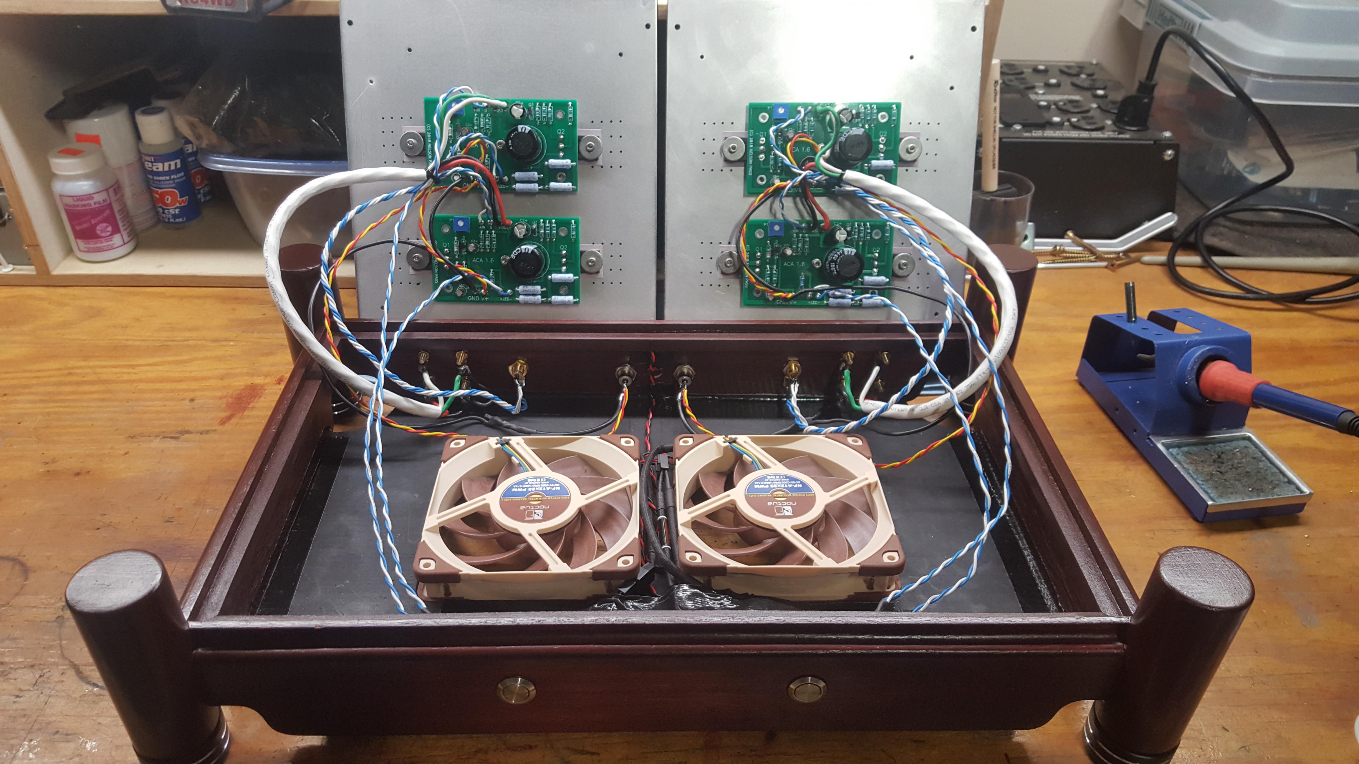

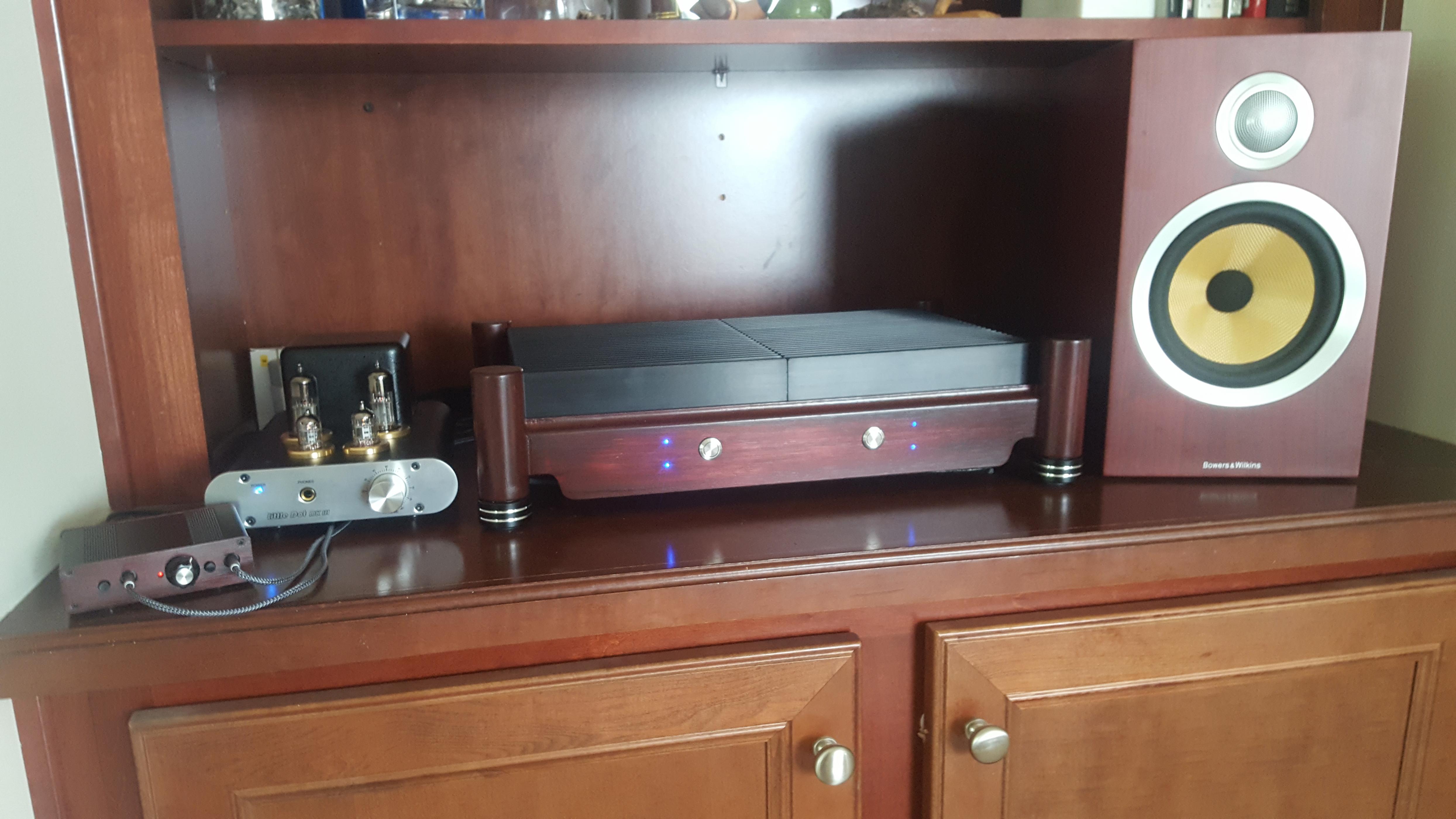

I finished my ACA a few weeks ago and thought I'd share it. It's two kits (4 individual amps) with my speakers bi-amped. I'm running the stock external SMPS with each pair of amps completely separated (there's insulation between the heat sinks so they don't touch). There's no extra space inside, and no airflow from bottom to top, so I added two 80mm "Silent" fans. They're turning pretty slowly and are very quiet. I can hear them if I stand right by the amp, but not from where I listen.
The highest ambient temp I've hit so far this year is 22 C. At that temp, the case internal temp is 30 C and the highest temp on the heat sink is 52 C.
You can see in one of the pics below that there are small holes (wire gauge drill, I don't recall which one) drilled around each transistor. That allows a small amount of air to be pushed through to the top of the heat sink which helps the hot air rise off the the top. It helps to over come the inefficient orientation of the heat sinks.
The heat sinks are 40mm Heatsinks - 250 x 210mm 0.19 C/W from the DIY Audio store, here.
The two pre/headphone amps in the pic are an O2 and a LittleDot MK III.
Forgive the abysmal speaker placement. I don't have a lot of options right now.

I think the looks of you AMP are fantastic! Really lovely looking at sites perfectly with its environment.
I have some Noctua fans sitting on a shelf. Would you care to elaborate how you give 12V to them and how you control the PWM speed? Thanks.

Thank you for the kind words, RafaPolit, I was quite happy with how it turned out. I'm practicing my wood working skills as I'm learning about amps. Two things I enjoy quite a bit coming together!
For now, they're not PWM controlled. I just used the resister lead they came with to plug them in which slows them down pretty well. In the (not so distant?) future, I'll add an Arduino that controls fan speed based on input from a K-type thermocouple.
For power, I used a 12 volt SMPS that I luckily had laying around. That had the benefit of keeping both halves of the amp completely separated, but at the expense of a third plug. Oh well. I can live with that.
Unless you want to learn and play with arduino, the eBay pwm controls already come with a thermocouple and cost a few dollars... The meanwell power supply I use already has a +12v output for a fan. Very handy...
