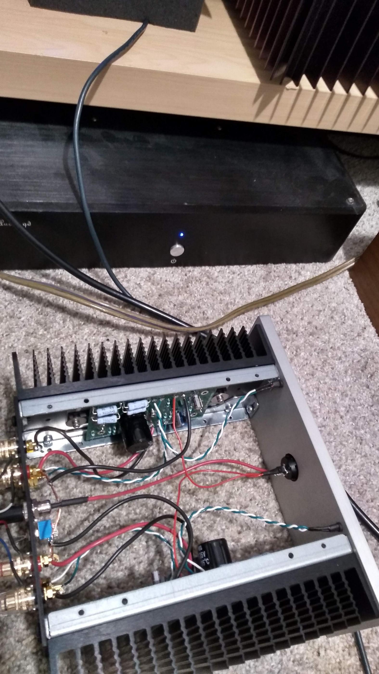

Would a 150x150x28mm heatsink work for a 24V ACA? The original heatsinks are 200x80x40 so less area but deeper fins.
I can get a bunch of these for free but after looking at them I was worried about the lack of depth. No C/W rating available.

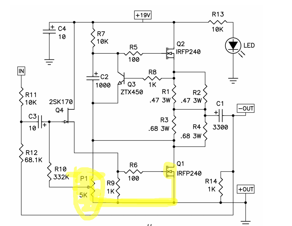

Can C3 come before the input or does it need to be inside the feedback loop?
being inside the loop will reduce its influence on the sound,
its function is to block DC but there would still be no DC within the loop so it should be ok, right?

but there is 3 or 4 volts on the gate of Q4...
oh right, I see now im ignoring R10 and that aspect of the circuit. thanksbut there is 3 or 4 volts on the gate of Q4...

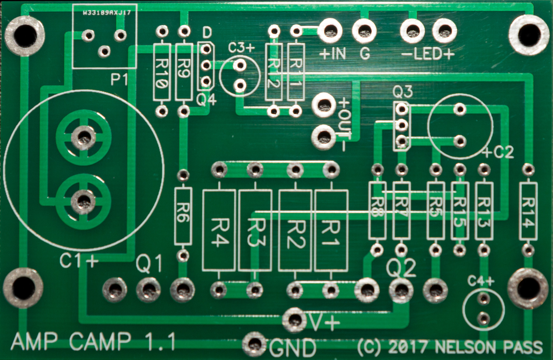

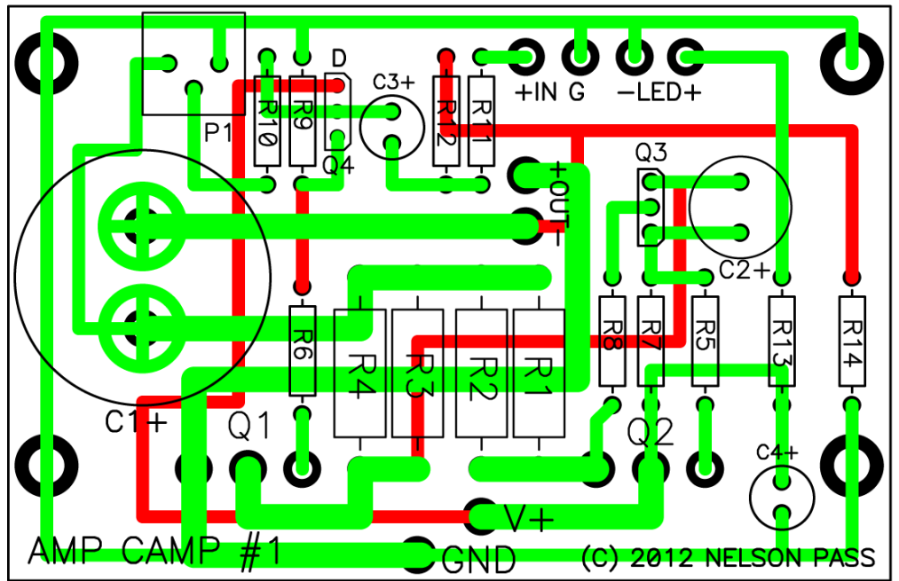

hey everybody, been wondering if anyone else has found errors between the layout (PCB) and the schematic. I've been noticing in the original (V1) schematic and layout that it has the + of C1 (the big output cap) connected directly to the far terminal of one P1. But according to the schematic C1 doesn't connect to the the pot. Also,in the newer versions of the layout (PCB 1.1,1.5,1.6) the + of C1 doesn't seem to be connected to anything. I would really appreciate any help, i have yet to find a version of this schematic that actually perfectly matched its corresponding PCB layout.

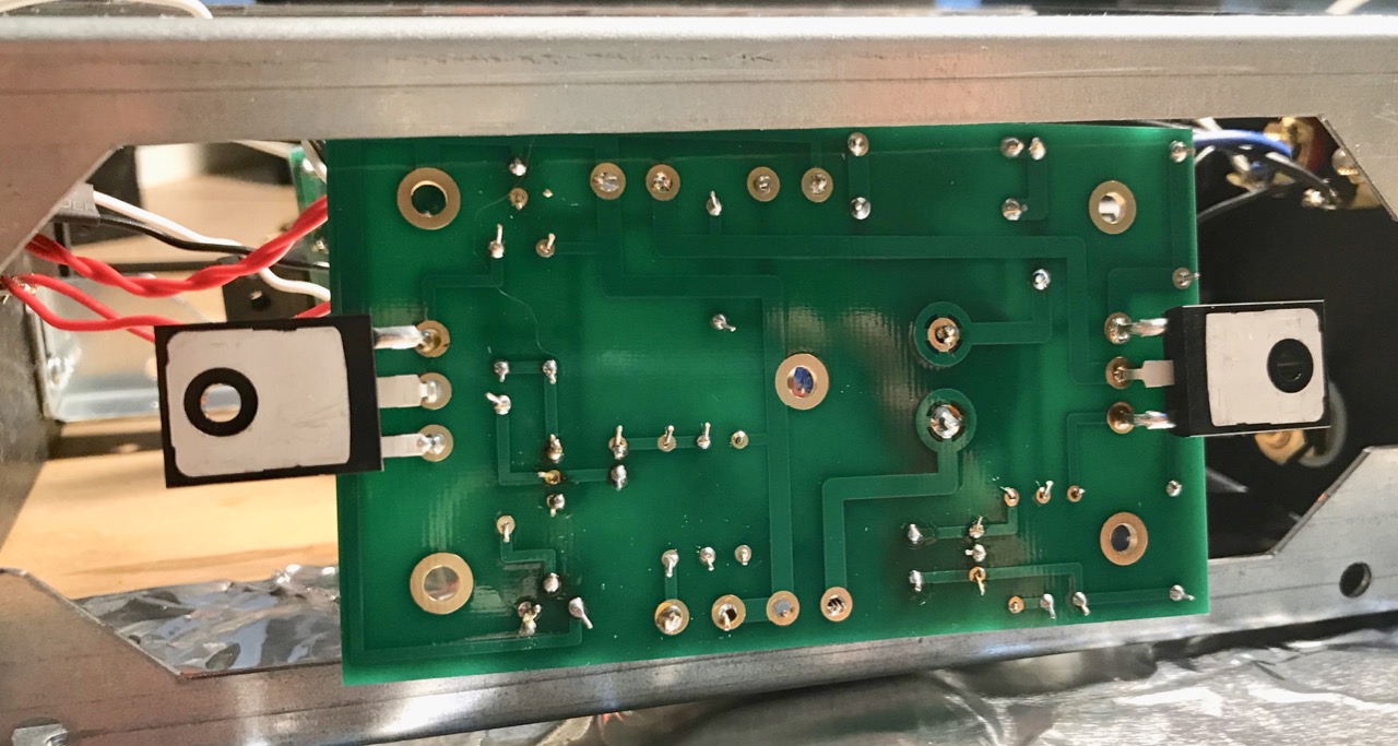

Regarding the C1+ not connected to anything, I think you are forgetting that the PCB is two sided. The built guide has one single picture of the back of a PCB, but there is a version missmatch (it is an older picture).
On V1.6, as you can see in this picture:
C+, on the other side, is connected.
On my V1.1, I do agree that C+ is actually connected to the Pot. I'd look further into that, as I don't think I have pictures of both sides right now at hand.

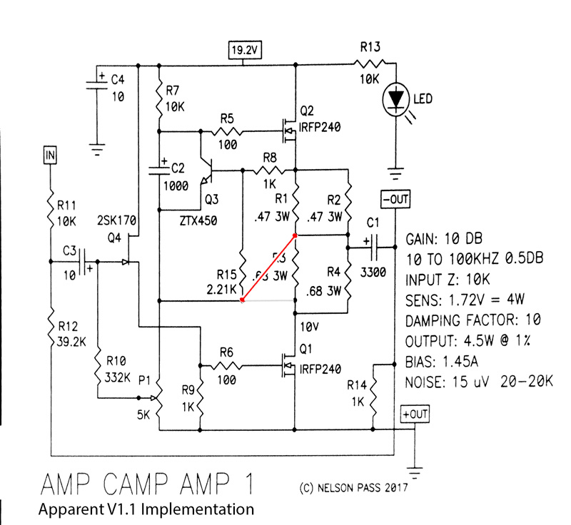

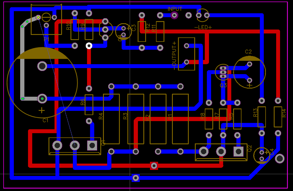

Thanks man i realized about C1 and the double layer about 5 mins after I posted. My issue now is with V1. The far end of the pot (that's shown as tied to C1+) should connect to the bottom of R3/R4/C2(-) and the emitter of Q3. The layout has it instead connected to the + of C1 and R1/2/3/4 etc. What's bothering me is that tons of people built that board and apparently it worked, even though it is totally wrong.

Ok, so I have spent a good hour looking at the schematic and the boards of V1.1, and there is CERTAINLY something that doesn't match the design.

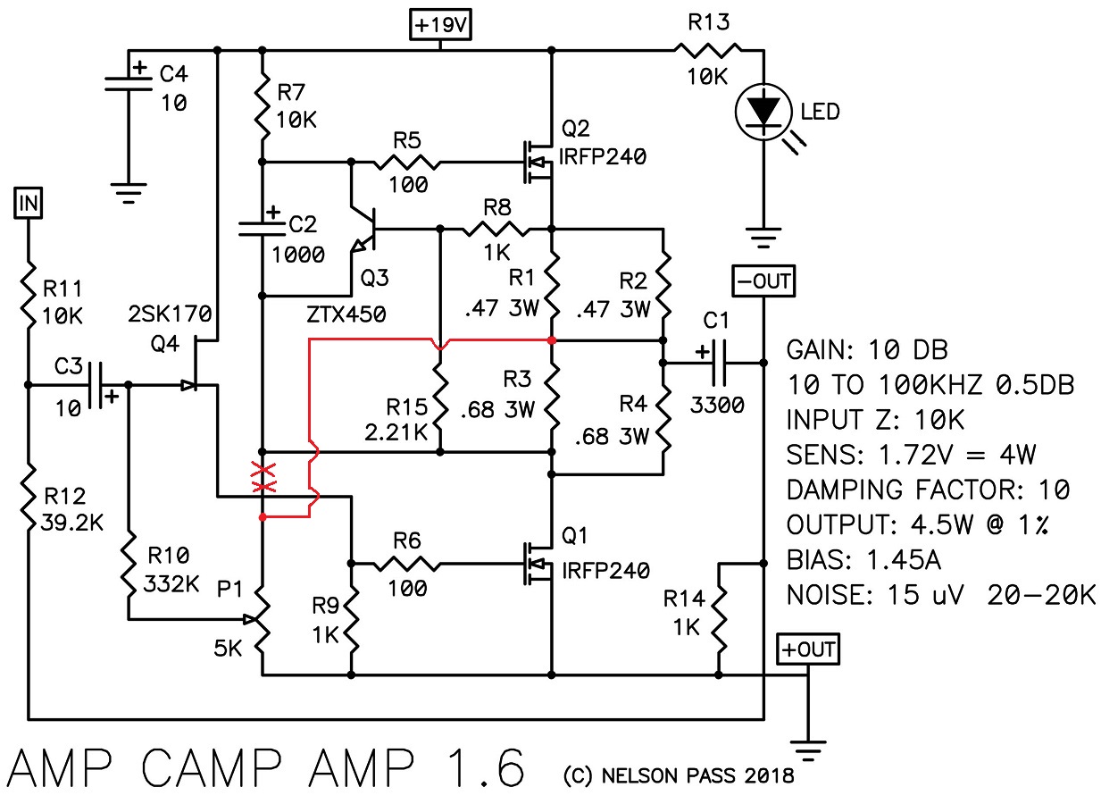

I believe that something like this is what actually got created in the PCB:
There is, without a doubt, a direct connection between P1 and C1+.
What effects can this have in the AMP, the audio, the expected lifespan?
Perhaps other important side effect is that the R15 mod from 1.0 to 1.1 appears to be 'floating' there without any influence to the circuit whatsoever. There may be other inconsistencies.
Thanks for taking a look into this. Best regards,
Rafa.

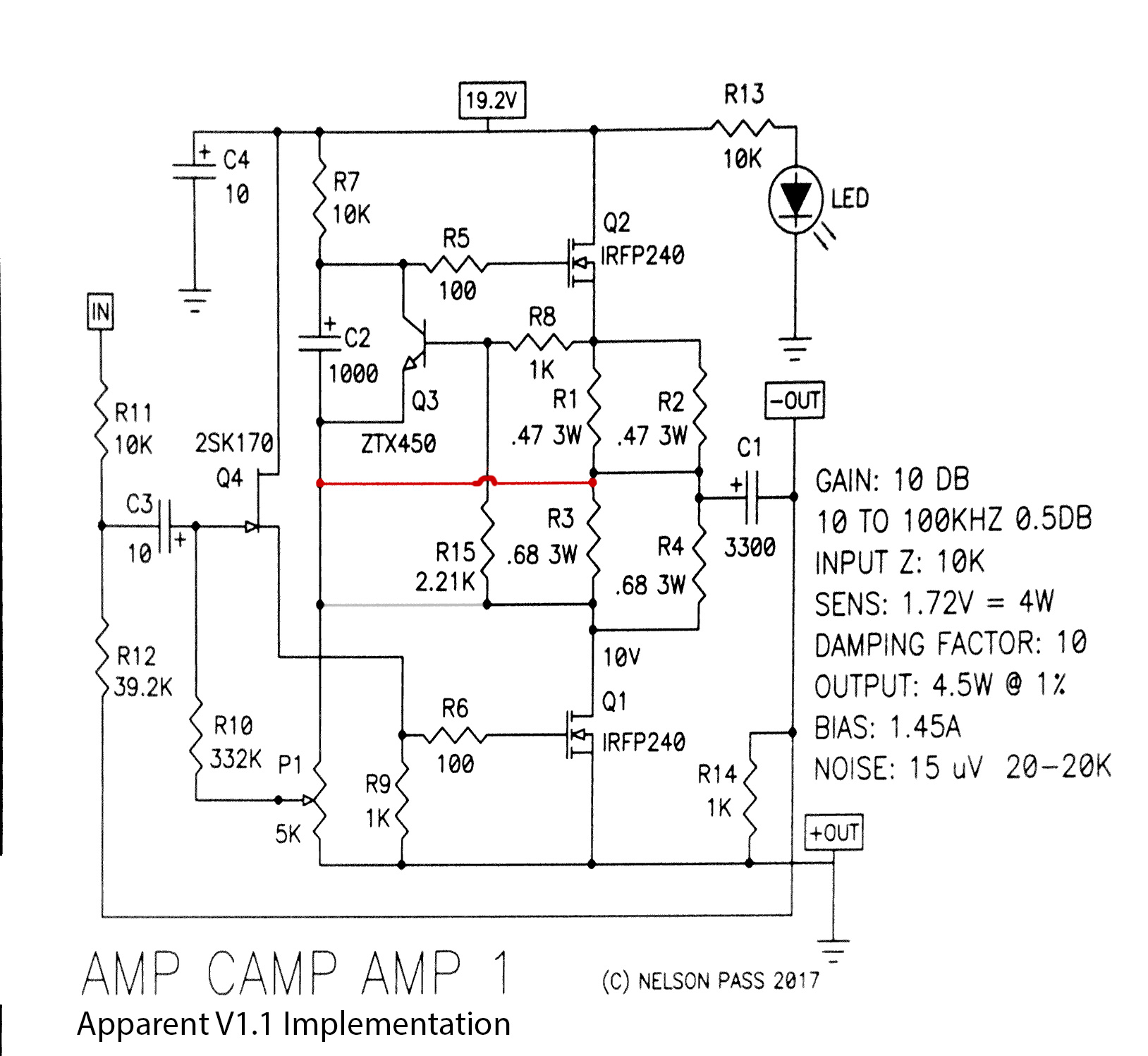

Rafa.

Rafa, your schematic looks like the original one to me... I’ve been looking at it for a while and wasn’t able to tell the difference. Can you please highlight your changes?
There's a big red line in the middle, and a grayed out connection between R15 and P1 in the first version. And a big diagonal red line from R15 to the middle of R1 and R2 and a grayed out line between R15 and R3 in the second one.Rafa, your schematic looks like the original one to me... I’ve been looking at it for a while and wasn’t able to tell the difference. Can you please highlight your changes?
You still don't have it right. The emitter of Q3 goes to the Drain of Q1. Disconnect the top of P1 from everything, then connect it to positive side of C1 and the common point of R1-R4.
