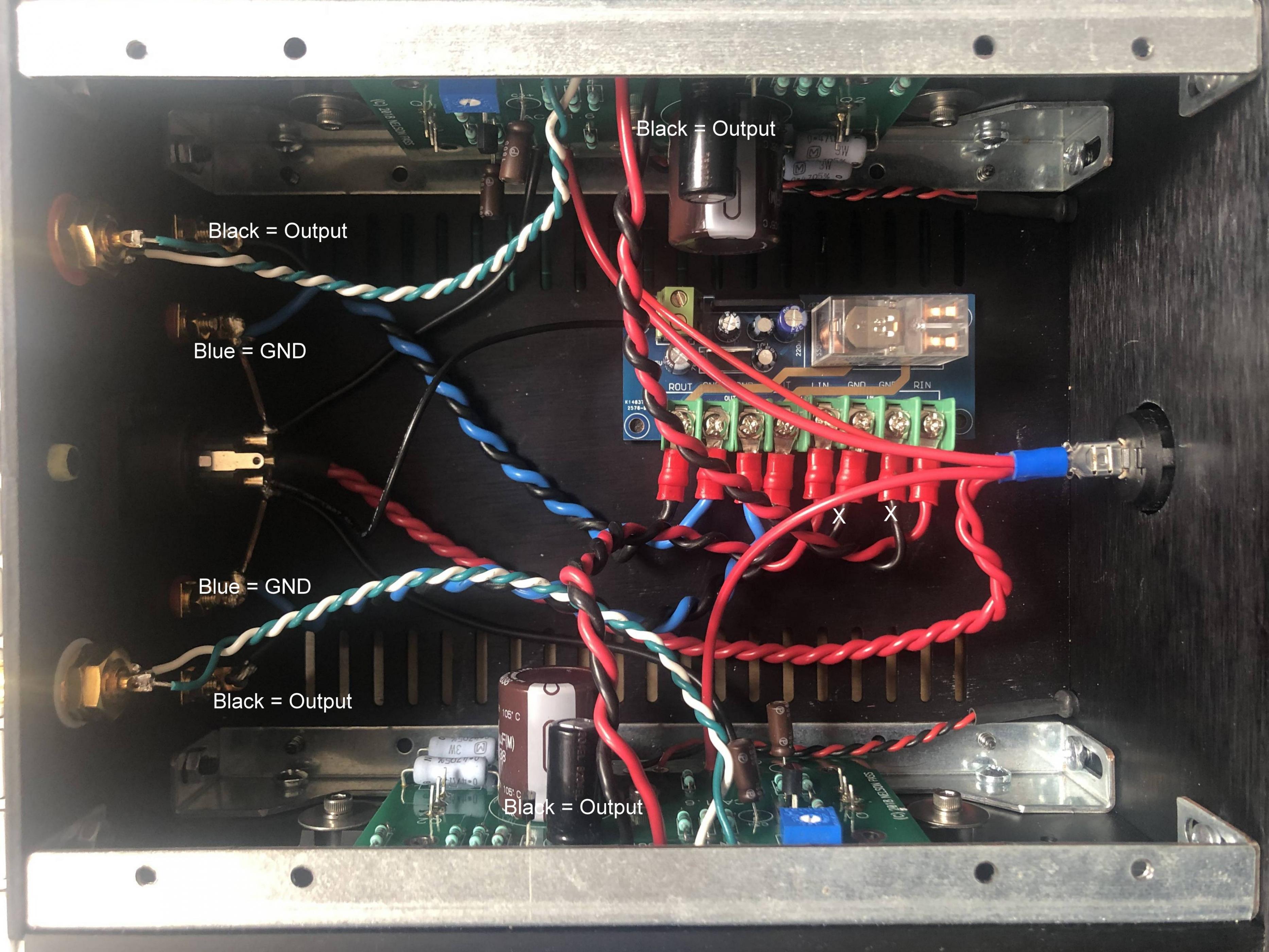

When I first assembled the ACA, it worked perfectly, other than the expected on/off pops. I added the delay/speaker protect to silence these pops. Since then I've had the issues, so during the upgrade process I've messed something up.
Next as they both have the same 'fault' it is more likely a connection problem. Have you tried going back to the build guide configuration, with no delay circuit at all?
I have tested the ACA in the original configuration, i.e. with the speaker protect fully disconnected and the ACA connected directly to the binding posts. It still has the problem.
I assume you have measured +24 volts on the V+ connection on both boards and the 'bias' is still about +12 volts on both?
Yes, DC measures correctly on both amp boards. Bias is stable at 10V on both boards (within 0.1V). The 10V number comes from the build guide. Is 12V also an option? Tradeoffs?
Then, please post some good clear pictures, so we can see the wiring and show us what type of 'delay' you used.
This is the speaker protect I've got in the case: UPC1237 Speaker Protection Board DIY KIT Used Japan OMRON Relay for Dual Channel | eBay
Though even with it completely disconnected, the amp has the issue present.

Looks like I screwed up the solder joint - I have some solder that somehow bridges the small gap between the center pin and ground. I have tried to no avail to clean that mess up - in fact, I think I've now made it worse. So, where do I go to get the same RCA jack? (I know any one will likely do, but I would prefer to have the same one as all the other ones.)
Thanks for all the pointers helping me to root cause this!

Pictures heres: ACA 1.6 - Album on Imgur First one was with everything connected up, last three after the speaker protect is disconnected.

Ummm, I see what has probably happened...
Looking at the first picture, with the delay board fitted, both outputs are shorted to ground.
Remember before you installed the delay board, the blue wires went to the Red speaker socket from the + OUT pads on the ACA boards. (This is a bit confusing as the + OUT pads are actually at 0 / GND volts.)
And the Black wire went to the Black socket from the - OUT on the ACA boards. This is the actual 'output' and NOT the ground connection.
Now if you look at the delay board picture the Blue wires from the Red sockets go to the GND terminals between ROUT and LOUT. That is correct, the blue wires are at 0 or Ground volts. So now the GND terminals between RIN and LIN are now at 0 volts too.
Unfortunately you have connected the Black 'output' wires from the ACA (- OUT pads) to the GND terminals causing a short ... It should have been the red wires from the + OUT pads connected to them. A bit confusing as I said.
What next?

Yes! This was it. Thank you.
I did the impedance measurements in section 56 and found that things were more or less correct. Then switched the outputs around as you suggested, and bam, it's singing again.
Very impressed that it survived that!
Now rebiasing to 12V before closing it up :)
Thank you very much Alan4411 and RafaPolit for the help.
