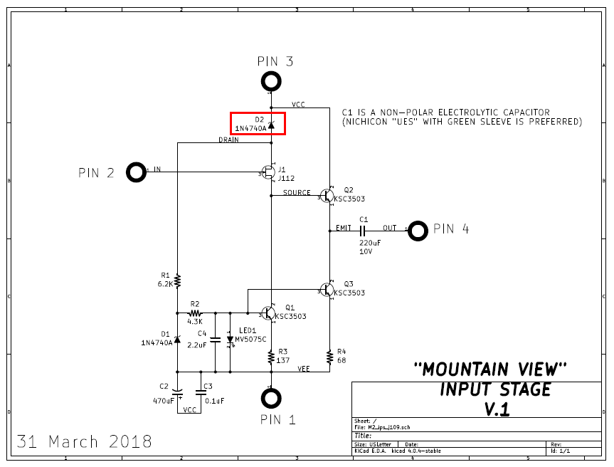

Would there be any harm to run the amps at 28-32 volts ( I have proper size toroid already that gives that voltage after rectification) .

Well, it depends… How big are your heatsinks? The standard ACA dissipates about 36 Watts per side, which is fine for the Mini Dissipante 2U chassis. I run a higher quiescent current in mine, so they are a bit warmer, but not hot.
When I started building ACA amps with linear power supplies, I switched to a larger chassis with bigger heatsinks. I have a pair of amps built in the old Hafler DH-220 chassis. One of these runs about 44 Watts per side, and the other is running at 48 Watts per side. I’ve written about the 44W per side build, which I call the ACA-220 v1. The hotter build is still somewhat a work in progress. Its rail voltage is 28.4V, and the quiescent current is 1.6 Amps for the time being. The voltage at the reservoir cap for each channel is 30.2V, which accounts for the remaining power dissipation.
There are also a couple circuit modifications that should be made. Besides increasing the current, it’s also a good idea to reduce the voltage across the input buffer JFET. I’ve done this with a simple RC filter of 499 Ohms and 100uF. I’ve also bumped R7 up to 12k. These are the values for the higher voltage build. BTW, the higher current allows the higher voltage to be used effectively, as well as placing the power MOSFETs into a different operating region.
... it’s also a good idea to reduce the voltage across the input buffer JFET. I’ve done this with a simple RC filter of 499 Ohms and 100uF.
Zener diode in the drain leg works pretty well in the M2x "Mountain View". Feel free to add current-increasing resistors and/or PSRR-improving capacitors if you see fit.
Hi TungstenAudio, I am looking to buy heat sinks, the chassis I have has small ones.18x8x5 Have to see what I can fit in my chassis.
And aside from raising the quiescent current to 1.6A Where in the circuit do I put the RC filter of 499ohm and 100mf? (sorry, newbie question)
Got this :R7 up to 12kThank you.
Also thanks to RafaPolit and Mark Johnson and all others.
The closest equivalent to the old Hafler chassis I am using is the Mini Dissipante 3U / 250mm. You could also extend the capacity by getting the 300mm deep chassis instead. The Hafler heatsinks are quite impressive.Hi TungstenAudio, I am looking to buy heat sinks, the chassis I have has small ones.18x8x5 Have to see what I can fit in my chassis.
For the RC filter I mentioned, I placed the 499Ω resistor in between the power rail and the drain of the JFet. Then I placed a 100 uF cap between the drain and ground. See Mark Johnson's example for an alternate method using a diode instead of the RC filter. I might suggest a red LED instead of the 10V Zener, since we have less voltage to deal with than what the M2x uses.
