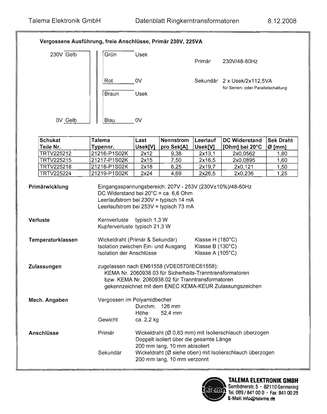

Will two transformers be good for him?Its huge. Should not be a problem.
1 pc. TALEMA vergossener Ringkerntrafo 225VA Eingang: 1x230V Ausgang: 2x18V | eBay
https://www.diyaudio.com/forums/attachment.php?attachmentid=739845&d=1551464617

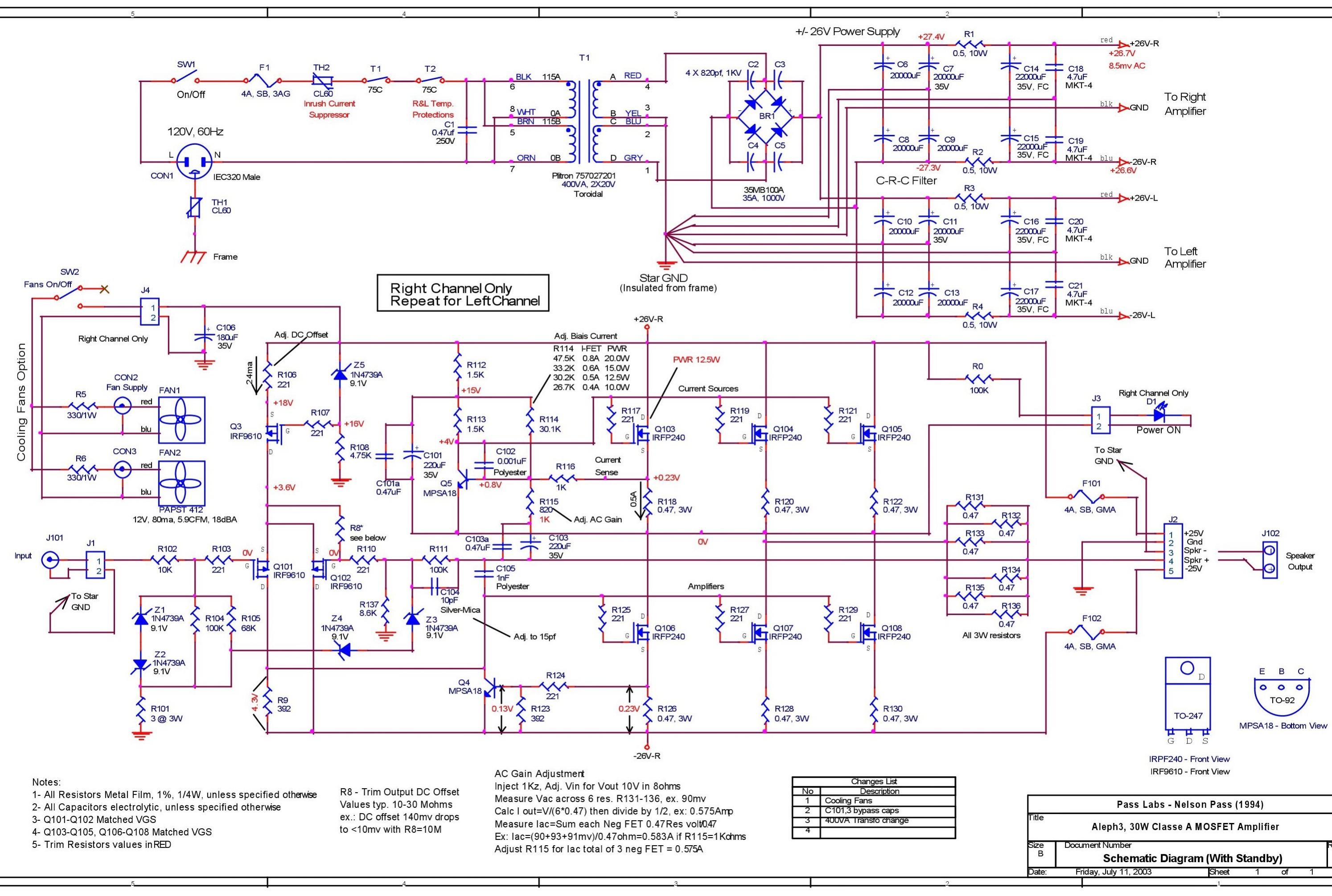

I'm still assuming you mean the amp camp amp because that schematic you attached earlier is not the amp camp amp. This transformer can work for two amp camp amps. You don't need two transformers. However why not use the power supply Nelson suggested? A 24v amps switching supply? I'm using a Lutze DRA-240 from eBay and its great. Only cost me about $30.
I am a supporter of the transformer power supply of the amplifier, if possible I want to make the power supply of both channels separately as a double mono.However why not use the power supply Nelson suggested? A 24v amps switching supply? I'm using a Lutze DRA-240 from eBay and its great. Only cost me about $30.
This is an amplifier circuit from Nelson. 2003
LongRoad, I think it is not really clear if you are inquiring about heatsink and power supply for the ACA (Amp Camp Amp) - which is the only subject discussed in these 7000+ posts - or if you are trying to inquire about that other amp.
That other amp has, apparently, option for even active heat dissipating components: fans! There is for sure a thread dedicated to the Aleph 3, in which you are more likely to find good answers if that is your goal.

But your schematics shows an aleph 3 this a Little bit bigger than an ACA.
For an aleph 3, two of the TALEMA trafos will be sufficent.
Normally one single 300VA Donut will do the Job too.
But consider to Change the thread.
To maybe this one Aleph 30 diy - total beginner
