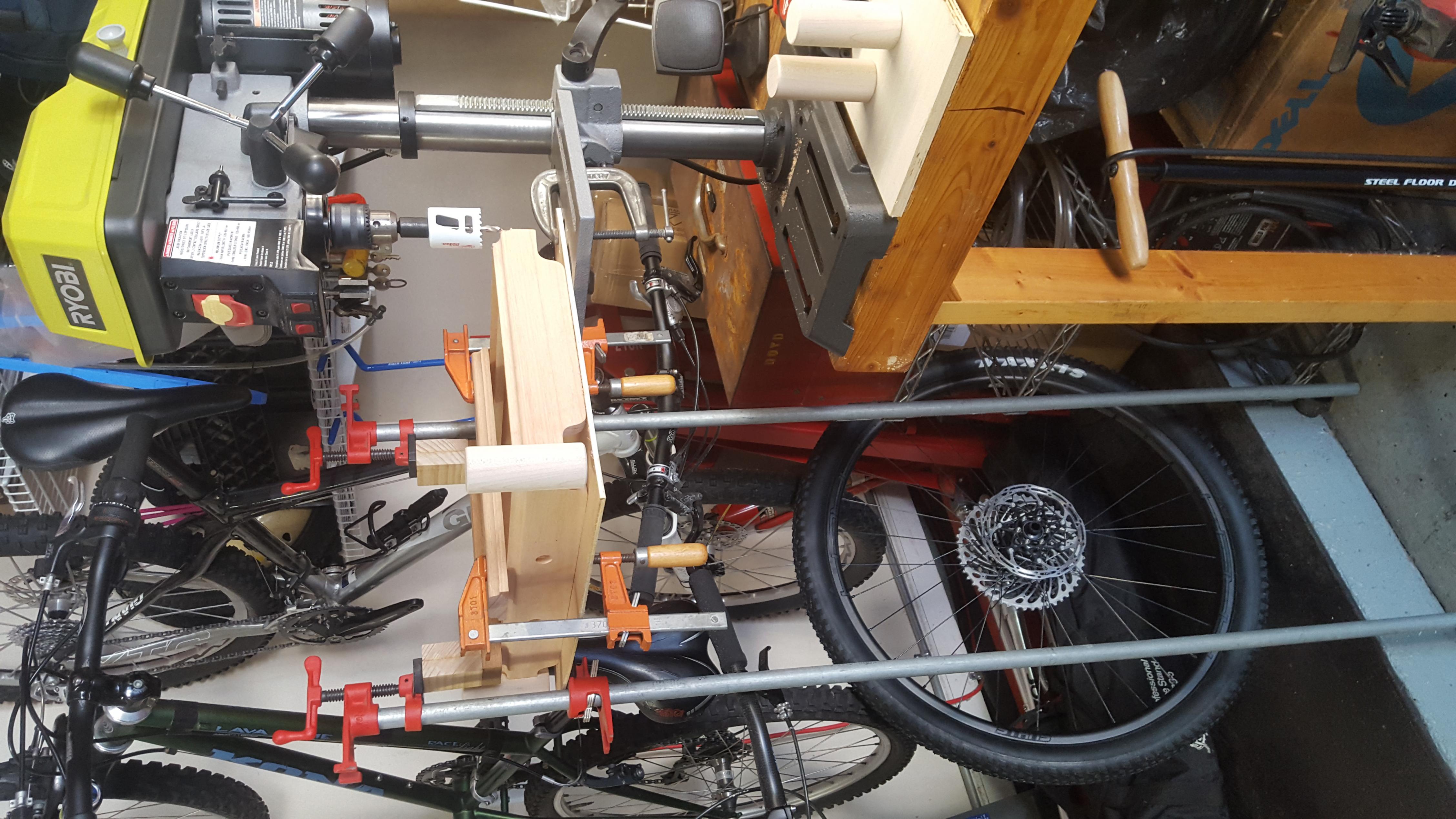

Yes, I took a few pics while I was building it.
The drawing below was my concept drawing. It probably shows it the most clearly.
I used a hole saw the same diameter as the dowel to knock the corners off and a strap clamp to hold it together while the glue dried.
It was originally glued up square with mitered corners because that made the router work easy. Then the inside corners where glued in to provide support when I removed the mitered corner. Then the dowels were glued in place.
The triangle braces like in the drawing would've worked better than what you see in the pics below. I did it this way because I broke my right hand (and I'm right-handed) at the start of this project. I did almost all of it (and the O2 from the first pics) with my left hand and a bunch of clamps. It took almost 3 weeks!
Sorry the portrait oriented pics get turned sideways... you can still see what's going on, though.
Good luck with yours, I'd love to see your pics!

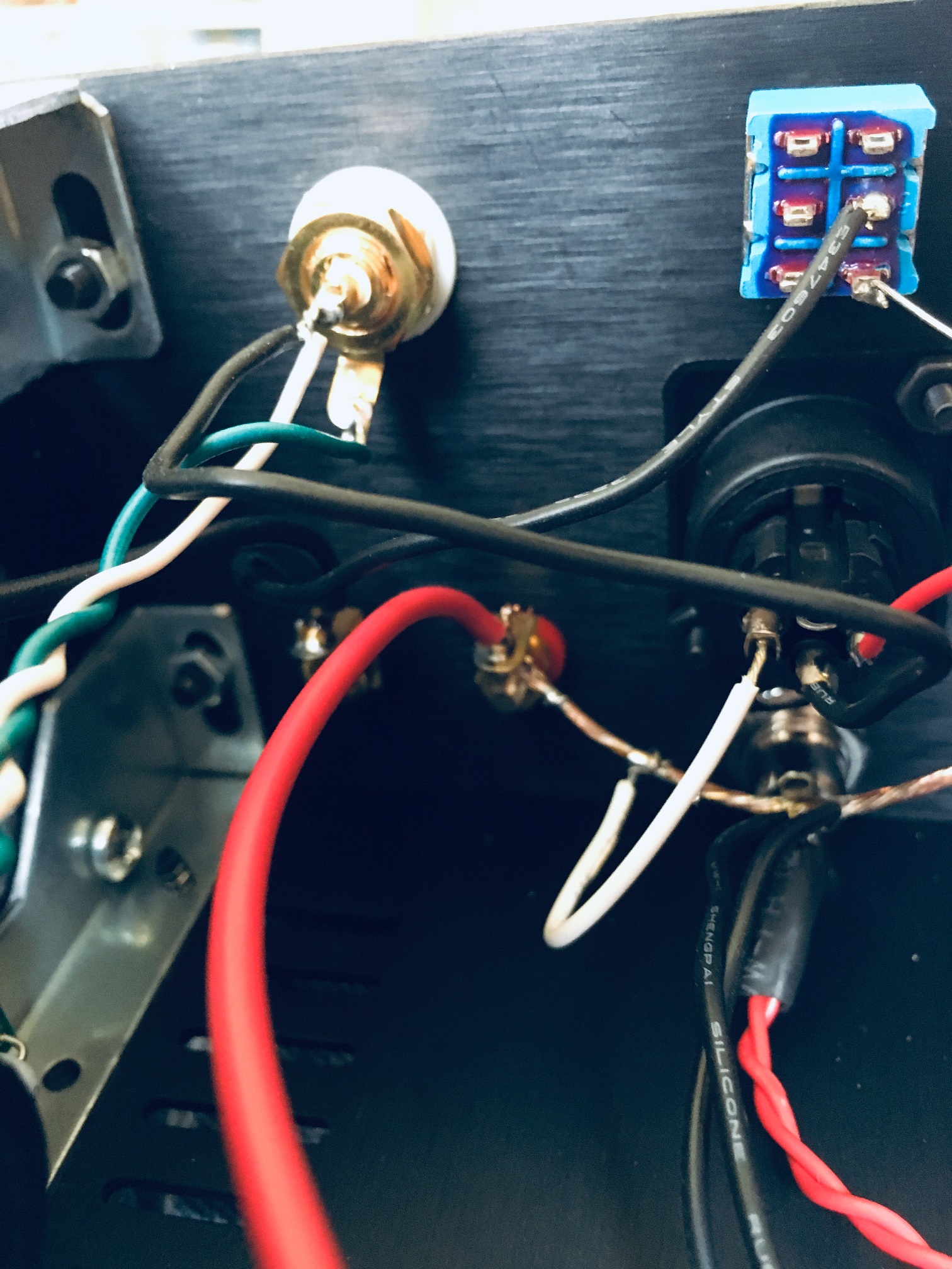

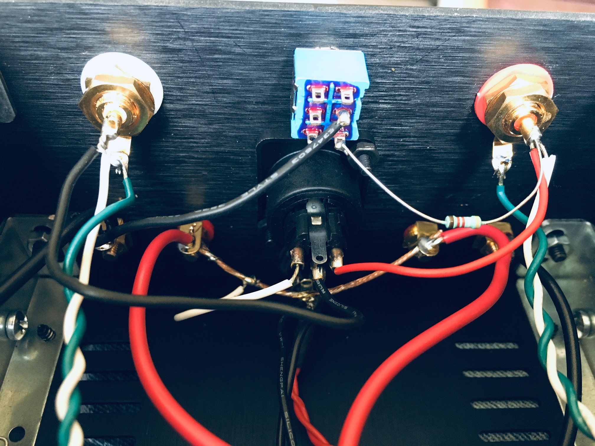

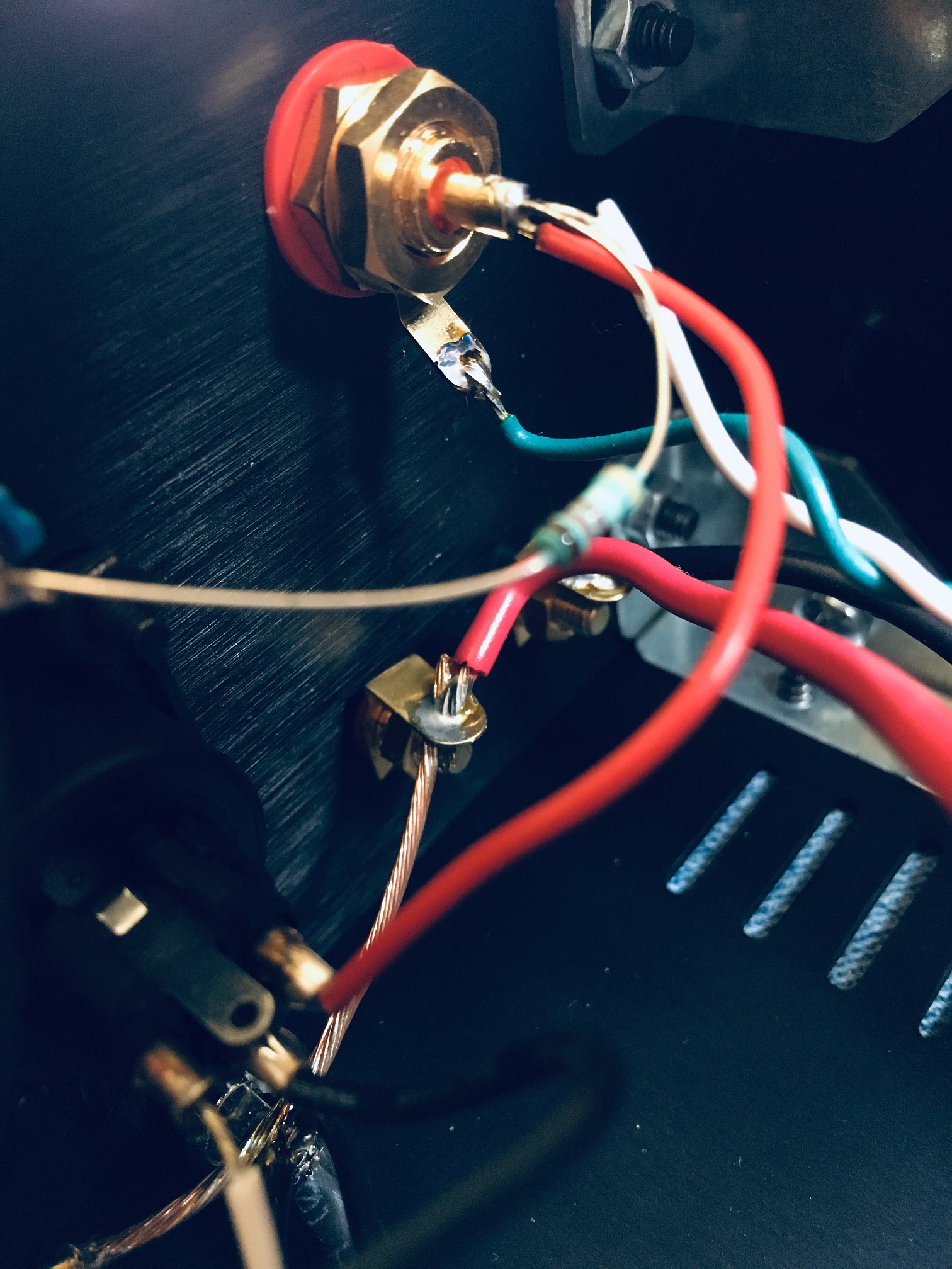

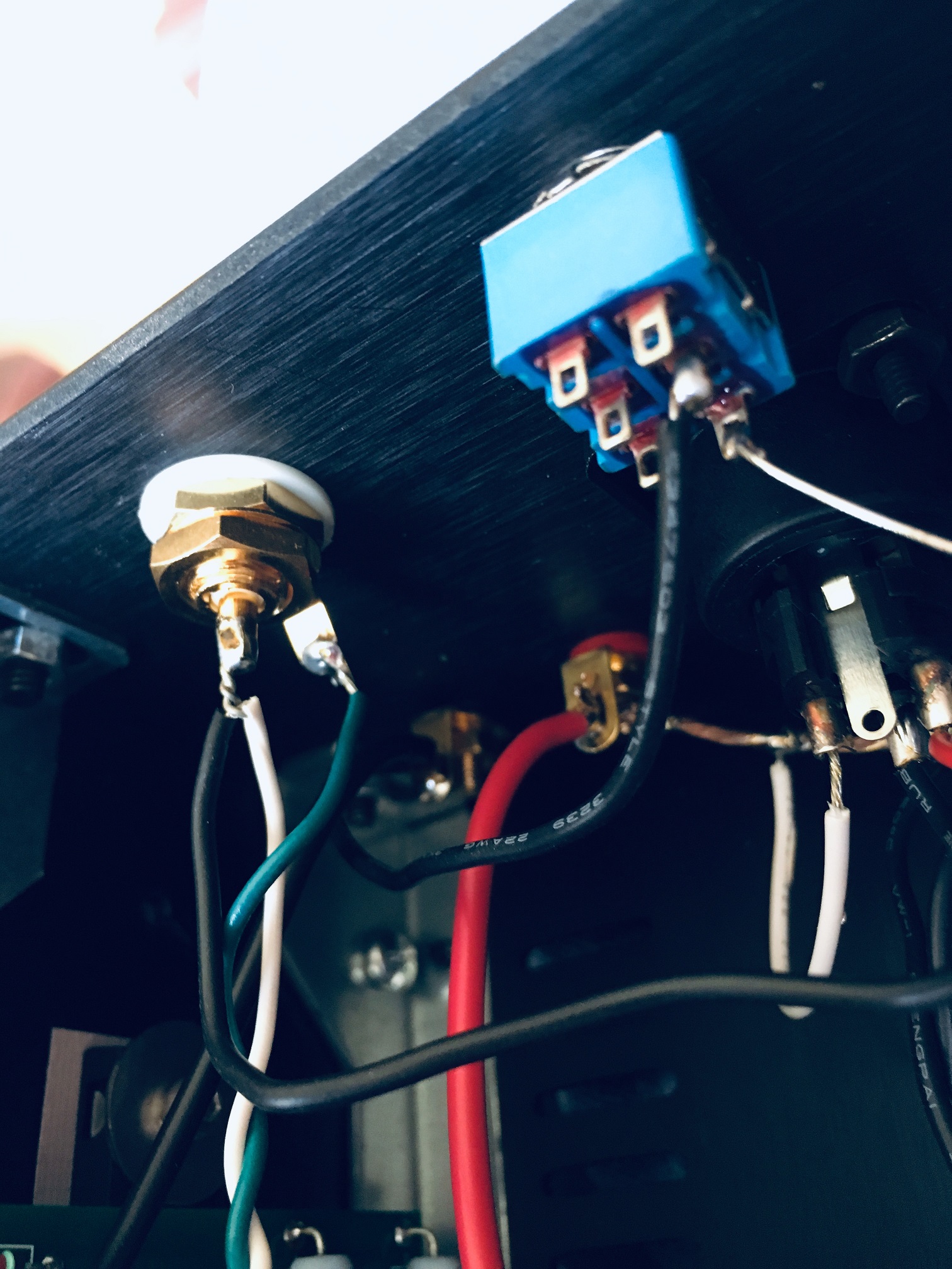

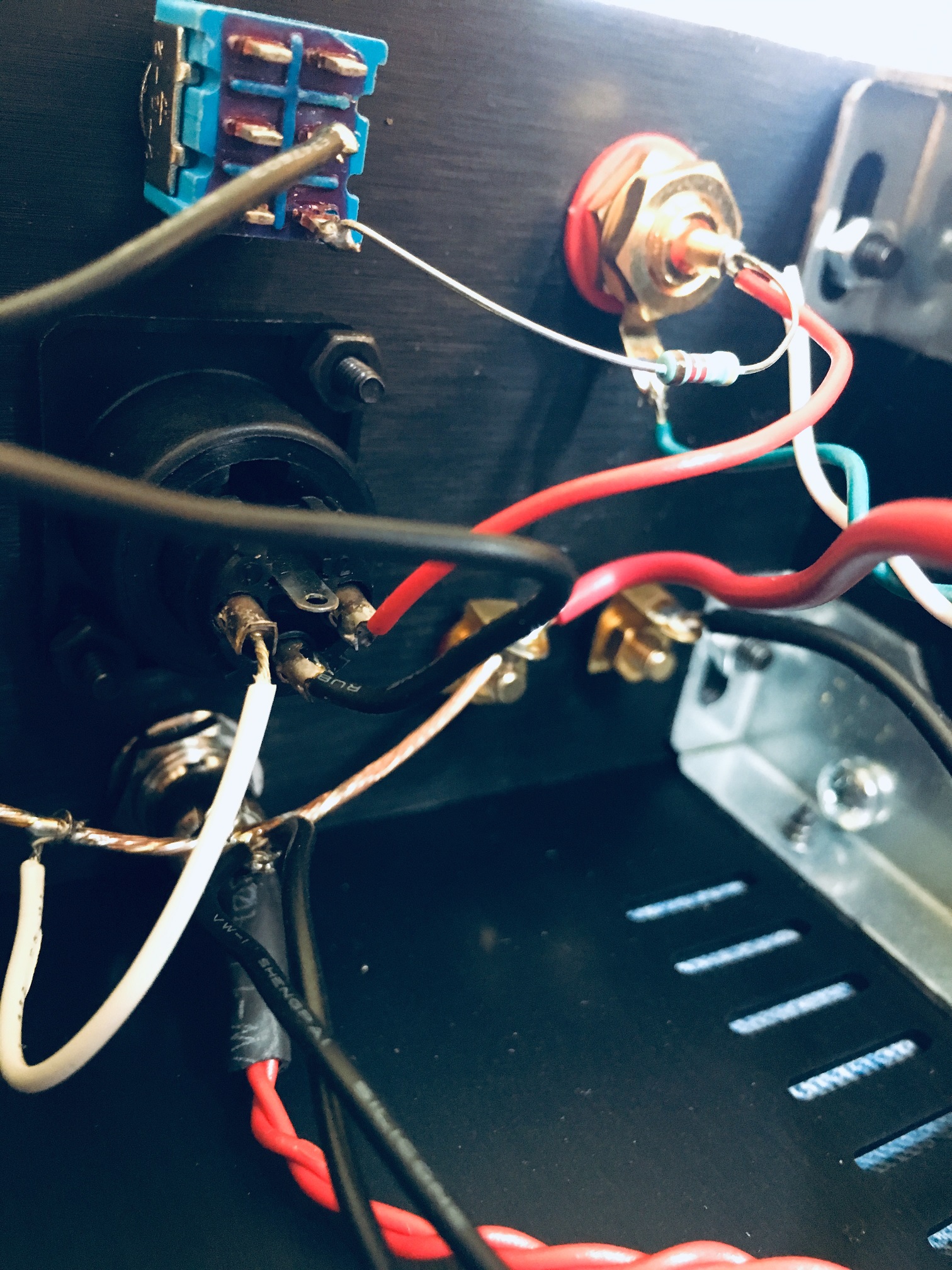

Hello Everyone,
Apologies if this is answered elsewhere. Could someone please direct me on this ACA issue:
Built ACA 1.6 kit with included front panel switch and back toggle switch wired as shown in batch 3 and step 49 video.
Problem: connecting only one input, either red or white, results in both speakers producing sound, regardless of rear toggle switch setting. Toggle up has slightly higher output. Connecting both L&R (red + white) inputs simply produces higher volume.
So far I have reconfirmed that everything is wired properly and according to wiring diagrams.
Is the problem that it is only working in mono? Could it be the switch or the 39K resistor has gone bad? I would very much appreciate some skilled troubleshooting and resolution advice. - Thanks

I have a couple of tests / ideas you could try, until someone else points into a better direction:
- Have you checked with a multimeter that the back switch is actually changing from continuity to open on the two pins you have soldered the wire and resistor?
- Is there a chance there is continuity between the XLR pins (for instance if you have a jumper shorting the input pins)? Check with a multimeter that there is no continuity between both pins in the XLR.
I would try to isolate the problem by going back step by step until you have something working. E.g. try to see if you can get RCA inputs working as "standalone" for both channels. E.g. start to unsolder resistor from switch to right RCA input and maybe also the red wire from XLR connector. Then check if right channel works as it should using RCA input.
