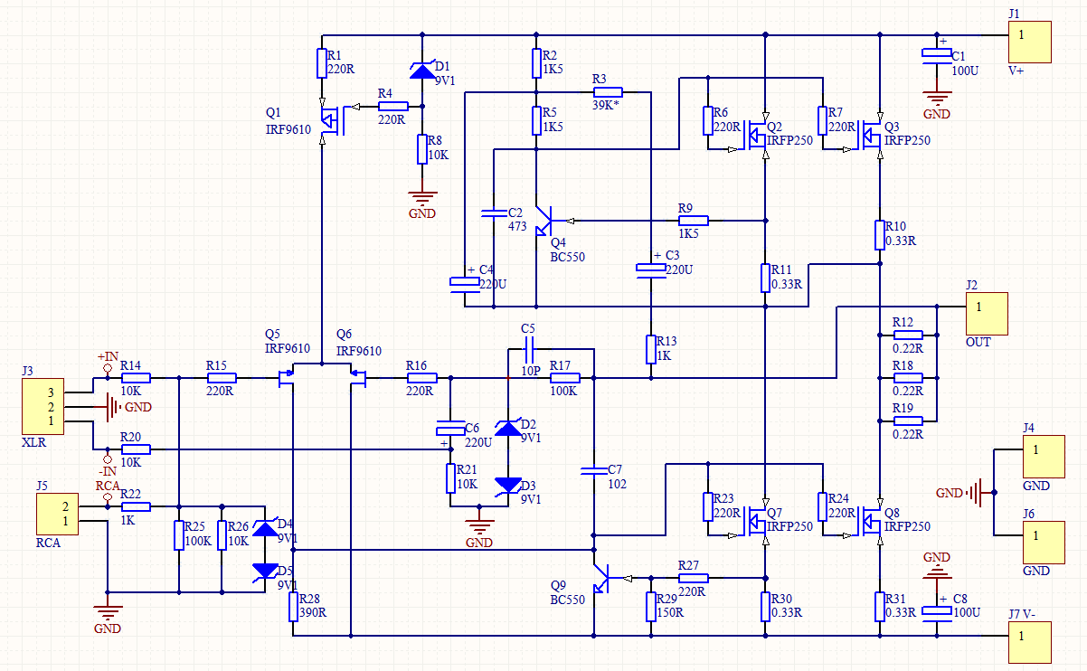

Tell me which transistors are better for the amplifier, who has experience?
My head is spinning
IRF250P224 , IRFP250PBF , IRFP244PBF , IRFP240PBF 😕
My head is spinning

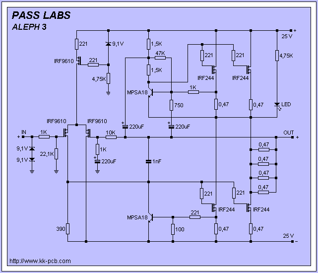

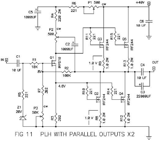

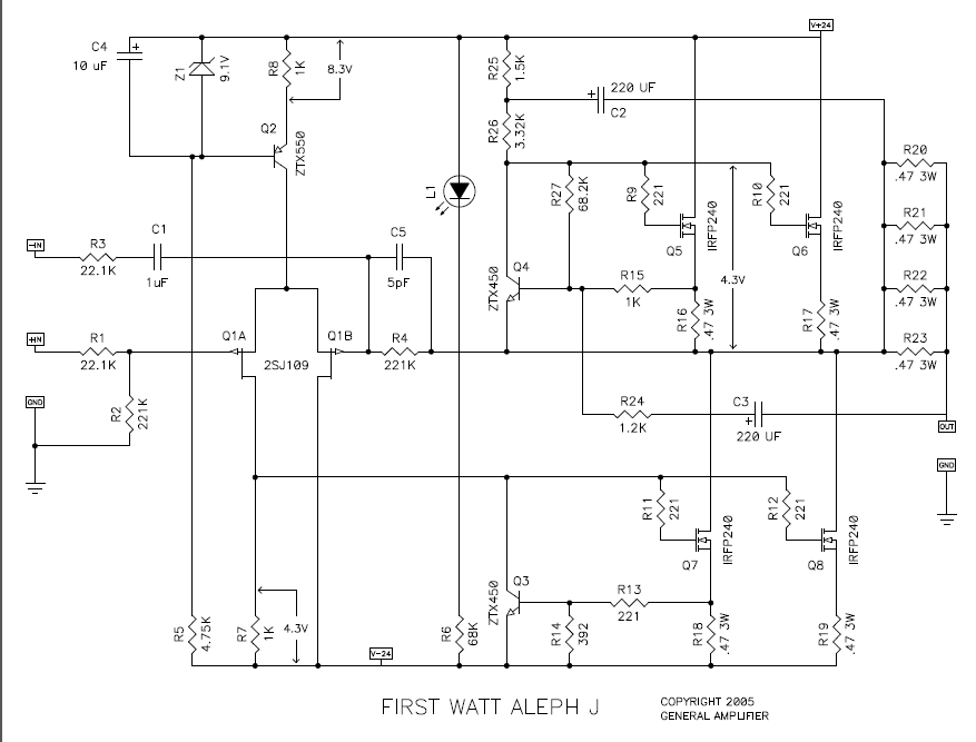

All of the output stage operates in the same mode.For what amplifier? You’ve got 3 different amplifier topologies in your schematics.
I am interested in which of the transistors with less noise and works better in such switching IRF250P224 , IRFP250PBF , IRFP244PBF , IRFP240PBF ?
If the ACA is the target amplifier, then the IRFP240 (pbf) is the default choice, and the best place to start. Since that transistor is also the default for the Aleph J and other FW clones, it is convenient as well. The ACA does not require matched power transistors, so it may use 'leftovers' from matching devices for other builds.

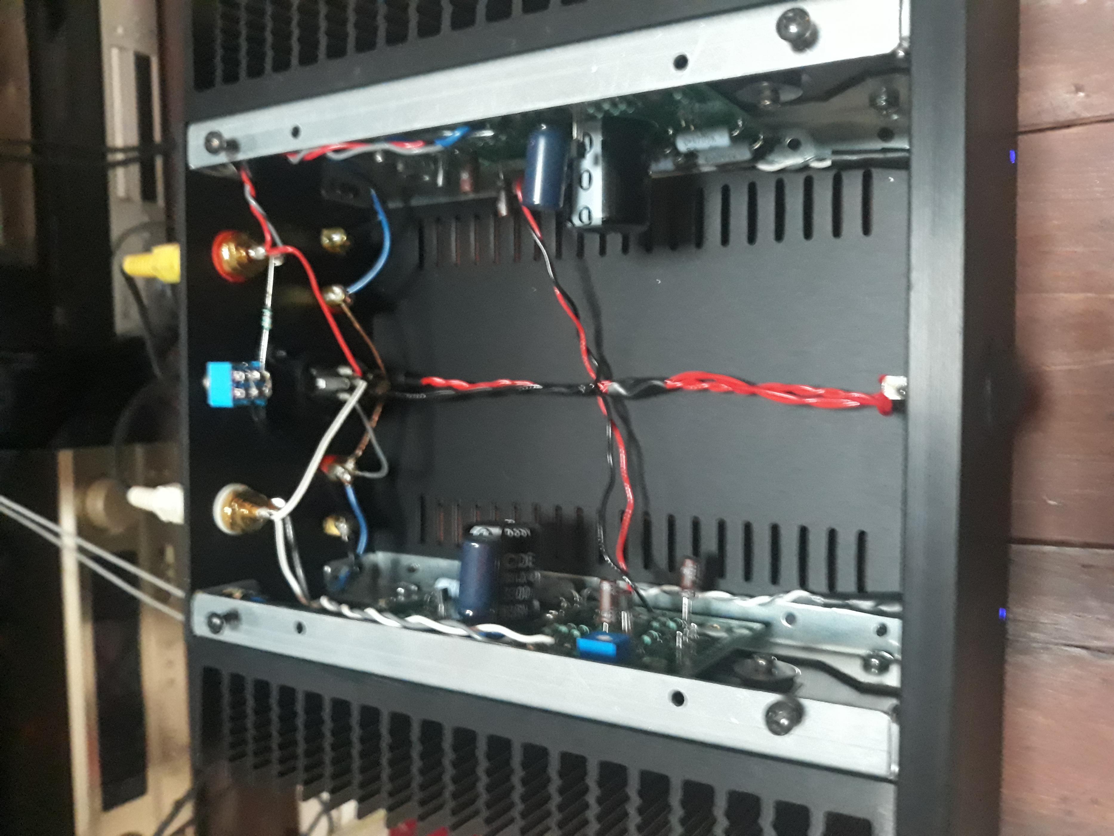

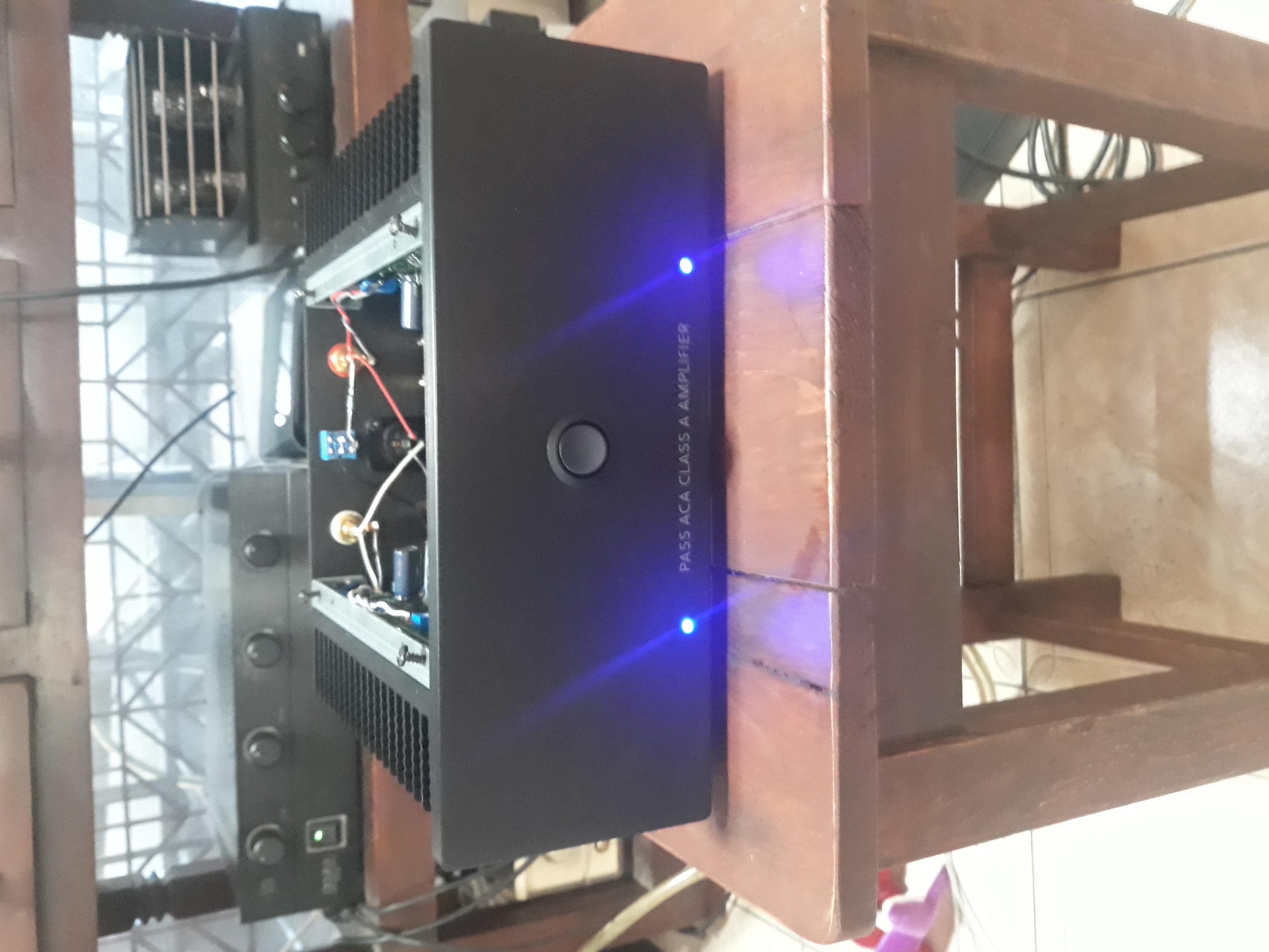

Hi! I'm from the Philippines. I ordered two ACA kits. I just completed one, and it's working now and sounds great.
Cool. Wait 'til you get the 2nd one, quadruple the fun..
