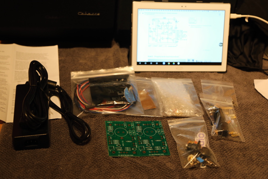

I greet everyone. Have anyone experience with such a Kit?

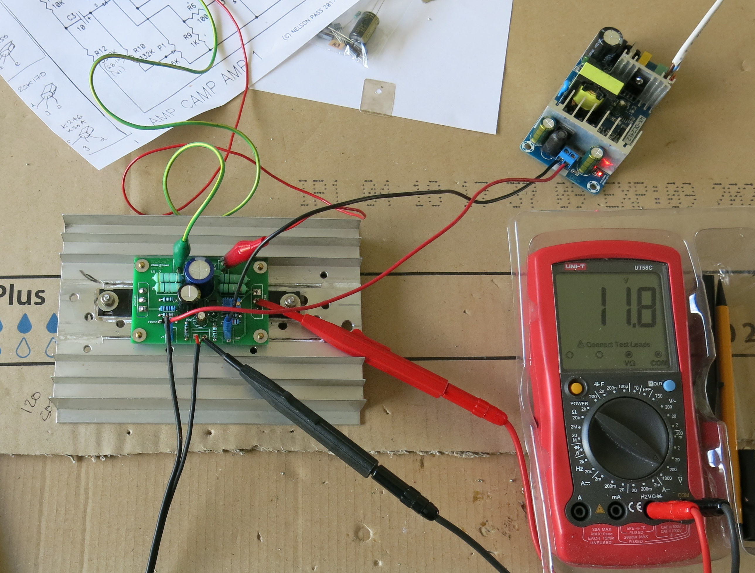

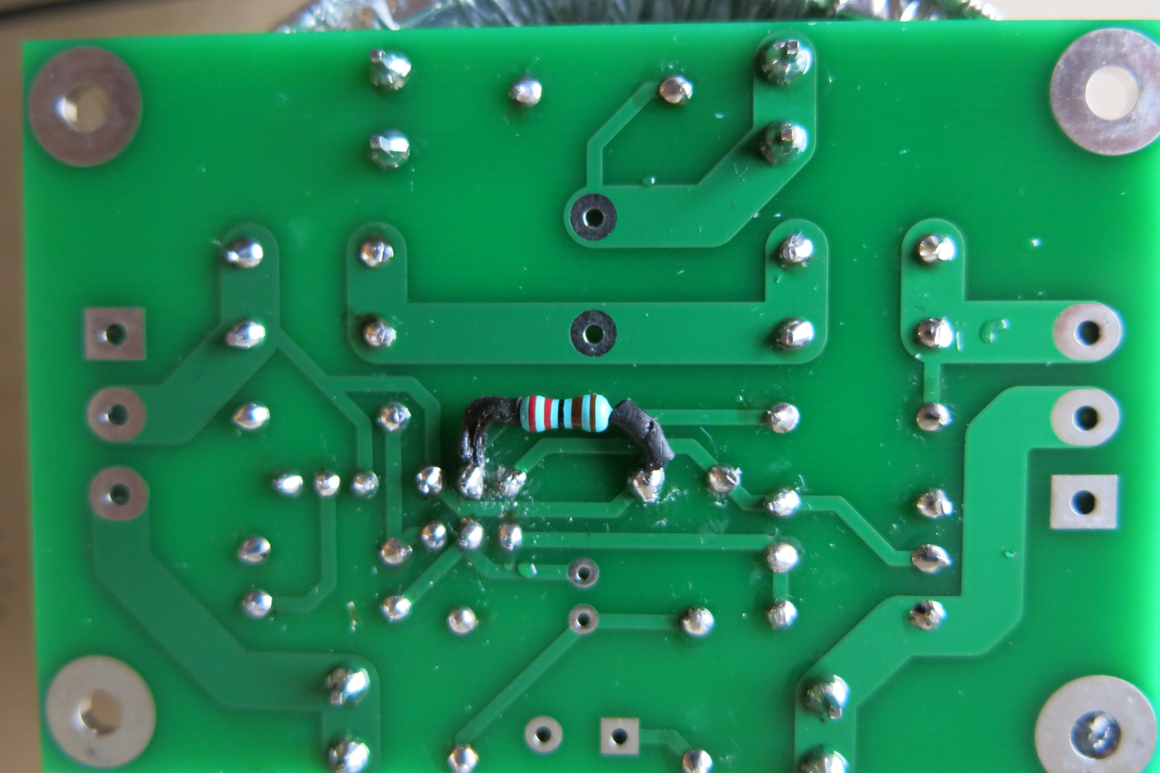

The ZeroZone and other Chinese clone kits typically fail to include R15, the 2.21 kΩ resistor from base to emitter of Q3. This was an important part of the later version of the ACA which allowed it to achieve closer to 8W. It's Ok to use a BC550 instead of the ZTX450, but the 2SK246, or K30 is a dodgy replacement for the 2SK170. In all likelihood it will not perform or sound like a proper ACA, given the parts in the kit.

What I was trying to say was the Chinese "ACA Clone" kits such as this one have some problems that you will need to fix. You will want to add R15 and run the boards with a 24 Volt power supply to get the best power from them. It would also be much better to find a pair of 2SK170 or 2LS170 JFets to use for the front end. The BF862 has Ok performance, but is only available in SMD package, as you have found.

The addition of R15 will increase the quiescent current through Q1 and Q2. This gives a performance boost for both 19V and 24V power. Remember that the source of Q4 (maybe BF862) runs at the gate voltage necessary to turn on Q1, or about 3.5 Volts. So Q4 does not have the full power supply voltage across it.

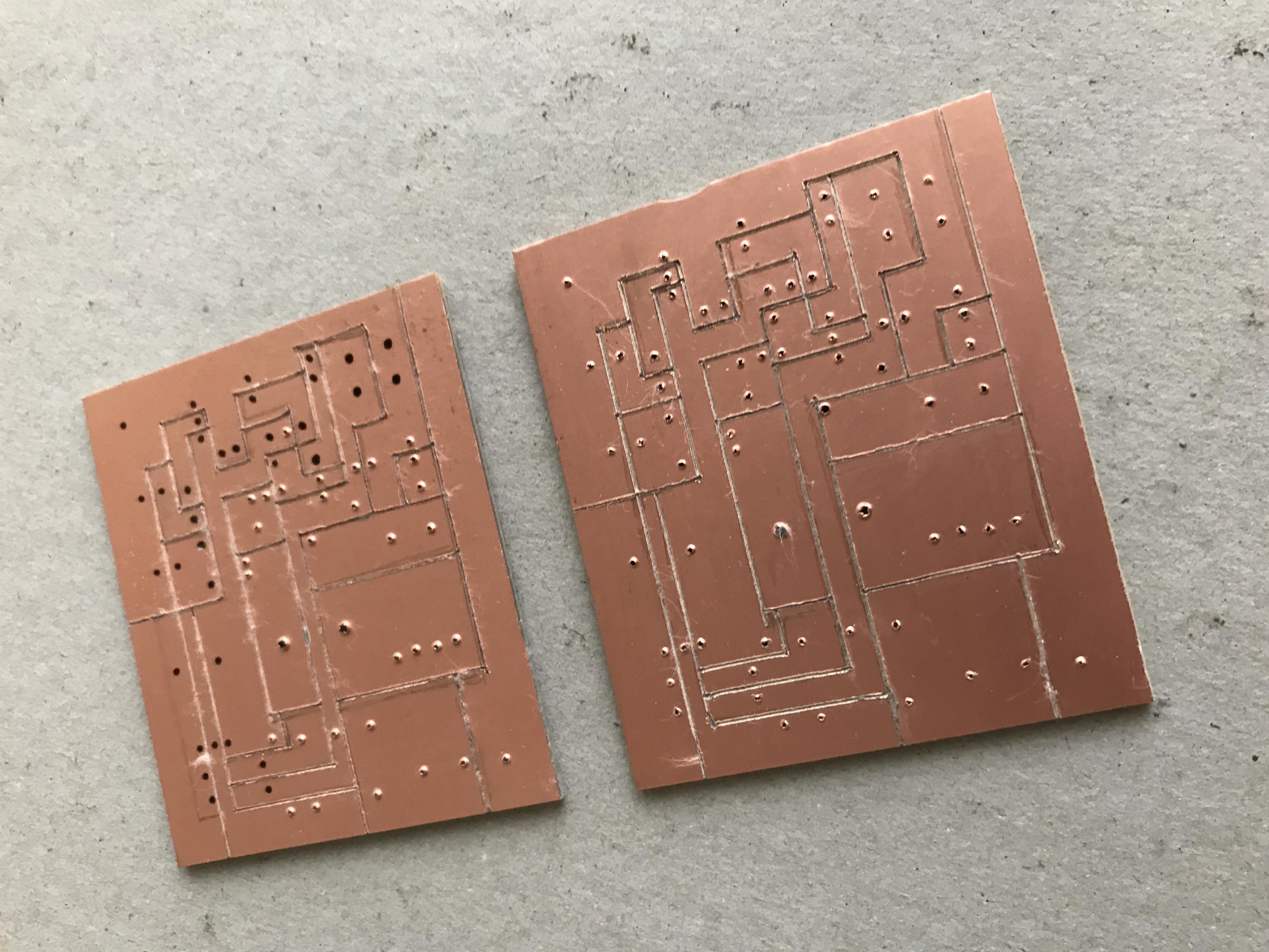

Here’s my ACA pcb - made using an engraving bit on my rotary tool but I guess you could do it with a knife. Single layer, Two jumpers. Haven’t populated them yet
No chemicals required

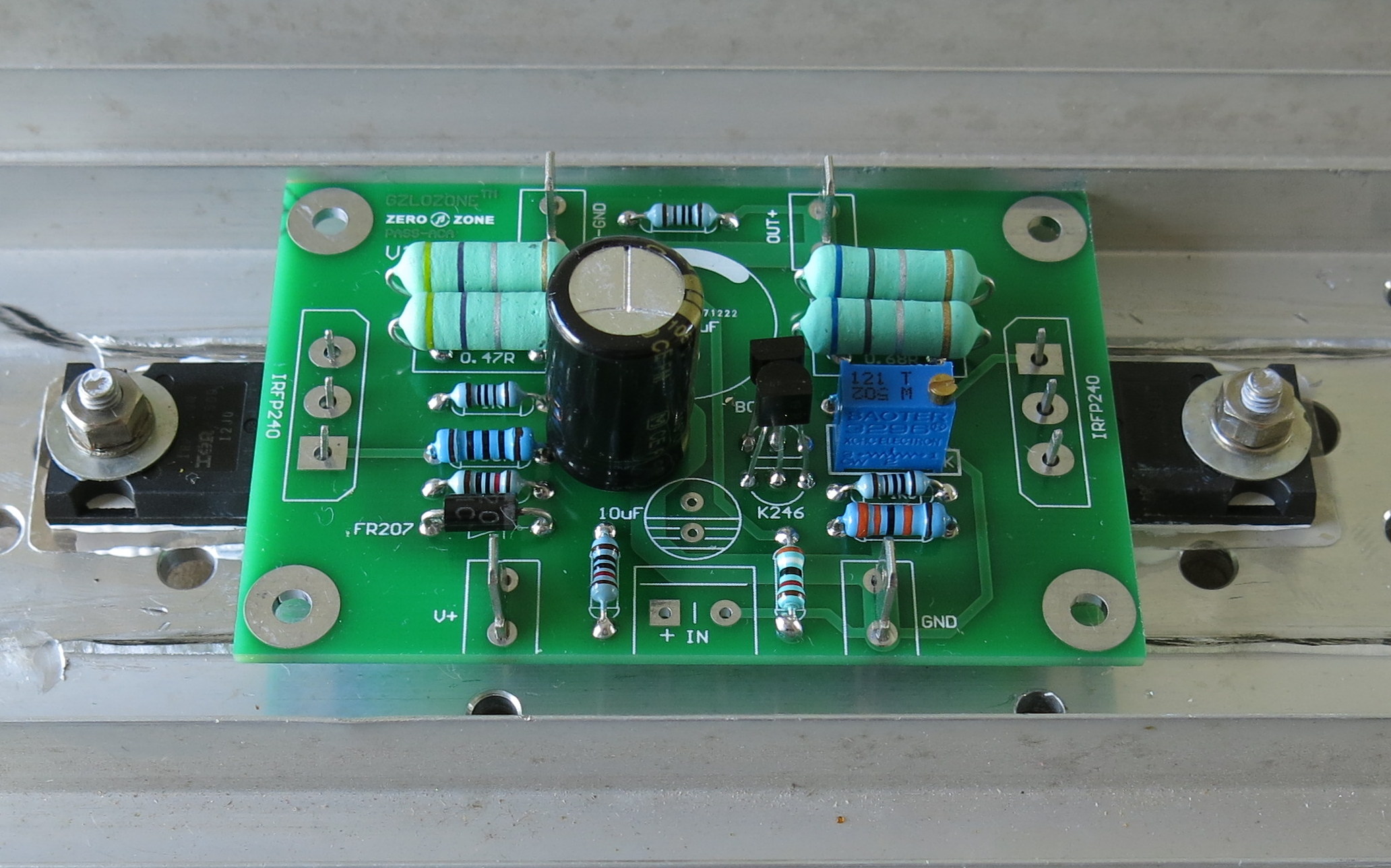

Whats visible is a different layout with awkward placement power transistor, BC550 replaced with ztx450 and 2sk170 reaplced with k246 mosfet and a diode added.
I guess they replaced rare transistors with common ones with the intention of producing cheaper kits without fakes... edit:that mosfet isnt common at all
all other components are the same so the original transistor might drop in.
as for capacitors the nichicons look authentic in the pic at least.[/QUOTE]
I used a pair of those kits for my first ACA build, (The DiyStore kits were out of stock for ages.) and I had that itch...
I ditched all the parts except for the trim pots and MosFets, they tested fine and are still working.
Everything else I replaced. The ZTX450s are easy to find and cheap, the 2SK170s were available in the UK at the time too. Just be aware if you do use these devices in the 'copy' kit you have to reverse them both and not follow the screen print on the boards. You can just see that on the picture.
The limitations are the size of output capacitor you can fit on the board, they are much smaller than the official ACA boards, and no space for 2.2K R15 as stated. You need to fit it to the rear which is easy enough.
They perform identically to my proper ACA 1.6 kits.
The last picture shows the £5 Chinese 24 volt SMPS I used / use.
Cheaper than all the parts to build a linear supply and again has worked flawlessly. I even tried a 10,000uF cap across it, but found it just as good without...
If you do go the linear route, don't forget each board needs 1.5 amps (class A) so build at least a 4 or 5 amp supply.

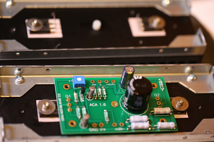

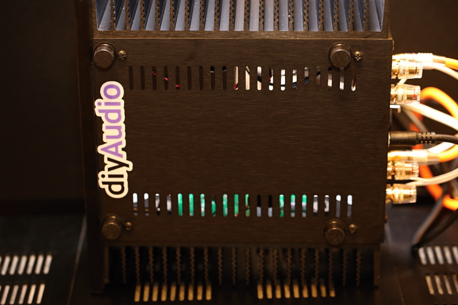

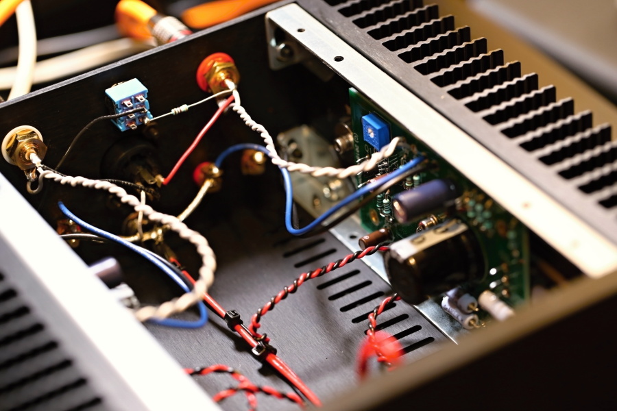

Finally did it! I figure as a degreed EE if I can't build this I may as well just hang it up and quit my job in shame. I had almost no experience soldering but I was surprised how well it all turned out. I had a little trouble soldering the barrel-type connections like the power jack and RCA connectors; I was concerned about them falling out, and it took a few tries. Tabs are much easier. I also had difficulty mounting the LEDs, the heat shrink method didn't do it for me, but Gorilla glue did. I also realize I should have used heavier gauge wire for the power to the boards.
I feel like a young kid again, listening to this incredible class-A sound from something I put together. I connected it to my TV's fixed-level audio out, and the TV audio input is fed by an AppleTV streaming music. As such I didn't have a gain control (!) and it's just a line-level signal but surprisingly I got a decent room-filling volume on my efficient 99dB Klipsch Heresy speakers.
My next step will be to pull the jumpers on my NAD integrated amp and use that as a preamp and get proper preamplification and a volume control.
Thanks SO much to Nelson Pass and everyone here for making me feel young and happy!
