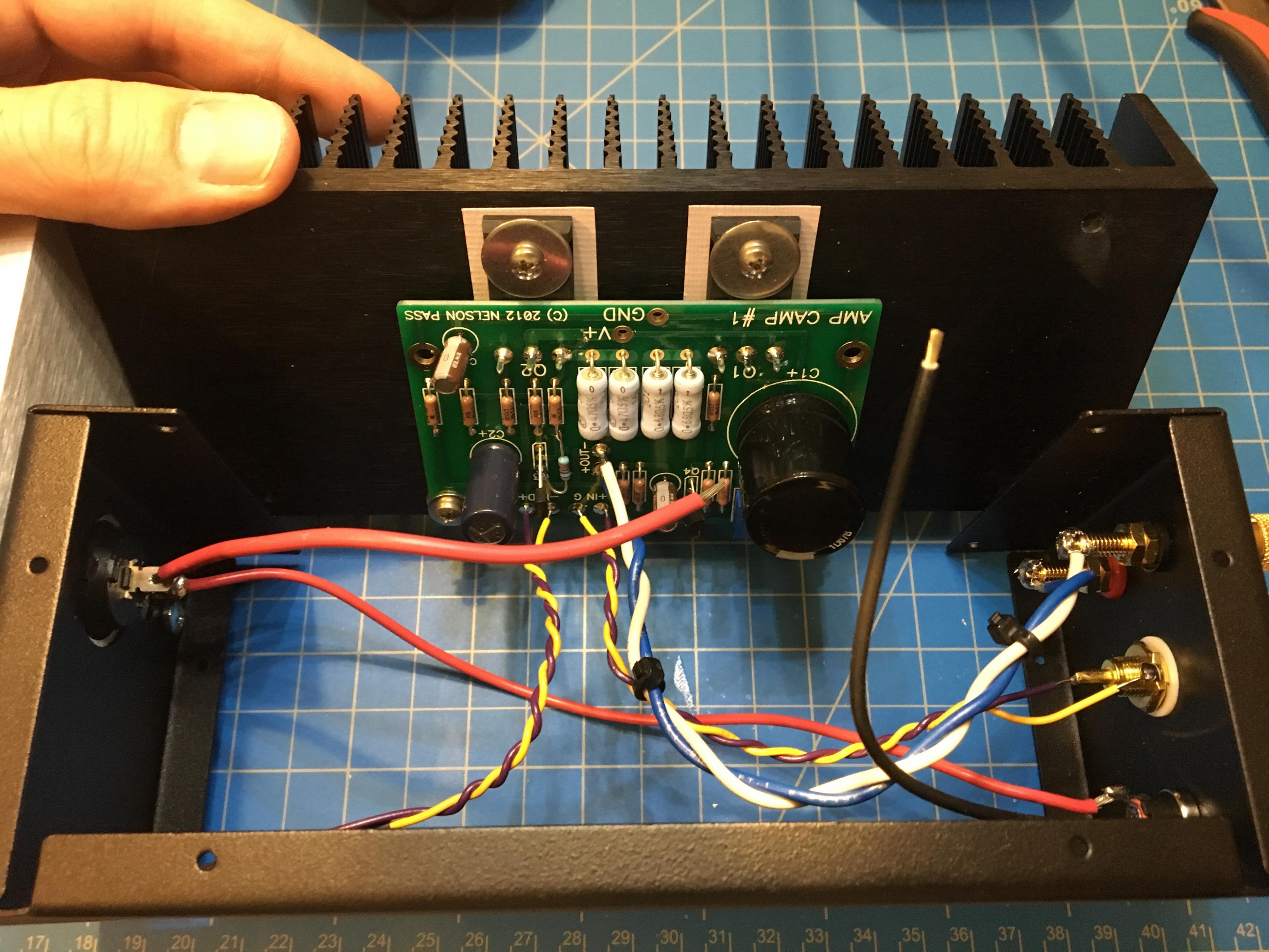

I am planning to build the standard ACA 1.6 monoblock balanced inputs, and everything I have purchased already maintains the values in the schematic.
Good! That will work well.
Mine will be standard ACA 1.6 boards only modified by changing the electrolytic caps to more musical ones.

This is the question: Extreme Boky posted his system changes and he has C1, the output coupling cap, beefed up to 10,000 uF in parallel with a 2.2 film cap. I can get a suitable 10,000 uF cap in the musical (series II Gold Tone KG) Nichicon series, and I can get a nice and not gigantic 2.2 uF metal film cap to replace the circuit's C1 as specified.
Sound like fun. Fancy parts are pretty.
Because of the parallel arrangement, the overall capacitance at the C1 spot will be low, but the capacitors will be able to hold a lot more current than the 3300 uF cap specified in the schematic. Would this be an adequate solution to the, so far only potential, issue of not having enough current available at amplifier level to cover the needs of my 5.9-ohm speakers?
It's not going to make one bit of difference.
That cap is there to block DC and to let AC pass. That's it. The capacitor is not a PSU reservoir or filter cap that can act as a reservoir.
The circuit needs to have a number of points set to various DC values to operate, and that DC can't get to the speaker. Remember, the music is all AC. (It's a wave, right? 🙂 ) The coupling cap is there to let the output node of the amp live happily at 1/2 the rail voltage so the amp can increase the voltage above this neutral point when the speaker needs to be pushed out, and to have that same node go less than the 1/2 rail voltage when the speaker needs to be pulled in. However, the only thing that the speaker needs to see is the swing across the node (the AC) and not see the bias voltage (the DC) The coupling cap does this, as a cap will block DC and let AC pass.
As for more current, all you could do is have a really big power supply - a PSU that will have MUCH more power than the output transistor can pass. Luckily that's already been thought of, as the supplied bricks are 150W for a 5 W amp. 😱😀😱😀
Please let me know if this is a viable solution to cover a potential and occasional need for increased current availability from the amplifiers. This is something I can do with no problems, is it a reasonable thing to do?
TL;DR - Increasing the value of the coupling cap will not change the current delivery of the amp.

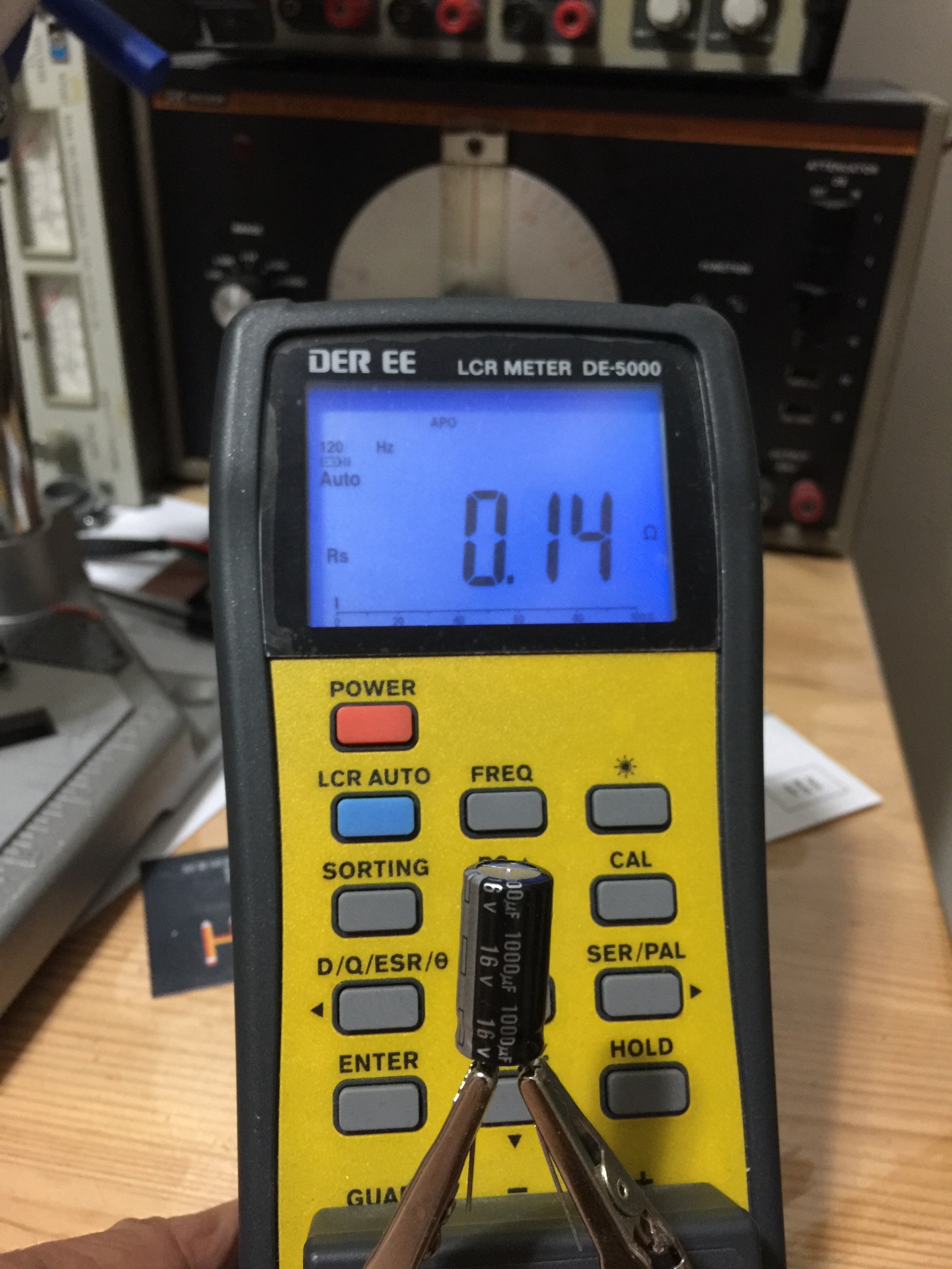

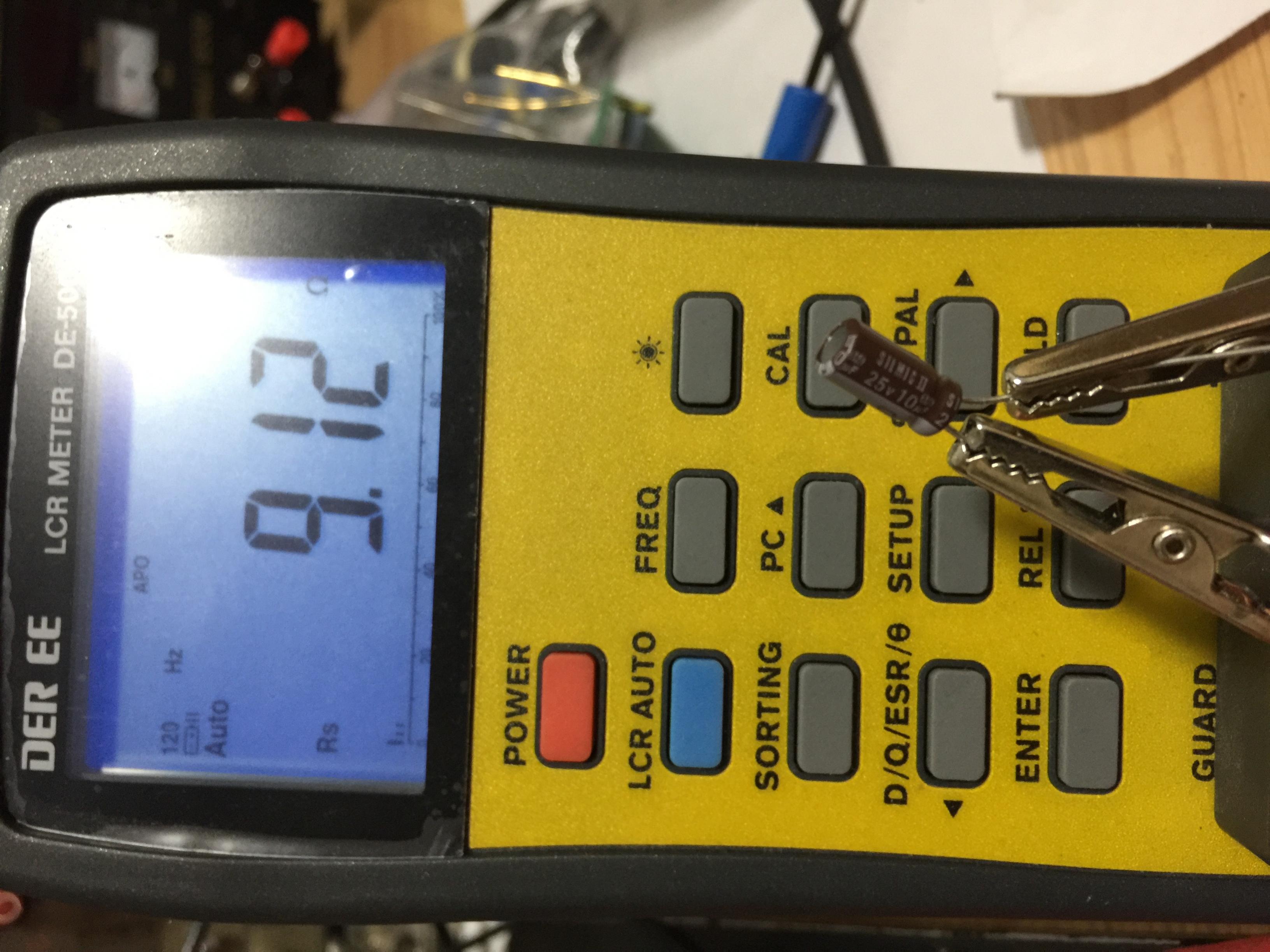

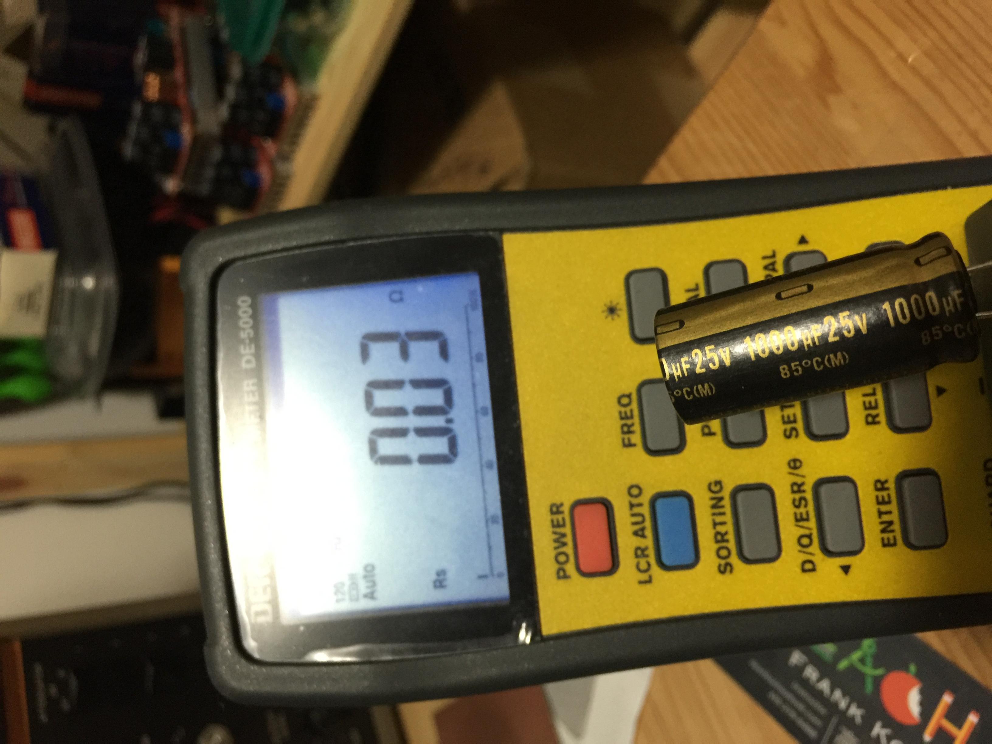

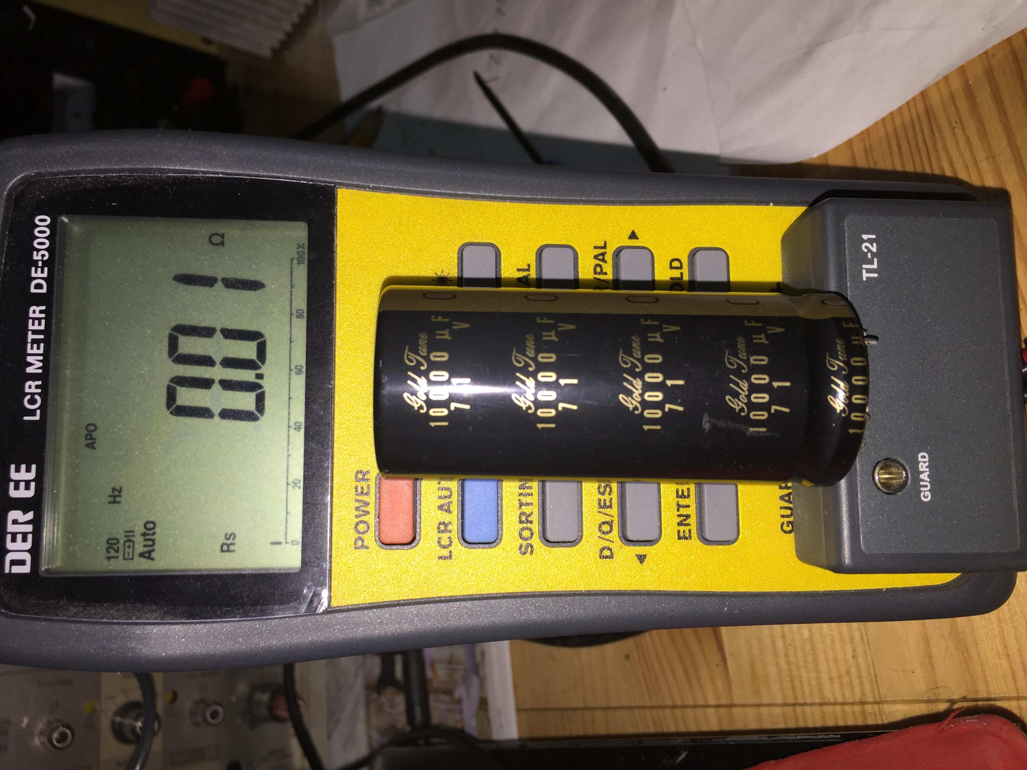

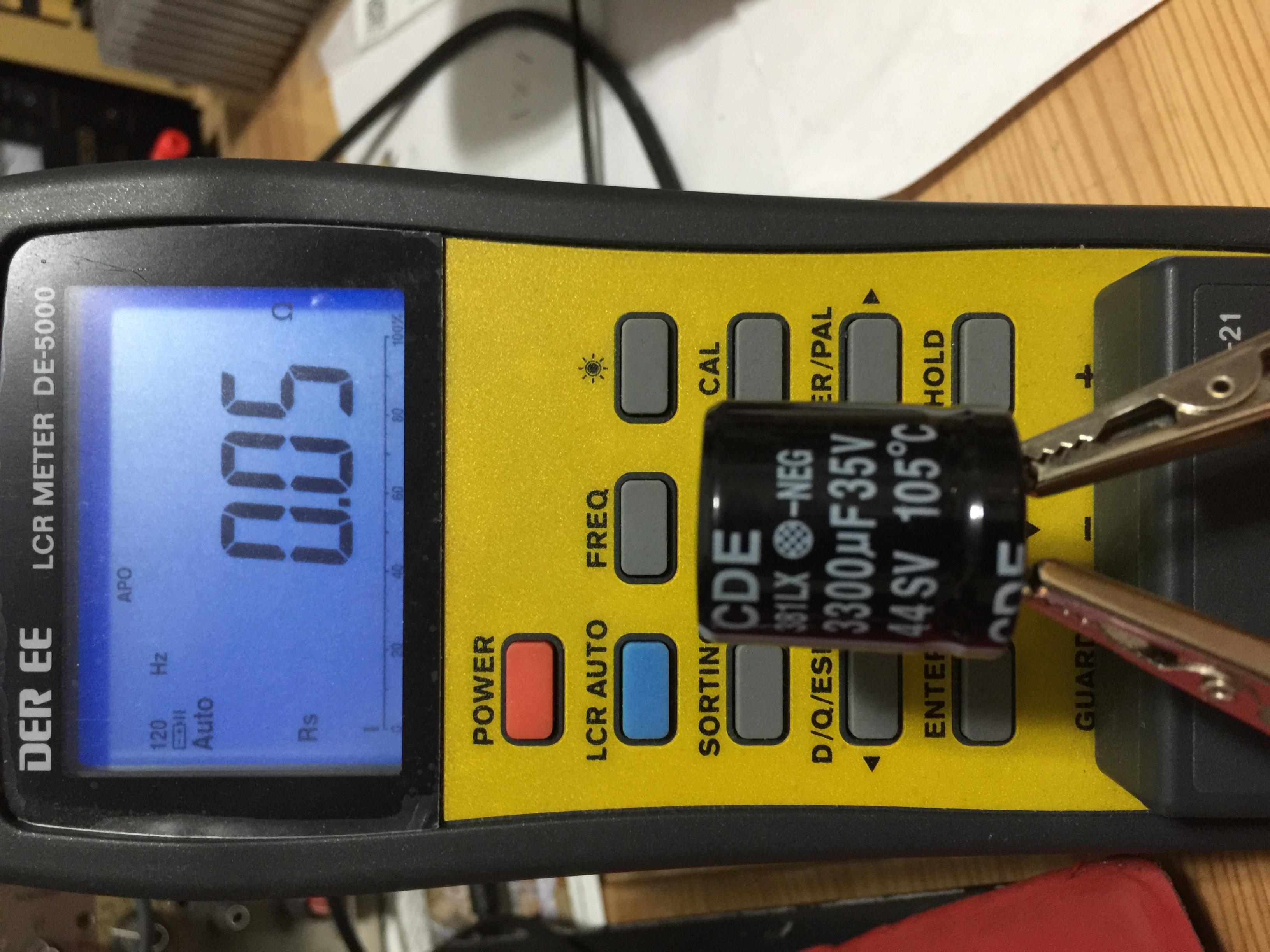

ESR TEST OF 10uF and 1000uF
One of the qualifications of a high-quality audio capacitor is ESR and lower is supposed to be better ?. This is what I found comparing Nichicon, and the kit caps. When trying to get fancy larger big-name capacitors will you changing amp camp amp smooth tubey like sound for a more sterile fast acting sound?. I guess this is what experimentation is for an exactly what this amplifier in brings out the tinker in every person learning by trial and fire 🔥. Every time I read one of my questions get answered 10 more take its place. Look at the photos below my tester for an ESR meter DER EE DE-5000 Below photos show the capacitors been tested

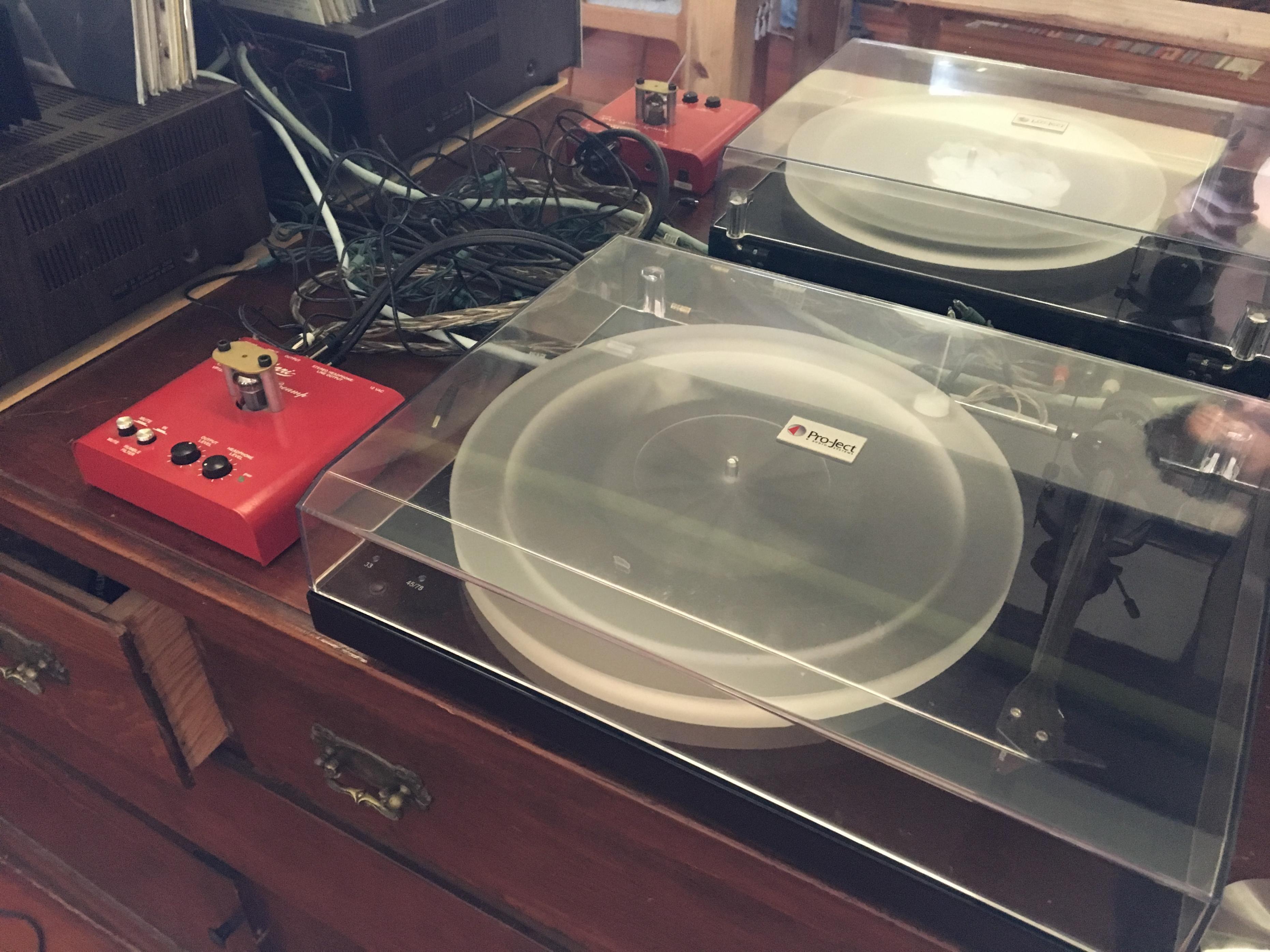

Hello, all,
I've been lurking around these pages for a while now. I purchased the ACA v1 kit about 5 years ago and finally built it this summer. I'm a complete newbie when it comes to electronics, but the ACAs are working and haven't gone up in smoke (yet)! The ACAs are driving the Fostex 206e drivers mounted in back loaded horn enclosures. Initially, I must say I was a a bit disappointed in the sound. It sounded pretty flat and lifeless compared to my trusty old Marantz 2220B. However, after running the ACAs for a while, and introducing some EQ to the signal, I'm really starting to dig the ACAs. At this point, I'm just playing Spotify from my computer direct in to the ACAs and it's sounding great.
However, I'm having a heck of a time getting my turntable to work with the ACAs. I have the turntable going in to a Bellari Tube Phono Preamp, which is going in to the ACAs. This is generating a terrible hum. I assume it's a ground issue of some kind, and I've tried every configuration of power sourcing (plugging all components into the same outlet, different outlets, etc.) that I can think of with no luck. I'm perplexed because I don't have any such problem when using the Marantz to drive the speakers.
Has anyone else run into something similar with the ACAs, and if so, any suggestions? I haven't been able to find any posts that address this issue, so posting here, along with a few photos of the setup.

Google “bellari tube phono hum” and you will find this is a very common issue especially for one’s manufactured during a certain time period. I believe bellari used to fix them, but I don’t know if that time has passed. Some people even pick up radio stations with them. But lots of people like them, so...
Try orientating it differently, maybe keep it away from the ACA’s more, meaning more distance. Even replace the cheap wall watt plug with a new plug... those are the things that have worked for a lot of folks.

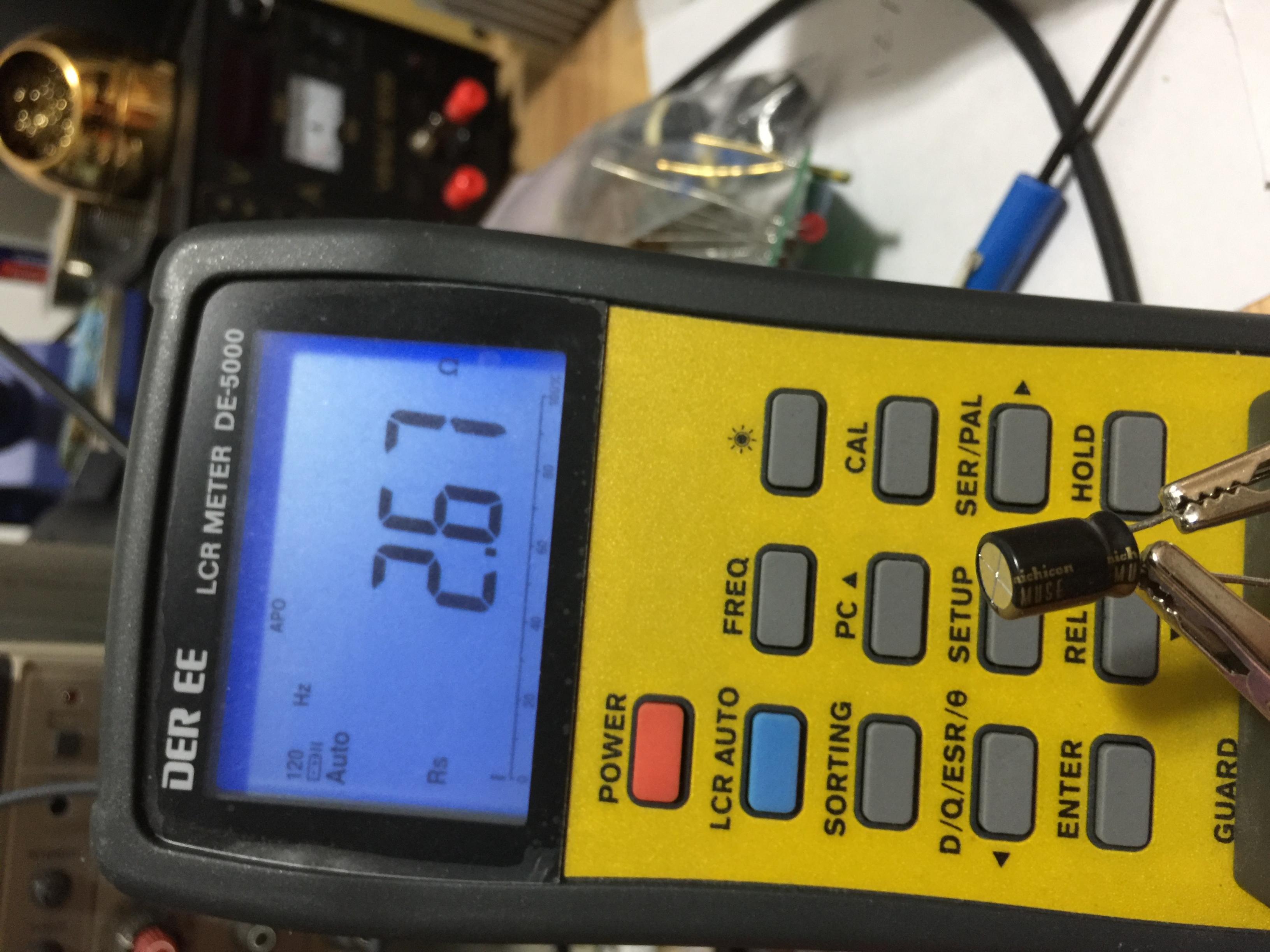

C1 cap test ESR
extreme-boky. Yes I have read about the exotic capacitors was thinking of using any more reasonably priced and sized film capacitor but decided to stick with what fits on the board and later do some A to B testing. I have three set of the early Amp came PCB from a few months ago, I built my stereo version with BOM then started playing by substituting parts from other projects I had and parts that my instructor from class gave me from electronics 101 . Working on the 1.6 right now slow progress and for testing I’ll build another 1.6 version ( extremely modified with a few in unobtaintieum NOS )Parts. Will build with the kit components and do A to B comparison with the switcher.
Here are some of the measurements I found on the C1 cap.
6L6 information that C1 is just to reduce DC or (Block) doses this work on the same principle as a power supply?. When you want to reduce Amp ripple? Where one capacitor is good but three smaller ones work better?. Because each size has a different “ banpass?” Frequency ? Not sure that’s the right word to use. Should a CAP ment and designed for a power supply may have a edge in place of C1 ?. Is this one of cases where CAPs of three smaller, different materials , electrolytic, Tantium , foil ?. From my reading about power supplies and cleaning power. I’m a nube still learning. I know we are playing with a little economy sports car and we are trying to turn it into a Ferrari. But it’s fun learning and you don’t get all greasy and bust your knuckles.
The long blue Cornell Dubilier Is for high-speed switching power supplies according to their data they brag about being ultra low ESR .

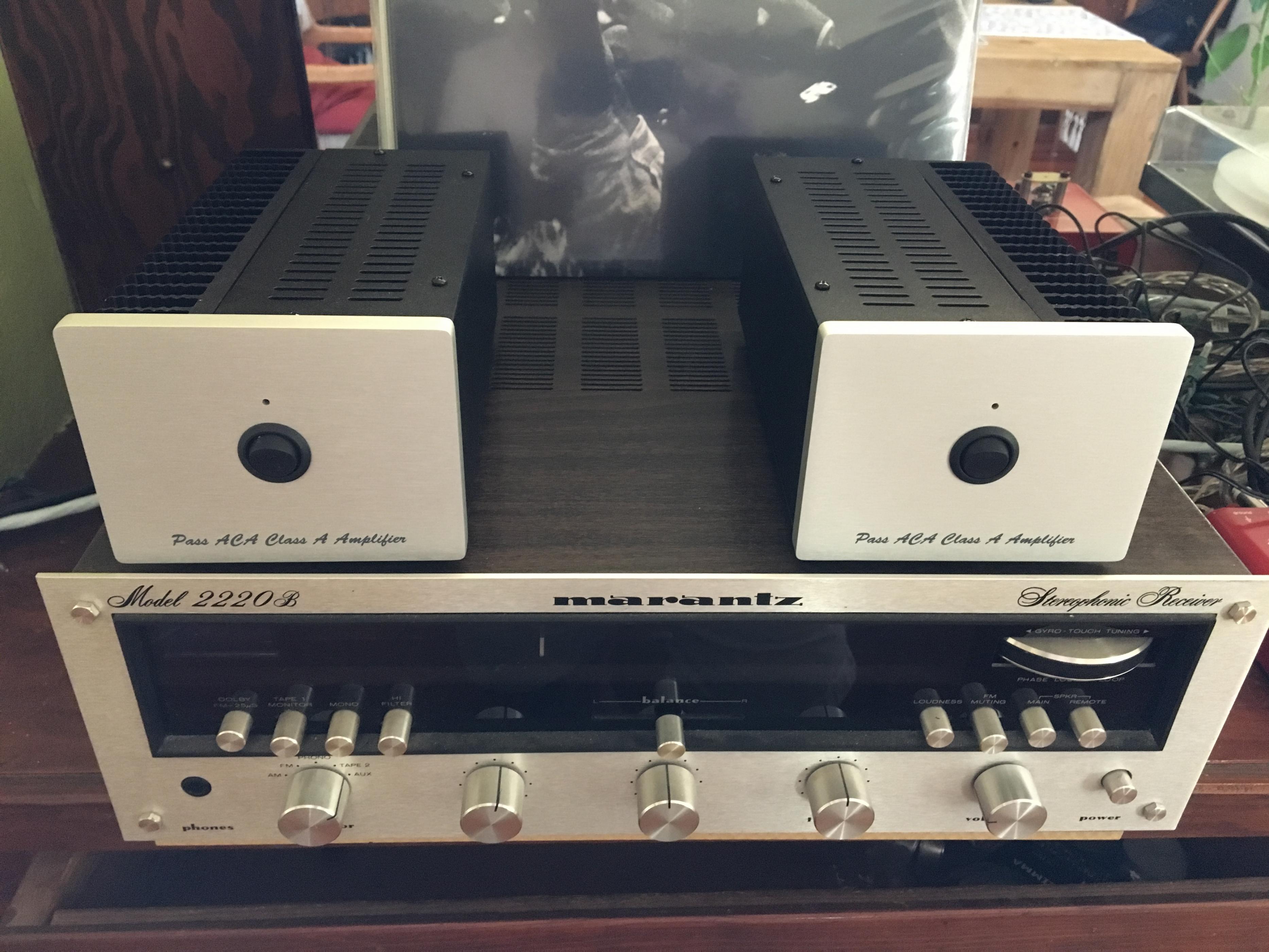

1. move the ACA's away from the receiver. the receiver transformer may be causing interference
2. Untangle the cables; separate mains cabling from low-signal interconnects. Use well-shielded interconnects between pre-amp and ACA's
3. Use a well-regulated DC power supply for the pre-amp, instead of a 12v AC power-pack
