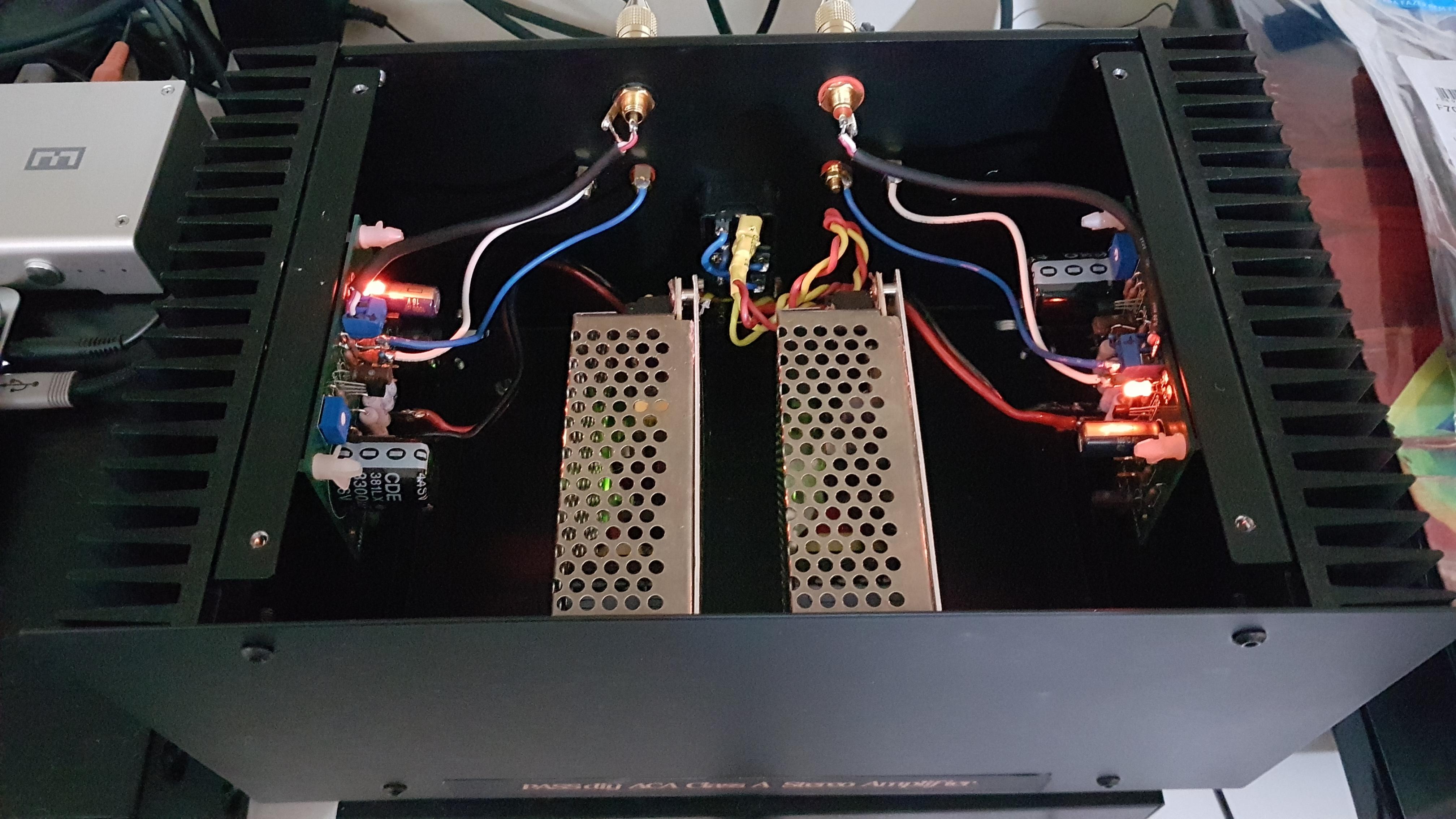

It is. I am powering my ACAs (1.5 ? Version) with one 24V 5A SMPS per channel placed inside the (somewhat larger) chassis with absolutely no noise.

Some generic low cost that I had. Tried them on to test the ACA with 24V (my kit came with the 19V ones) and there they stayed. A linear PSU was noisier (transformer saturation, maybe?) so I'll keep the SMPS for the moment.
