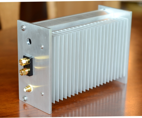

if this amp were to be built in a different enclosure how large of a heat sink is necessary?
no change needed. The heatsink is sized for the amps heat output, not the case.
In the ACA article Nelson suggests a heat sink of 1 degree C per Watt for each channel. That keeps the temperature rise to about 25 degrees C.
..... how large of a heat sink is necessary?
just dont make it smaller
and notice, its one channel
That original Amp Camp chassis as in the photo above, stays very cool since it radiates from lots of thick extrusions in addition to having a quite large heatsink. NP had no hand in its design.
We supply smaller extrusions for the kits (215mm x 75 x 35) those work fine too, in temperate climates and if the amp isn't in an area that's enclosed in any way. My experience is that the micro-climate (is it under a low shelf above?) and actual climate (do you live in southern India? ) are the big determiners. A hot interior room temperature could easily double the amount of cooling needed.

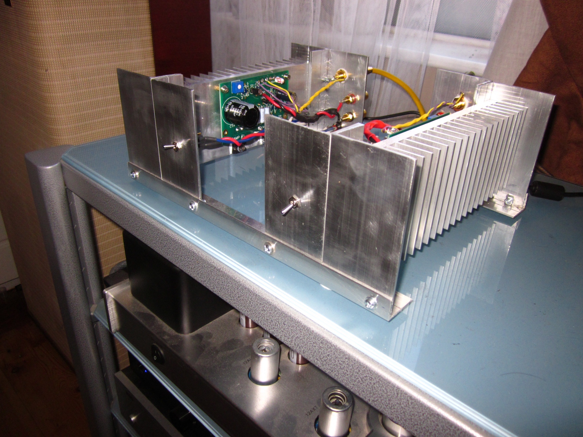

Ok got this finished at last. Couldn't trace the mains hum I was getting on one channel but after discovering it went away when the two mono blocs touched the way forward was obvious 🙄
Apart from the kit and sinks from the store I spent £10 on aluminium angle from a hardware store and £10 for two pc power supplies on the bay uk.
The amp sounds great....great power, bass and massive detail. Probably loses just a little smoothness in the mids compared to my tube/valve gear but not by much. Amazing amp for the build cost. The amp is dead silent between tracks and the sinks get warm but still ok to touch after 30 mins. I'm driving 15 ohm speakers with it....anyone know if it needs optimising for this load compared to 8 ohm? I got some spare boards and will probably have a go at a version with a "proper" power supply at some point. Anyone got any thoughts on a power supply?
