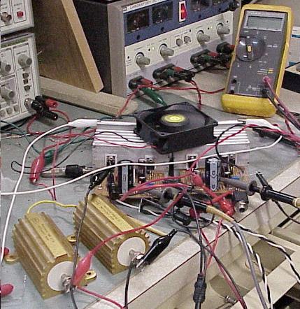

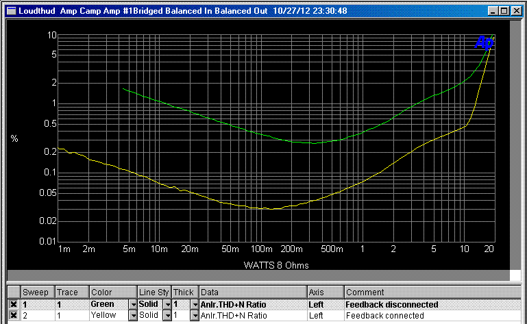

I got a second channel up and running. On each channel I installed a 1K resistor from base to emitter of Q3 with a jumper so as to increase bias current to about 2.2 amps. For some reason the DC adjustments of the two channels interact even though separate power supplys were used for each channel. The output caps, C1 are still in place.
For this first test I just used the balanced in and out of the Audio Precision System 1. I'll try other ways of connecting a single ended signal source in a day or two.

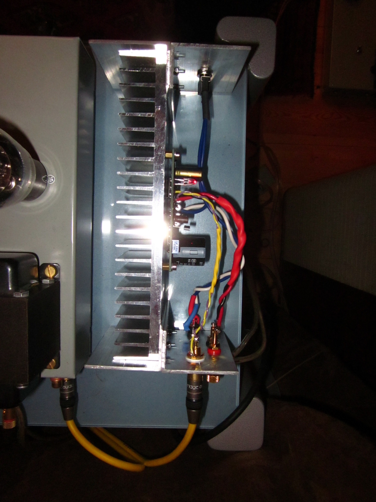

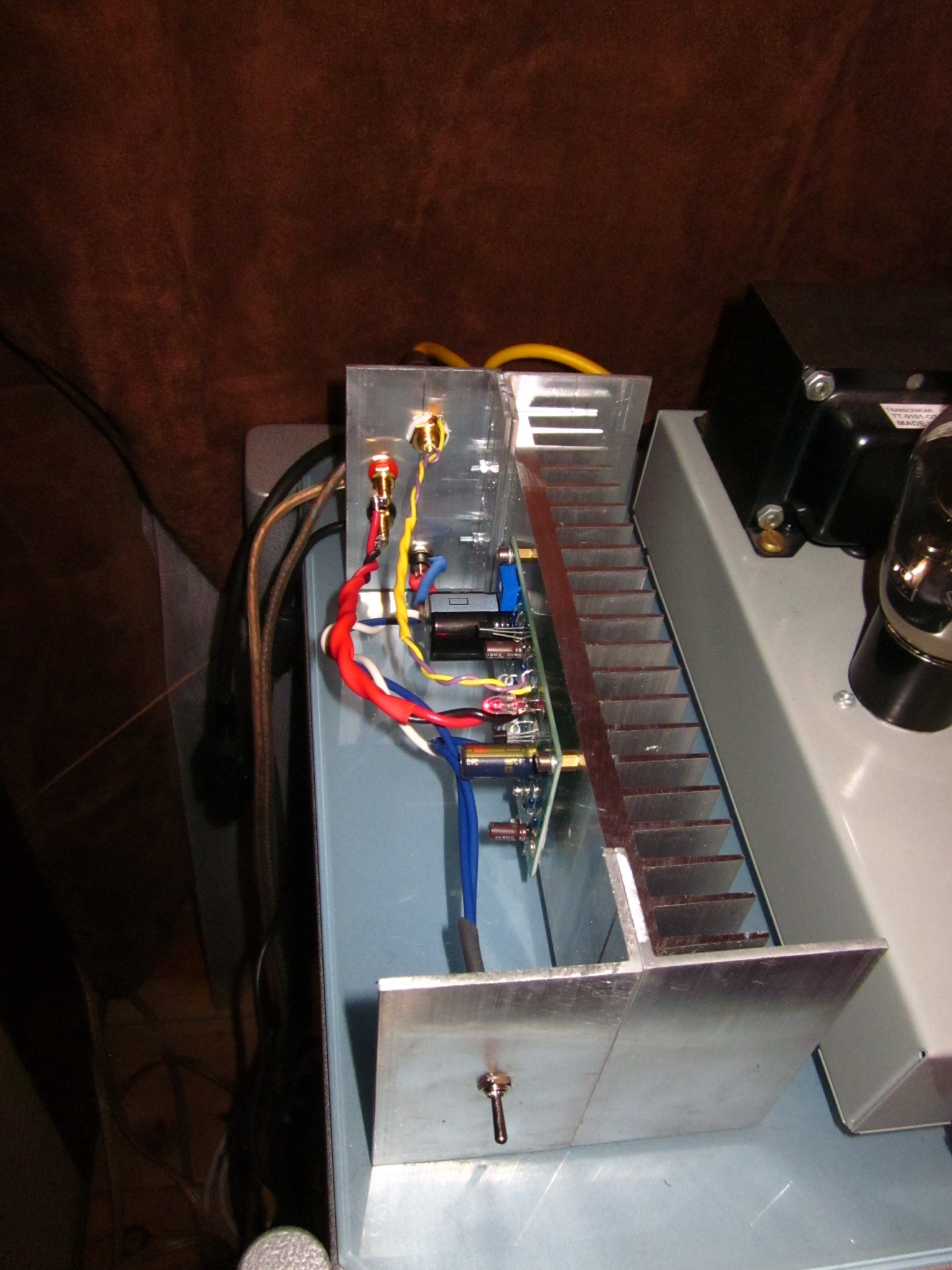

Been working on these this week after work and finished wiring one up tonight. Seemed ok on a dummy load so I hooked it up and even on one channel sounds sweet. Still need to adjust the voltage, finish wiring up the second mono bloc, finish the cosmetics etc. I will post more thoughts when completed.

What I am interested in is what is it hooked up to as a power source? A block of iron and a tube rectifier? Look very hardcore power source wise...
Sorry no mega power supply on this build. It's a standard build with one pc power supply per channel 19v 3.5A. I am using a toob pre but what you can see next to it in the pic is my Diytube GetSetGo power amp. Will be interesting to compare Jfet to 6B4g SET power....
