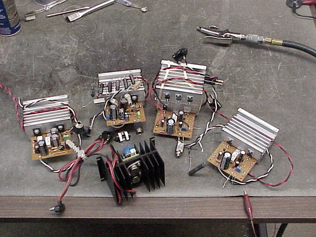

Along with the higher transconductance comes higher input capacitance. I tried IRFP460s and the results were poor. It could be that R6 needs to be lower, I didn't try that. I tried running three Q4s in parallel with R9 at 220 ohms and the results didn't improve much. Q1 becomes very non-linear as the Drain voltage dips below the Gate voltage. Visible distortion at 1kHz. At that high a rail voltage, you will need gate protection zeners. I'm going the other way. Next I'm going to try IRF120s. Suggest you search for my posts in this thread.

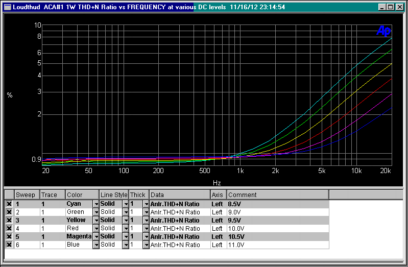

I was noticing some inconsistancy in the numbers I was measuring. I discovered that the distortion changes significantly as you adjust the quiescent voltage pot. Below is a plot.

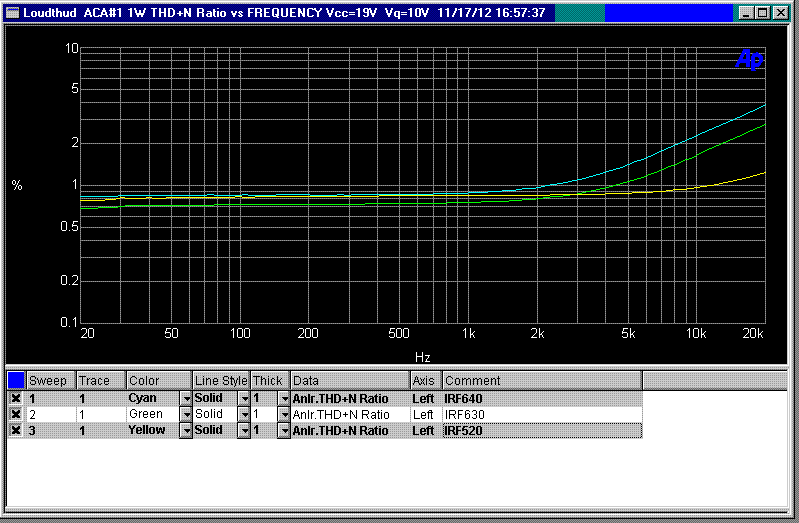

Trying different Q1s made a difference in the distortion vs frequency at 1W graphs. I also plotted the open loop gain. You can see that the smaller FETs have less gain but wider bandwidth. The smaller FETs don't change the low frequency distortion much. I think this is because the FETs are made of small cells in parallel, the bigger FETs just have more of them.

Experiment, have fun. I've built five of these amps, two stock, one with IRF120s and two with IRFP460s and other changes.
