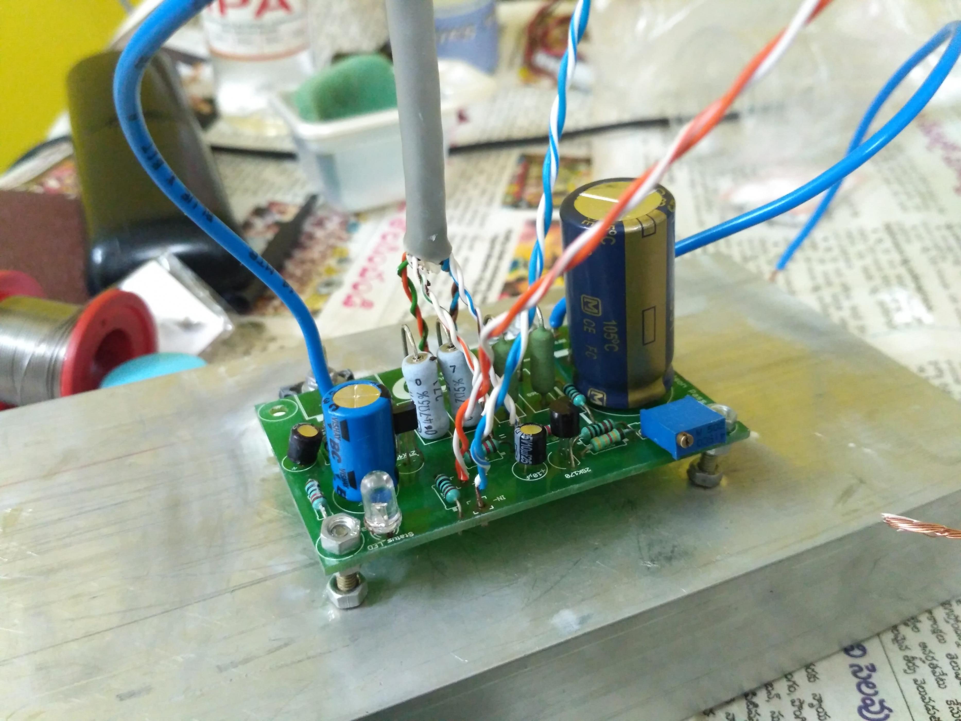

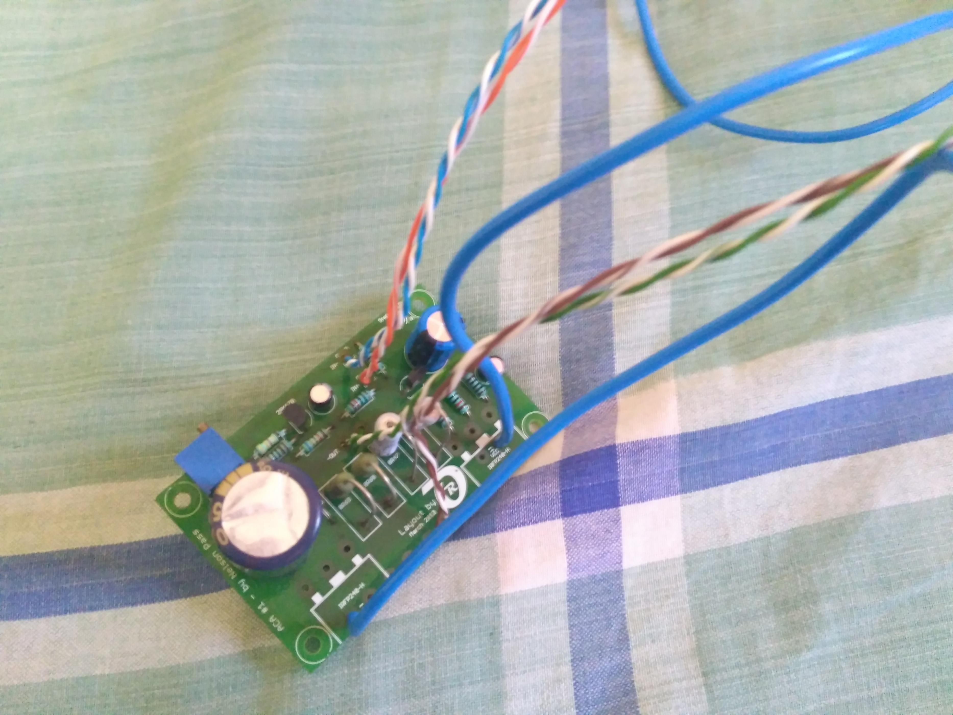

Initially i have taken out the separate twisted pair strands from the cat-6 cable and thought to use them independently for each input and output points..
later thought may be if i could use the whole cat-6 cable instead of taking the individual strands out as it looked more protected and secure inside, when used cat-6 cable as a whole.. so as we had 4 pairs available i used used one cat-6 cable for each channel (mono block)..
So shall i take individual twisted pairs from the cat-6 cable outside and twist 4 strands together and out of those 4 strands use 2 for input positive and other 2 for input negative.
And similarly take another 4 strands and twist them together and out of those 4, use 2 strands for output positive and 2 for output negative (so here all will be individual wires without outer protection layers as in whole cat-6 cable)?
I have separated the cat-6 cable outer cover to get the individual strands separated as in photo .. so now one pair of strands for each input positive and negative and output positive and negative .. is it ok now ..

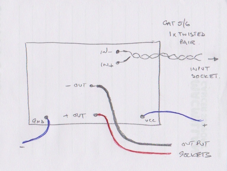

Hi sarathssca,
I think this is what everyone is trying to advise you.
You only need a single twisted pair of CAT5/6 wires for each input. (Say white is - and coloured is +)
You need much thicker flexible multi strand wire for the outputs. Use the same gauge / thickness as the blue power wires in your picture. Red and black in my picture.
Keep the input and output wires apart as much as possible.
Hope that helps, Alan

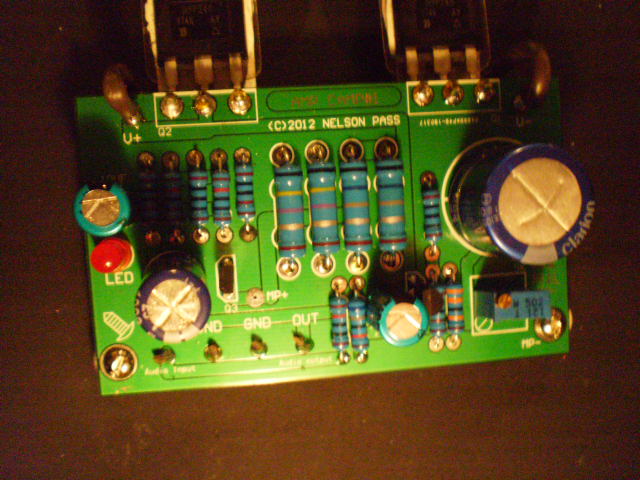

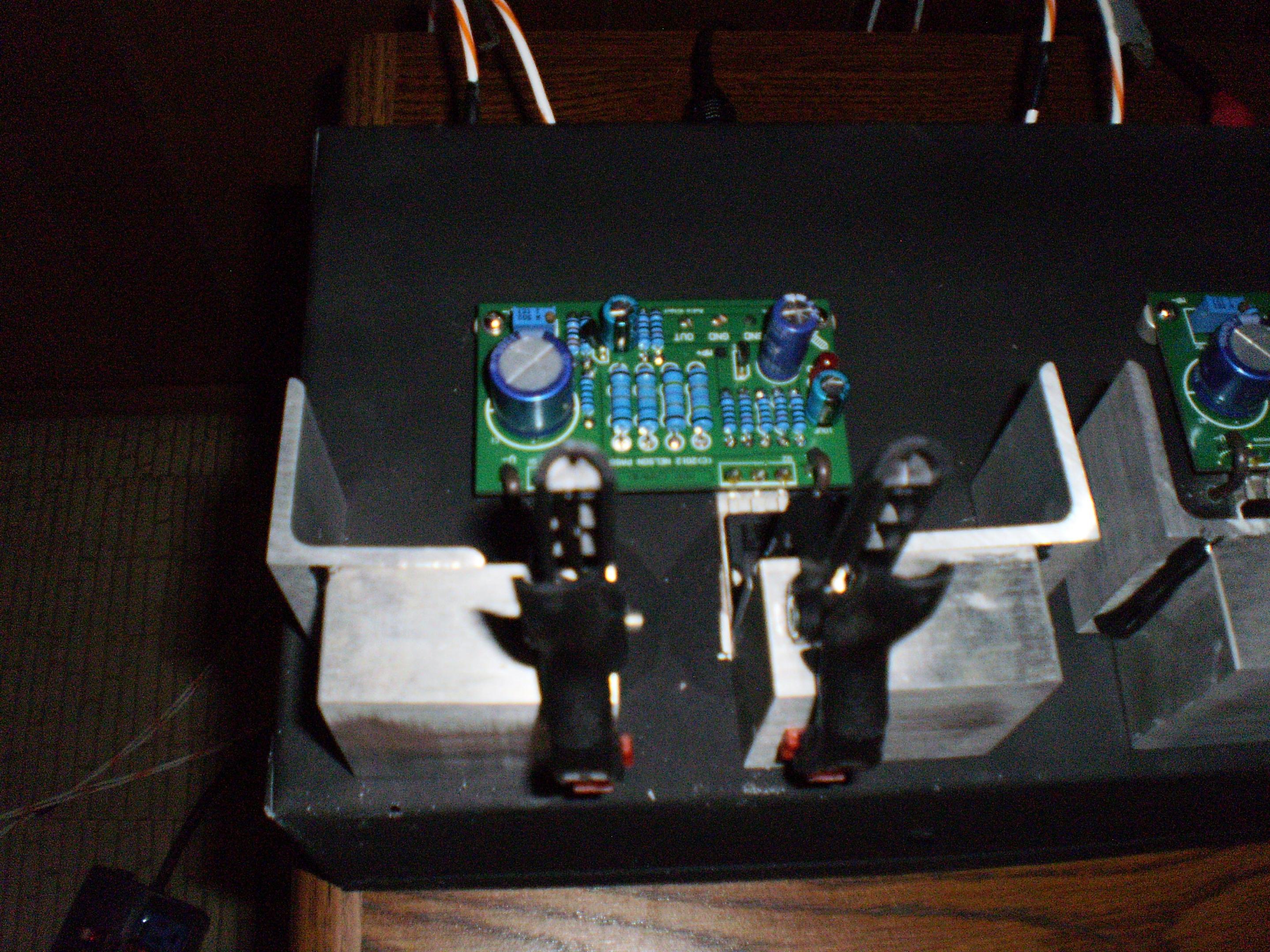

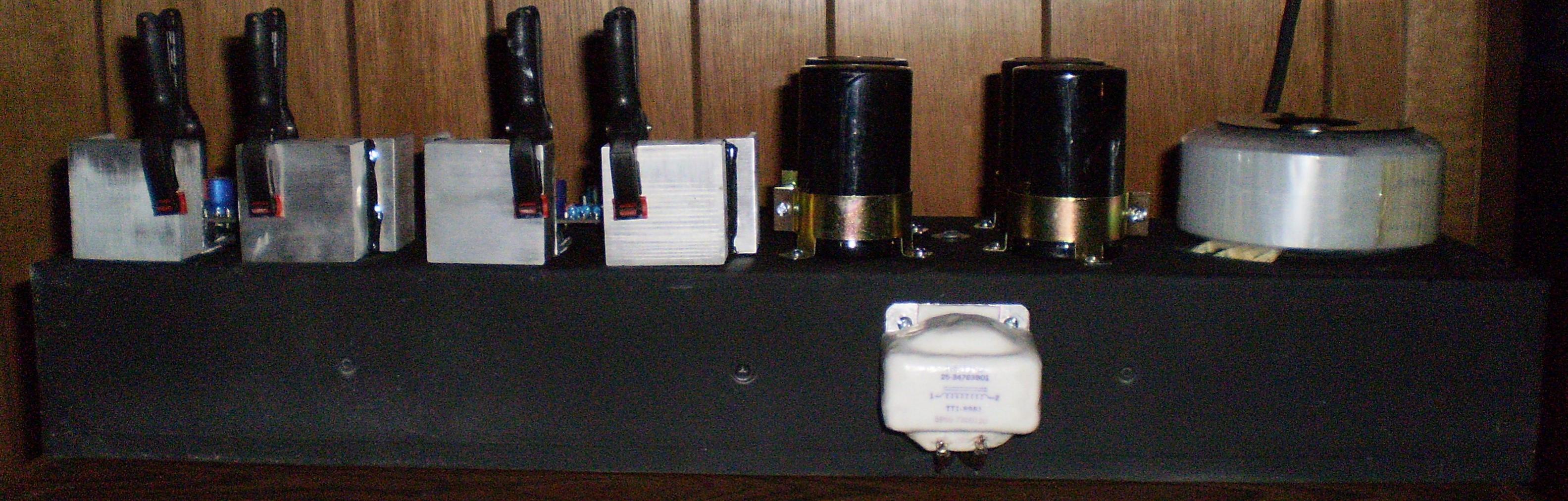

DIY ACA project : measurement data & photos ...
With the approval of Nelson Pass, I can finally present my DIY ACA project.
The power supply features an AnTek AS-2218 PT with dual 18V secondaries.
FWBR into CLC filter with 44,000uF per channel.
The mosfet heatsinks are 2" x 2" 1" thick aluminum bar stock with some aluminum angle pieces for additional cooling. This keeps the heatsinks operating within 25C of ambient temperature measured after 1-2HRS.
THD +N @ 1W = 1.5%, 2W = 3%, 3W = 4.75% with 1KHz test signal.
Power Out before clipping was 3.5W.
Square waves looked perfect at 1KHz & 10KHz.
Subjectively, I enjoy this ACA project on Altec 2-way horn speakers.
The sound is very tube-like with its 2nd order dominant harmonic profile.
dt 667

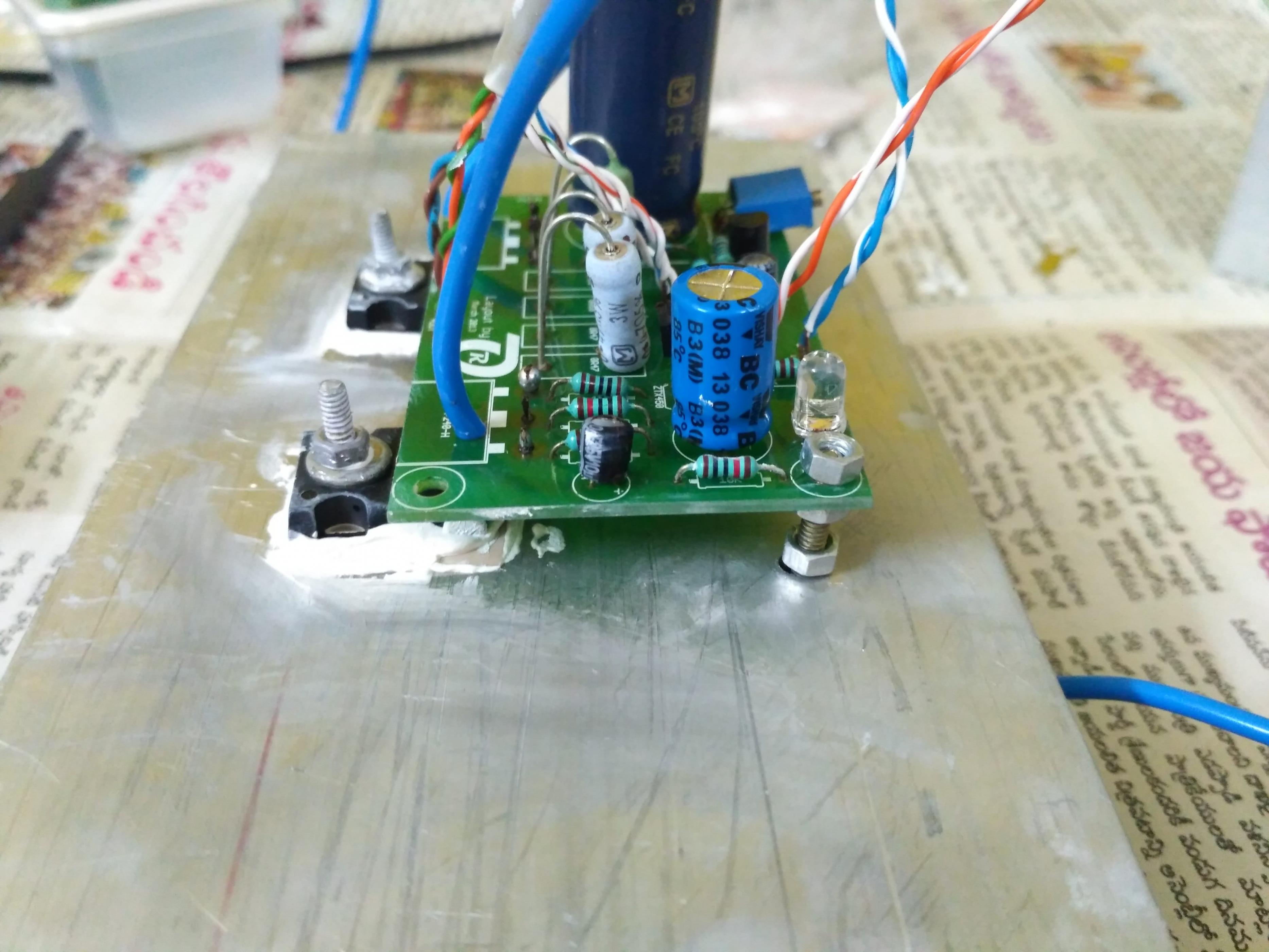

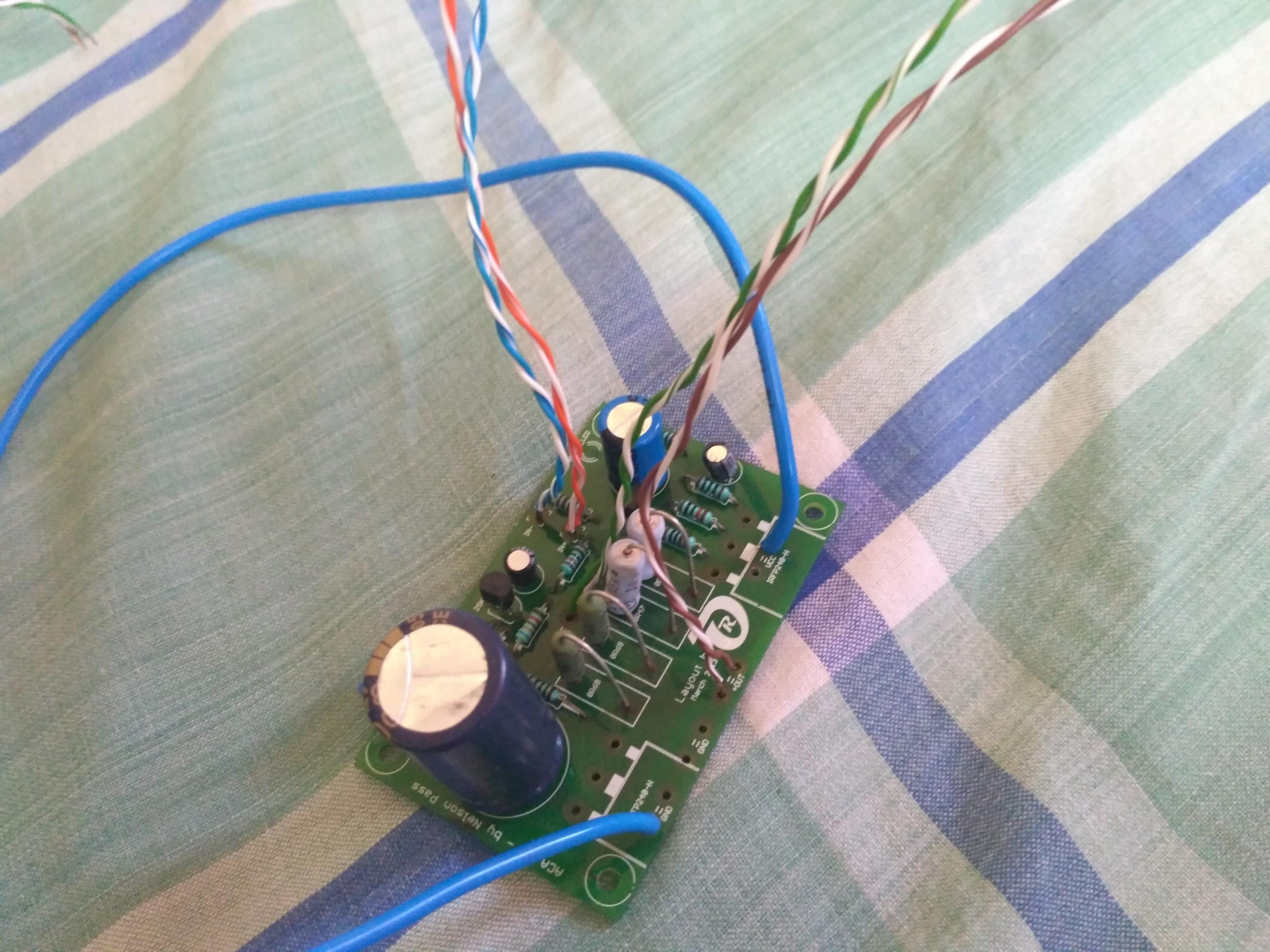

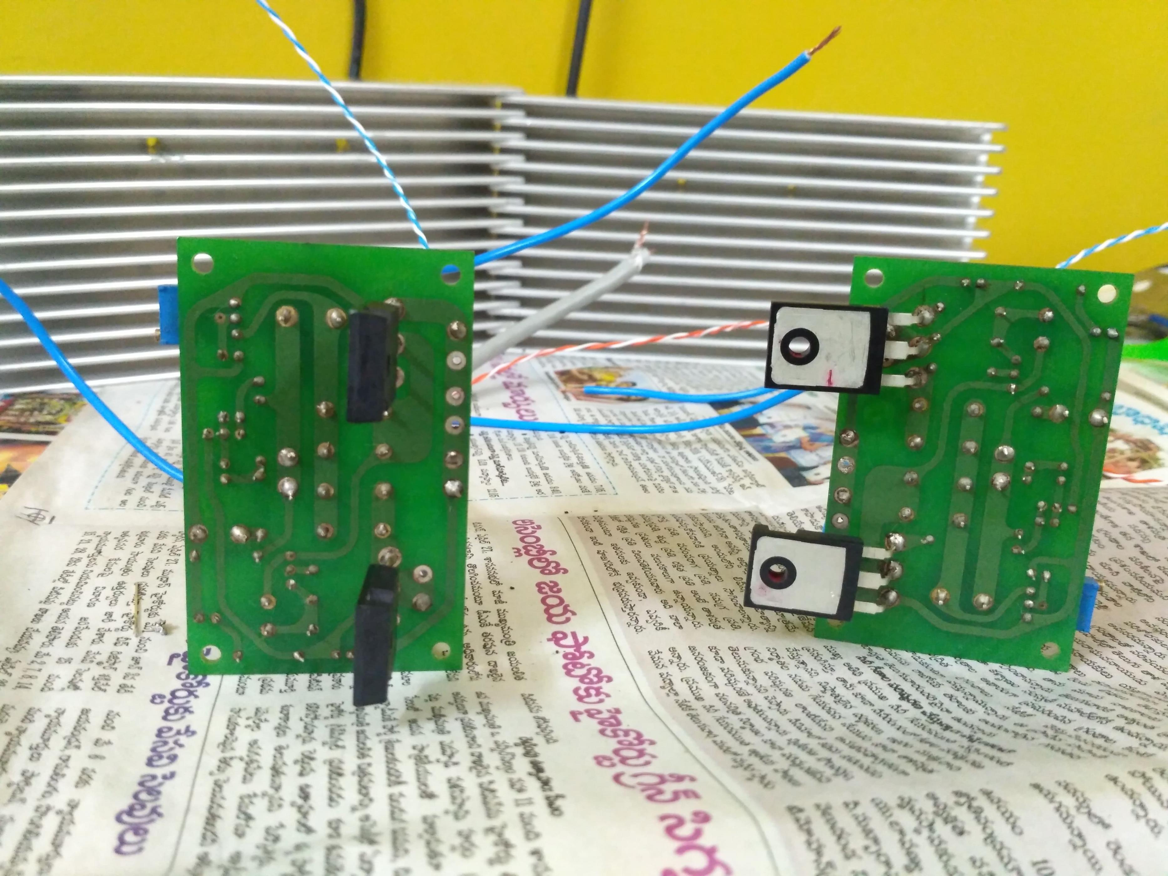

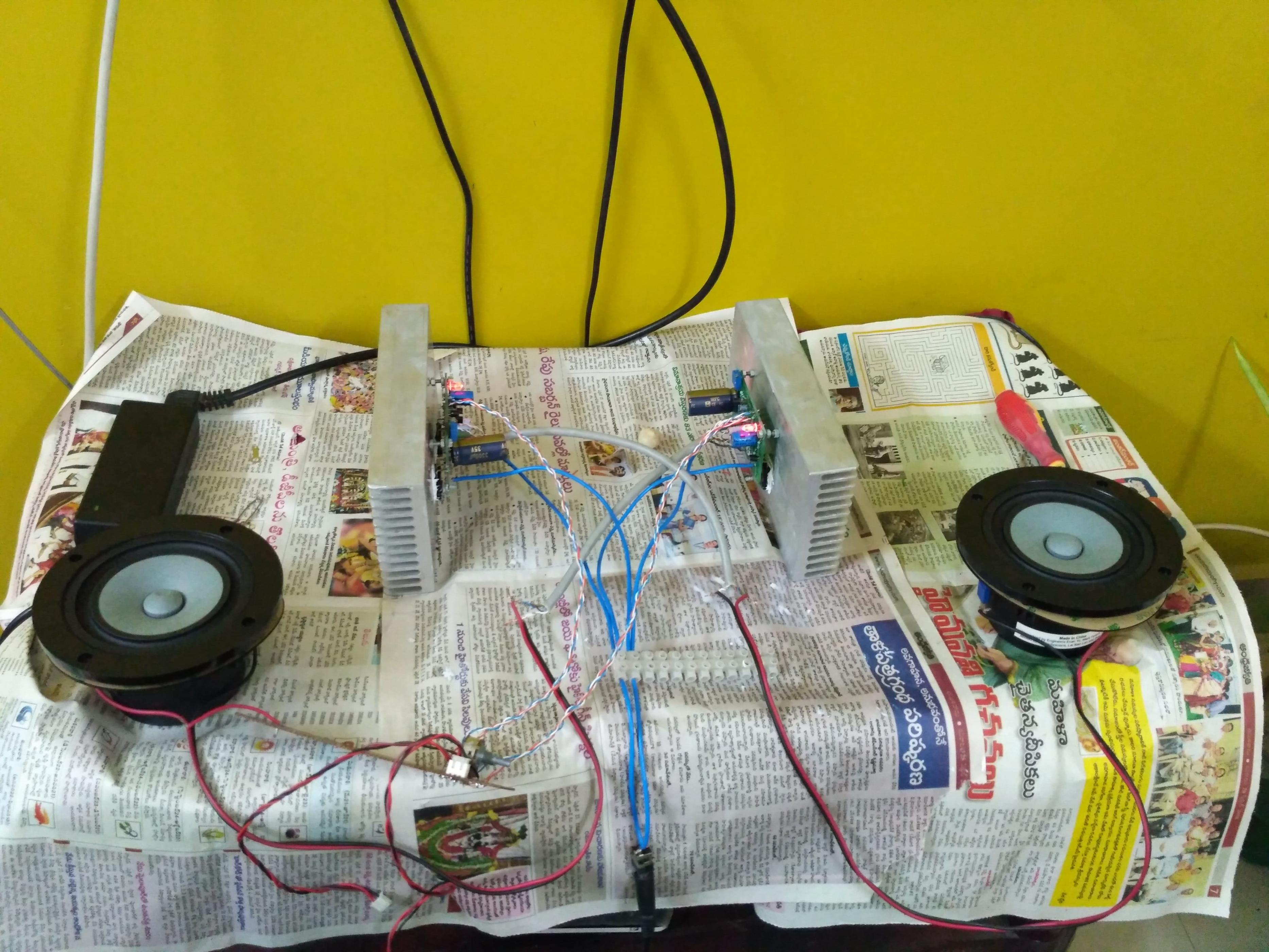

Finally assembled and got the amp sing .. 🙂
- no thump sound at power on or off .. it's smoothly starting and stopping ..
- finally used 4 strands of cat-6 cable for each output positive and negative on one side.. my soldering job little ordinary only
- I couldn't get the bolt/connectors for mounting the board and MOSFETs on the heatsink as in other aca builds here .. I have used normal screw and nuts for this as in photos but faced difficulty in properly fitting the board and MOSFETs. Needed to put the screws from behind the heatsink and put the bolt on top as I couldn't put the bolt behind the heatsink .. also the holes for MOSFETs and PCB were not properly aligned as my heatsink has horizontal fins ..
- my heatsink r of size 190mm *95mm *33mm.. is it ok .. while running it's getting very very hot .. i haven't done any mod and these r running on 19v 90w power supply.. do I need to use bigger heatsink or small fan or another additional heatsink and fix it over these 2 heatsinks ..
- volume out of the alpair 7p speakers r coming little less only .. current volume is ok for near field .. now need to run these to break in the alpair 7p drivers

You have very high distortion and not much power before clipping. An original ACA should do better 🙂 …..do you use "correct" FETs?
Is bias correct adjusted?
Hum could be caused by floating input......bad Gnd at input etc.
First step is to check rail voltage and that DC voltages around the circuit is correct (of course the PCBs has to be correct assembled with no bad soldering etc.) then apply test generator (e.g. 1 kHz sine), oscilloscope…...trace signal from input to output. That would be my approach.....and be careful not making any shorts with the probe.
I used IRFP240 Mosfets as per BOM and biased them to 1/2 of V+.
I did notice something about an R15 resistor mod that is required to get better distortion performance when using earlier ACA boards, I'll have to study it a bit more. Maybe that would help with the bench test measurements. 😱
dt 667
