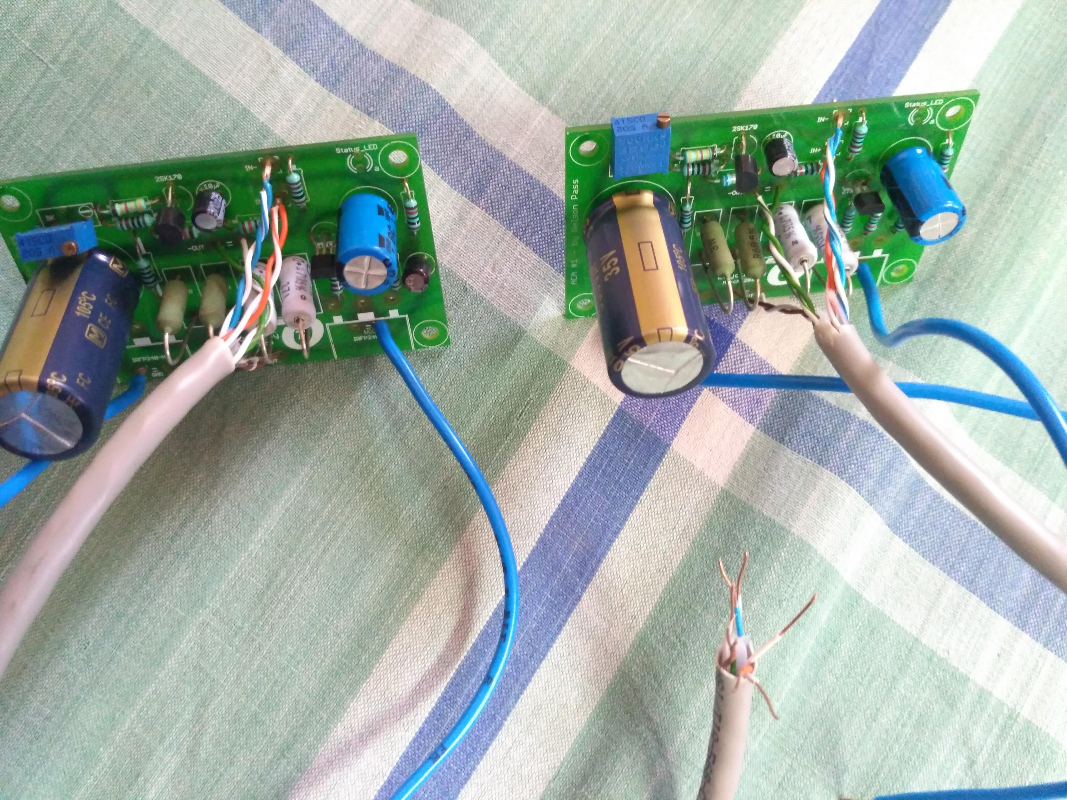

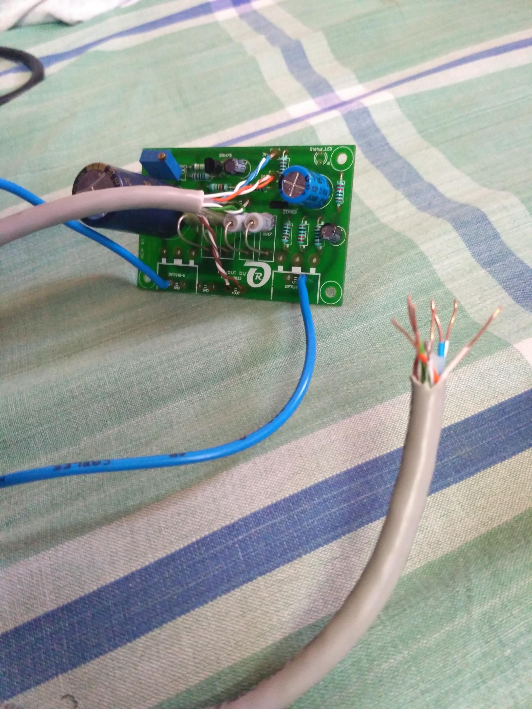

Hi .. could u please help with below queries regarding aca amp build .. attached couple of photos of current state ..
1. Can we use cat6 ethernet cable as in the photo .. the cat6 cable has 4 pairs of twisted wires .. I have connected 1 pair (2 individual wires) for each : input positive , input negative , output positive and output negative .. thus both input and output are going in single cat6 cable .. is it ok or do we need to have normal twisted pair cables separately for input and output ?

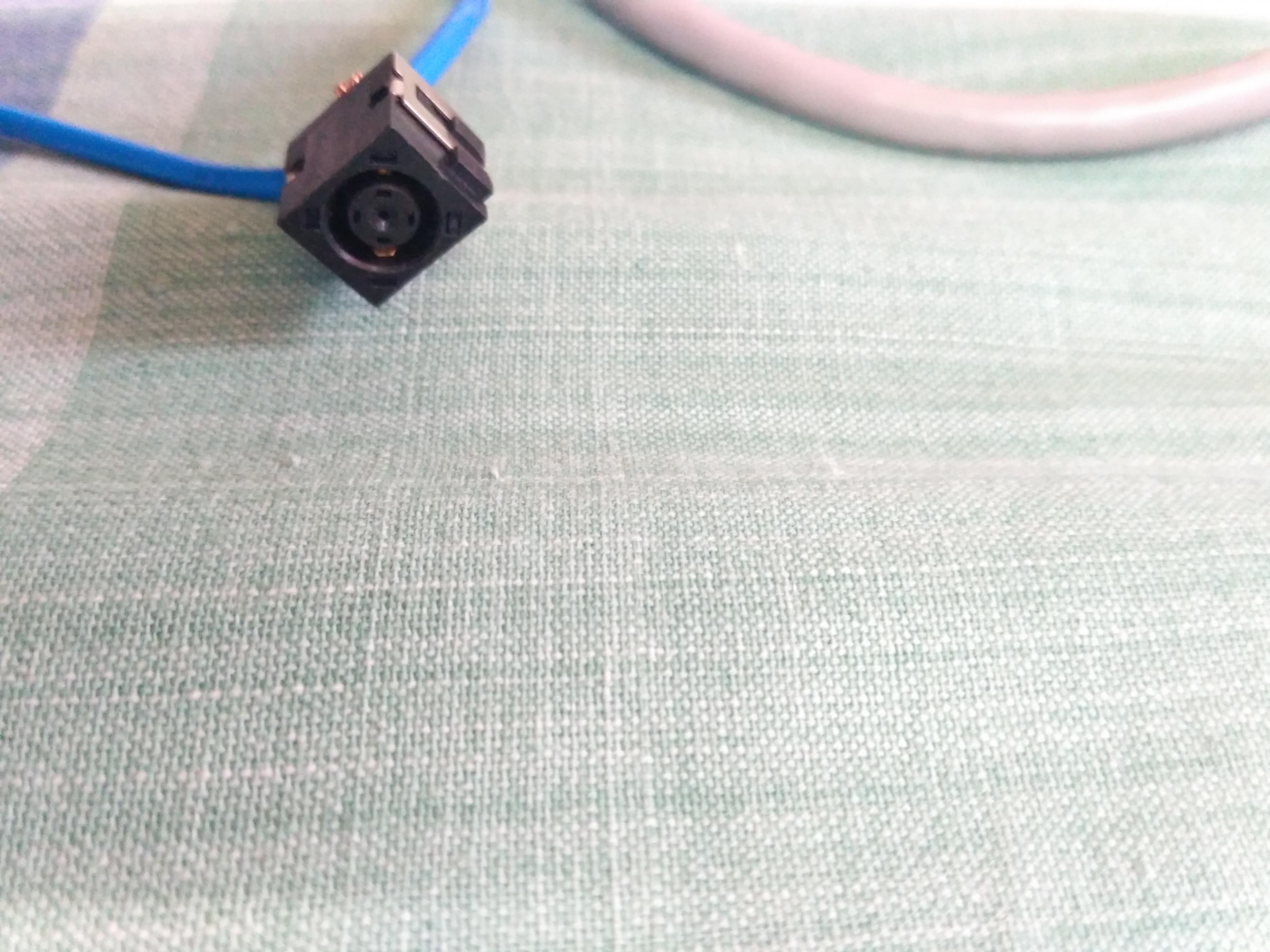

2. As we r using laptop power supply .. I am planning to use laptop power supply socket/holder as in the photo , so that we may use any laptop power supply directly without tampering it .. is it ok or do we need to have a different type of connection for power supply input ??
Not ok. Use a single twisted pair for each RCA input (hot and return), remove the shielding.
Use a separate "figure 8" cable for speaker output, do not run input twisted pair wiring and the "figure 8" wiring in parallel.
The bigger the contact area - the better. There's around 3amps of the constant current draw from both PCB's... this requires (very) large contact area.

what is "figure 8" cable..
means we should not use same cat6 cable for both input and output (different pairs on the single cat6 cable)?
Regarding the power supply connection wouldn't the laptop socket as in my earlier post's picture work , as we are using the laptop power supply only ??
The laptop socket will work. But keep the power cable separate from the in/output cables.
And also keep the input cables separate from the output cables. Each + and - output cable should be thicker than Cat-6 single or even double strand. I heard a big improvement in soundstage quality when I upgraded from single strand Cat-5 to 4-strand Cat-5 speaker cables (4 Strands for + and 4 strands for -). I used the mixed colors for - and solid colors for +, all in a single Cat-5. Sounds great!

does "4-strand Cat-5 speaker cables" means the output cables from amp output to speaker terminals?
ya power cable is different from signal input/output cables.. for power i have used little thicker copper cable and for signal (+/-) input/output i have used one pair of twisted pairs inside a single cat-6 ethernet cable
4 cables (inside one cat-6) will be too thick to put into the pcb holes i think for input.. for output we have multiple holes for +/- output on this pcb..
Yes
One Cat-6 strand is fine for input cables. For output you need thicker or multiple Cat-6 strands from PCB to RCA socket - if that is what you're using.
Yes
ya currently have cat-6 cable's, 2 strands (ie. 1 twisted pair) for input positive and 2 strands for input negative. and 2 strands for output positive and 2 strands for output negative, from the same cat-6 cable used for inputs.
I would keep input and output separate. For what reason do you want input and output in one Cat-6 cable?
Maybe more experienced audio people can chime in here and point out the drawbacks of having input and output together. To me it just sounds wrong.
