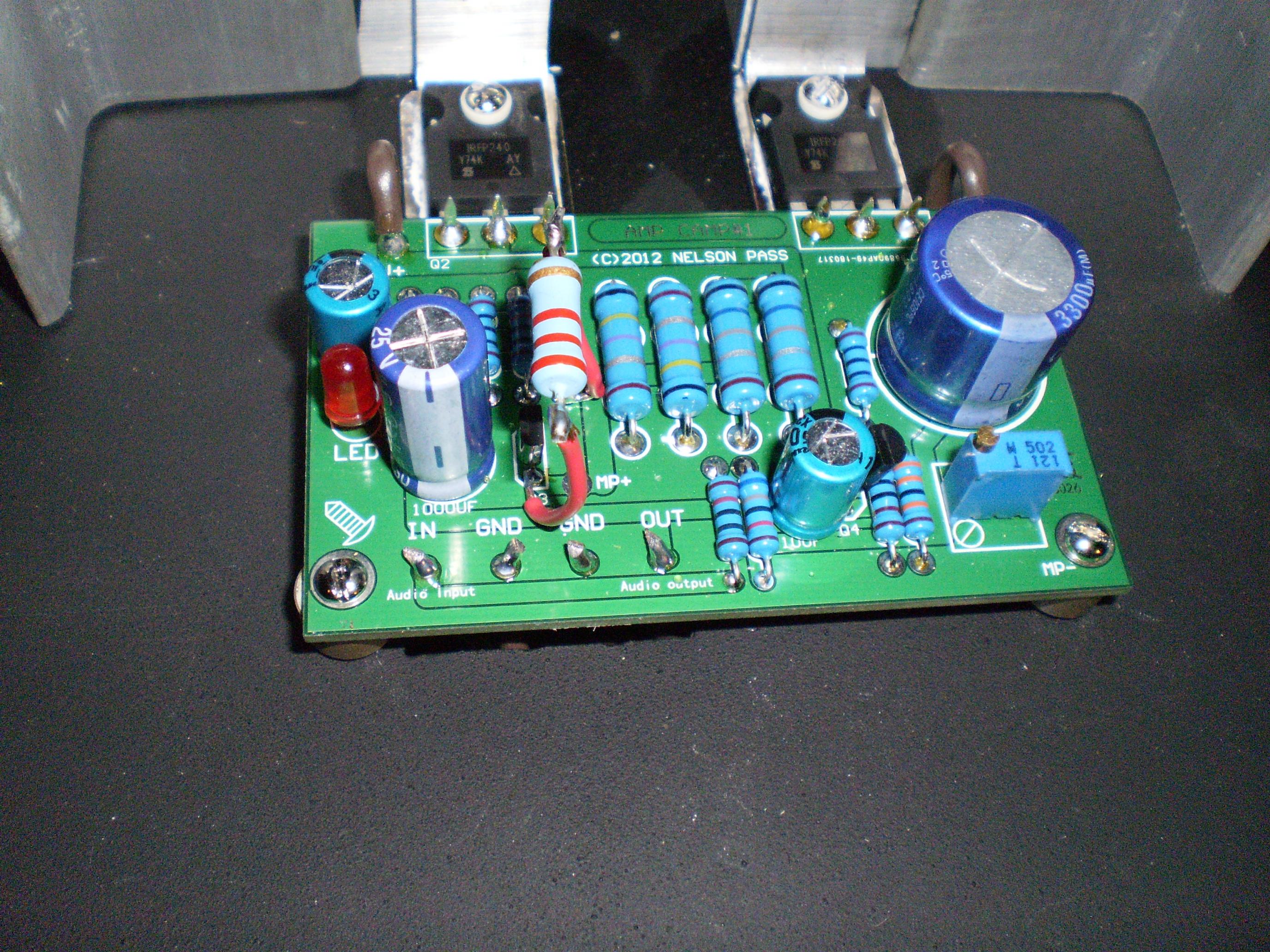

The power supply might be a bit close rated given the 1.45 A per channel quiescent current... however this is what I would do.
1/ Concentrate on just one channel at a time. That means disconnecting the supply to the channel you are not working on.
2/ Fit shorting plugs to both inputs.
3/ Check the basic voltages that will show what the state of play is with the amp.
These are firstly confirming the supply is correct at 24 volts.
Now check that the voltage on the speaker coupling cap (+ end) on the channel you are working on is approximately 12 volts and is correctly adjustable.
Checking the quiescent current by measuring the voltage across R1 and calculating the result using ohms law. 1.45 Amps should measure as 0.34 volts. Remember there are two 0.47 ohms in parallel and so the effective resistance is 0.235 ohm.
URL for photos requested. Don't know how to provide. Should've mentioned I suppose, that both pcb's worked fine before when IRFP240's were wired to board because heatsink holes didn't align with pcb. Only thing I changed is soldering output transistors directly to pcb. I'm checking all I can with my meter now. Will post numbers. Thanks
Holly thermal grease batman 😱
You do know that thermal grease is only meant to fill in the tiiiiny little voids between the surfaces.
The thinnest smear is ample.
There's enough on yours to mount 20 devices.
yeah , and extremely bad soldering everywhere
that begs for some practice beforehand (on junk pcbs , desoldering , soldering again) and just then thorough cleaning and re-solder of ACA
sarathssca,
Yours does work! Soldering could be better, but the board side picture is not that bad. There is much worse soldering to be seen... Yes a little too much thermal goop, mind you do not get it in your eyes, seriously wipe it away. You do really only need a small blob, less than half a grain of rice, next time.
