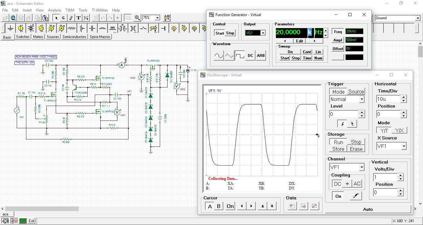

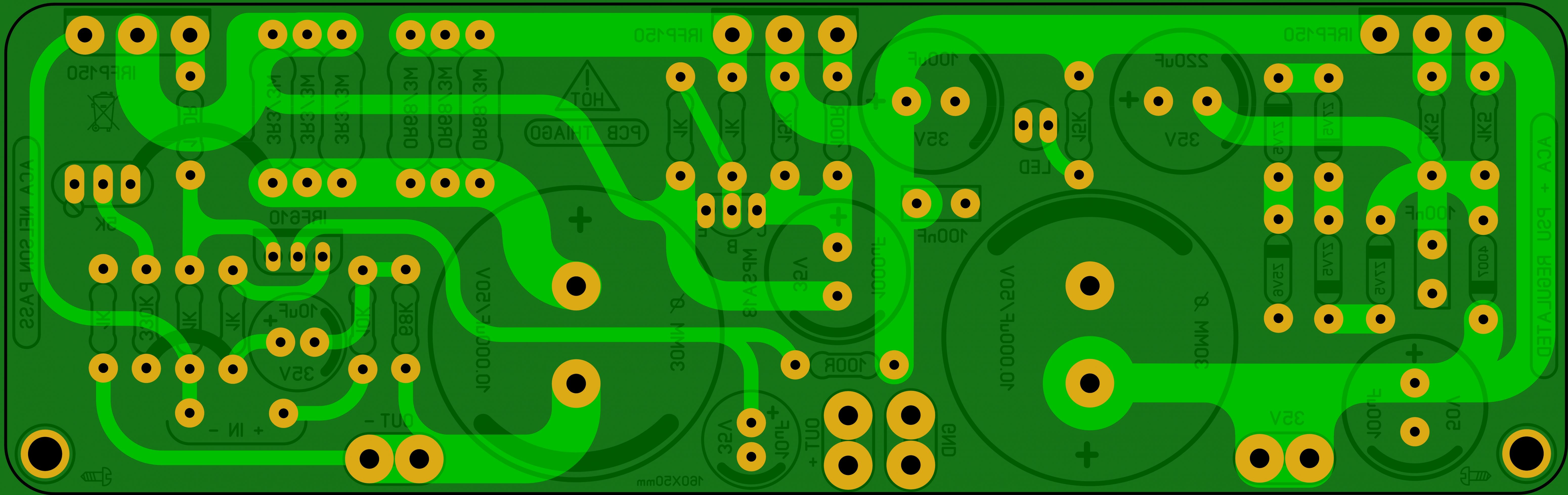

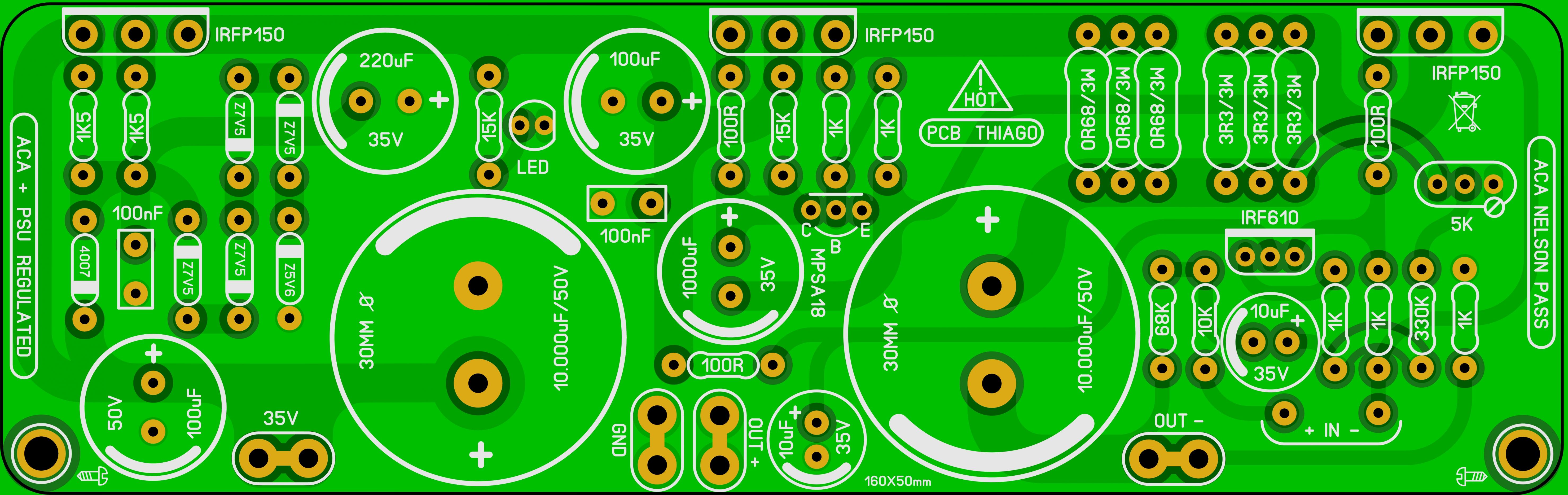

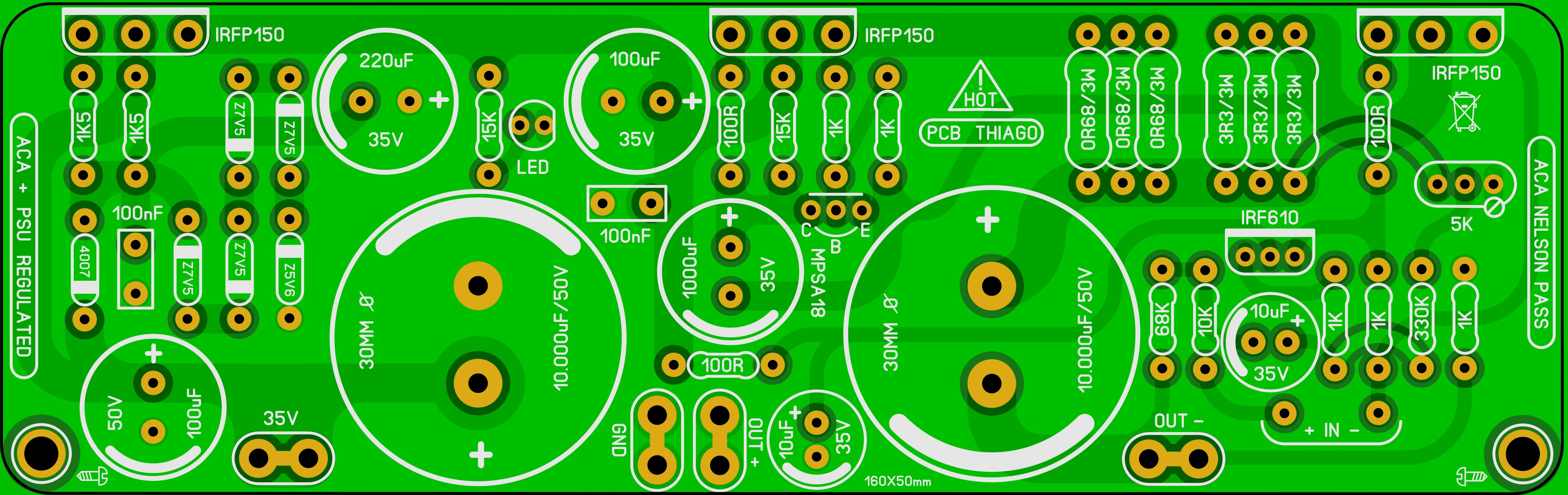

perhaps a regulated source is welcome here.
Article PSU ZEN 3
Thiago

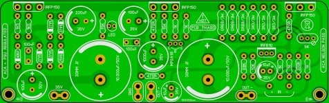

your PCB´s are really beautiful !!
could you please tell us, which software do use to make them ?
cheerio,
Balou
cheerio,
Balou
And where do you have them made, please!
best regards,
Ricardo

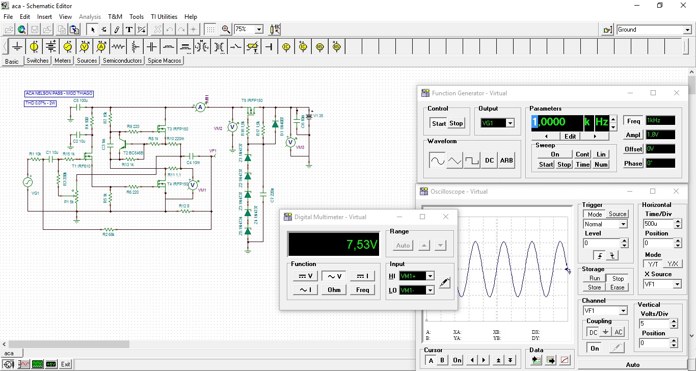

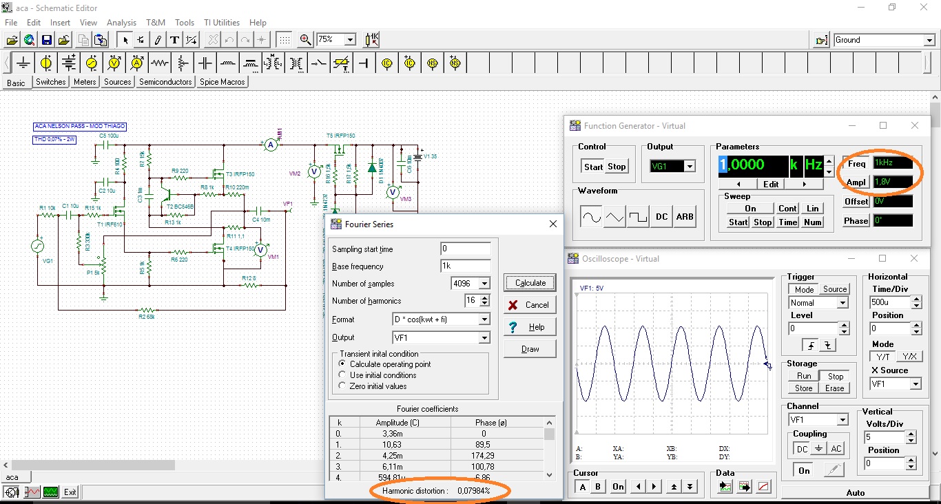

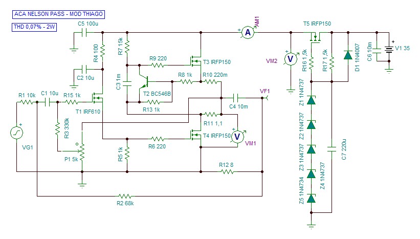

Thiagomongi,
This is one of the freshest variants on the ACA that I have seen. Most people using ACA are driving with a 19v or 24v SMPS which are regulated and have typical 60mV to 100mV ripple. With a 35v supply - I assume you are using a traditional rail from one of your class AB trafo/cap bank PSU's - you are really pushing the power rating up. What is the operating voltage of this shunt regulated amp design now?
Thansk,
X
Beautiful layout btw.

According to Nelson 7volts is lost in the regulator.
In the simulations the amp works with 29V.
Thiago
Thiago

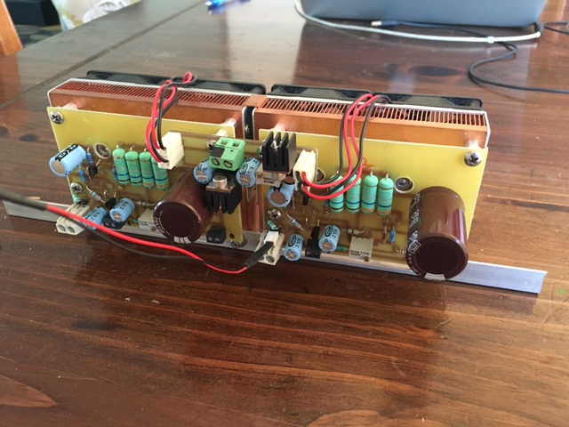

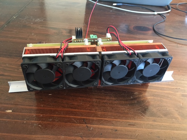

IT WORKS!
It Works!

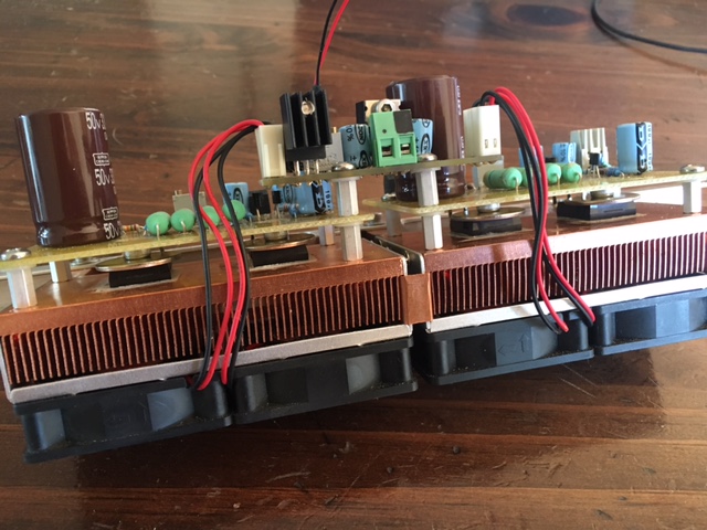

Finally, after several failed attempts, I made some boards that worked, populated them, and got them making music. To refresh: this is a dual mono build with fan cooling, 32V supply rail, using IRFP150s for the output devices. All other components more or less identical to the stock ACA with a couple of exceptions. Should produce 10-12 watts into 8 ohms.
Will start on the chassis soon. But, like all my projects, this one is proceeding at a snail's pace
. Build thread here: ACA Conept IIl.
