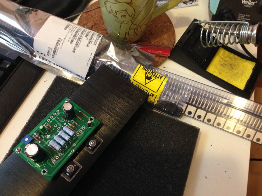

My kit arrived today, so I'm working on setting up a workspace and will begin shortly. I really should order a better quality soldering iron first though.

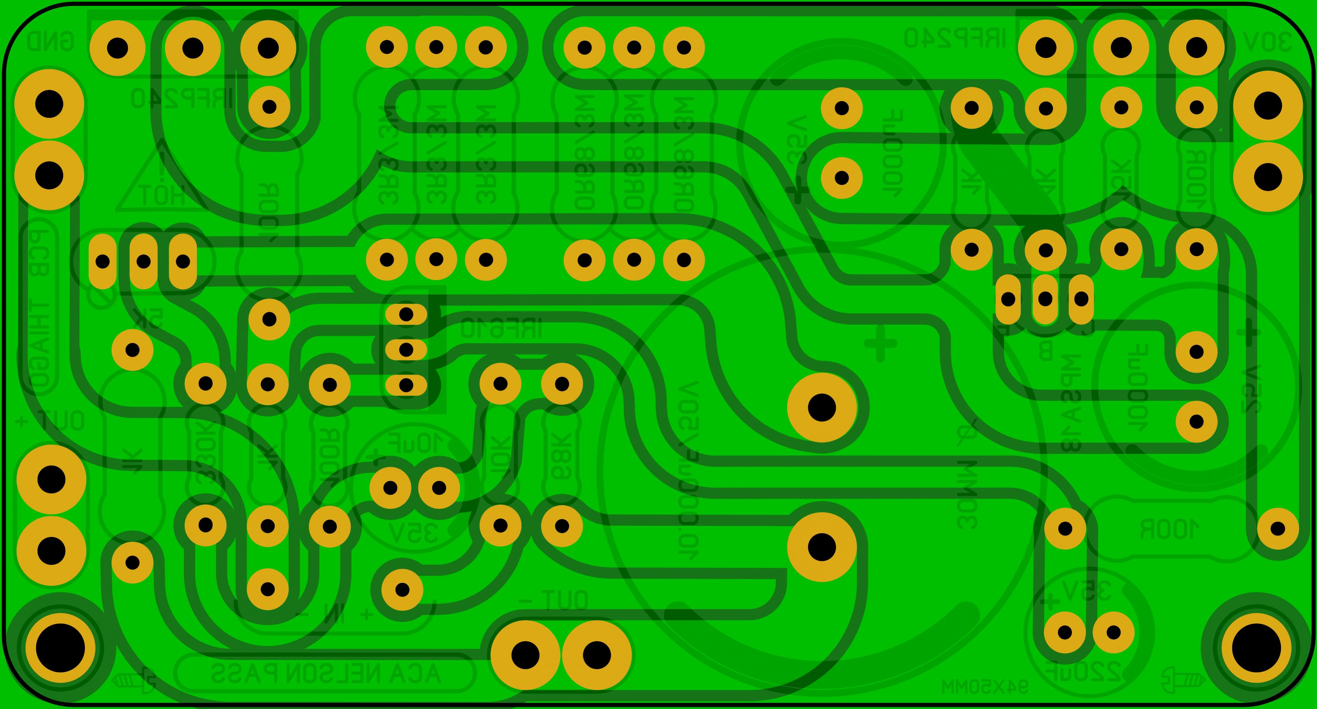

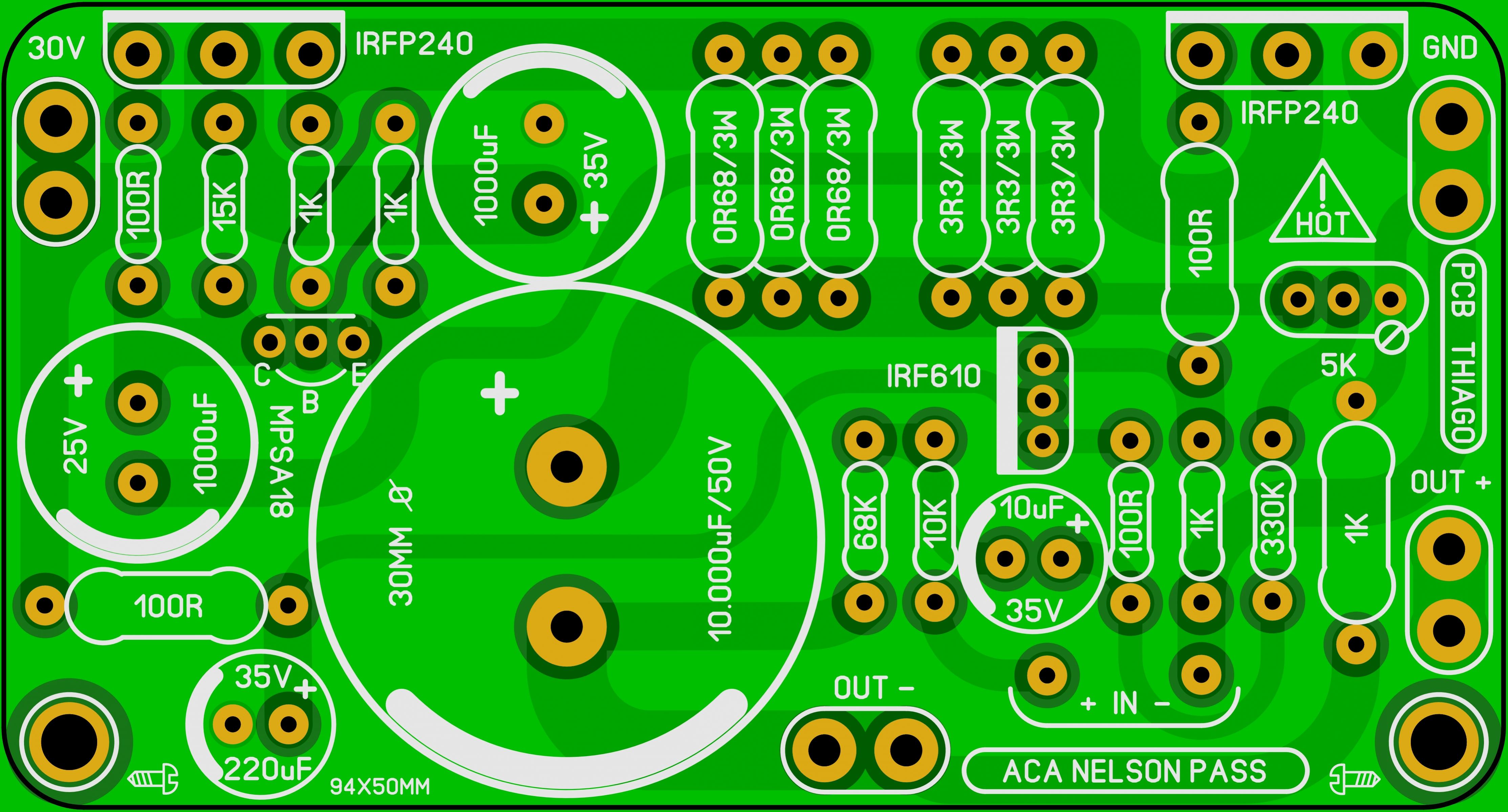

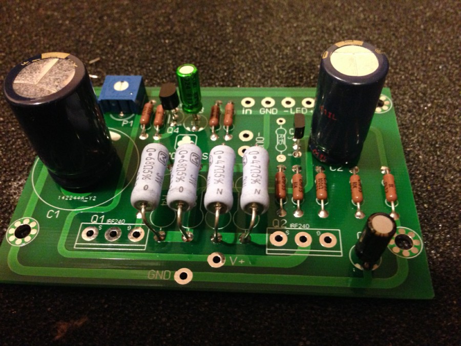

My ACA mod to go with IRF610 in place of 2sk170.
I used TinaTI and looks very good. THD 0.07% to 2w. 30v voltage. 1a Iq
Any comment?
Nice way to mix it up. You just have to make it and see how it sounds. The 2SK170 is legendary for ultralow noise so not sure how the IRF610, a power MOSFET will hold up. I know a 2sk170 can drive a IRF610 very nicely (F5 head amp) so nmaybe a cool mod would be a 2sk170 driving a IRF610 so that we can get a higher gain amp like traditional 26dB SS amp? I see you are using BD139. According to F5 build guide, BC550/560 are good substitutes for ZTX450/550.
http://www.diyaudio.com/media/build-guides/diyaudio-f5-build-guide.pdf
Hi XRK.
Thanks for the comments.
The choice of IRF610 was based PLH and Aleph amp Nelson Pass, to facilitate for those who can not get 2sk170 genuine.
Yes, BD139 can be BC550 or MPSA18 among others.
Thiago
Thiago

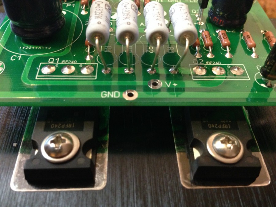

Beautiful work. You plan on running at 30v? Hot!!!
Yes, my wife asked me a heater, so I'll ride one.

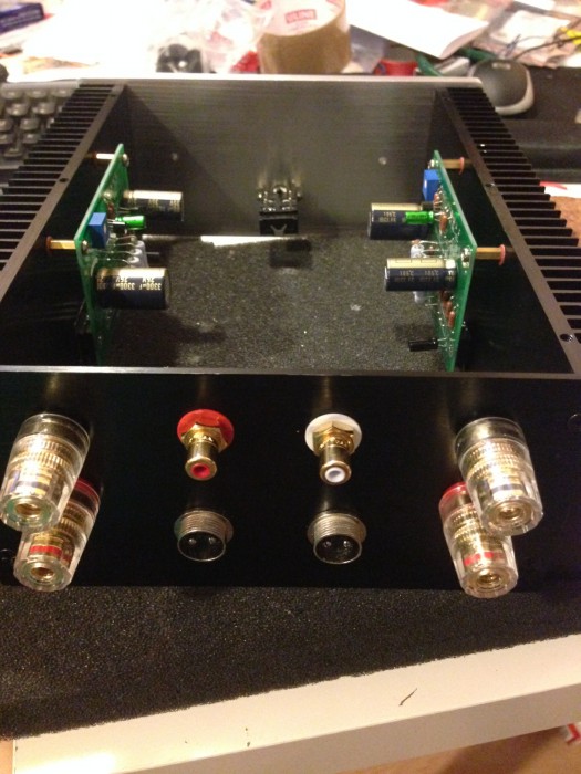

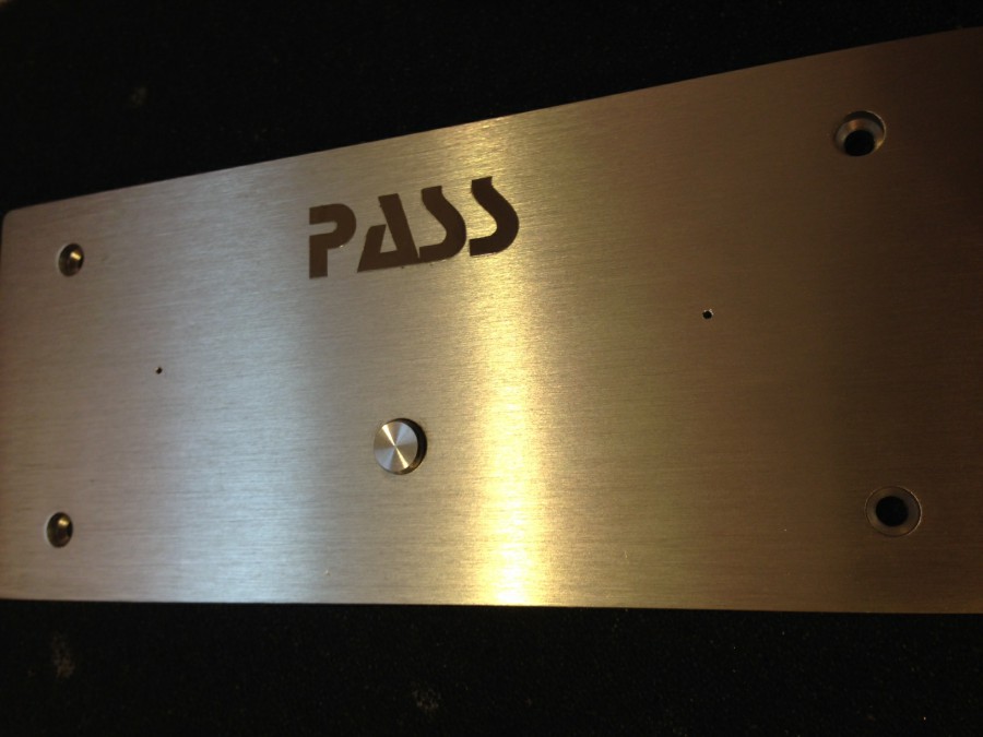

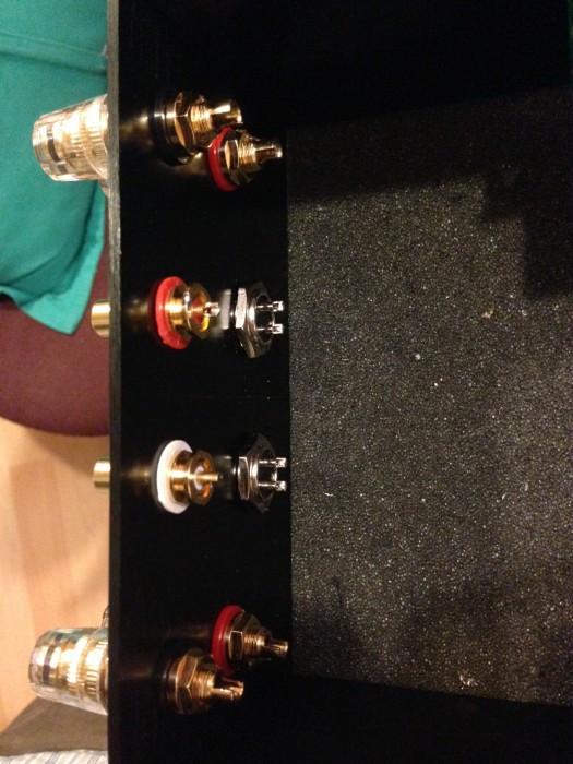

Recent build for a friend.
- Amp Camp Amp - ACA
