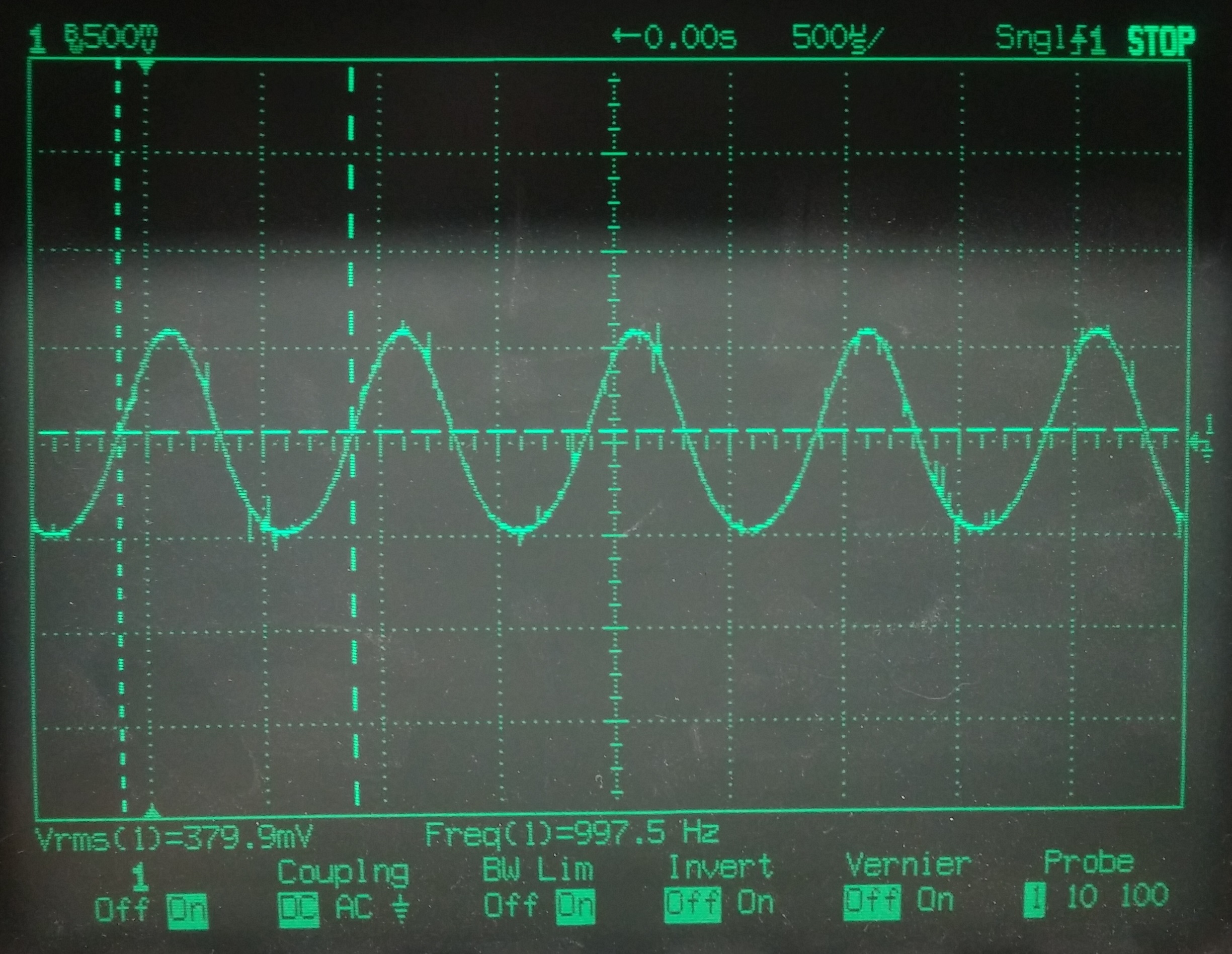

It seems really strange that two power supplies would both be "bad " in the same way. We've had very few failures, and a few more with hum, but never two I. One order that both didn't work right, in the same way......Were the SMPS supplies connected in the same way as the linear supplies? Did you use the power jacks for the switcher bricks and not the linear supplies? Were the SMPS putting out voltages about 19v each?

Both were at 1 watt and noisy with the SMPS and silent and 6watts with the linear, regulated supply. The DIYaudio store has been super easy and is sending 2 new units.

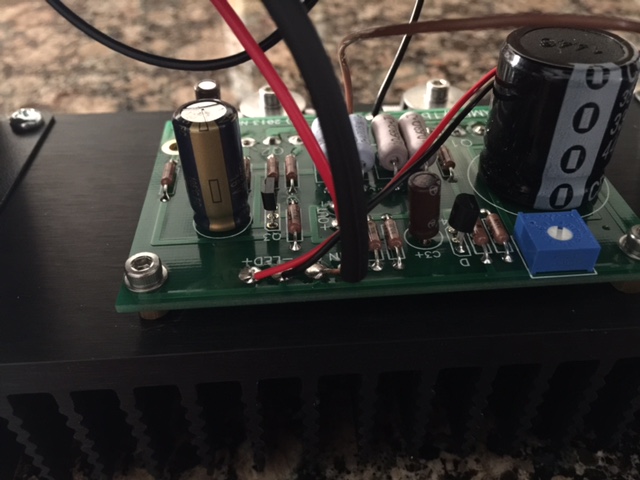

I have pics of my build... happy to email anyone who wants to see. Ive ordered 2 fixed linear 19V supplies form Ebay. I plan to measure the results again with the old SMPS, new SMPS and the linear supplies.
I recognize its strange to see same issue in both. Its appears that the amps are perfect, but the SMPS are not.

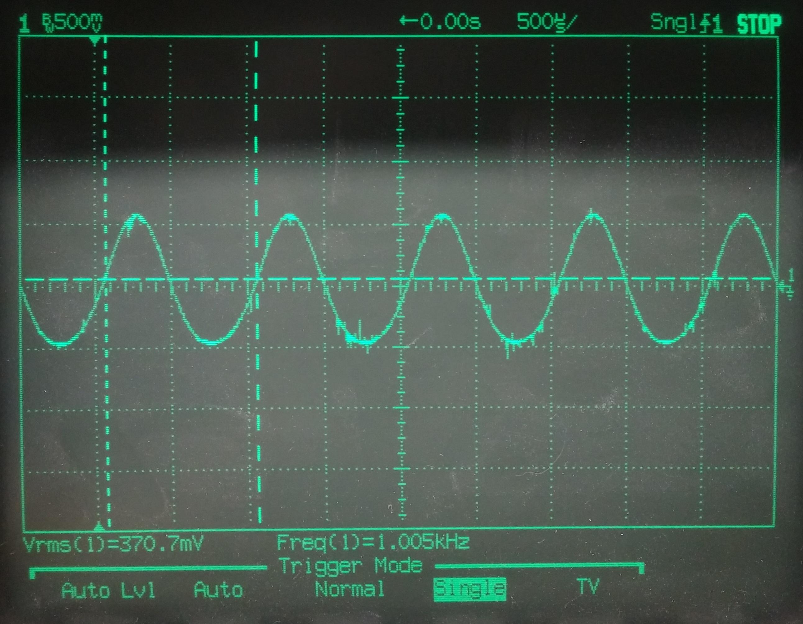

The SMPS were hooked up the same way as the linear. We started out with the SMPS... lots of noise and only 1 watt. Hooked up to the bench power supply... adjustable, linear and regulated supply... no noise and 6 watts.
Used signal generator, into amps. amps into dummy load with BNC back to scope.
The amps are stock. Only diff was I used Teflon wire and added a connector for the LED. All connectors used and wired as specified.

We'll get you the replacement PSU's. Because people have wired the power jacks incorrectly It was the only thing I could think of that would be different between the switch mode PSU's and the linear supplies.

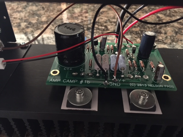

6 Channel ACA
I've got 6 ACA boards going into a single amp case, mounted to a large heatsink. I'm wondering about where to mount them. My heatsink is 340x360mm with the fins running along the long dimension. The base is 10mm think and the 30 fins are 70mm high.
Do I spread them equally around the baseplate or is there some 'ideal' mounting scheme I should follow? 😕

Well, I have a couple of thoughts regarding your project and question. If we take a clue from Papa's original design, it would perhaps make sense to mount all six across the bottom of the sink provided there is room to do that. Otherwise maybe spreading them out equally around the sink might be a good way to go also. If your base is a good enough conductor it may not make a lot of difference. Just an opinion. If I were you I would consider trying to connect two sets of three ACA's in parallel, inputs to inputs, outputs to outputs like Papa mentioned early on as a way to increase output. I have been tempted to do just that ever since reading his recommendation. Are you planning to use the six in a tri-amplifed system? If so, the output capacitors could be different on the mid and highs channels than on the bass. Just thinking....I've got 6 ACA boards going into a single amp case, mounted to a large heatsink. I'm wondering about where to mount them. My heatsink is 340x360mm with the fins running along the long dimension. The base is 10mm think and the 30 fins are 70mm high.
Please let us know what you do and how it works.

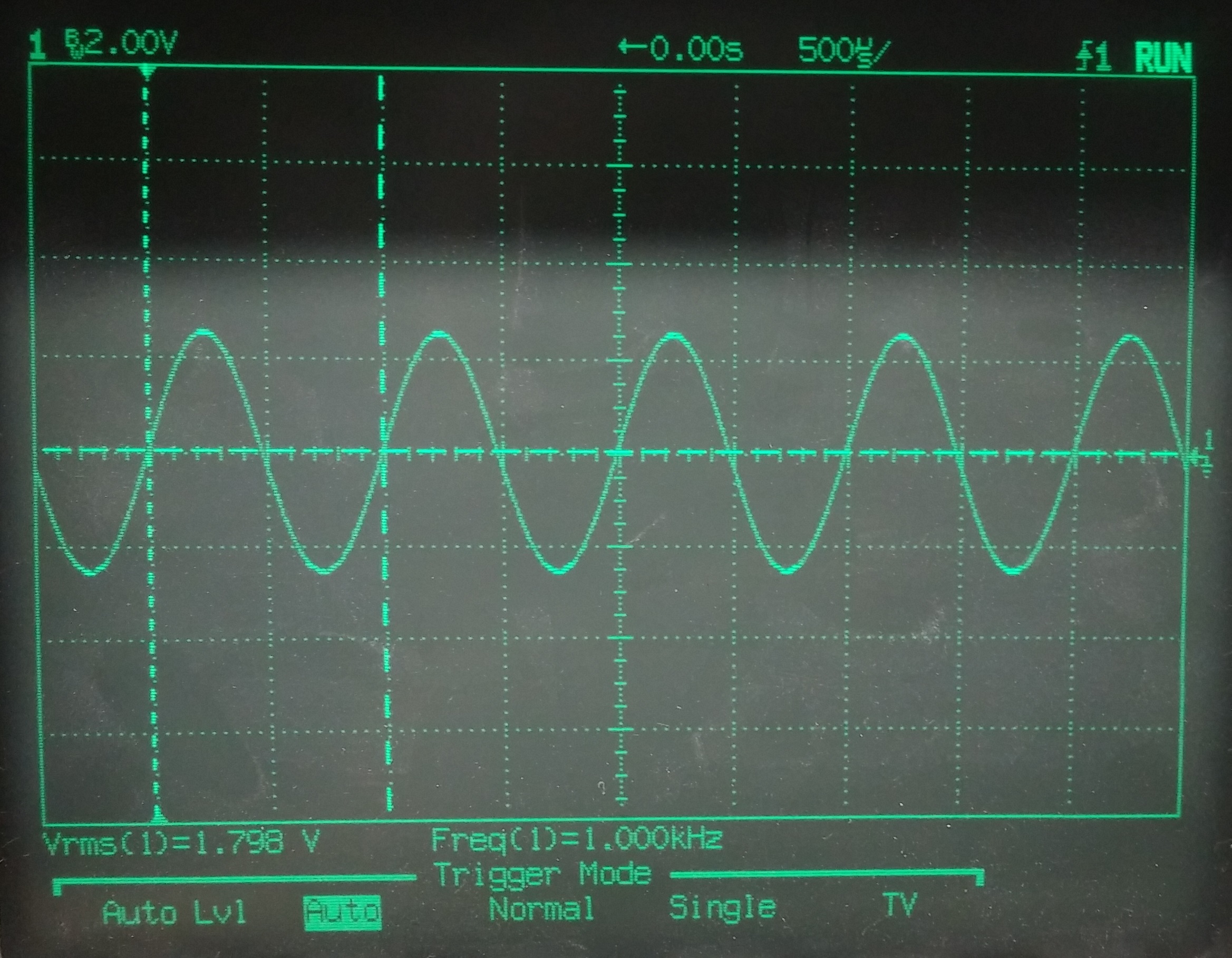

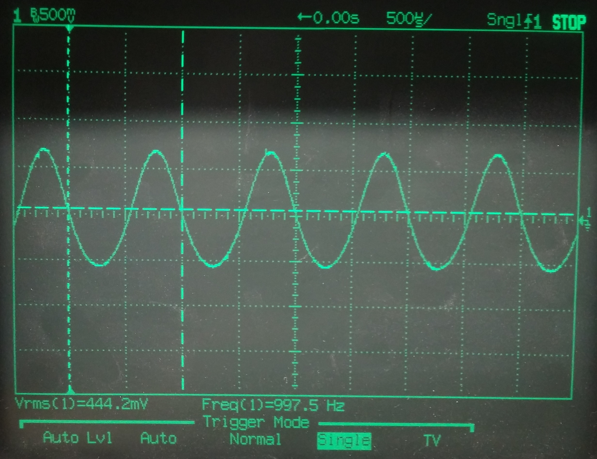

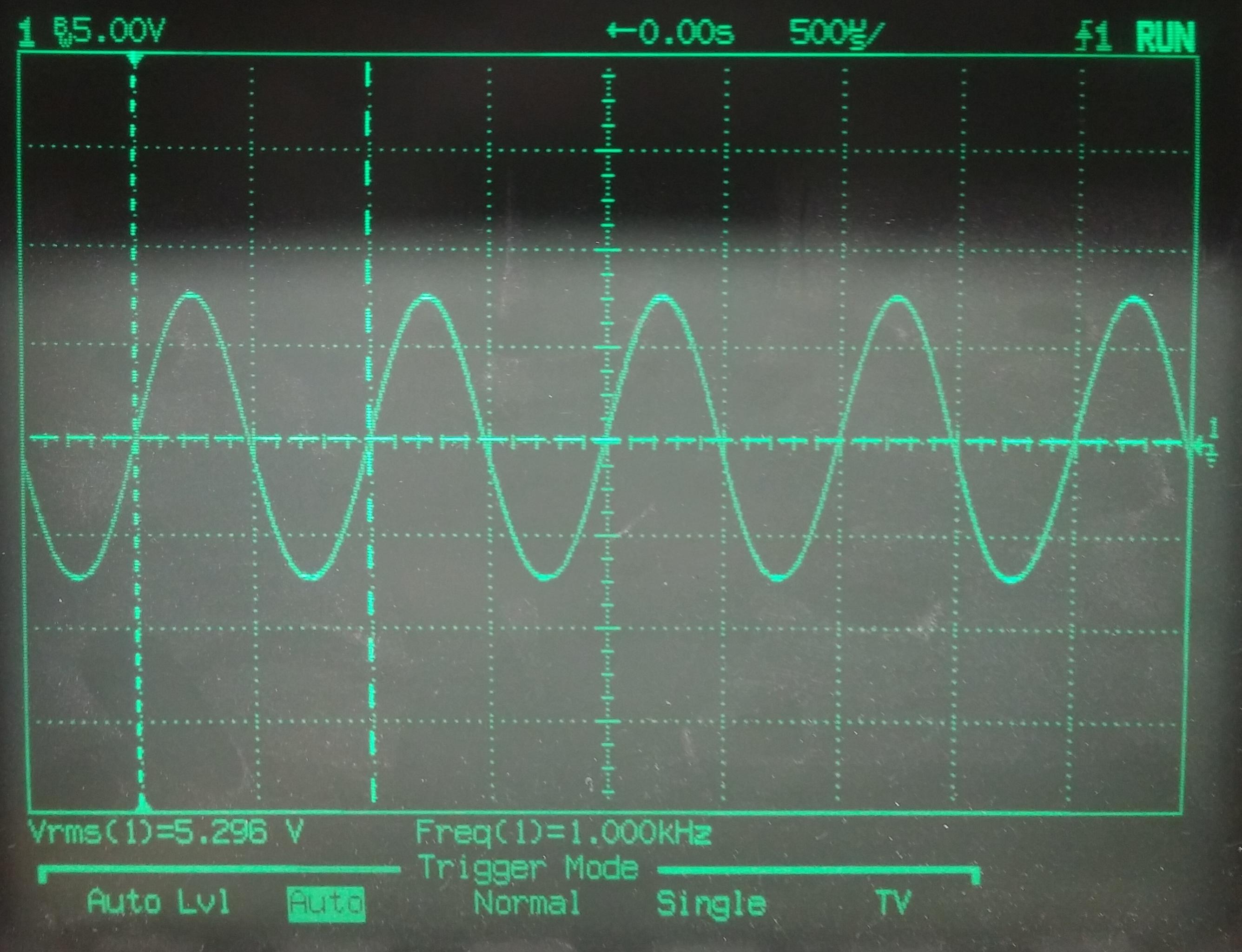

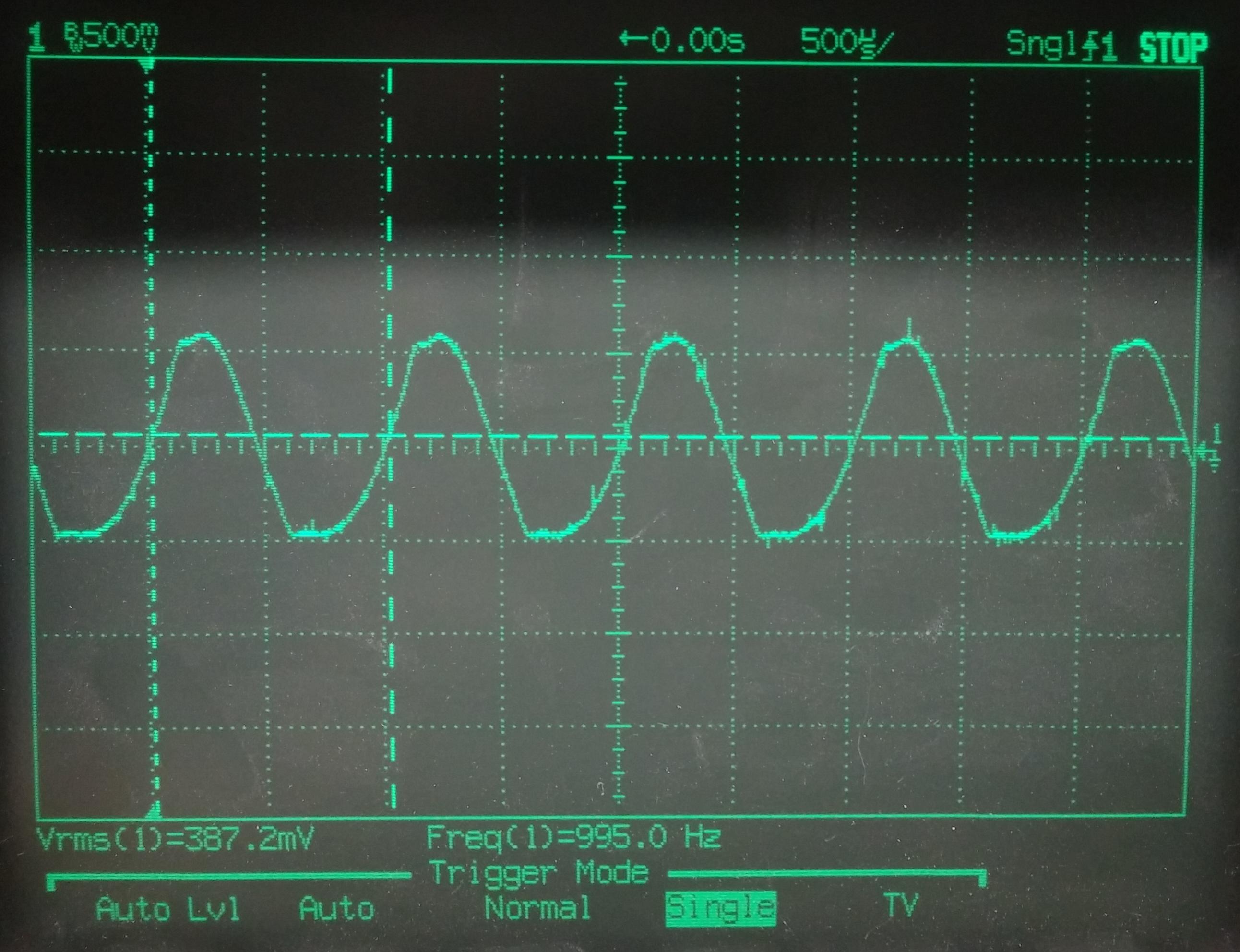

I took some screen shots of the scope when trying different supplies. The stock supply photo shows the amplifier with 500mV Peak input the output is shown at the bottom of the screen. Notice the noise, when I try to put in more than 500mV the amp starts to distort really bad. I tried the replacement supplies with the same input conditions and the Rep1 and Rep2 are the outputs. I tried the linear supply I bought but it turned out to actually be a switching supply. I took a screen shot with this power supply under the same input conditions. The wave looks a little better and I got a bit more output, but it is still noisy. Last I tried the linear bench supply and the output is much better. The Lin500 photo is of 500mV in and the last photo is Lin1500 shows the full output of the amplifier before onset of distortion. The input voltage is 1.5V peak. All tests were done with 1 kHz on the input.
