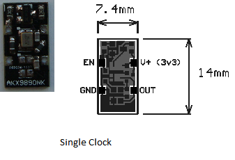

Can anyone please provide a description of the NDK2520-CCHD950 board, is it a clock adapted board?
Yes, it is. Convenient package to make manual soldering easy and also for previous version of S03 that has no land pattern for this tiny NDK crystals.See pic
