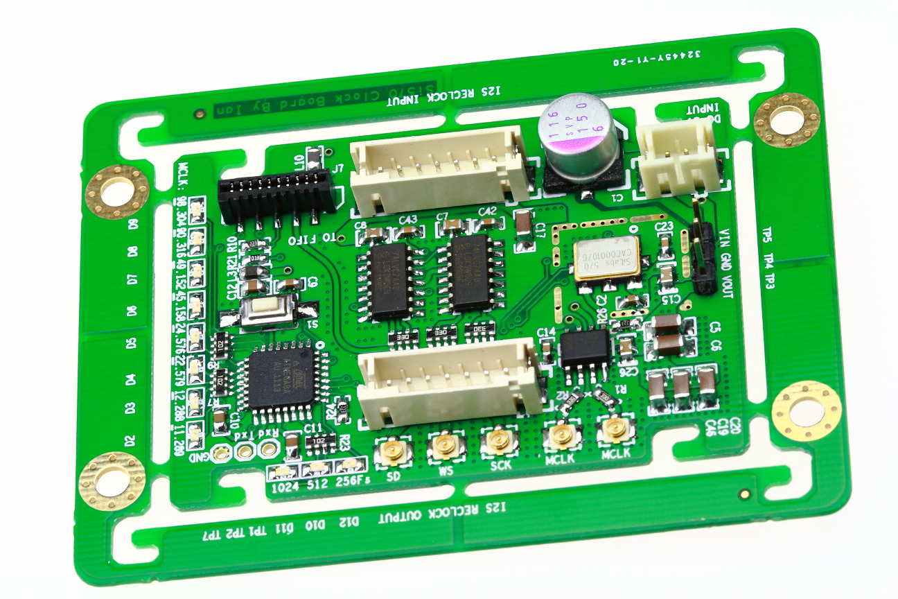

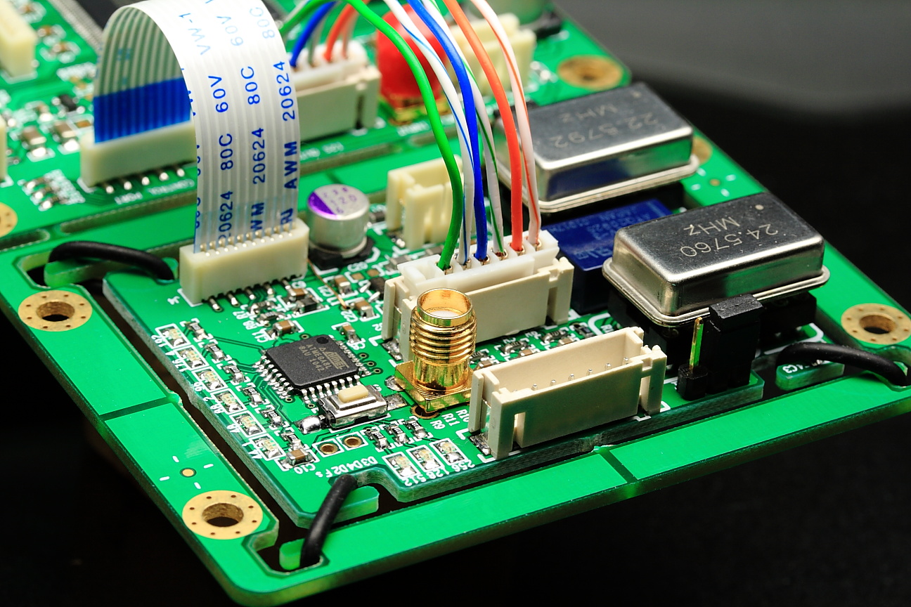

If you check through Ian's FIFO thread he had the same idea and designed the clock boards with little ears that could be cut off and attached using o-rings.I am thinking more along the lines of an "acoustic suspension"
http://www.diyaudio.com/forums/atta...ltimate-weapon-fight-jitter-batteryfromj5.jpg
http://www.diyaudio.com/forums/atta...ct-ultimate-weapon-fight-jitter-si570_top.jpg
The little tabs joining the inside clock board to the outside pcb frame can be cut and o-rings used to suspend the clock board.
Thanks, (I know). I might knock up a little frame like that for the S03. 🙂

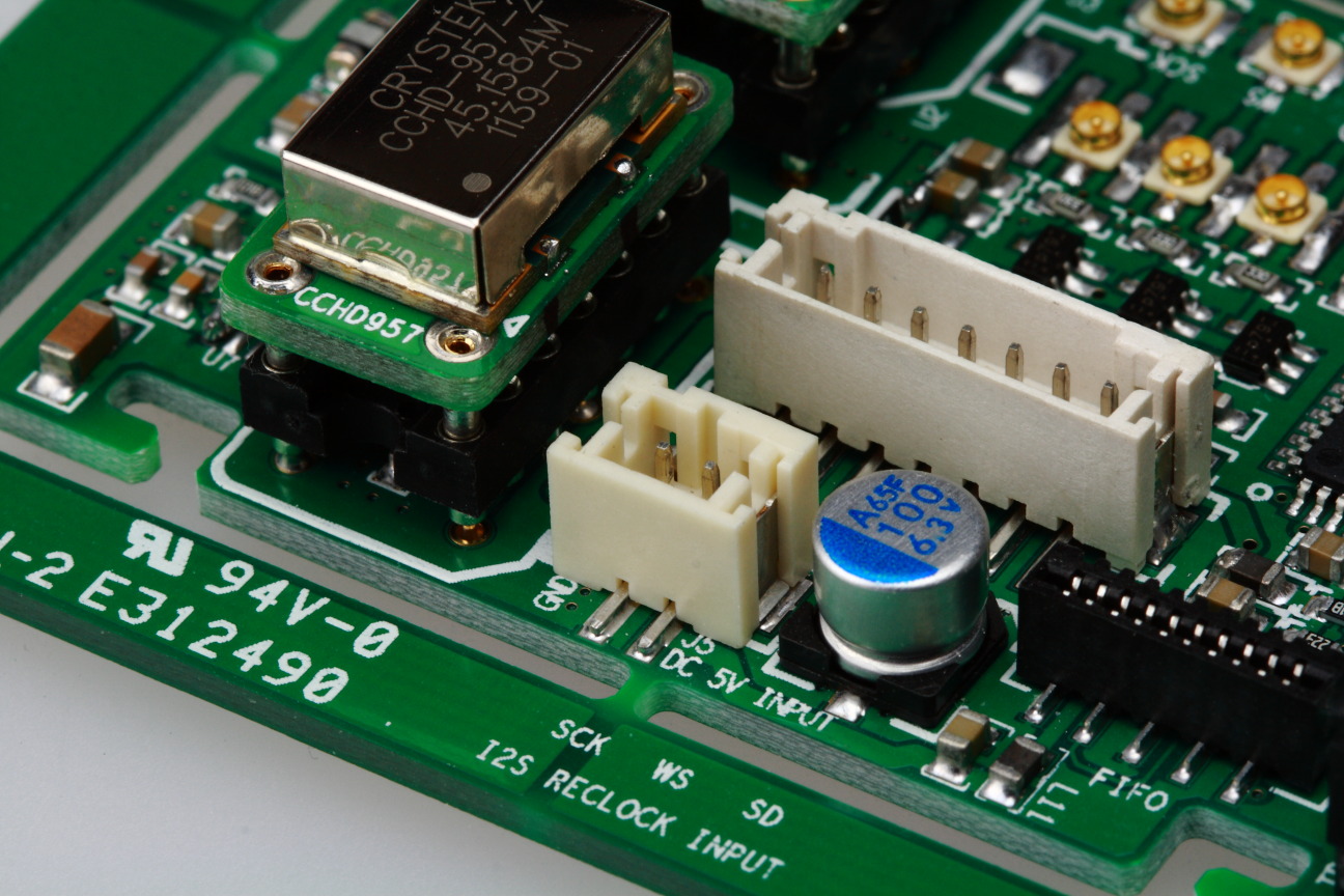

Hi Chanh,
The clock benefits if you place the shunt regulator directly next to the clock. The wires running from the dac board to the clock have a fairly large impedance in view of the high frequency that the clock is running ( and thus drawing current influenced by this frequency).
I have the black board with extra holes for a regulator for the clock, I assume there will be some way to place it near the clock on the older board.
I have an older green board but I only noticed recently when you mentioned it that I also had the 3 mounting holes for a standard 3 legged reg. So I was able to change from this mess (you can see the 3 holes at the bottom of this pic)I have the black board with extra holes for a regulator for the clock, I assume there will be some way to place it near the clock on the older board.
To this. Much neater 🙂
There's a place on the underneath of the board which needs a solder jumper if you want to use this point. It's obvious if you look.
But later on he recommended this:
http://www.diyaudio.com/forums/digi...mate-weapon-fight-jitter-343.html#post4074975
Ahh cool. Those bushings are easy to get hold of and not expensive 🙂

Hi Chanh,
It's a bit too early to answer your question on the ideal supply for the S03, I hope to finish the S03 board the next weeks.
I will use a shunt regulator positioned next to the clock, I have good experience with this in CD player designs I made in the past. The raw power does not need to be regulated, but I will try what I have laying around for now; a supply with simple LM317 but with some nice black gates, and take it from there. The clock benefits most from a very fast and close (very close is important! Best to solder directly to the power leg of the clock, more than a few cm apart does have negative influence) to the clock positioned regulator. Do not use big caps (max about 0,1uF) between the regulator and the clock, this will slow down current supply.
I am using the salas shunt regulator for the raspberry pi now. I have not noticed big changes with other supplies, as long as they are linear.

I am thinking more along the lines of an "acoustic suspension" as shown, given there is a sensitive clock on board as explained in my previous post. So will prefer a horizontal setup and connection using flexi cables will put the S03 Clock into the 'swing of things' 🙂
I have no expertise in these matters and I'm not suggesting that 'rubber bands' or the like wont make a difference but, at the frequency that clock crystals operate at won't the suspension essentially act as a solid/rigid connection? Can anyone contribute to my education?
