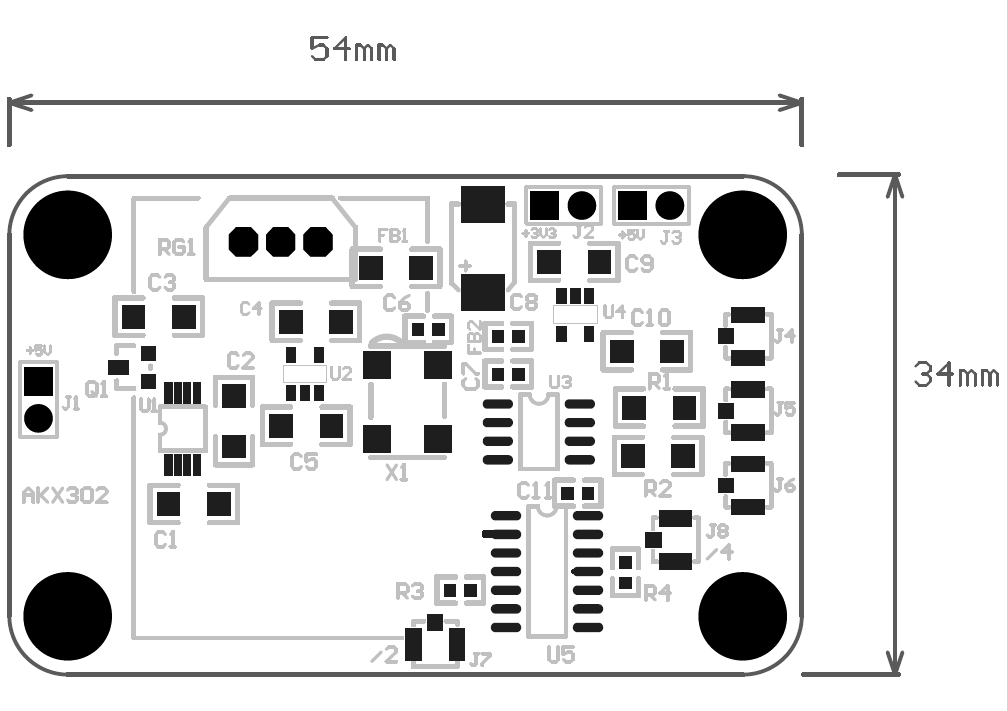

Thanks Qusp, points noted but no harm trying.
I have updated the Clock board with div/2 and div/4 output options for MCK and in snyc with RCK.
You could something similar with si570 but how do you sync them?
Also worth noting that you can still use MCLK from the Amanero without using the clock division on the MCLK.
For a 200MHz RCLK clock I don't think we've really stressed this PCB or the parts too much.

no of course not, try what you like, thats the point of tyhese little boards, it just doesnt make sense to me to prioritize RCK jitter over MCK and I think thats what the setup above does.
sync what to what? the si570 module has 2 buffered outputs to cater for dual mono, if you divide one and steal the reference clock from the higher speed output, wouldnt both be in sync?I have updated the Clock board with div/2 and div/4 output options for MCK and in snyc with RCK.

Ok thanks got it. From the same output, of course.

Thank Guys, helps a lot! I started to spin of this Clock module because of the 100Mhz limit of Ian module and the re-clocker can take higher speeds. Anyway it is all good to experiment. I will check out Ian's design. Trying to avoid duplication and wasting time... My own DACs have no XO on-board so welcome anything favourable.
