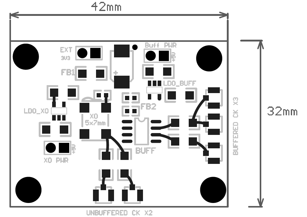

XO - AKX302
Simple XO board for use with the re-clocker and DACs:
Has buffered and un-buffered outputs.
LDO options (AD150) for both XO and Buffer IC.
External power option.
0.8mm thick, FR4 board, 2oz Cu, gold plated
Price: USD 12 + std shipping (airmail)
Free shipping for those who have bought the Rec-clocker boards
A free board (and free shipping) for those who have also bought my DACs
Off to Fab early next week. ETA stock ~1wk.
Any comments/suggestions welcome.

Acko,
I've just got two questions:
1. I'm about to order my Potatosemi FF for the reclocker so I was wondering if I could use one of their buffer's too. Is the PO74G38072A compatible?
2. Out of interest, is there a technical reason for the 0805 impedance matching resistors on this board vs the 0603 resistors used on the AKL-S0x boards?
Chris
Yes, it is in fact another tasty PotatoChip PO74G38072A 🙂
Actually a 1206 on this board to make it easier for manual soldering and if you wish go for z-foils or RF types that more readily available in bigger packages. The Re-Clocker board is pretty cramped to match the Amanero dimensions and so the reason for 0603s
Thanks Acko, I've ordered my PotatoChips 🙂

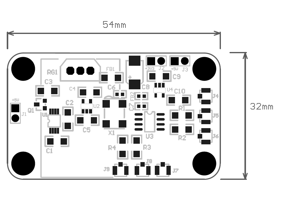

What are the chances of changing the ext header to a 3-term type? I have a few spare of Ian's TPS7A regulator boards here that I could use, others might want to try Hynes reg or TPA shunt reg. This might need you to flip the 5V XO Power input to the top edge of the board perhaps?
Thanks! In this case if this reg is readily available then thinking of mounting horizontally over the on-board LDO cct. Any details of mechanical/dimensions?
I don't think Ian has published any dimensions. I don't have any callipers here, but by measuring one I have here against a ruler I get 20mm x 31mm. The 3pin socket appears to be dead centre and holes are at 0.1in (2.54mm) pitch.
Here is a post where Ian shows it mounted a few different ways with the Si570 - diyAudio
In terms of availability, it is really only available whenever Ian runs a GB, so I'm not sure if I would describe it as 'readily available' though I can't see Ian having a huge objection to someone replicating the PCB since it is relatively simple. A similar circuit could be made on board though the QFN package reg chip isn't as simple (though it certainly is possible) to solder with conventional soldering iron so might not be ideal as the 'default' but it does represent a significant step up in performance over the ADP150.
My thoughts were that since the 3 pin vin,gnd,vout connection format is also used for other regulators this would allow people to experiment in the same way as Ian suggests in the post I've linked above.
