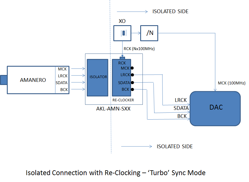

Acko; Can I ask what XO you'd use to drive all 9018 frequencies (~>= 100mhz)? I've been doing some reading, and nothing jumps out yet. Any input welcome 🙂
MisterRogers, could you clarify if you mean to use this clock as MCLK on the 9018 too? I suspect you aren't but just want to be sure.
I have a 200MHz Fox (http://www.foxonline.com/pdfs/FXO_HC73.pdf) loaded into my cart ready to click 'buy' for use on the AKX301. In general I think faster is better for the RCLK in terms of reclocking performance.
Nope, not for MCLK of the 9018. Yea, I've picked up on your preference for faster clocks; sounds intriguing to me and makes alot of sense. That Fox is exactly the sort of recommendation I was looking for. Keep them coming 🙂
Cool, I just wanted to be sure that no-one else misconstrues recommendations for fast RCLK as a recommendation for exceeding the DAC chips max MCLK spec.
Since Acko's designed a board that lets us use parts that go fast, it is mighty tempting to go as fast as possible. I just haven't found a faster clock yet at reasonable prices/availability that looks well speced for the job. For $5-10 ea those Fox ones seem pretty decent. The usual suspects didn't appear to be available upwards of 100MHz though when I went looking the other day, if I find others I'll report back here.
I might actually probably grab a 50MHz and a 200MHz of the same clock and see what there is to see, I'm not expecting a huge difference, though as you say, for faster sample rates, the slower clock isn't going to get the job done.

why not just multiply the dac clock?
Doesn't make sense to reclock with a synthetic clock does it? RCLK jitter is crucial to reclock performance since it is the CLK input on the flip flops.
Prefer clock division to drive DAC MCLK. e.g if RCK is 200MHz then use a /2 to 100MHz clock for DAC.
Something like this... RCK spinning higher means we can take advantage of better stability and jitter performance of XOs. If Pulse Modulation Error is a concern as what GLT indicated then this is minimized with the higher RCK frequency. Also, I am assuming jitter is Freq domain stuff and dividing to get MCK means jitter is reduced?
Something like this... RCK spinning higher mean we can take advantage of better stability and jitter performance of XOs. If Pulse Modulation Error is a concern as what GLT indicated then this is minimized with the higher RCK frequency. Also, I am assuming jitter is Freq domain stuff and dividing it to get MCK means jitter is reduced?
Thanks for this Acko, I follow the logic, seems like a good idea and I'll probably give it a go! I'll see if I can draw some diagrams of the signals in different configurations to improve my understanding, will report here if I find anything interesting.
