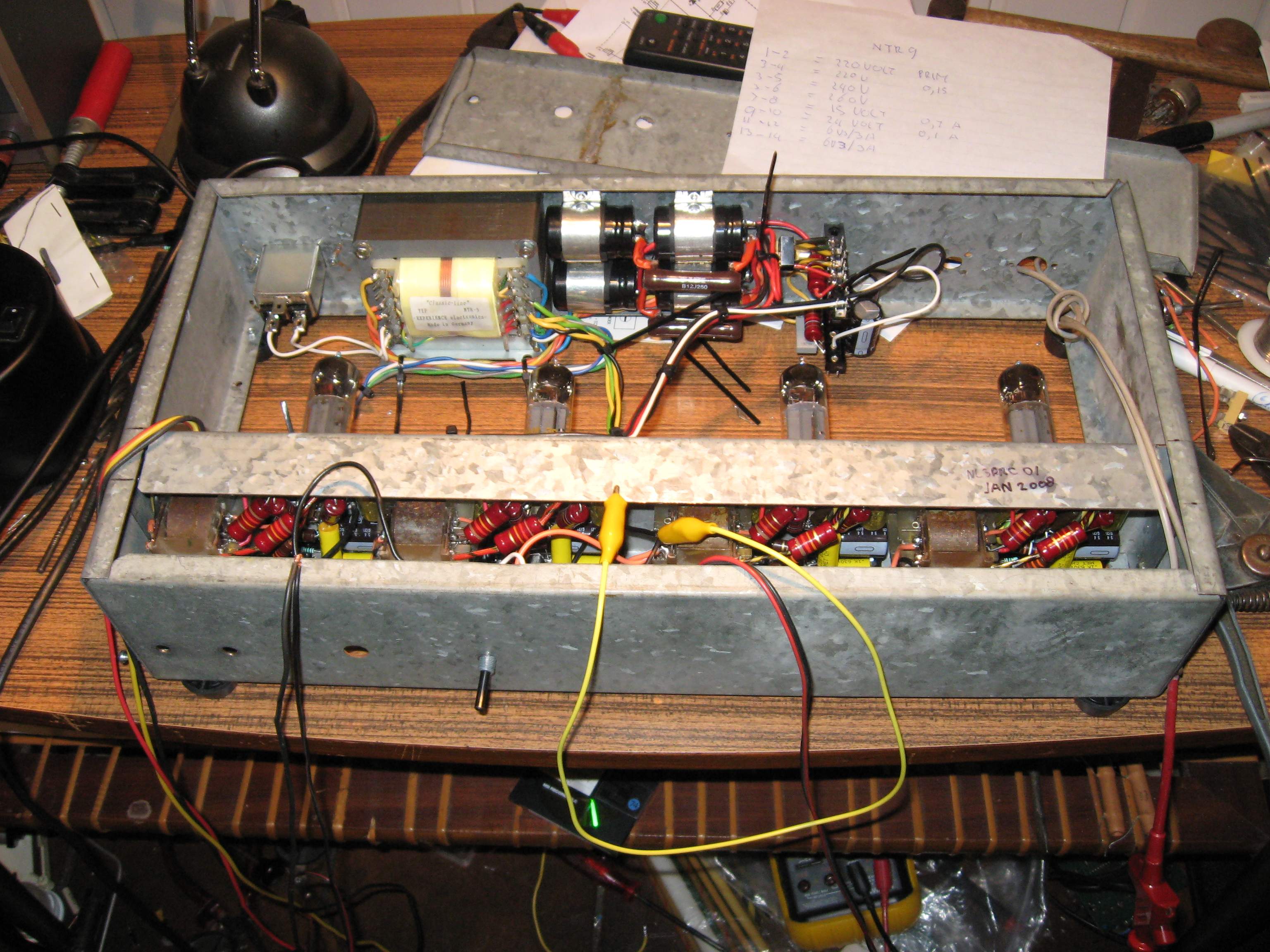

Even that steel is being magnatised bij the power transformer i alway use galvanized steel
So you can solder the wires directly on the chassis.

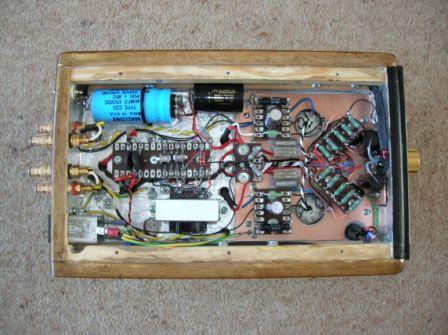

I use wood with double sided PCB inside the top plate and solder to that I have put EMI tape under it in the past..
The problem with coupling means you can get hum from the power Tx coupling to the OP tx's.

I don't use any PCB's in my amps mostly i hardwire.
I only use small pcb boards in mij power suply and my delay switch when needed.

I hard wire as well the PCB is used like this..Not as a PCB..😀
Under the transformers I line the case with EMI tape.
