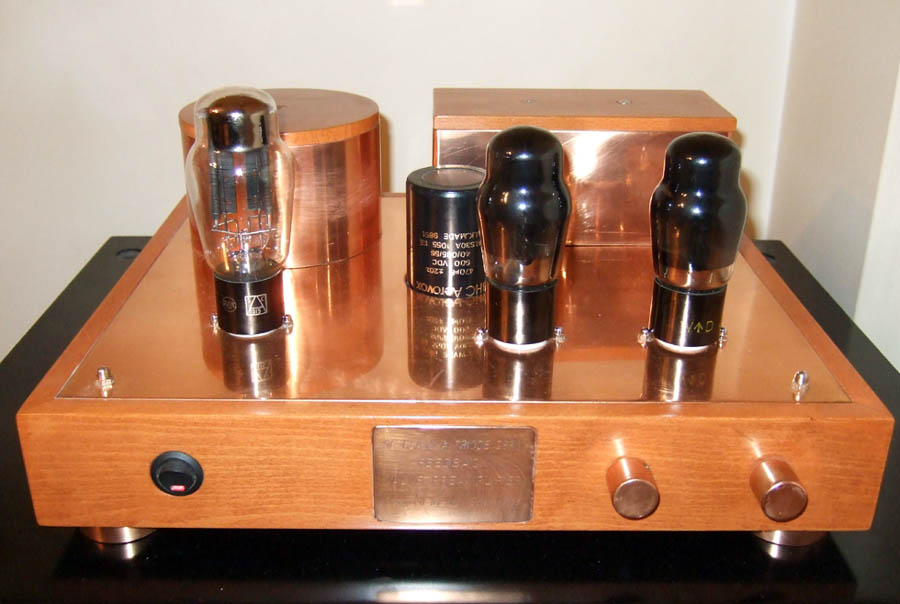

kevinkr said:
I like copper even better, but it's too expensive, really hard to work because of it's softness, (Clogs drill bits, end mills, punches, etc), greater thickness is required for a given load on the top plate, needs to be well protected from oxidization, and is prone to bending and scratching. However nothing looks better than clear coated copper IMHO.. 😀
It sounds better too. I went that route with my preamp, and although a PITA, I am happy that I did.
