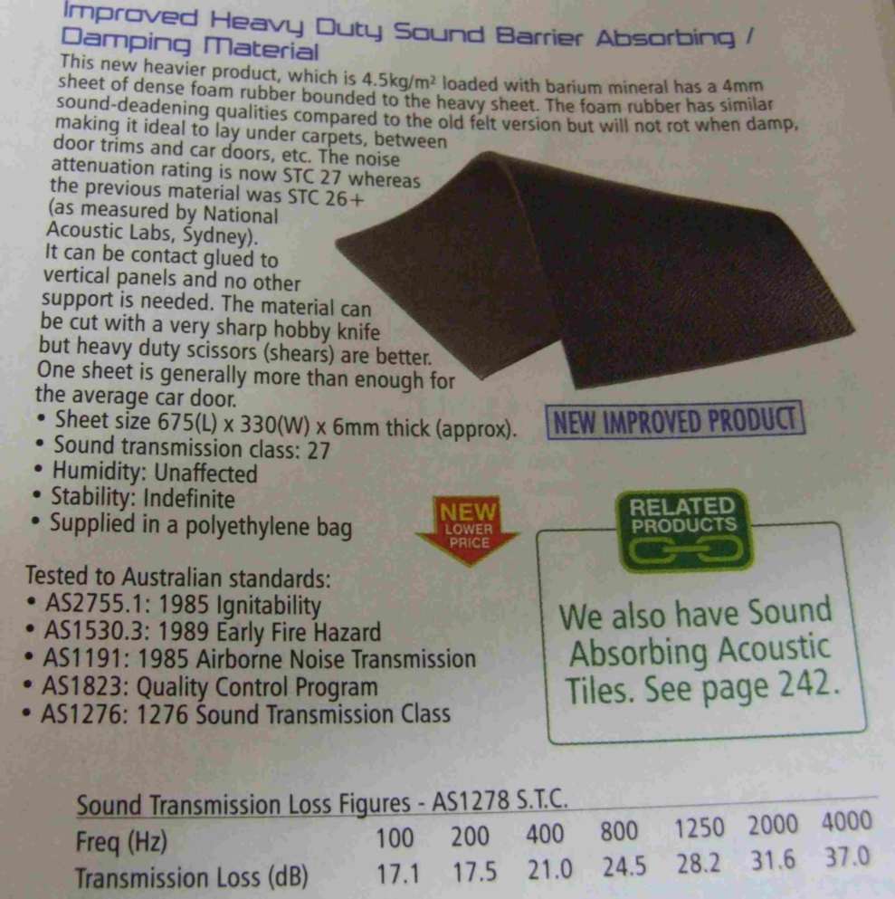

You are very much on the right track – in fact we think a like when it comes to that dirty word “resonance”. Jaycar (I see you’re from Australia) sell a plastic/rubber mate which is used to line speakers. It has barium in it which make sit heavy. Glue it every where in the case which does not get hot. Glue it under the case. There is no need to disfigure you case to do this. The amp should not only sound beautiful but look beautiful too. If you are married you will know about WAF.
If trannies don’t get hot grommet mount them. I grommet mount my cct. brds in my valve preamps and then use self adhesive computer mounting feet. Jaycar sell heavy brass isolation feet ($30). I don’t use the double sided sticky rubber pads they provide bolt them direct into the case. Use isolation plates under your amp. I have too favourites. ½” glass plate on thick silicon feet and the other ½” Italian marble on silicon feet. Both 300 X 400mm. I also use silver wire in the audio path. This is pure silver .7mmm thick and I cover it with spaghetti or cotton insulation. It is cheap and generally you don’t use much.
I could go on for hours but I will bore you. Let me know if I can make some more suggestions or just disagree with me as so many other have done.

Got it
That looks right. There has been a few different ones over the years. The one I have is reasonably thin though made of a number of layers. Use a strong think glue to attatch. Sometimes it can pull away under its own weight.
