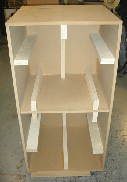

^^pics of my bracing^^
The reason why I like this style bracing is because the long panels serve to break up (divide/raise) resonate modes. I borrowed from Bills approach, brace spacing. The added mass is welcome for obvious reasons. I used three-quarter inch plywood for the bracing... in the areas where a cross brace can't fit rib bracing is the second best... so they say...

Camplo, what do you cal ribbs bracing please ? Is it a wood piece glued on the internal baffles only or the a wood piece glued on two facing baffles to couple them ?

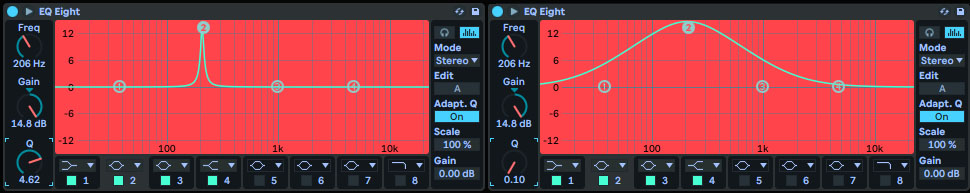

From my humble perspective...Q is somewhat complex and gets used a few different ways, so forgive me if I mix it up.
Q=compliance is highest at the resonate note. Period. and lowers above and below
So if you raise stiffness....the resonate note goes up in frequency and compliance goes down. Q going up with stiffness is really a misnomer without the designation of the fact that we are no longer talking about mechanical compliance.
Q going up in that sense (as you are referring to it), refers to the shape of the resulting frequency response of the material resonance.... in the same sense that you see "Q" as an adjustment on an parametric equalizer....this compliance has to do with the willingness of a frequency response to be manipulated by a filter or input via resonance....thus a Filter or frequency response with a high Q will create a sharp and narrow peak ...and a filter with a low Q will create a wide smooth mound....
attachment.php
I could try to use more words but a pic says 1000.....
So once again, the literal mechanical compliance (the ability of an object to yield elastically when a force is applied : FLEXIBILITY) of a material actually goes down with rigidity.....and though the Q of the response to the resonant goes up....the fact remains that the energy transfer is much less efficient at the resonant note resulting in less resounding....

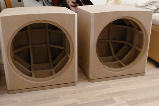

According to Bill, this is the most effective bracing strategy per mass...
I personally say, science/nature agrees...the structure of bird bones comply.
I said
and one of the his protégées said
Bill does...
Never said/implied it wasn't, just way overkill like 99.9 % of the DIY bracing I've been exposed to.
You want to compare it to bird construction? Pick one up after it's flown into a window pane, it's more mush than intact IME, so not a valid example.
Again, haven't said anything re driver vibration and if you go searching and find all the times I've been involved with this subject I tell folks that they need to tie all six sides together to keep it from 'breathing', so you're 'preaching to the choir' here.

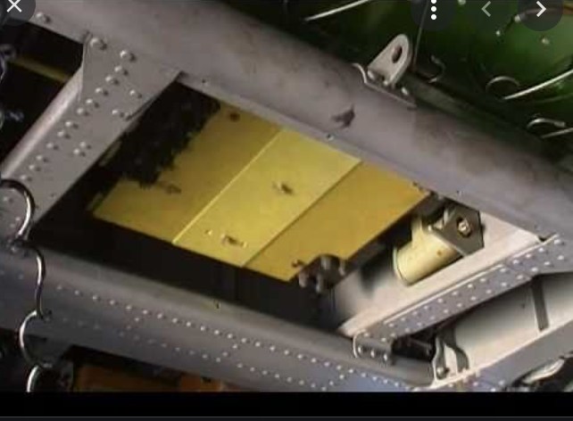

Maybe light cabs can employ some aerospace vibration management similar to the H-60 vibe-absorbers? A tuning spring, essentially-

@GM, can you elaborate more on that? MOE as in modulus of elasticity, right? If I'm following, it sounds like using the inherent ring of a light/stiff panel at a desired frequency where you then clamp it down via a top weight or use a base that will soak up the resonance. Very nice little tricks!
