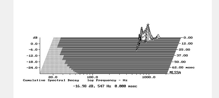

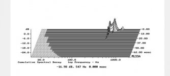

I wasn't tempted to open that debate, the only thing worth talking about regarding them is the enclosure if you ask me. The above chart looks pretty quiet I just wonder how quiet a properly braced cab of baltic birch compares.

MDF is bad for anything but subwoofers. Its just cheap heavy junk, unsuitable for high end fullrange designs without extensive damping and reinforcement. High grade marin plywood is by far the best cabinet material with the best compromise in stiffness and internal dampening. The novelty of using compromised materials for building enclosures has worn off for me. I would rather use tried and true good old marine birch plywood to get predictable results. Besides, you could always cover the enclosure with sheet aluminum or other material if you want that look.
I tested these materials here. The Russian birch ply was essentially the same as the MDF except at 900hz were the MDF had a real problem that the ply did not. The primary resonances were equally bad and there is no way I would spend the money I did for that Russian birch in the future. Not when there were much cheaper CLD methods that are easy to construct, like the 1/4" MDF glued together with Weicon Flex 310M adhesive.

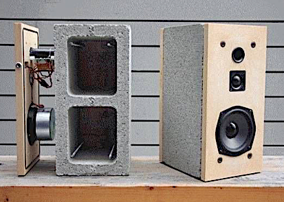

augerpro - did you by any chance test concrete? I raised the idea of including concrete in a previous post. I've just been looking at cinder blocks which can make an interesting "bookshelf" size 2 way, though you wouldn't exactly put it on a shelf.
Ever since I made a pair of concrete speaker cabinets when I lived in Norway I've been a fan. Haven't touched the stuff recently but I've been researching ready-made solutions like planter pots in 1 cu ft size. I just came across something brilliantly simple, so easy I just have to do a build. It would be about a day's work. Here's the idea:
Cinder Speakers Turn Concrete Blocks Into High Fidelity
Ballou Projects
Cinder Block Speakers | Parts Express Project Gallery
Classix II MT Bookshelf Speaker Kit with Baffle Only
And here's the hollow concrete blocks. The walls are 35mm thick. They weigh 26kg. I calculate each chamber as 4.5litres (145x145x215). They could be combined if an angle grinder could remove a bit of the centre section.
215mm Hollow 7N Concrete Block | Lawsons Lawsons, but also Jewsons etc etc
This looks the right size for a BBC clone LS3/5A. Plenty of kits available for that. Front and back could be baltic birch, MDF or 12mm aluminium. Or a composite of ply/MDF and aluminium in a constrained layer. Or whatever.

If I'm not mistaken, if one hangs the common cinder-block in free space & strikes it with say, a long piece of metal, it will ring a resonant frequency.
If the little woofer frequency range is within this resonant frequency, it will set the enclosure in motion.
As such, this frequency would have to be damped out.
Perform an experiment to confirm or deny this theory...a simple AF generator on your computer...listen to the two side by side to try to match the frequencies you're hearing.

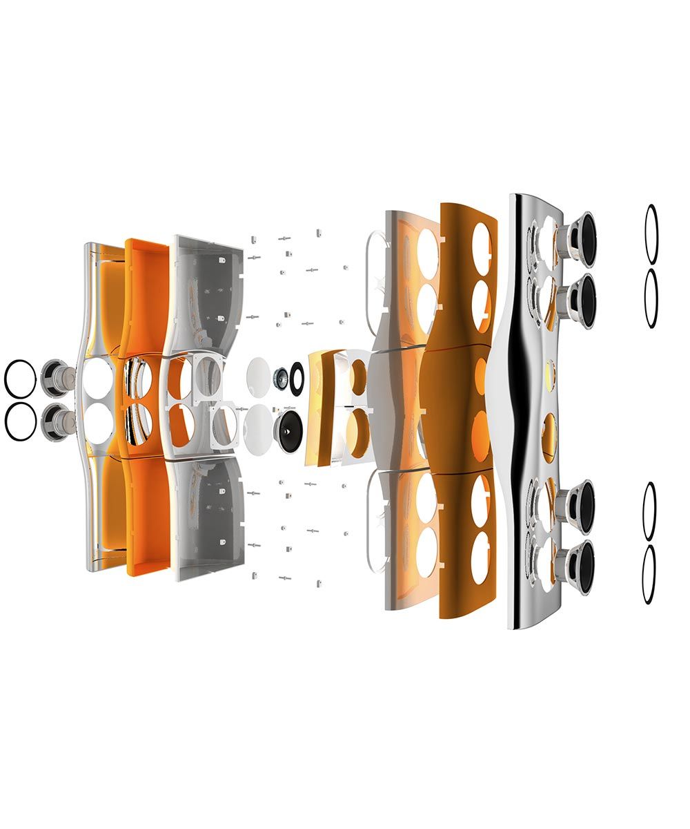

anybody knows more about these?
surprised these haven't come up yet - KEF Muon. The "exploded view" shows a lot of internal construction but no information whatsoever about materials, layering etc - anybody knows more?
