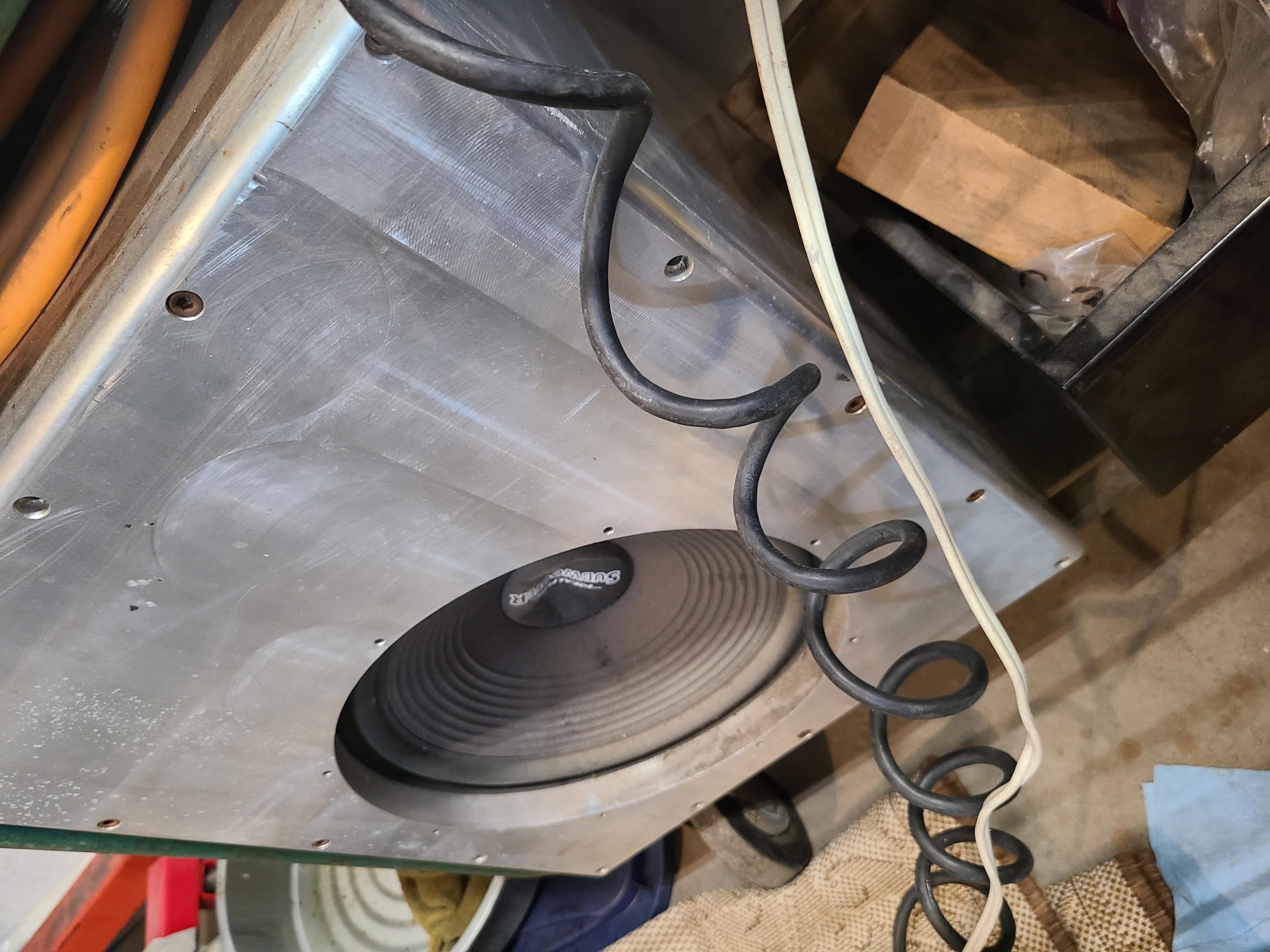

"what you can take to the bank is that Al panels are going to physically flex less than regular cabinet materials"
If you compare an alu speaker shell to a ply shell made with identical dimensions - like 1cm thick walls - then yes.
The 120kg alu box will be stiffer then the 30kg ply box.
However, if you adjust the wall thickness, so that both speaker shells weigh the same, then no. The ply box will be similarly stiff, assuming "regular cabinet materials" that are around 14GPa (rated F17 or higher).
My LF cabinet walls are about 4cm thick. The core is normal ply, the outer layers are stiffer (4mm of F27 ply and 5mm of strand woven bamboo)... so in theory this composite will be slightly stiffer than a 1cm alu wall of the same weight.
Again: not that it really matters. The cabinet was fine before I added the extra layers. This is all overkill.
In practice, heaps of mundane stuff - like moving from one chair to another - has a much bigger effect on the bass / sound quality I get.
After a basic quality level is met, it is probably better to look at everything else - dispersion pattern, EQ, room optimisation and so on, rather than to obsess about whether your cabinet materials are hyper premium enough.

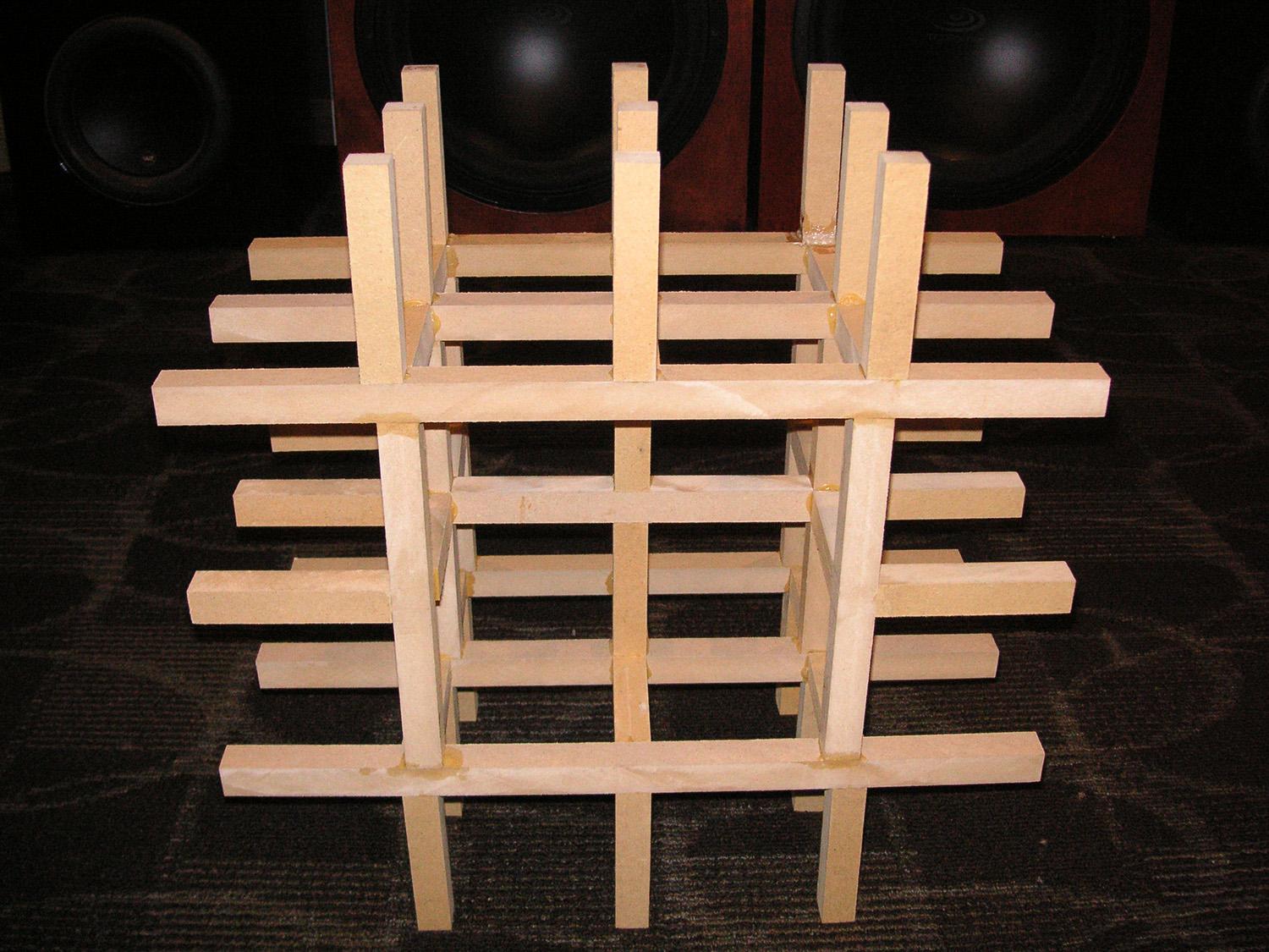

I can certainly test that theory. Now I did test a standard .75" x 1.5" oak brace (see my thread or website), but if you can provide specific guidance I can test that too. My boxes are (externally) 18"x8"x10.5. So a typical standmount speaker for a single 6-7" woofer. What sort of brace would you like me to implement?
I can give you a starting point but to be scientific we must acknowledge that different materials and various thickness of material require different bracing. Lets focus on the popular Matrix bracing which is a construct of crossbeams that reach from wall to wall, spacing and bracing thickness are are variables per material/thickness.
The approach from Bill is this
I use 3/4" ply, so to extrapolate the data ....0.5/.75=1.5(6)=9" so with 3/4" ply, 9" spacing......
This approach of Bills has been developed around Baltic Birch ply.....change the material and thickness, brace spacing changes. From a technical point of view I was told to study Flexural modulus, which I never did. Bill has been around (in the Diy community) for a long time, is an engineer, and is the only person I know of who confidently will say he can make a non resonate cabinet from 1/2 plywood.
I'm not advocating at this point, I am passing on the info sort to speak
Bracing101 2021 - BillFitzmaurice.info
I took this info and did something else with it but I think since this Matrix bracing has a following as well as the fact that there are manufactures using this strategy as well. Its a good starting point.
1/2" plywood complimented by 6" spaced 1" thick beams
Way overkill unless a bunch of them are going to be stacked/arrayed and/or going to take a beating in transit. With that much bracing you could skin it with 1/4" no void ply in a HIFI/HT app.
There's still the [lack of] mass issue though, so put removable weight on top as required.
According to Bill, this is the most effective bracing strategy per mass...
I personally say, science/nature agrees...the structure of bird bones comply.

- Aluminium speaker cabinets
