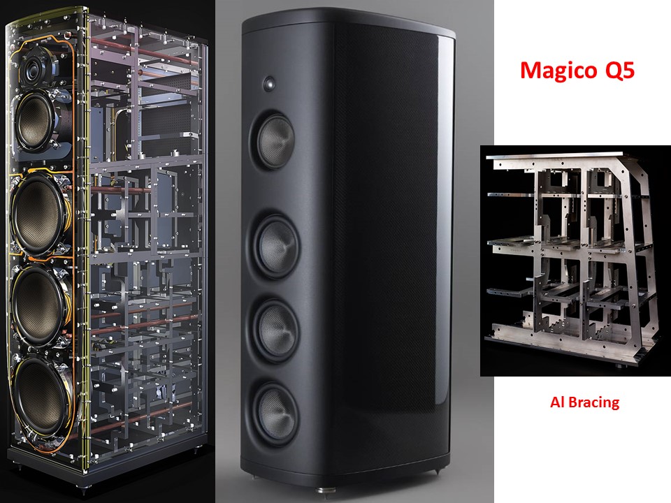

Silicon Valley company MAGICO with speakers like model Q5 is the leader in using aluminum for bracing and shaped external panels.

The magico seem to be all talk and no data....wheres the data showing how Quiet the enclosure is compared to a properly built baltic birch cabinet....I highly doubt this is available...this, in my opinion, is the land of diminishing returns...the last few percent's of performance in order to claim a product as "king" and justify charging you a ridiculous price for the clout.... #provemewrong
