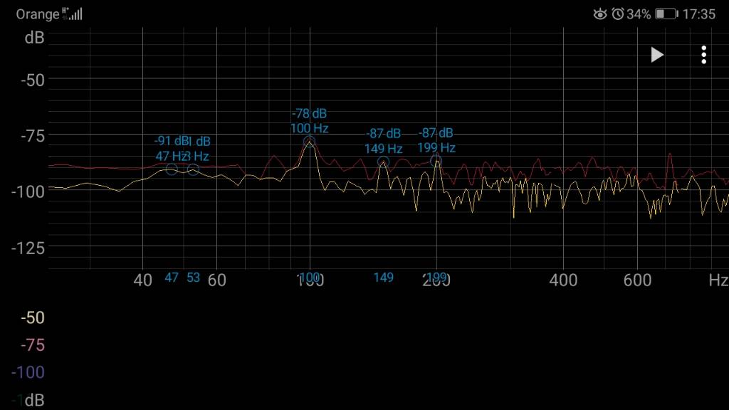

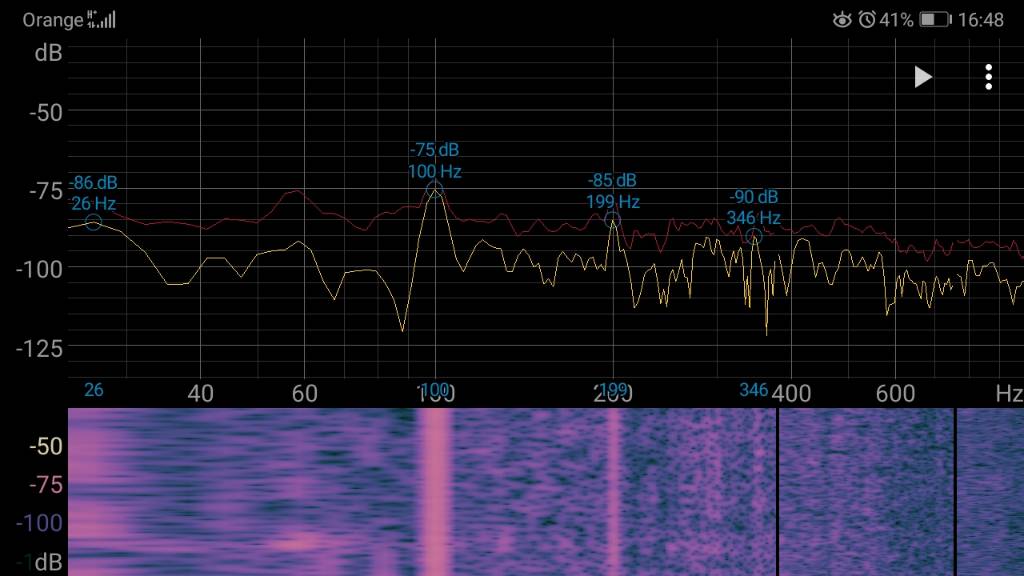

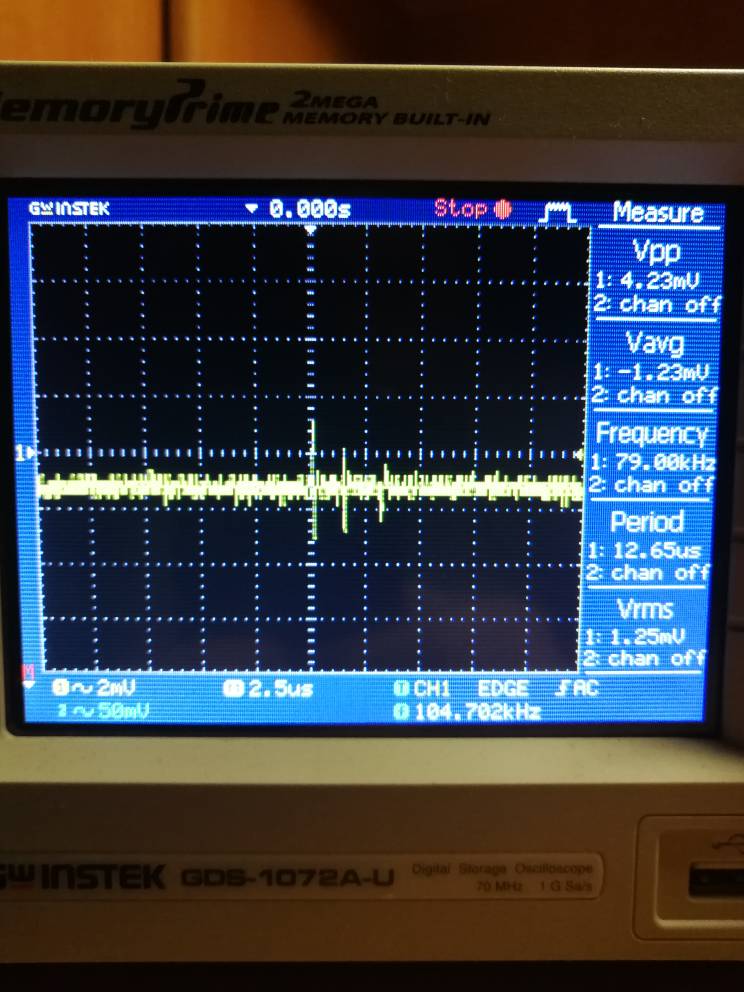

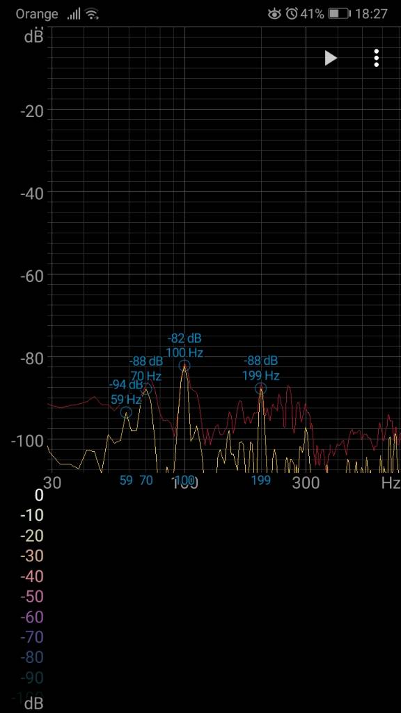

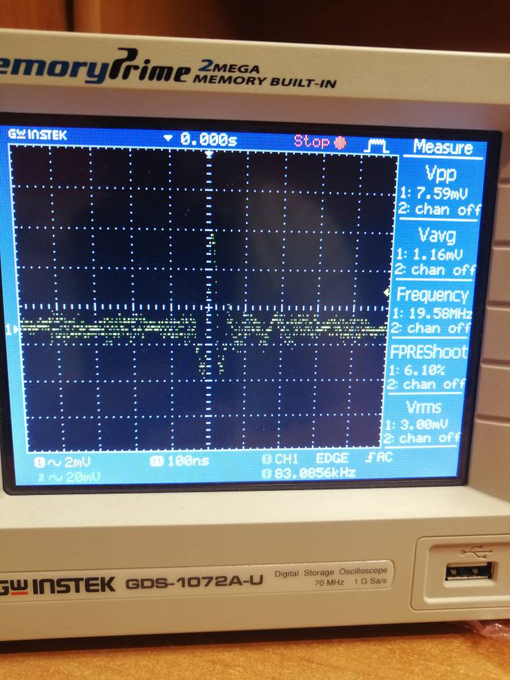

I tried to measure the noise with the oscilloscope but I think I was doing it wrong or too weak oscilloscope. DMM also has too little accuracy. I just hear the noise and I know what frequencies they are from the phone application. I know this is inaccurate but you can find differences in the pictures.
First one Ischikawa board, second Mountain View.
Third is noise on oscilloscope
darrr,

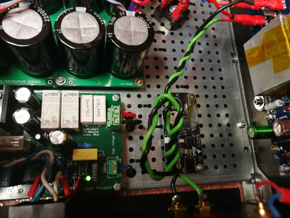

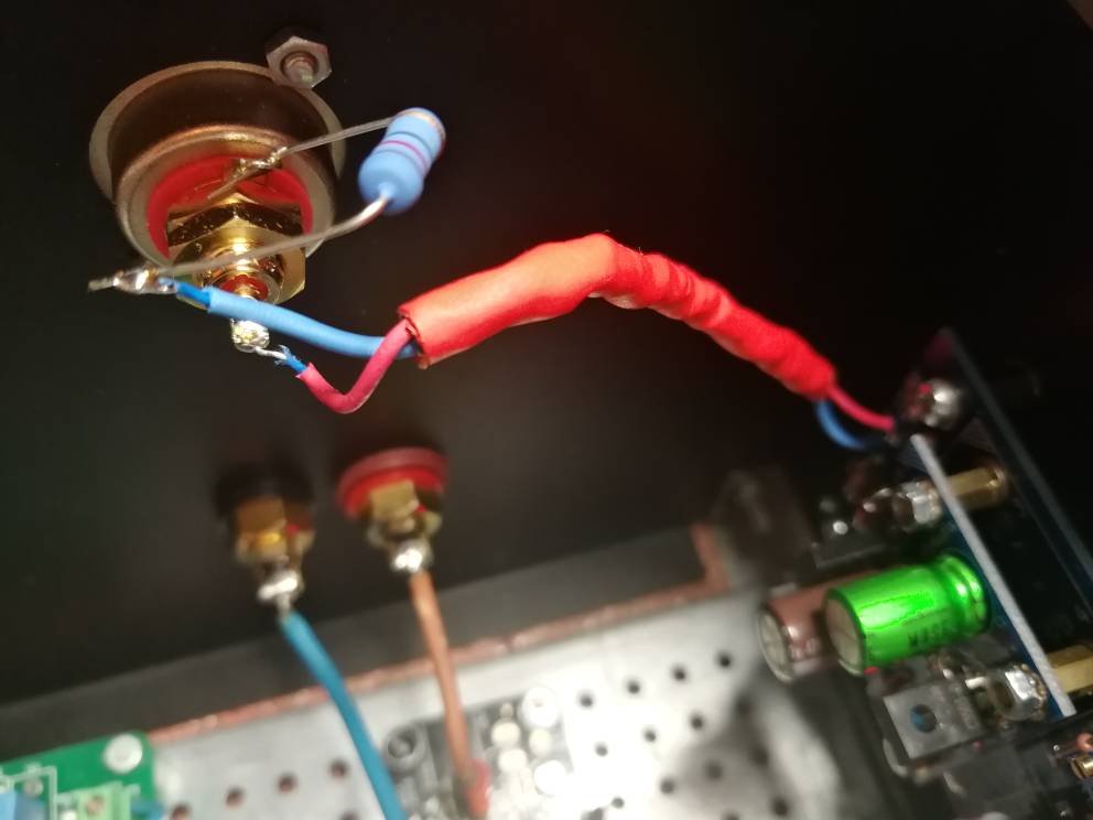

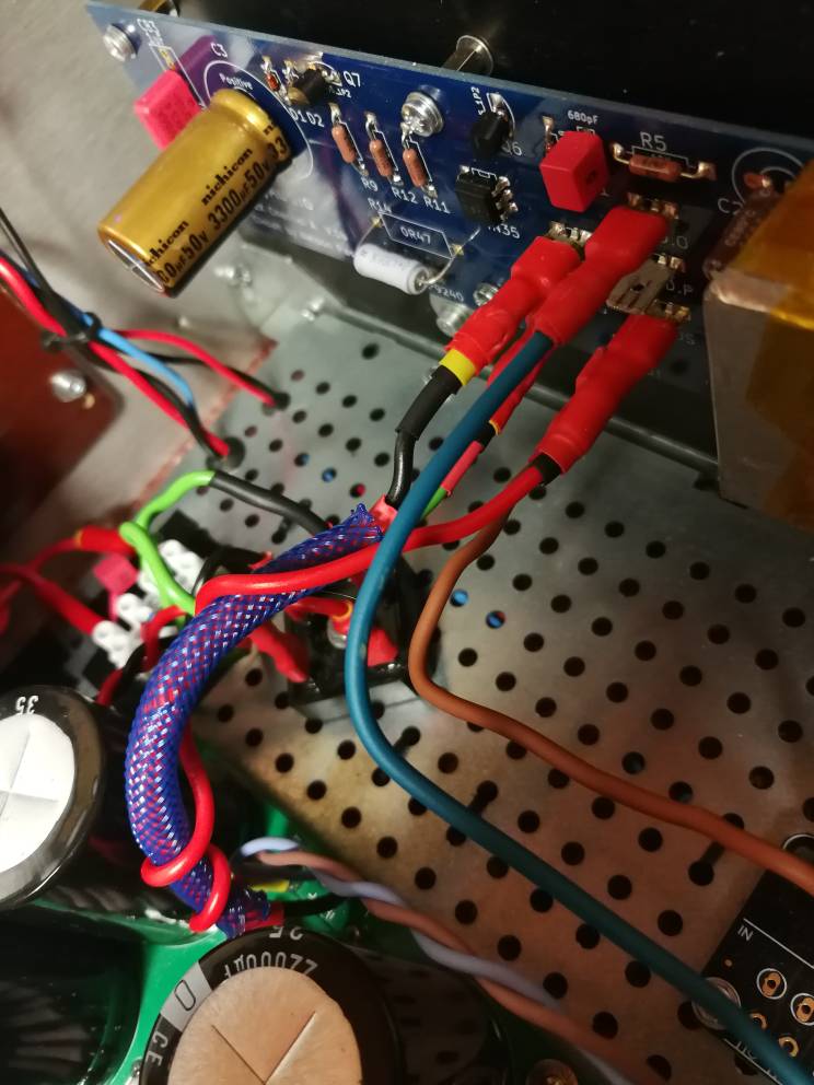

Looking at your wiring diagram I see that you have a ground wire with your V+ and a ground wire with your V- to each amplifier board. That is not a good thing to do. You should only have one ground wire to each board from the power supply and it should be twisted together with the V+ and V- wires for a twisted group of three wires.
As with Jeff, I also believe in twisting wires with their returns, which was strongly advocated by the late Andrew T, RIP.

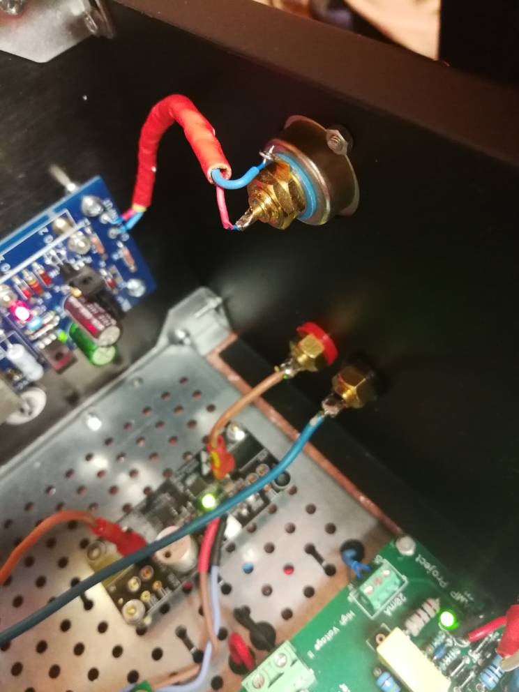

So I also would twist the speaker out from the board with the ground wire to the speaker protection board and then continue the twisted pair to the speaker output at the back panel. Another thing you could do temporarily is to take the speaker protection board out of the circuit to reduce the variables that may be causing hum. You can put it back in the circuit once you have solved the problem. It may be that it is part of the problem.
Thanks Ben 🙂
I have already made your first suggestion. When I drew diagram even noob thought it was unnecessary. Unfortunately, it did not make a difference.
The second and third suggestions are to be made after replacing the wires. Now I have 12ga solidcore which is hard to twist.IMG_20201221_224418.jpg

Following your advice, I bypassed the speaker protection tabs. I didn't notice the difference, but I'll try to use the loudest input card yet.IMG_20201222_003412.jpg
Are you getting noise with some input boards and much less noise with other boards? If that is the case, it appears to me that the issue is with the input boards, not with the power supply or the rest of the amplifier. Jeff has already told you that the ripple of your power supply board is according to design.
You should sort out your issue with measuring the amplifier output with your oscilloscope and get some accurate noise measurements. Did you put an 8 Ohm resistor at the amplifier's speaker output for the measurement? Did you short the amplifier input?
Thanks to a lot of help from all my good friends in the forum, I came to a conclusion.
I can confirm that the worse PSRR of that input card is the cause of 100hz noise. At the same time, many people wrote that there is no problem using a universal power board from the diyaudio store. Therefore, I am waiting for advice from Jeff whether it is possible to reduce the ripple in some simple way.

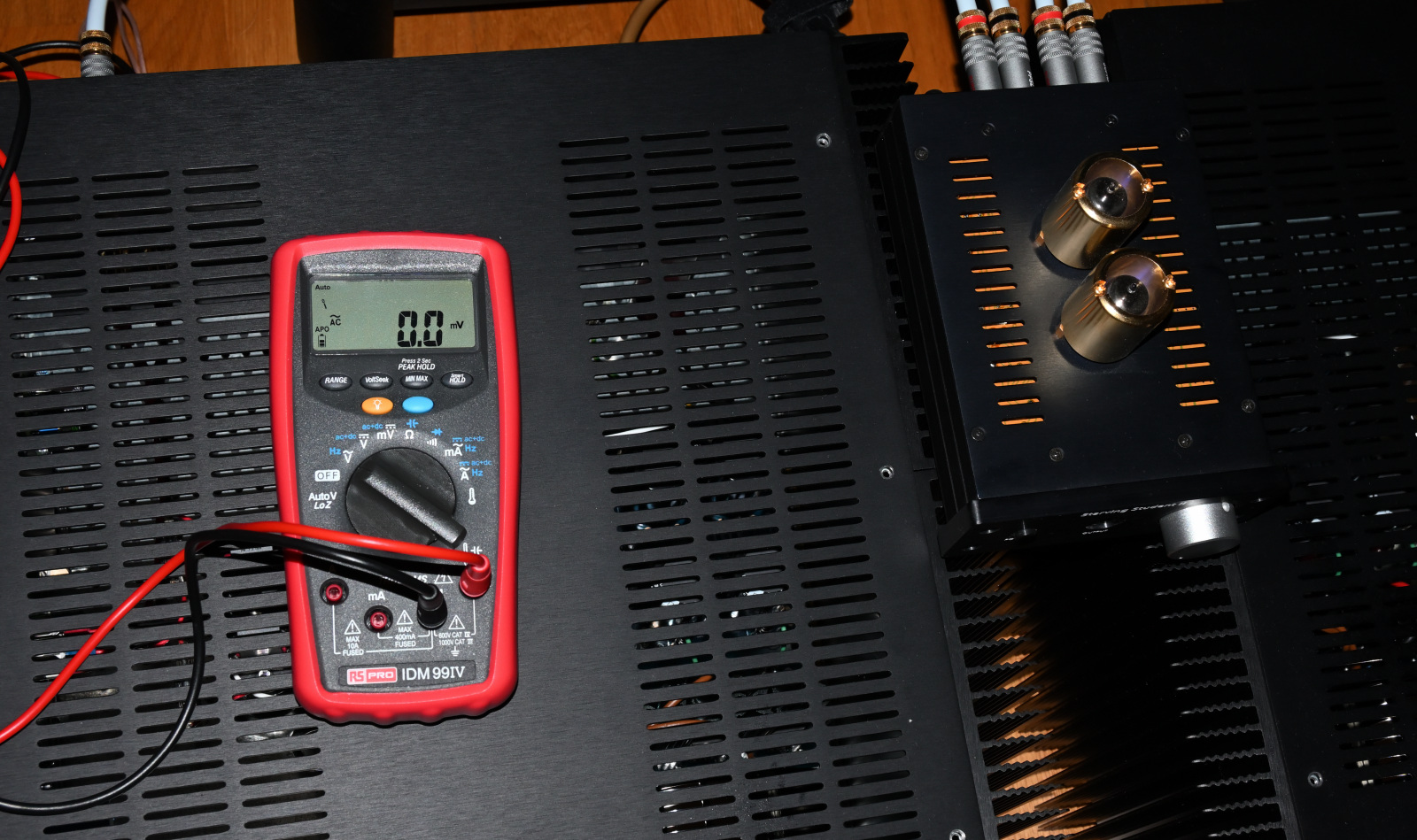

It is possible to get M2X very quiet.
Here I measure AC mV at speaker out with speakers connected and preamp powered on....but with no input signal. Input board is IPS6.
I have been through some iterations of the PSU. Mainly the rectifiers which are low Vf Schottky types. PSU is CRCLC and M2X built as mono blocks.
If you can't hear any hum-noise at listening position then be happy for now and enjoy some music. Then built another amp next year and when you have another working amp then go back to M2X and maybe re-built the PSU or just modify it.....if you know what to modify to get it more quiet. Maybe you will know after another built.

Pics input wires.
I improved the wiring a few times, changed the connection method, also without speaker protection cards. I didn't found improvement.
Mountain View cards are the problem, or rather their worse PSRR. IMG_20201222_224704.jpgIMG_20201222_224723.jpg

I'd like to go back to Ben's point on noise measurements on your channels.
Can you please try measuring with inputs shorted, and with say, an 8 ohm resistive load?
Try it with both your scope and with a multimeter (set to AC and mV scale)
Being able to quantify the noise level will help you evaluate changes.
The loudspeaker is the load, the inputs are shorted . I have a dummy load prepared, but I don't know if I can do it with a resistor today.

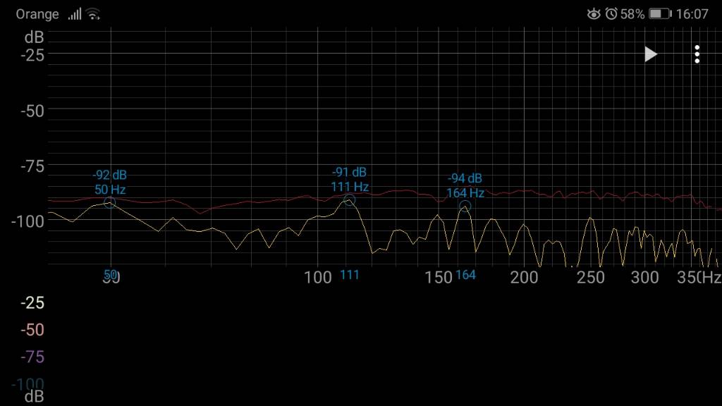

I know it's inaccurate, but since the ear can hear it, so does the smartphone. One channel with a resistor, the other withoutScreenshot_20201223_173540_org.intoorbit.spectrum.jpgR%20chn%2012r%20input%20gnd.jpg
