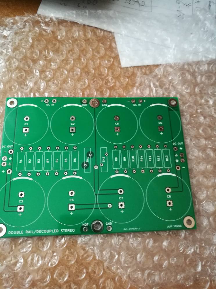

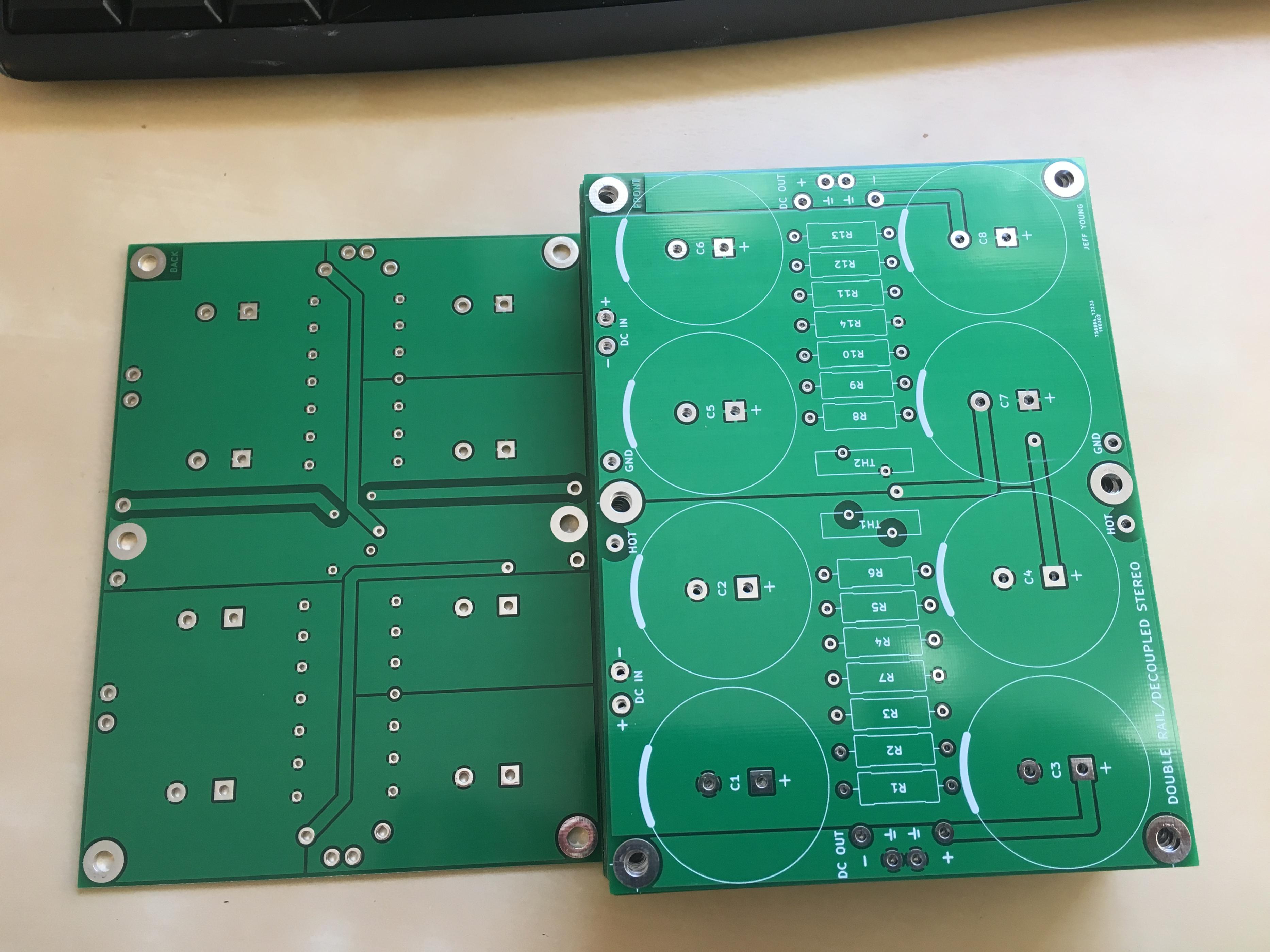

Boards are in - way faster turn around than expected. 4 left up for grabs. PM me if interested. I'll PM those who have some reserved to finalize details.

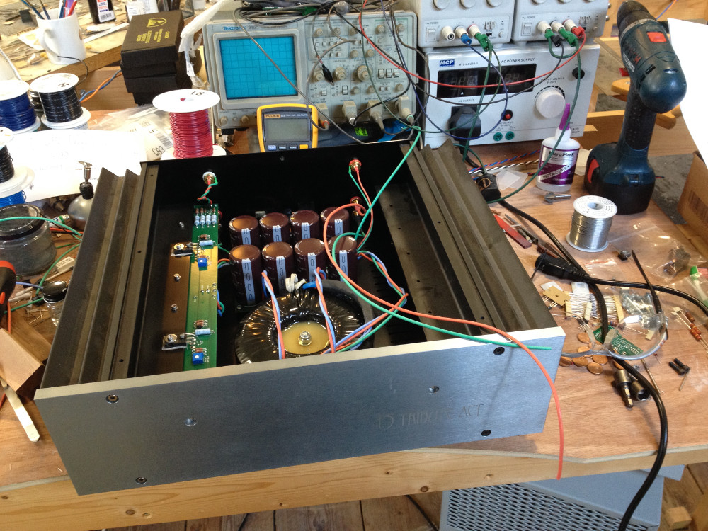

I received a few dual boards from different sources. Doing a repair on a simulated F7, so changing the store power supply board to this one. 🙂
Please post when you have it Fitted and had your first fire up impression.

I have two simulated F7s, so it's easy for me to test. 😉
Hi Jeff, just placed order for these PSU boards and rectifier boards also. Thanks for sharing! Btw, where do you get those First Watt look-a-like cases? Would love to build one also.
that is a nice build - picked up 2 of these PCBs myself for a potential F5 V2 build ..dB

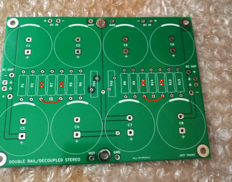

I want to use two pcb, each for one channel. What changes should I make?@darrr, wirewound are fine in this application (better, if anything).
This board is designed in such a way as to not need two boards. It's the exact purpose: one board for 2 channels.
Indeed, this board is designed to need only one.
However, if you did want to use two, you can:
1) delete R3, R4, R10 and R11
2) change R1, R2, R5, R6, R8, R9, R12 and R13 from 0R33 to 0R47
3) solder a jumper between the lower holes of R3 and R4, and one between the lower holes of R7 and R8
Use as large a wire as you can fit for the jumpers.
Jeff.
Jeff.
Why does the resistor value matter?
thx.
@vdi-nenna, it doesn't really. Higher resistance will give you more ripple rejection at a lower voltage; lower resistance less rejection but higher voltage. The difference between these two values though is probably in the weeds; I mention it mainly for those who want to stay close to Nelson's original design....
