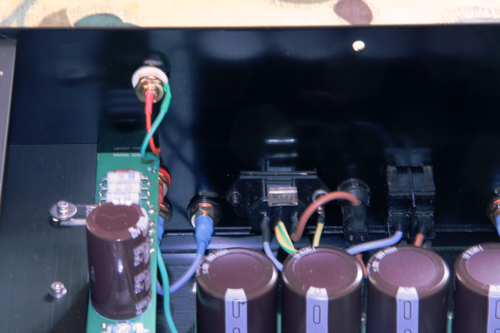

For a 110V implementation with two parallel transformer primaries I'd recommend doing the thermistors off-board as in 6L6's build guides. (The current board is based on a both a single thermistor and a single primary winding, which significantly reduces the number of connections required.)
6L6's method will also give you a location for the line suppression cap.
FWIW, with a single primary and the thermistor on the board, the easiest location for the line suppression cap is directly on the IEC inlet:
I honestly don't see anything with tightly twisted AC wires going from the back panel right to the front panel where the transformer is.
Would it be safer practice to put the suppression cap after the switch somewhere to avoid it being constantly subjected to line voltages?
It's also well documented that when certain RIFA line rated caps fail they short! I just learned about it myself from Dave Jones' video, but a google search shows incidents going back for years:
YouTube
I have a handful of these surplus RIFA caps and just be safe I tossed them.
It's better/safer to put any filtering after the fuse and switch in case of failure.
YouTube
X1 and X2 capacitors are designed to fail short. That way they trip your circuit protection.
And yes, as I said above, in a 110V country I'd put them after the fuse and switch as in 6L6's build guides.
Here in Ireland (and in the UK) all plugs are fused, so I like them at the entry point to prevent any RF incursion into the chassis. YMMV.
