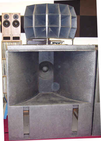

For the comb filtering, are you talking about the multicell horns? I've always wonder about that, how do those darn multicell things work? In my experience with them, I sure didn't notice any comb filtering. In fact, they were the best sounding horns I've ever heard. The 1505s, that is. My experience with the big 1803 is limited. It certainly has its fan, tho.

Right, each cell + common throat + driver approximates a dustcap shod HE 'FR' driver of equivalent Sd, so just think of all the standing waves, overlapping BWs and discrete beaming going on, especially with one with as big and many cells as the 1803.
The 1505 is bad too, particularly in stereo due to its wide coverage angle creating excessive early reflections off side walls in all but the largest typical HIFI listening rooms. Up to a point all the multi-cells are incredible performers, but for HIFI they ideally need to be BW limited to their actual gain BW and let a CD tweeter do what it does best to complement it. IIRC, the pics I've seen of the system you auditioned used JBL 'baby-cheek' tweeters. Did they have them in your time?

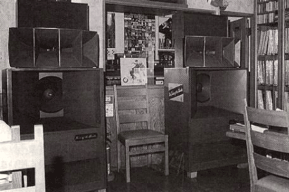

Cool! Here's some 311-90 A5 variants with a 511 perched on top, though I don't have a clue what the XO points are:

Hi GM,
Is the A5 cabinet narrower than the A7? The reason I am asking is that horn you call a 511 in that pic seems to be as wide as the cabinet whereas the 511 on my cabinet is not. There a couple inches either side.
Was the 311 part of it referring to the horn?
Help me. Help me please.

No, they are one and the same beginning around the mid '50s. Before that it was mini-210 sized (see attached).
Right, the big horn that ~looks like a 511 is actually a 311-90, the large format driver cast alum. version of the W.E. 329A 300 Hz sheetmetal horn. The relatively puny 511s are spaced up in wood boxes above these and offset to the rear to apparently align the VCs.
GM

GM said:Right, each cell + common throat + driver approximates a dustcap shod HE 'FR' driver of equivalent Sd
Makes sense, but it sure didn't sound that way. Smooth as silk, very "real" sounding.
That may be why they worked so well for me. Never heard them in a small room. Medium to large room, to jazz club, to ballroom, to outdoor. Listening distance was often close, tho. ~3 meters. Very palatible 3D image. No close your eyes and imagine stuff.
Correcto! But when I used them it was bullet tweeters, JBL 2402, IIRC. Don't remember what the crossover was like, execpt passive and massive. 2nd order, I think. Many times I simply didn't hook up the tweeters. Sounded fine to me. I could always "hear" the tweeters, they sounded good, but not real. Maybe I should have just turned them down. 🙂
