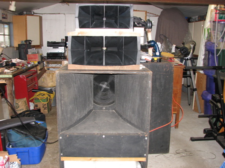

I have now received my bolt on midranges so I started with this pole mount.

Hi Cal, how are you crossing over from the 500 to 800? I have an idea that needs more thought. Something like load sharing.
Hi Geoff, the XO's are approx 650 and 5K, 12 dB
Also, what's that up in the top left in thes last pic? [/B]
Part of a kitchen cabinet set . That is the lower corner cupboard I have stuck up on the wall. It's where I keep my stash...
...of caps coils and resistors. 😉
You don't have to wait for spring, it's summer over here.[/B]
Thanks buddy. Strong winds and rain mixed with snow here. You really cheer me up.
panomaniac said:
Stack O'Horns! Love it! What are the drivers?
The lower is a Selenium D250-X on the 511 horn and a Selenium D205Ti on the 811. The woofer is a Selenium WPU-1507-QCF.
Ah ha, I was supposed to stick the D210s on the 811s to have a listen, never did. How are the D205s?
