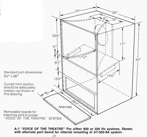

A question on the A7 and similar. The plans I have look as though part of the driver fires behind the flare of the mid horn, or do you cut the hole with straight sides to match the sides of the throat.
I just cant see why you would bleed part of that energy back into the cabinet, or am I missing something?

Geoff,
The A7 cabinet is the one in my avatar. The mounting board (baffle) is solid and larger than the woofer so no sound slips back into the cabinet. The drivers are back mounted so the space between the mounting board and the throat opening acts as a compression chamber and sends it all out the front.

Thanks Cal, what you say makes sense. However the diagram looks as though a 8" wide throat is on a 13.25 hole. Allowing for the thickness of the flare, leaves a gap 1.85" wide behind the flare. The baffle is only 18 inches wide. Now that's baffling.
I have attached the drawing, it's probably well known to you.

All the cab designs in this version of the speaker enclosures manual are basic almost to the point of being worthless to the neophyte that it was at one time geared to. Here's a better drawing of the early 825 cab and a later version of the 828 cab you referenced that has a full width baffle: http://www.lansingheritage.org/images/altec/plans/1968-enclosure/page09.jpg
http://www.lansingheritage.org/images/altec/plans/1970's-lf-plans/enclosures11.jpg

Hi Geoff,
My throat opening is only 7.5" and the baffle is about 18" +/- The baffle does not cover over the inside of the flare and there is a gap between the edge of the baffle and the side of the cabinet. I have heavily stuffed the inside of the flare. If I remember I'll snap a pic next time in the shop (not at my house)

Yes, the better drawing says it all. The gap I was seeing is covered by the cleat.
When I built my 411 boxes, I used 2x3 hardwood frames (big cleats!) as I was not real good with timber, and that gave me tons of glue area so they weren't gonna leak. Screws about 8" apart, so they weren't gonna rattle. 2x3 brace just below the driver, tied to one on the back. Another between the sides. I allowed a cub foot for the bracing/frame. My mates thought I was nut's. If I was it was due to other reasons.
