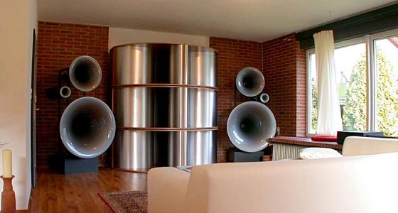

matt28sr, be assured, you were not the culprit. 'Twas me!
Interesting story about your 508s. I think all floor standing Altecs have a sound of their own. And those that know it, remember it. Like you, my current main system is not Altec, but Altec inspired.
No, they're not mine. They are in this interesting article.
http://www.gtaust.com/filter/04/09.shtml
http://www.gtaust.com/filter/06/08.shtml
http://www.gtaust.com/filter/05/07.shtml

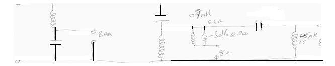

Hi Cal, what I was thinking with your stacked horns, was to try shelving the the lower horn at 1200, rather than rolling it off.
Seems a shame to have that horn only covering a bit over an octave.
See the rough sketch attached.

Hi Geoff,Geoff H said:Hi Cal, what I was thinking with your stacked horns, was to try shelving the the lower horn at 1200, rather than rolling it off.
Right now I have just fooled around with fixed L-pads but I hear something a bit strong and I think it's around 1-3K so I'll experiment with some notches and see if I can tame it a bit.
Isn't a shelving network just another name for a fixed (non-variable) L-pad where you have incoporated the frequency of shelving independent of the XO? If so, that's not quite what I wish. I just wish to rework the padding so I am able to get more off each end of the midrange and cut back the middle a bit.
Seems a shame to have that horn only covering a bit over an octave. [/B]
600 - 5K is what it covers
See the rough sketch attached. [/B]
Thank you.

Shelving, as I understand it, ie on the Barcelonas (Altec network #30904) attenuates the lower end of the horn, without as much, if any, on the top end. Just flattens out the response. On the 411 based systems, there is a big difference in sensitivity, 8 or 9 dB from memory.
FWIW, when I have played with that sort of thing, found it easier to disconnect the top end, run the "mid" on high pass only. Once that's sorted, work on the top end.
Wouldn't life be easier with 2-20 uf variable caps?
Don't take the values on that drawing as gospell. They're calculated on 8 ohms resistive.

Cal Weldon said:Hi Geoff, the XO's are approx 650 and 5K, 12 dB
The lower is a Selenium D250-X on the 511 horn and a Selenium D205Ti on the 811. The woofer is a Selenium WPU-1507-QCF.
Greets!
Ah, OK, my comments assumed combining them over a wide BW to take advantage of the smoother, more robust response of the larger combined mouths. FWIW, using an 811 as a tweeter will in theory sound more cohesive with it positioned between the 511 and woofer, but never having heard the combo either way AFAIK............. with your nifty tie bkt. it shouldn't be hard to try though. 😉
Interesting about the Seleniums, seems to me these were discussed awhile back on the HE forum and the consensus was that they wouldn't mate well enough with the 511/811 to make extended, high SQ HF.
GM
