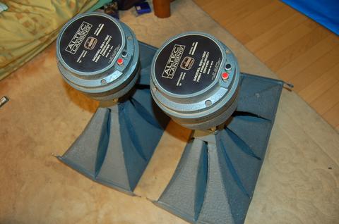

Since your'e going for full tilt on ALE compression drivers...
Try to get another matching pair of 416's - then separate each pair per channel, for dual drivers per bassbin... You could try the so-called "Onken W":
http://www.audioasylum.com/forums/HUG/messages/110602.html
http://www.audioasylum.com/forums/hug/messages/102764.html
You could email the poster who owns the system above for more detailed plans. BTW, if you got the ALE drivers from Kevin Brooks why don't you ask him for suggestions...
http://www.melaudia.net/remOnken.php
http://www.melaudia.net/litterature.php
The old French articles here are in HTML, at least you could do an online translation:
http://www.ispra.net/audio/Onken/onken.php
fred
While Zen's having a green dream (with envy) I'll announce that jealousy is a curse. (and IIRC he's second in line for a set of plans)

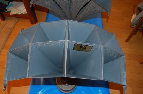

I think I have enough views of those big horns to draw up plans. They'd be good on the workshop shed pointed at the paddock, and my neighbour that likes trance at 2 in the morning.

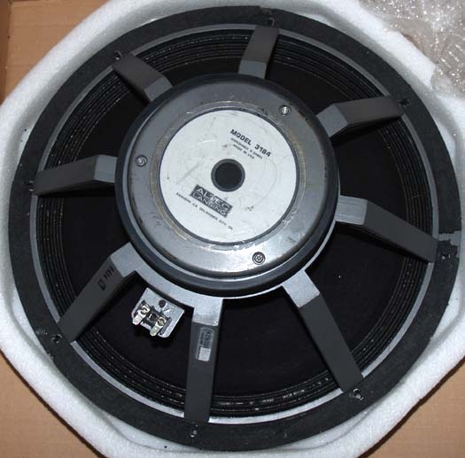

Are you planning 2 of those 3184s in each cab? Then stack a 511 on top to stay ahead of Cal.
The horns look in good shape. Nice.

No auditorium, just something I had to do. Wasn't happy with the old woofers, that's all. ;)
515B`s or something else? Were they faulty or just insufficient? I have some 421 8H SII in my four tiny 816A bins. Probably better drivers available now for reinforcement work although with nothing to compare to I think they are pretty good.

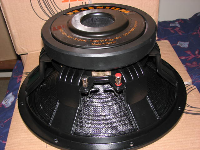

If the published plot is reasonably accurate, this driver seems a poor choice for the 210 unless XO'd down around 216 Hz. It looks like the Brazilians have finally gotten their 'act' together though, the Seleniums I viewed/auditioned 5-6? years ago were really bad compared to Altecs, JBLs, but then they were a lot cheaper too.

They were Pyramid car drivers and the foam surrounds were contacting the baffle at high excursion. These now match the units in the A7 cabinets.
That will be just fine. I run them from a plate amp or with an active XO and regular amp. They are not likely to see above 125, although I still have the passive network in there at 250 2nd order if I wish. They are only to augment the low end from the 825 cabinets. I am continuing to fool with the padding and notching of those. Getting close. It will make a nice loud system when complete. Only problem is, it's winter...
It looks like the Brazilians have finally gotten their 'act' together though, the Seleniums I viewed/auditioned 5-6? years ago were really bad compared to Altecs, JBLs, but then they were a lot cheaper too.[/B]
Build quality and price have gone up. All of my pro gear is Selenium and I have no complaints.
