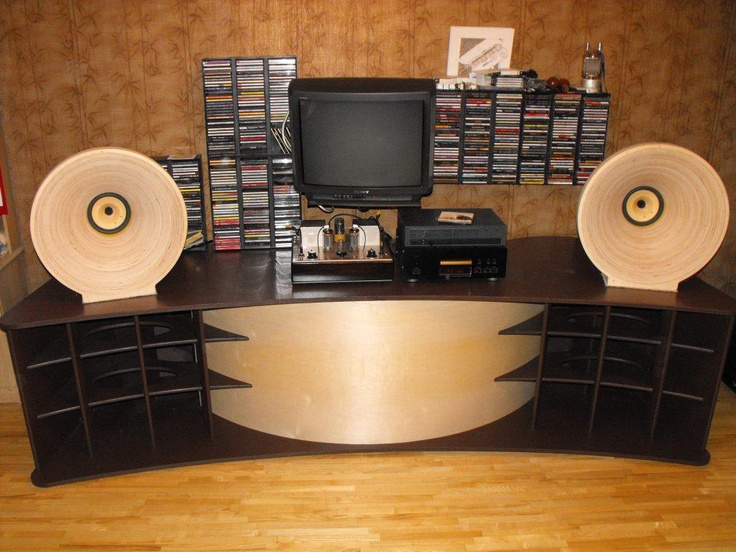

here are my 212 8a hiraga style
slr,
How did you determine slot and how did they turn out. Ill be cutting wood in a week or so.

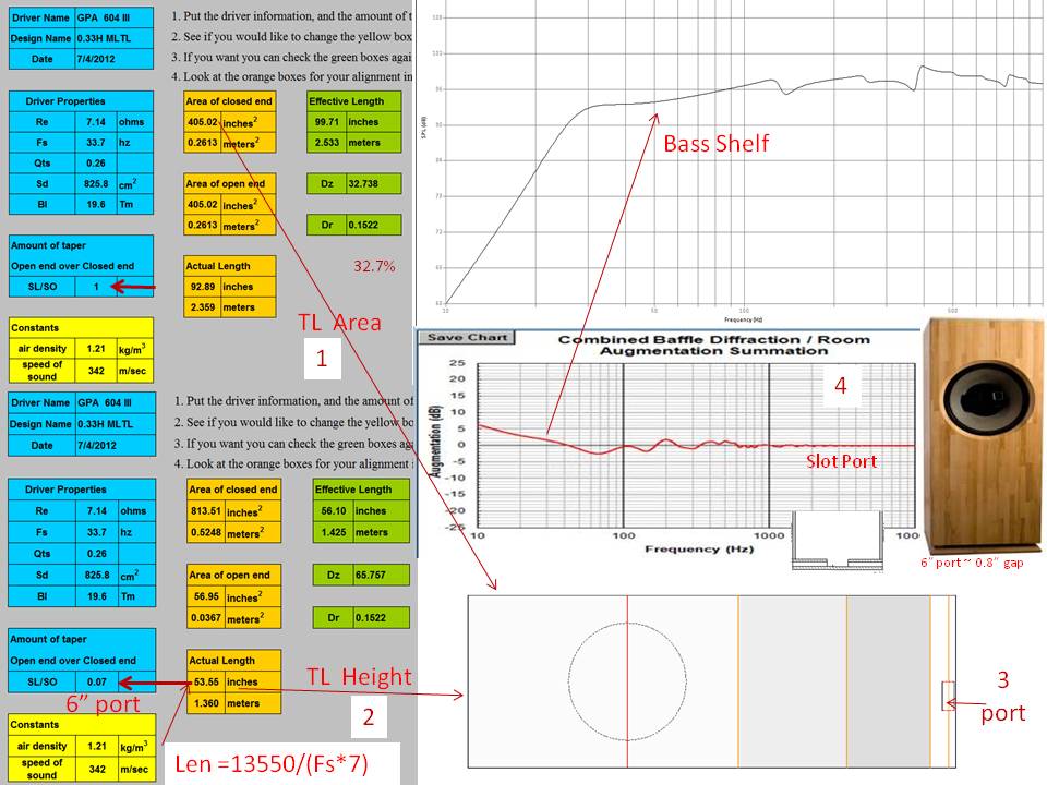

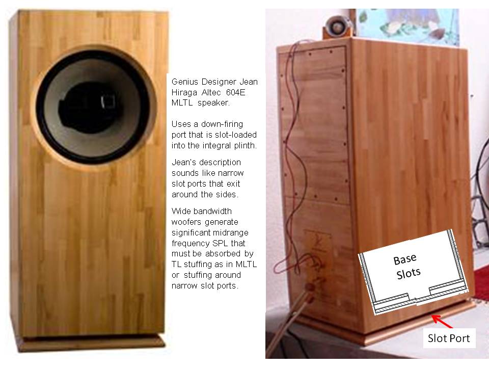

I PLAYED_WITH a few sims of an MLTL for the GPA604III with the idea of a Hiraga cabinet clone. I really like the look of Jean's clean industrial design. The total bottom 3-sided slot area matches the area of a 6" pipe port. Some room gain effects were factored into the sims. There was some discussion of using removable shims for adjustable lift of the cabinet above the bottom plinth to provide changing the port tuning. Round-over of the bottom cabinet edges and the plinth edges should perform like the rounded flange on a pipe port.
You will want to use the exact T/S parameters of your 604-model and run final cabinet and room gain simulations. I'm happy to further share my sims if you decide to continue in this direction, but stuffing material and technique play a major factor for MLTL performance.
I am interested, as my current designs will port to the bottom of the cabinet.
