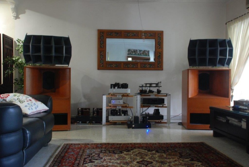

Very nice! 1505 horns? The bass cabinets look great. A custom build?
The posts look to be stock size. Are they? I've had better results with smaller ports.
What drivers are you using?
I have a 3-way Altec VOT with active sub - Altec 288-8G for the 1505, GPA 515-8G woofers/828 cabinets, Rythmik 15HP subs and JBL 2404H horn tweeters.
I use an active crossover at 50Hz, 500Hz, and passive 1st order at 15KHz for the horn tweeters; biamped using We 91a 300b monoblocks, 26 tube preamp, Tetra Sans Phono Preamp, Gyro SE TT and Marantz SA-KI Pearl CD for source.
Very happy with the sound produced.

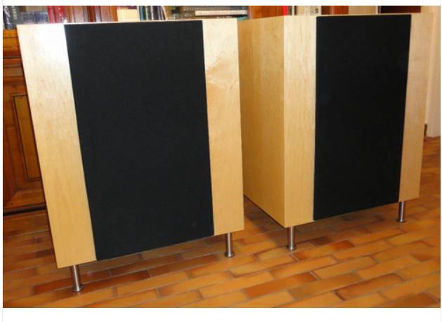

Hi every body.
does someone knows those speakers please?And could tell me what is all about. They are on eBay .
Many thanks
Pascal
I'm guessing home-built cabinets with Altec 604-8Ks in them. They look like nice cabinets, although I'd want a good view of the driver cones etc. before I bought.

Semelec was (is?) french GPA distributor.
thanks for your replyf Fpitas.I gonna ask the guy to send me photos ....He told me every thing have been refurbished .And then , need to listen to them! it' an eBay "by it now" and the price is 2990$;Correct???...
