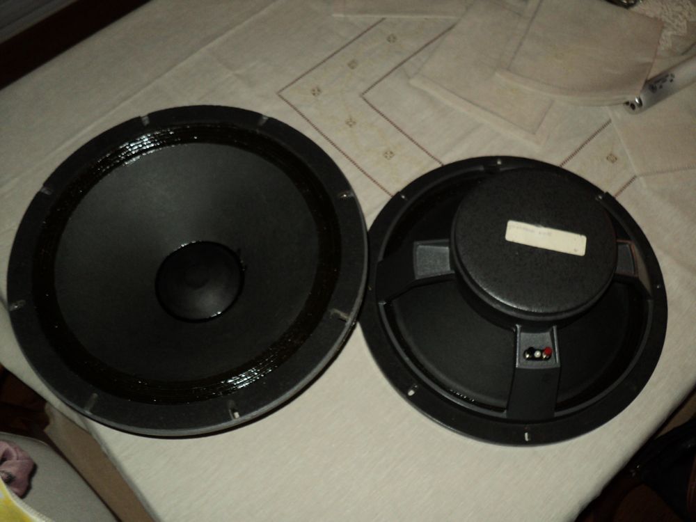

So that is a suitable cabinet for the 416C? I seem to remember a 45º bevel at the ports but I don't see it in those photos. Is the bevel an improvement, not necessary, or something I shouldn't do? It does have a visual appeal.
Just my opinion ...
No argument from me pb. I know what they can and can't do. 🙂
BTW, my babies are back from the hospital today. Sorry, wife's camera, hard to see how beautiful they are.
