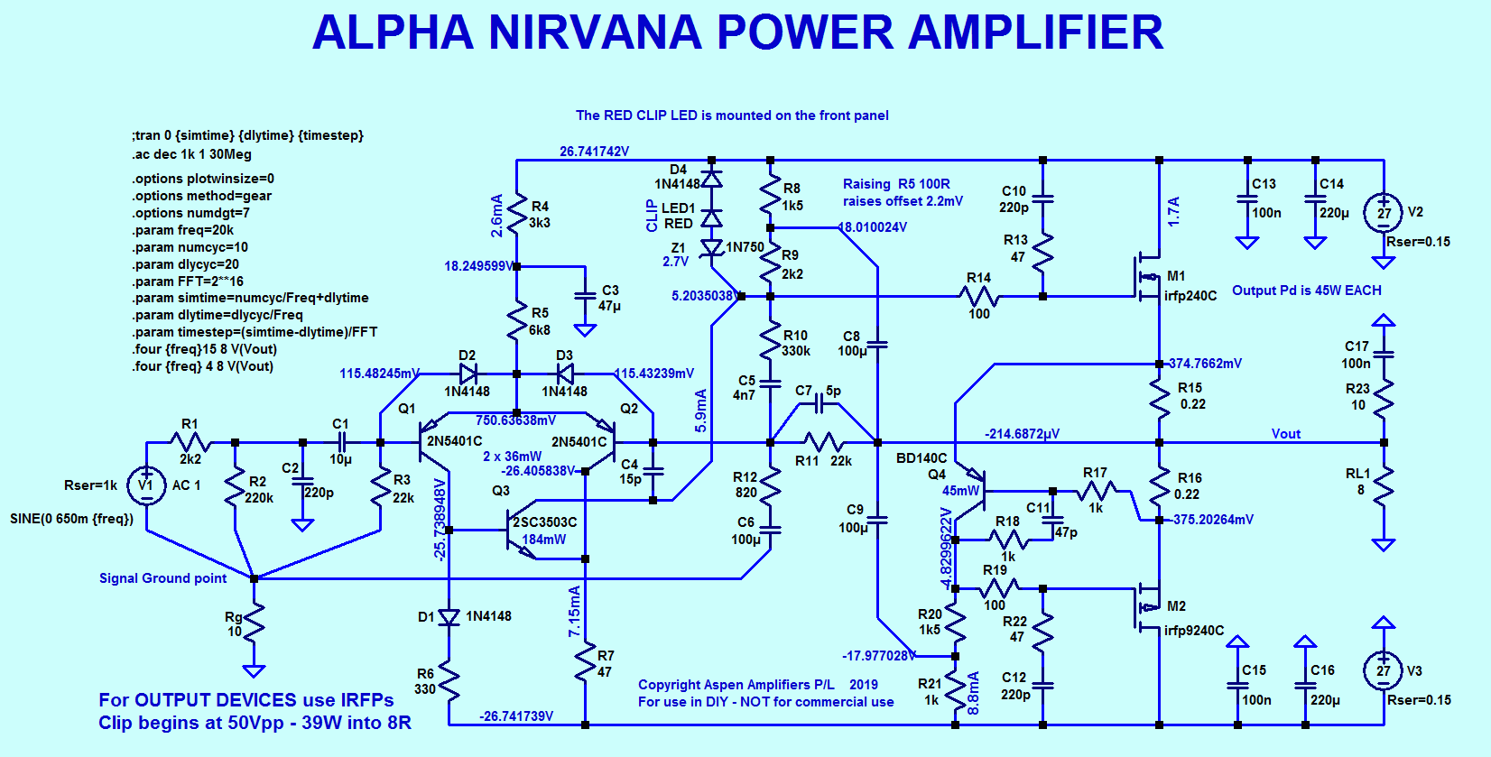

Here is post 88 schematic:

I don’t believe that is the final schematic that Hugh produced. As that one has a 47R between the emitter of Q4 and source of N channel MOSFET. Here is production board schematic:

I have searched through the thread but cannot find any later version of Hugh's schematic (than the one in post #88).
Yes, of course you/JPS64 have turned this into a different schematic (which uses different component numbers) - which matches the PCBs you produced.
Anyway, I updated the 8R BoM with your 'As Built' notations in red.
NB: Except for R171, which I have left as the SL15_47003 specified in the BoM (as per your email instruction).
Hopefully, this is useful to some people. 🙂

There is another thing I cannot reconcile between the 'As Built' schematic and Hugh's (blue) 8R cct diagram:
* Hugh's 8R cct diagram has C10 & R13 connecting the +ve DC rail to the Gate of M1.
Likewise, C12 & R22 connect the -ve DC rail with the Gate of M2.
These are not shown on the 'As Built' schematic - so, presumably they don't appear on the PCBs? 😕
Andy

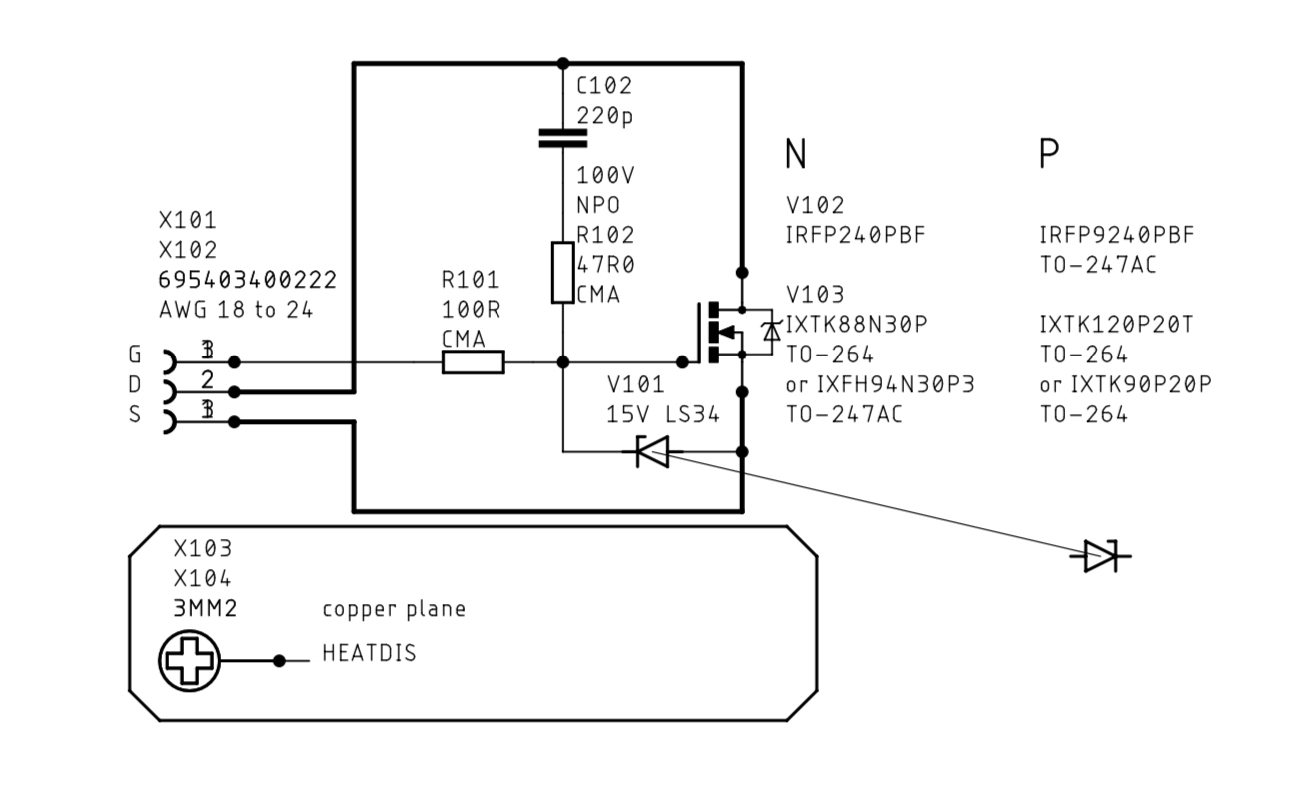

C10, R13, C12, and R22 are on the snubber boards.

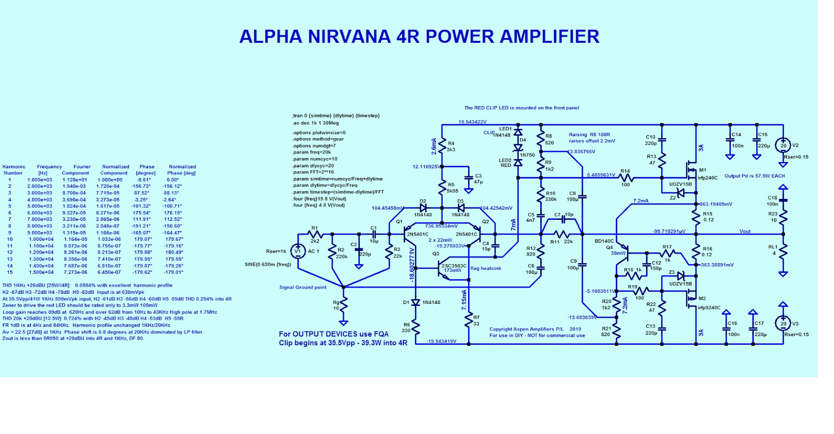

BTW, tikiroo, Hugh's 4R cct diagram has:
* Z2 connecting the Gate to the Source of M1 (V141 in the 'As Built' schematic), and
* Z3 connecting the Gate to the Source of M2 (V142 in the 'As Built' schematic).
Will these Zener diodes be able to be soldered in place on the Snubber boards? (They're not present on Hugh's 8R cct diagram - so I presume the Snubber boards don't allow for them!)
Andy

Hi Andy,
You mean Hugh's 4ohm version of the Alpha Nirvana can be built using the PCB designed for the 8ohm version? Yes.
Exactly, x! 🙂
So my task today is to create the 4R BoM from the 8R BoM. As there is no '4R As Built' schematic, this means I have to add a column which has Hugh's components names ... and match these names against the component names used in the BoM & the 'As Built' schematic.
