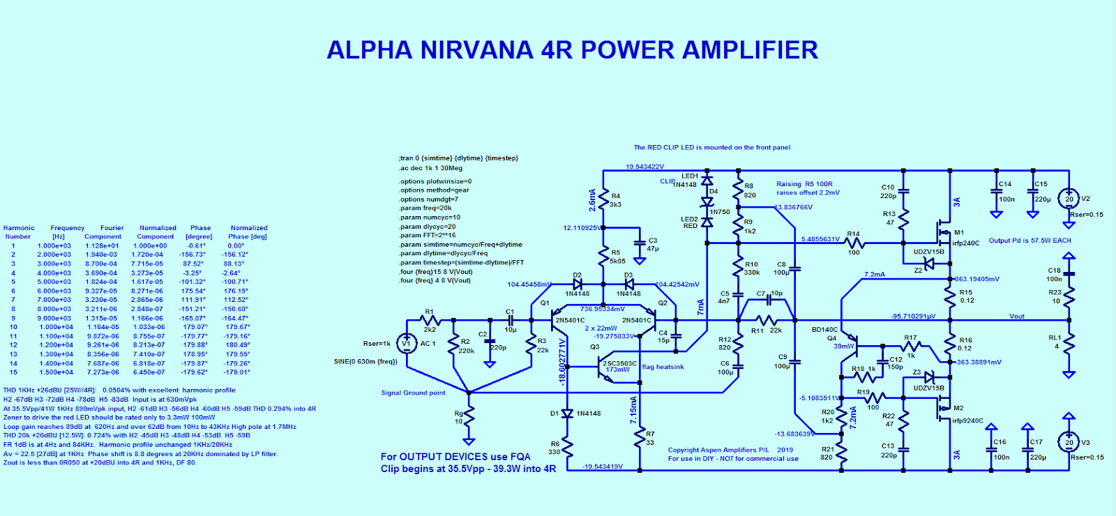

Hi X,
I have nearly finished modifying the BoM with the 4R version component values (which, of course, need Hugh's component numbering scheme! 🙂 ).
This has taken me several days - for 2 reasons 😡 :
1. I have had no internet access for most of the time since last Thursday, and
2. Comparing:
* Hugh's 4R cct diagram
* with his 8R cct diagram
* and your 'As Built' schematic - which has modified component values and JPS64's numbering scheme
... has been a nightmare! 😱
Before I can finish the s/sheet, I'm afraid I need some answers from you:
1. Vunce explained that JPS64's numbering scheme allows different options for some components - eg. choose 1x 10uF component from C102/C103/C104/C105.
Q1: are V113 & V115 simply 2 different options for that transistor?
Q2: if so, I'm curious how they can be interchangeable - given the BoM describes V113 (KSC3503) is rated at 0.1A ... whereas V115 (TTC004B) is rated at 1.5A?
2. Your 'As Built' schematic has R136 (4R7). This doesn't appear on either of Hugh's 4R or 8R cct diagrams. So:
Q3: I presume R136 actually does something useful (essential!)?
Q4: given it's required for the 8R circuit ... I presume it is also required for the 4R circuit?
3. Likewise, your 'As Built' schematic has C134 (2200pF). This doesn't appear on either of Hugh's 4R or 8R cct diagrams. So:
Q5: I presume C134 actually does something useful (essential!)?
Q6: given it's required for the 8R circuit ... I presume it is also required for the 4R circuit?
Thanks,
Andy

Hi AndyR,
When asking questions about a schematic, please post link to image inline with your post like this:
It will save me from having to dig through the thread to find it. Truth is, I do most of my responses to posts via my phone. I don’t have paper schematics in front of me nor my main laptop with the big screen. So if you want an answer quickly, including the schematic will be helpful.
I am assuming that this is the 4R schematic you are referring to;
Let’s try to answer what I can, keeping in mind that some small changes to compensation tricks to prevent oscillation are added at the last minute via email requests and are not captured in Hugh’s final schematics which JPS64 uses for development of the prototype/production PCB. The questions you ask are partly related to this and partly related to fact that we try to provide alternatives for people regarding BJTs and MOSFETs.
You may ask this later: since the snubber boards have 100R gates stoppers already, is R133 and R135 needed?
Technically, no, you could use a wire jumper. But I installed 100R gate stopper on PCB and another on snubber board for a total of 200R gate stoppers. My thinking is that the stopper is on both ends of a flying lead that can pick up RF/EMi and maybe it will absorb oscillations better from both ends. That’s how it’s built anyhow and doesn’t oscillate. Change that and I can’t say it will not. Sonically, 100R lets the current drive higher capacitance of the MOSFET gate with more authority - perhaps higher slew rate. It’s DIY so you might try skipping g R133/135. I am not noticing any lack of resolution or slew rate though.
Tested with KSC3503, but part is sometimes hard to find. TTC004 is rated higher but should work fine and well below its thermal limit. You could even use a KSC1845 here and it will work but is 175mW dissipation.
It is extra precaution against oscillation - I would keep it.
Again, extra belts and suspenders to guard against oscillation requested by Hugh at last minute of layout work to prevent Q4 from blowing up the outputs. 🙂 I would keep it. You are welcome to not use it but use an Oscope to check for oscillation. Of course, your MOSFETs may already be toasted.
I’ll let Hugh answer but my guess is that it’s even more important in an a 4R application.

Sorry for not including the schematics, X. 😱 You picked the right ones. 🙂
I will include R136 and C134.

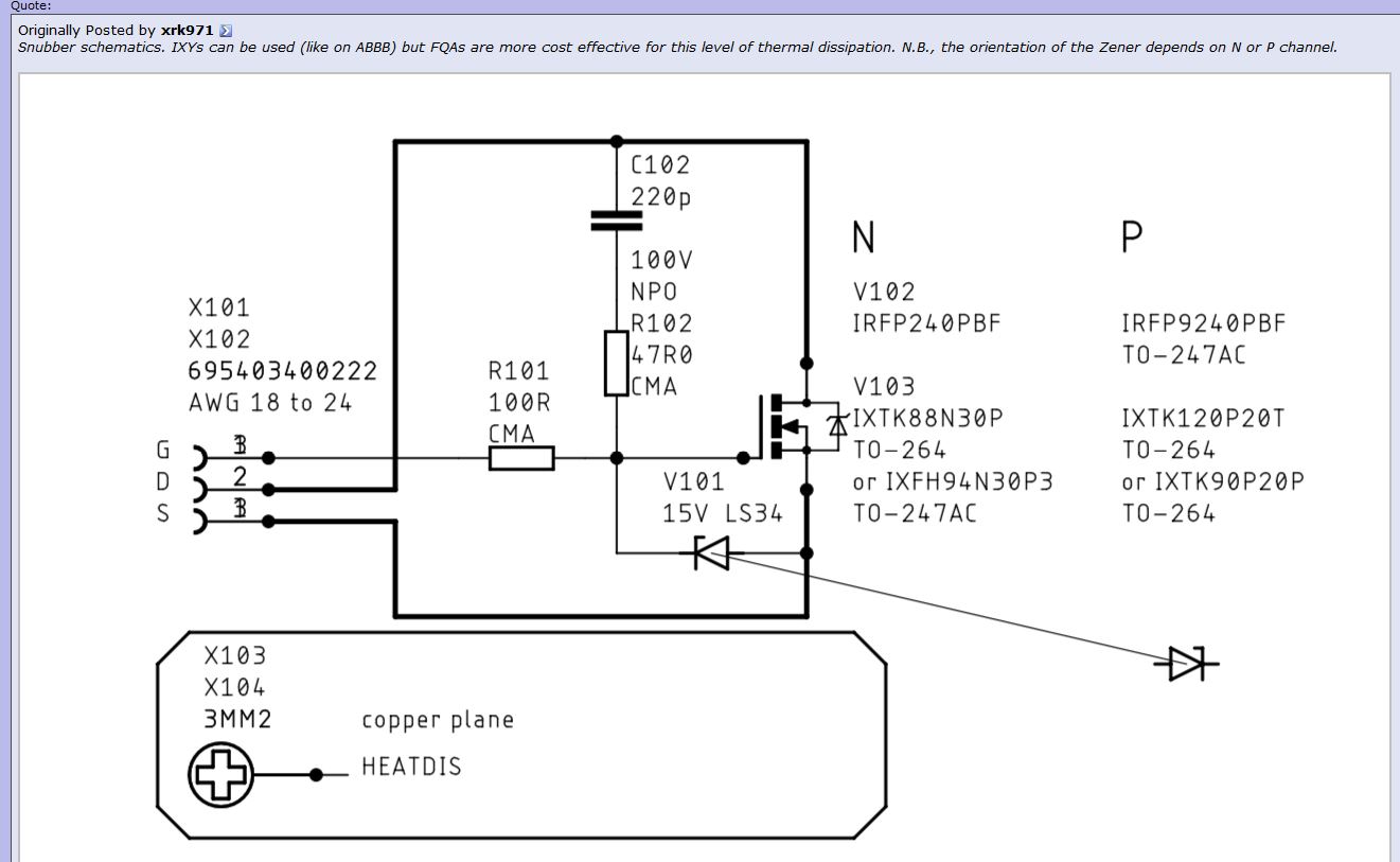

Thanks, X - I don't have enough technical knowledge to query whether R133/135 are still needed! 😀
I do note, though, that your snubber diagram - attached - shows:
* R101
* R102, and
* C102.
Can I suggest these component numbers are confusing - as the same numbers are used in the amplifier cct diagram and BoM.
Rather than leaving out R133/135 - what do you say to the suggestion of:
* including them on the PCB.
* then, during checkout of the working amp, short across these resistors whilst looking at the output on a scope.
* if no oscillation is noticed with R133/135 shorted ... try a listening session without & with R133/135 shorted, to see if resolution improves with them shorted.
* if not ... leave them in circuit (not shorted).
Andy
I agree the component designations are confusing since duplicated in the main amp. I guess this was a separate project from the Alpha Nirvana rather than part of the same set of schematics.
Your plan for testing with/without snubbers on board sounds good.
