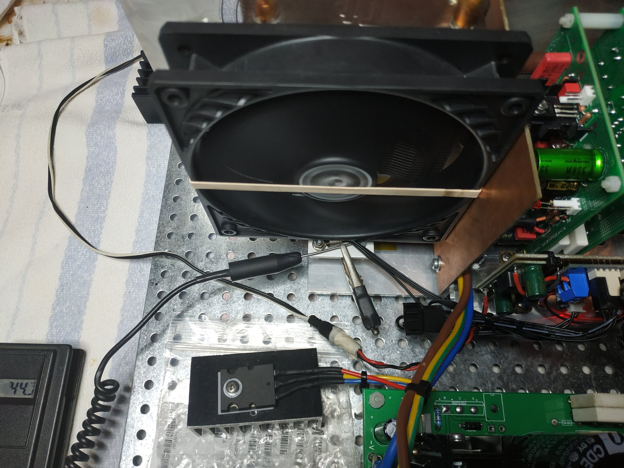

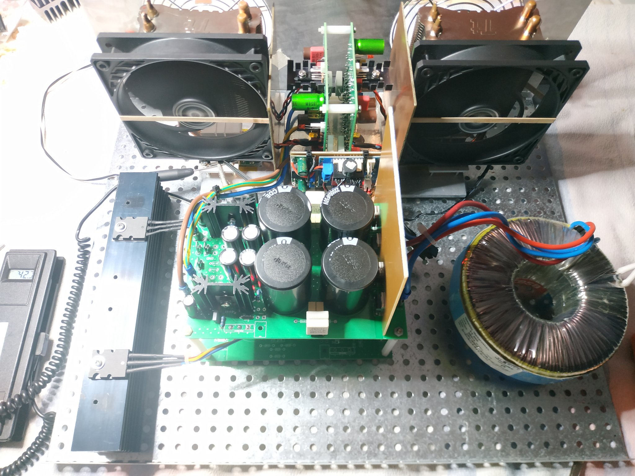

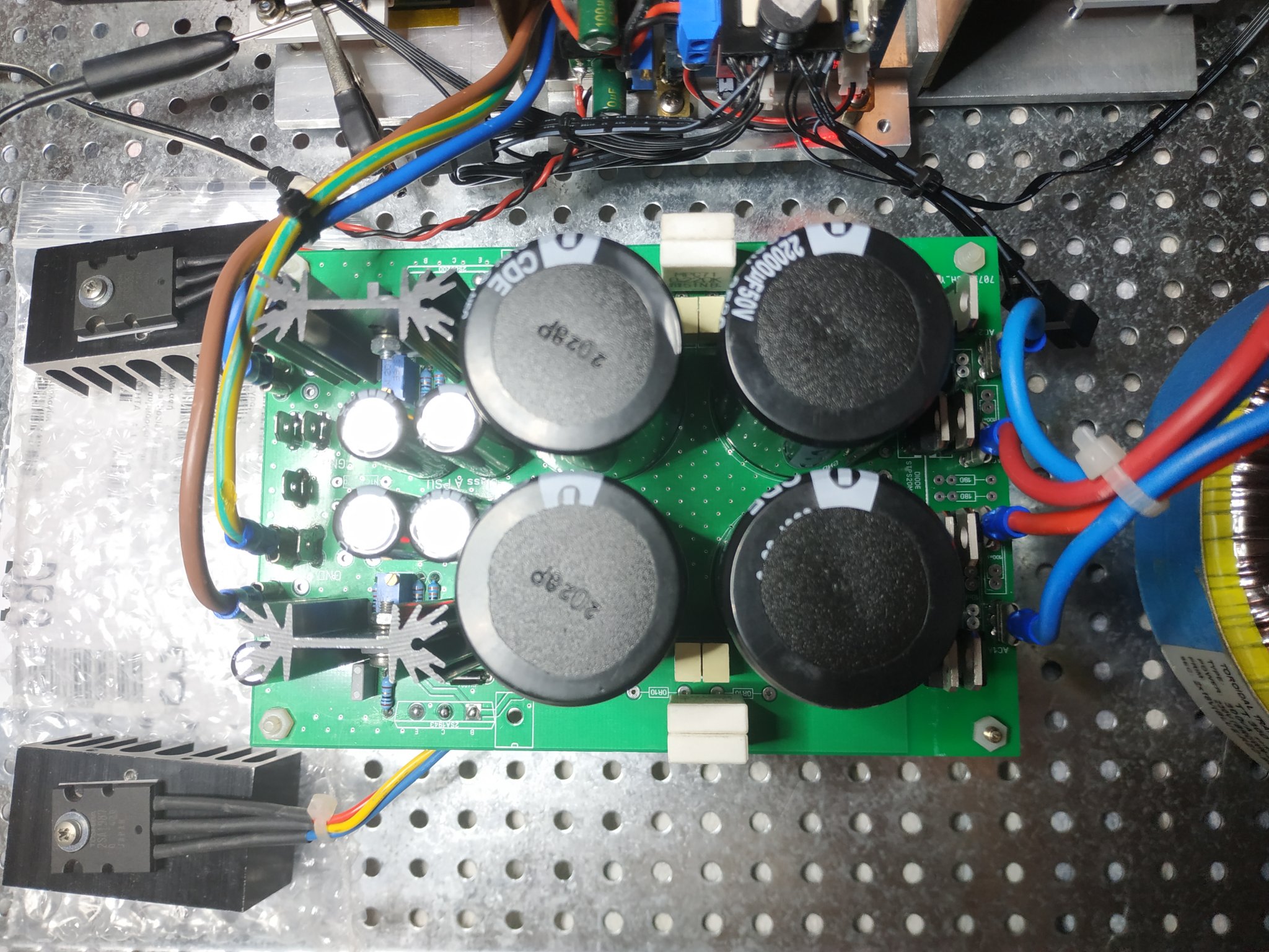

Hi my friends
Some parts arrived for my Psu with classic diodes instead LT3420.
The diodes STPS20M60D.
Vf 0.37V little warm without heatsinks about 40 C
All caps now are new.....
The ripple its zero.....at my scope at 2.3A bias with 0.15 Ω source resistor
Trafo 18.14 VAC input
Output +/- 20.68V bias 2.3A.
Ambient temp 27 C as you see the temp at active fan are 43-44C .Νο noise .
Also the temp for the output transistorsb on body of PSU are 36-37C.
