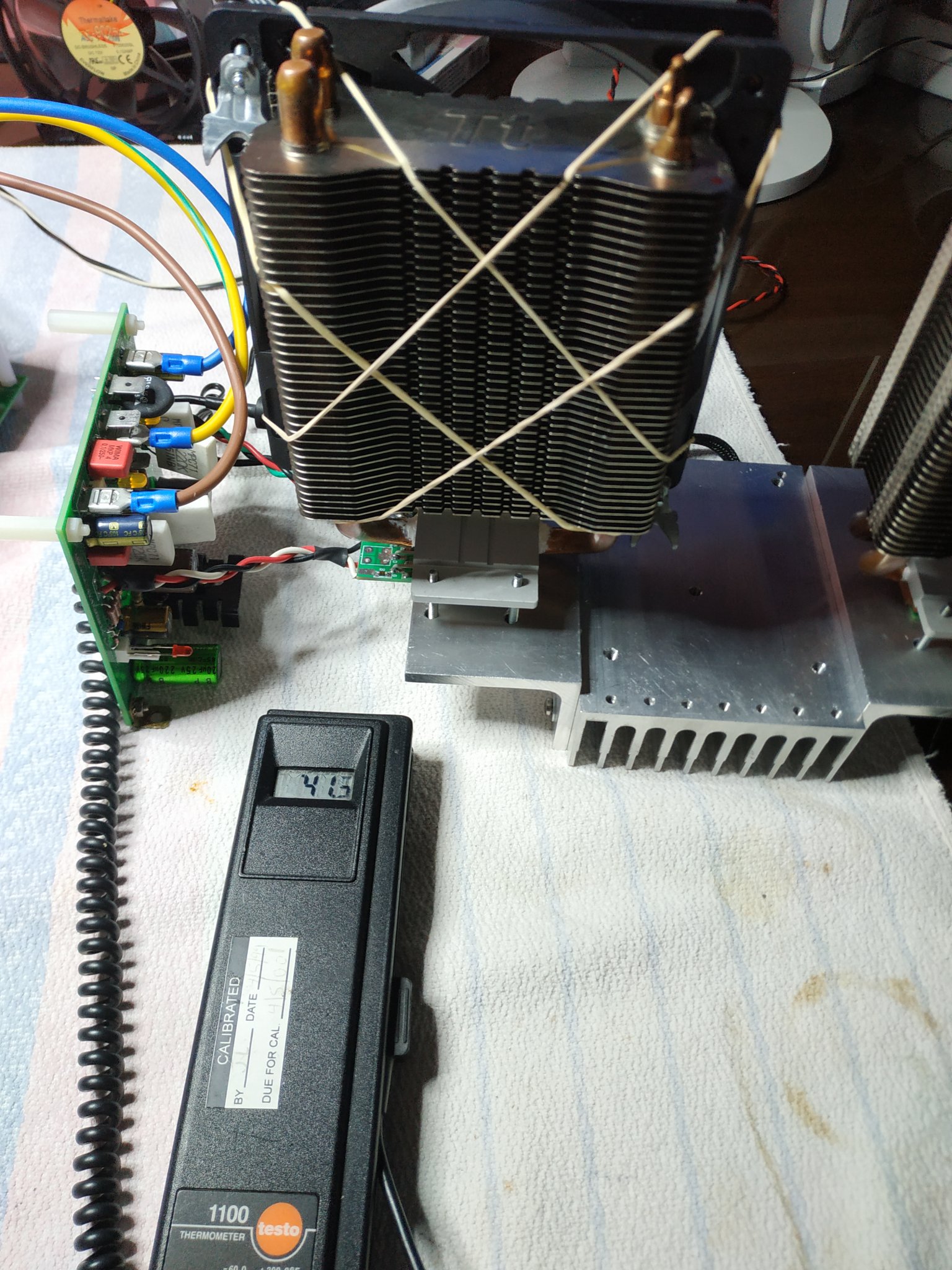

Yes, the 3a bias current - whilst it enables the 4R circuit to be stable into 2 ohms ... does create a lot of heat. 🙁 I originally had each pair of output devices bolted to a CPU cooler - with a fan underneath it (and a hole in the base of the case). This kept the devices to about 60 deg ... but, even with the 12v fans being run at a lower voltage, I heard too much fan noise (not surprising, as there were 4 fans!).
So I re-housed the amps in a 5RU Modushop case, having 300 long & 210 high heatsinks; these don't cool the output devices quite as well as the fan configuration did - so I am about to change R15/R16 to 0.15R (which should reduce the heat output - and the device temperatures - slightly).
Κalispera my friend Andy.So I re-housed the amps in a 5RU Modushop case, having 300 long & 210 high heatsinks; these don't cool the output devices quite as well as the fan configuration did - so I am about to change R15/R16 to 0.15R (which should reduce the heat output - and the device temperatures - slightly)
Thank you very much for the construction details.
I have seen your construction.....however, due to the height of your box, you have placed the active fan not vertically but horizontally and the temperature is trapped in the radiator. These active fan work much better when they are vertical. I have tried as I mentioned above with classic heatsinks, but the heat dissipation is much worse. The problem is in the heat that is trapped above the body of the mosfet, and for that you also need cooling in the housing, see my photo.
In this way I have achieved 41 degrees Celsius at 3,188 A.

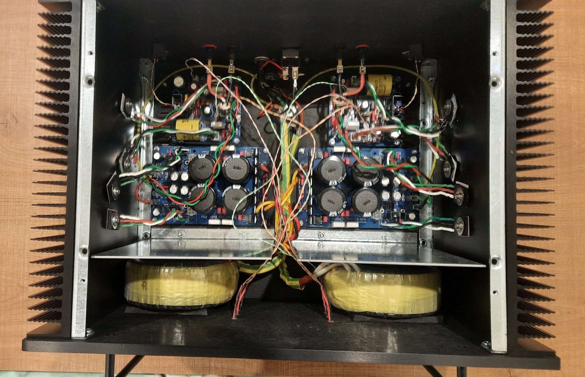

One amp is done - so, seeing how 'topless' shots are in vogue atm, I thought I would post one:
The case is a 5RU Modushop 'Dissipante'. Transformers are Aus made, from Tortech, spkr terminals are EIZZ and input RCAs are Vampire PCB2FA (unfortunately, no longer available 🙁 ).

Alas - I now need some smart suggestions from people who can help me figure out what is wrong! 🙁
After replacing R141/R142 in both channels, I reassembled the amp and switched it on - and nothing smoked! Yay! 👍
Put a 1kHz signal through the R channel - and looked at the output on my 'scope ... a lovely clean sine wave. Then I put a 4R/50w load across the R channel's spkr terminals - the nice sine wave continued.
So the R channel is AOK.
Repeated this with the L channel:
* without the spkr load resistor connected - there was no problem; ie. a smooth sine wave on the 'scope.
* but when I connected the 4R resistive load ... the smooth sine wave on the scope continued - but I began to hear a very high-pitched whine (maybe 8 -10kHz?). So I'm thinking ... something must be causing an oscillation in the L channel - but only when the spkr load resistor is connected. But whereabouts in the amp circuit can this be?

First of all I would look at my mosfet connections....I don't trust that type of Molex type connections....I have also seen point to point connections on to ONE mosfet? (filter 47Ω+220pf) ? Blurry image... look for loose connection......etc reduce mosfets wires .. ..increase the resistors gates ...all these with gen and scope..
Andy,
Nikos is on the right path I suspect. I also see a point to point method of attaching the snubber circuit for the Mosfets…in my honest opinion, the pcb that X sells is a much more optimized option with the snubber circuit, gate stopper, etc…all intrinsically attached to the respective pcbs. Long leads from the main pcb to the Mosfets is always a risk for possible oscillation unless a properly designed and implemented snubber circuit is included.
Good luck!

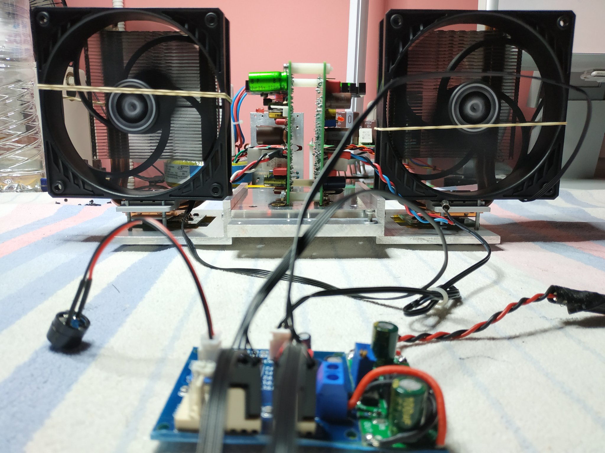

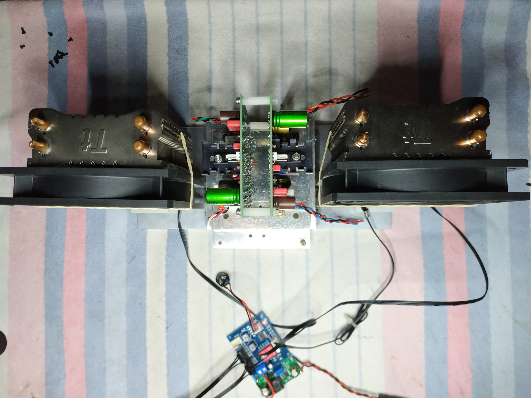

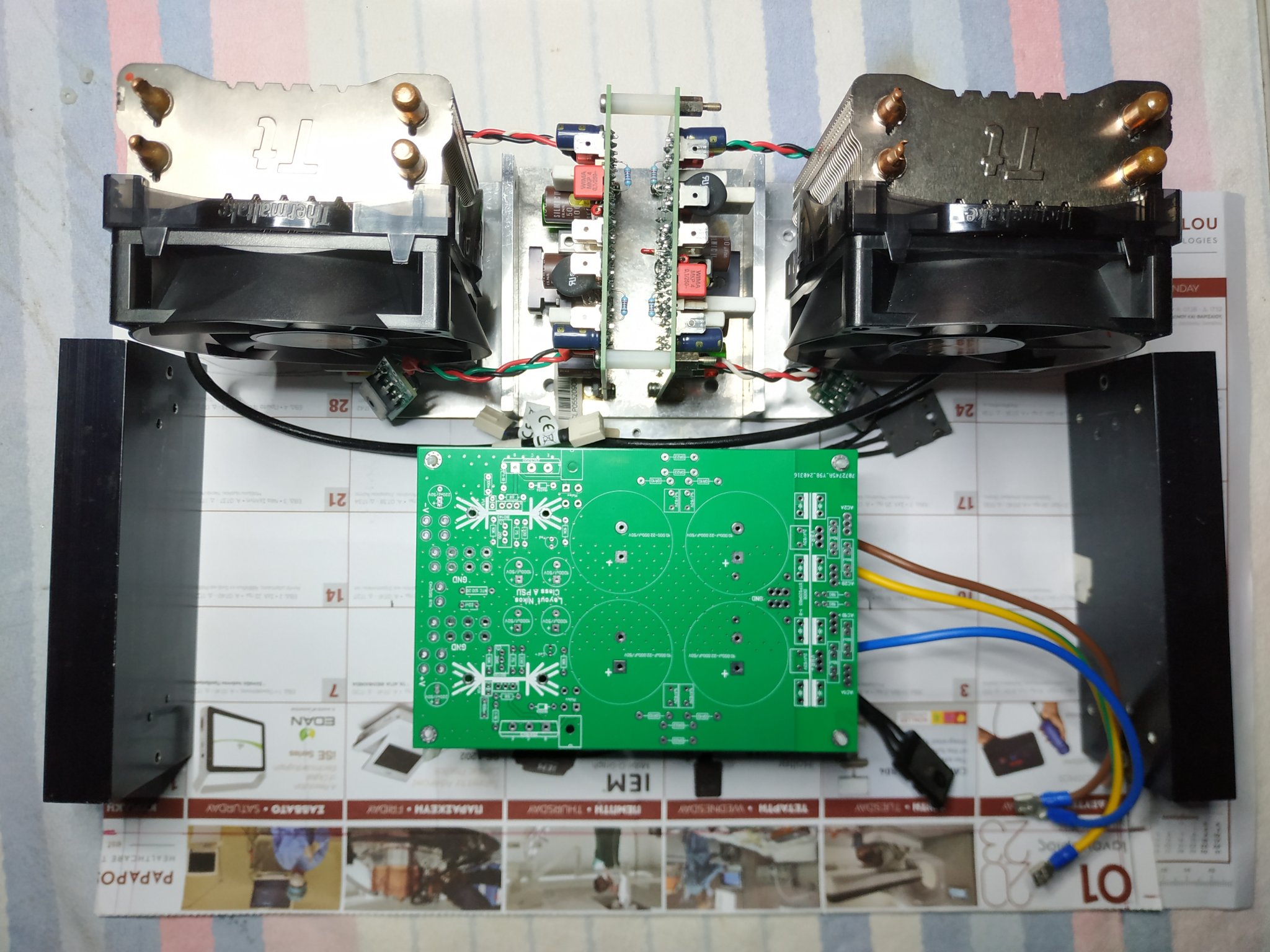

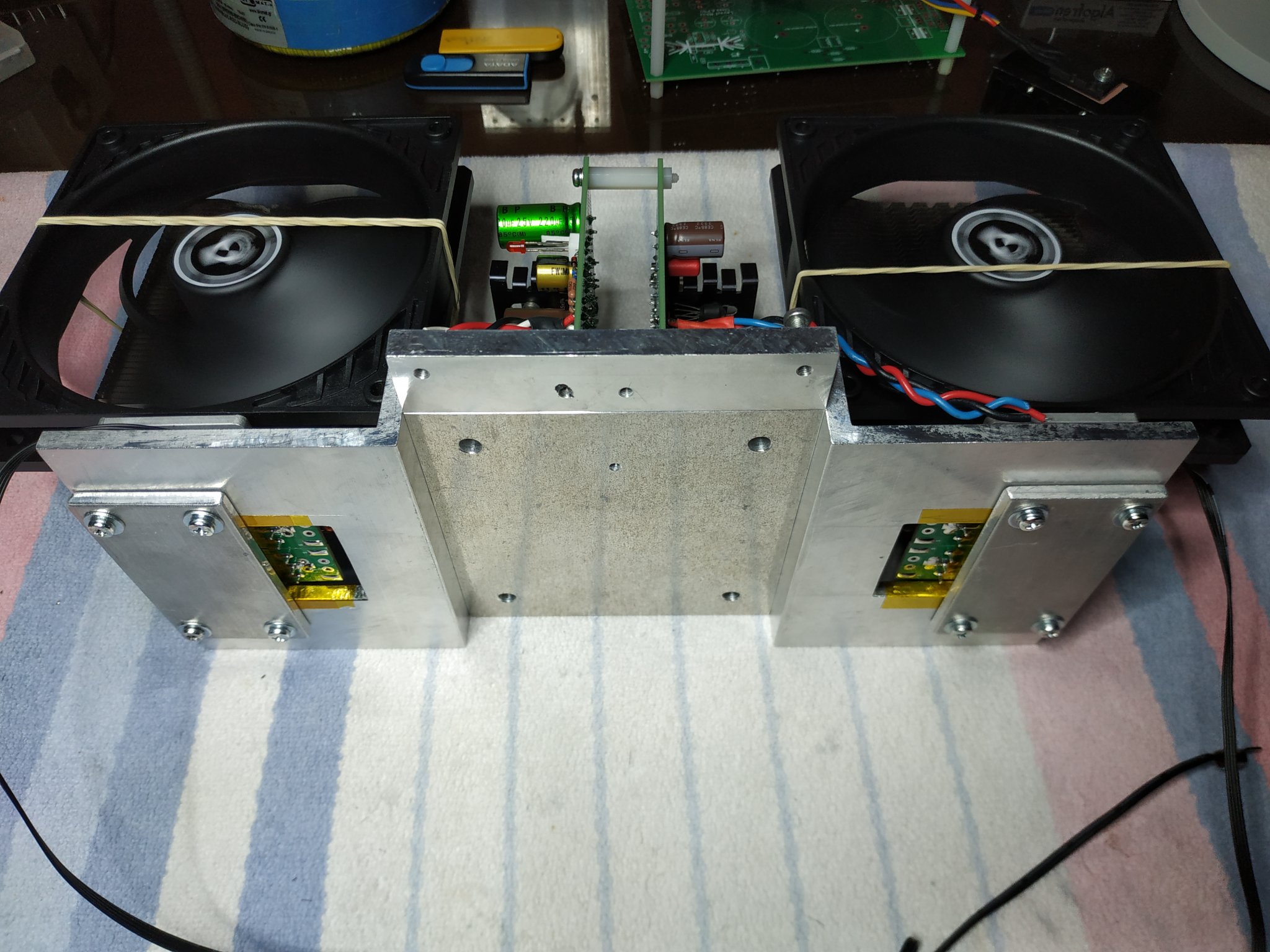

Little progress about box setup about 16.5cm high.
