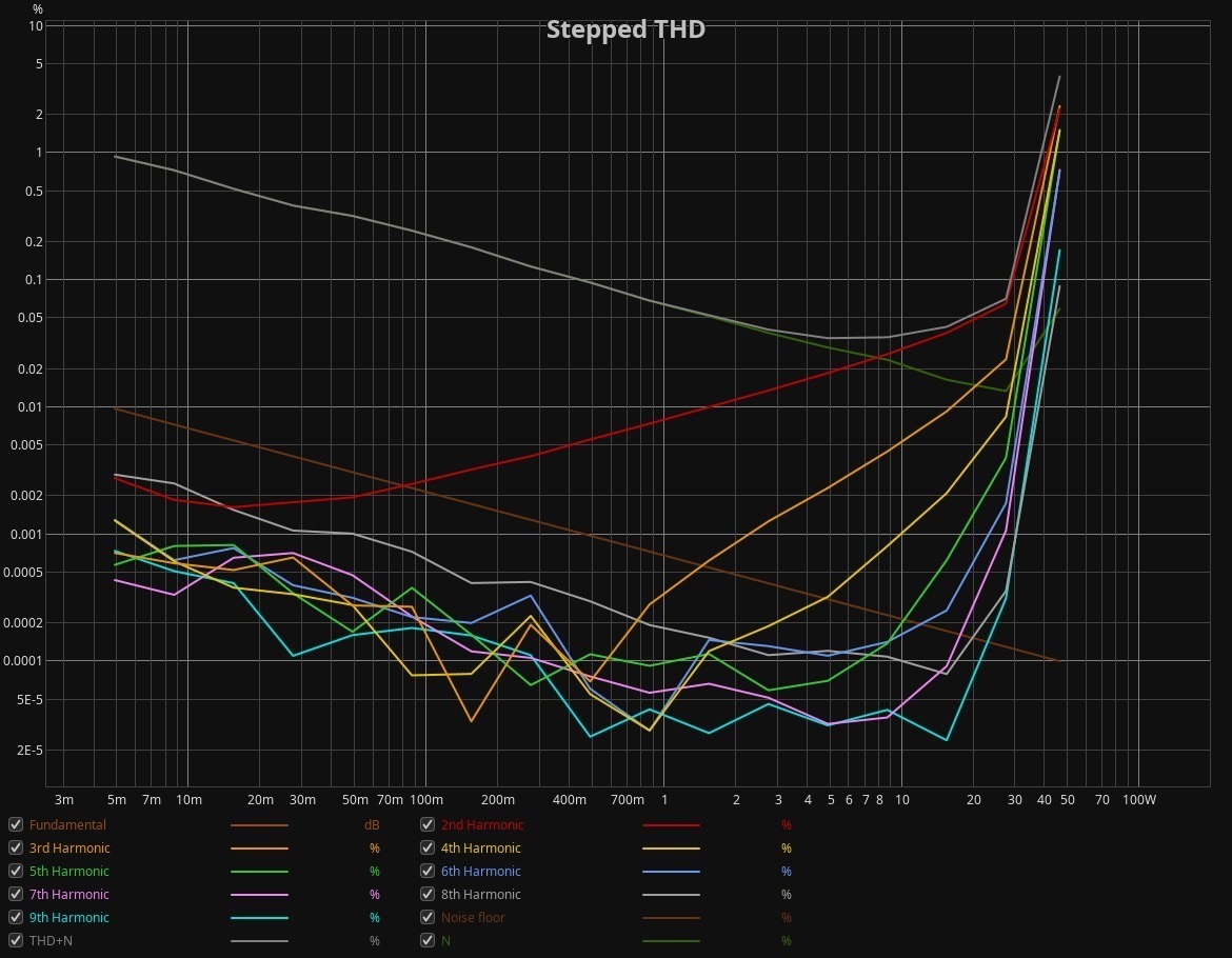

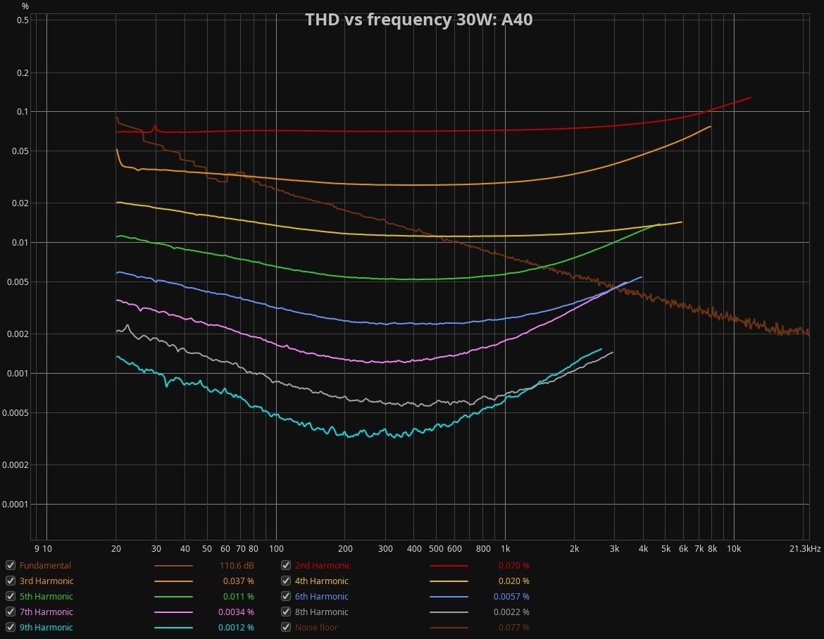

Latest measurements by Keantoken on commercial A40 amp shows distortion vs power behaving nicely.
Here are components vs frequency at relatively high 30W:
Always second harmonic dominant and descending higher orders. Just as it should be.

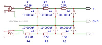

Hello, I would like to use this scheme to power the 4 Ohm version.
Do you think it is enough or something else needs to be added? It is for a single channel.
Thank you.
Thank you.
From a capacitance standpoint, you should be fine. But the resistor values imho are too large, you will lose a lot of voltage off of your rectified rails. Remember this is not a Class AB build, it’s a Class A build, where a constant bias current of at least 2A (since this is a 4 ohm build) is going through these resistors. So you lose 0.4V at R1, 1V at R2, and 1V at R3 = 2.5V. This will raise the impedance of the supply which can affect bass response. The resistors will also need to be higher wattage, i.e. P = I^2*R. So R1 will need to absorb 0.88 watts, R2 will need to absorb about 2 watts and R3 will need to absorb 2 watts. You will need to upsize those resistors by 3 times that value, so 3 watts, 6 watts and 6 watts because they will get very warm and will be prone to fail if undersized in power. I would not recommend your supply at all.

Knauf,
Anand has put it very well; caps are fine, I'd suggest reducing all the resistors to 0.15R, all rated at 3W.
With a 4R load the 2A quiescent (ideally it should be 3A actually) each resistor will dissipate 0.6W, and 3A would dissipate 1.35W. So 3W will give a moderate temperature rise and long life.
Be aware that more power supply capacitance will draw higher surge currents from the transformer; there is a balanced here. My thoughts are that about 30mF is about right for each rail on a 40W Class A.

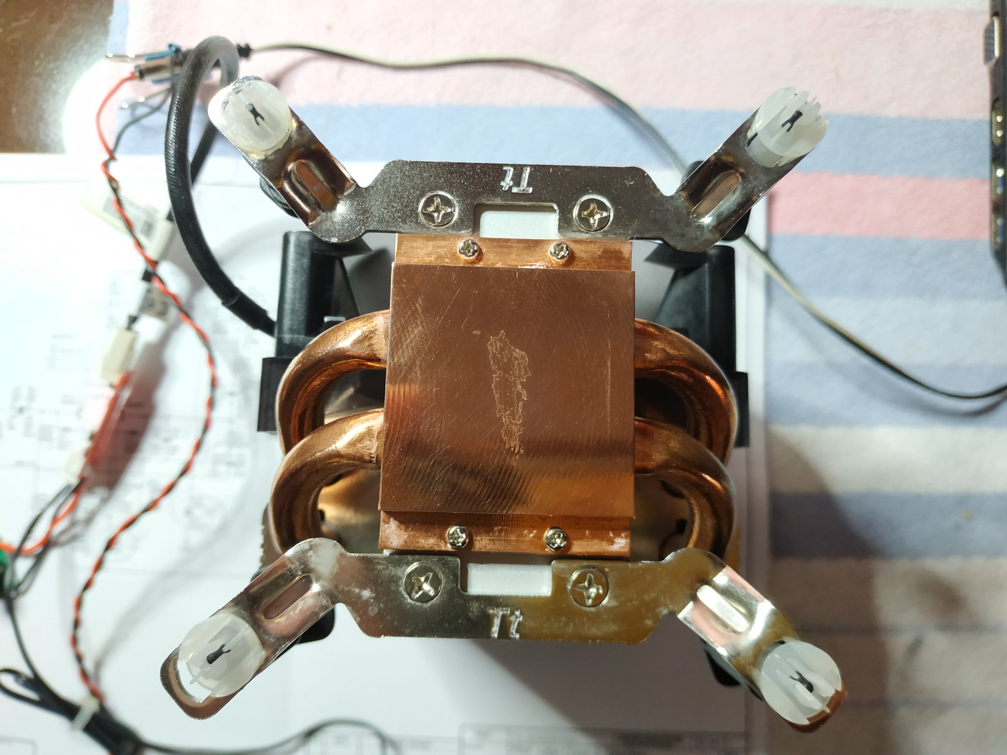

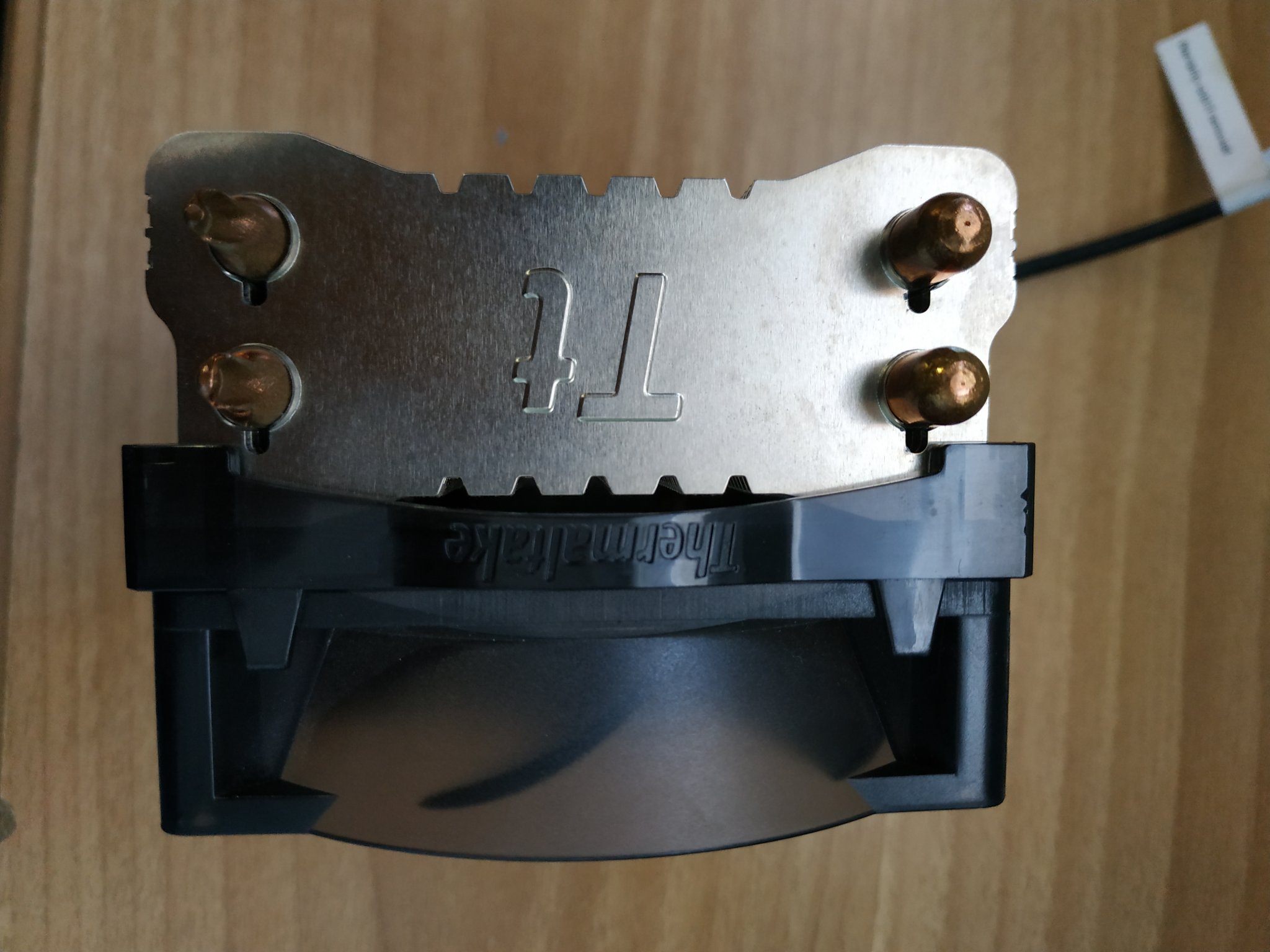

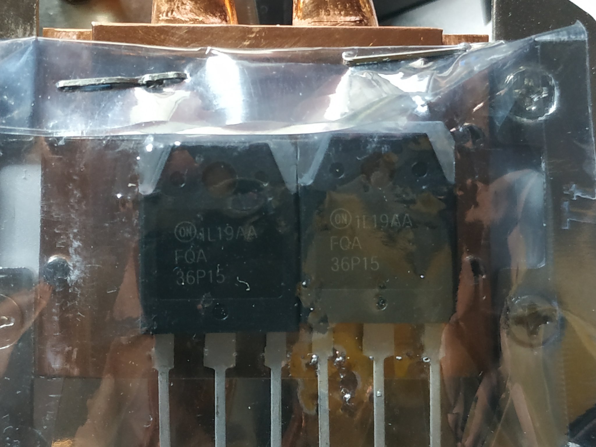

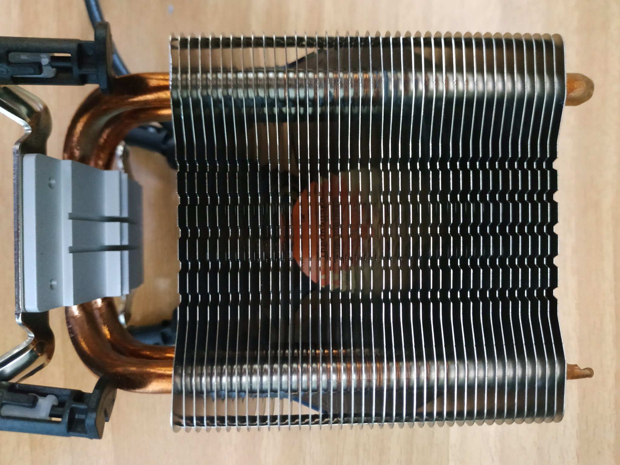

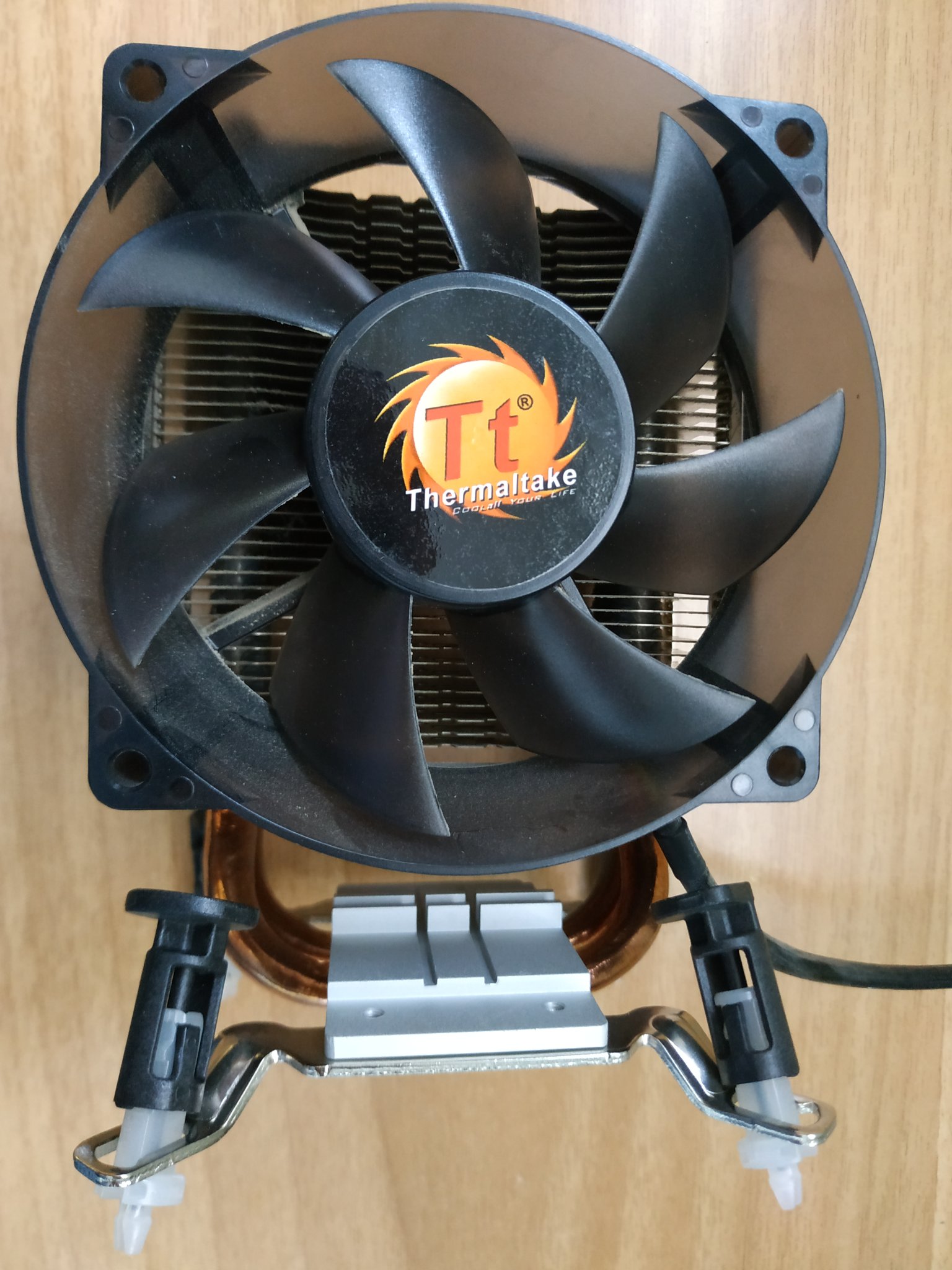

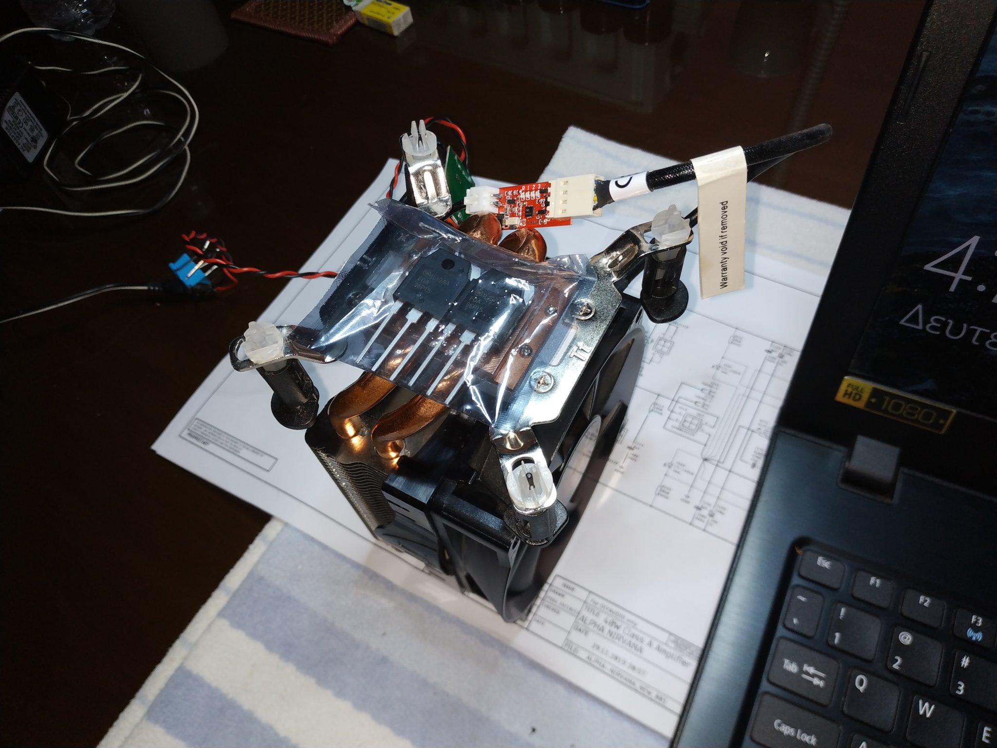

Hi ...
I m still collecting parts for this amp AN39.
I found this ... heatsink fan 90cm pwm THERMALTAKE Silent 1156 .What do you think its good for cooling?

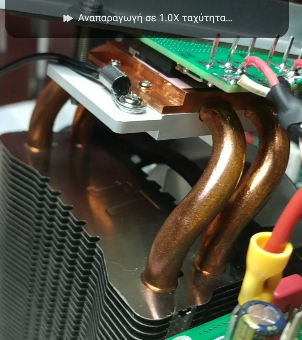

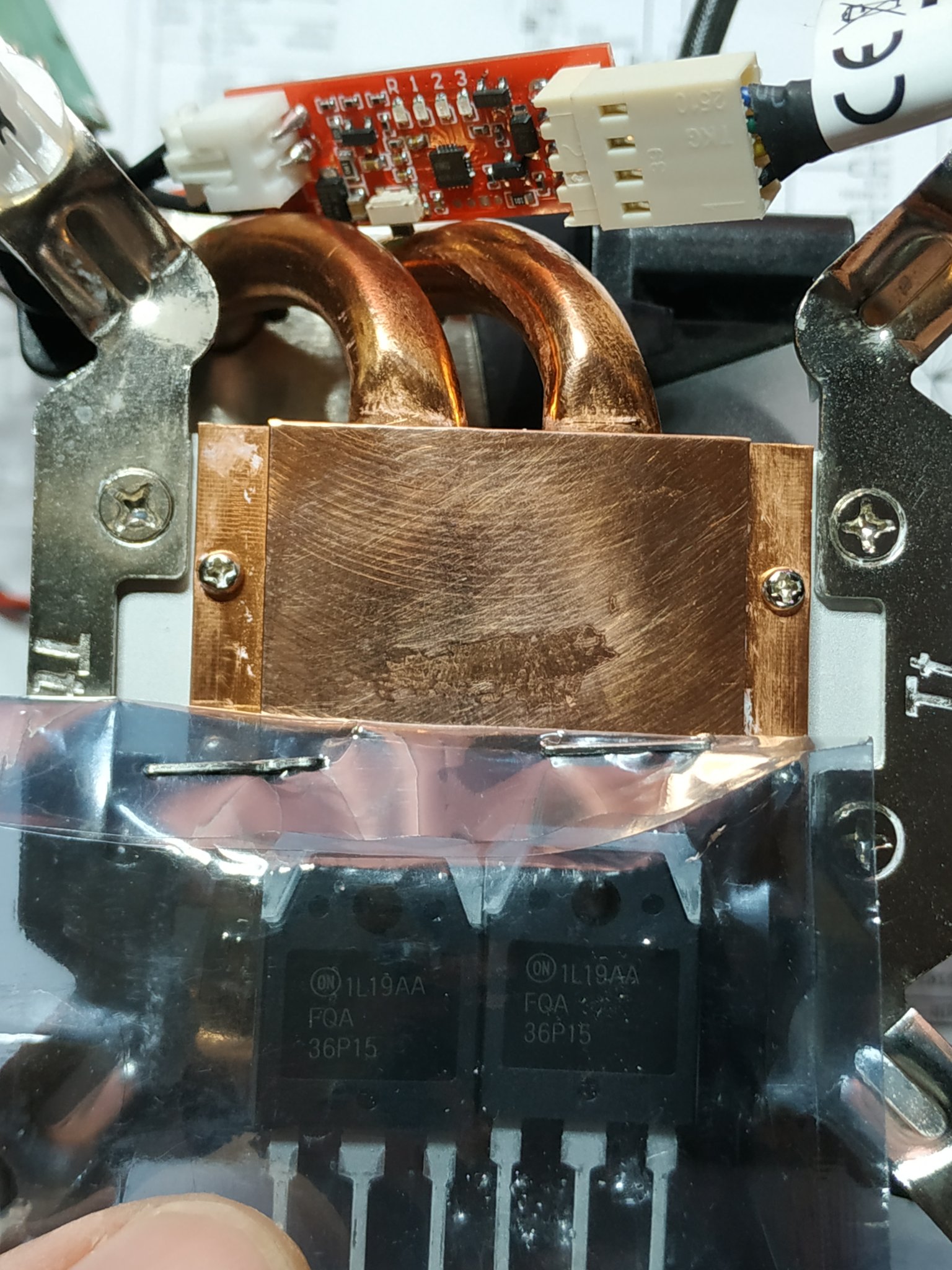

That will work but you need to find a way to clamp the MOSFETs to that copper pad. Can you fit two side by side?
#Xrk971
I think yes but haha i have only one heatsink fan for now....

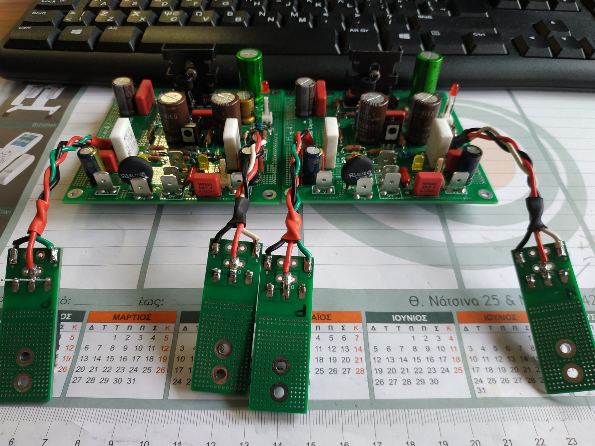

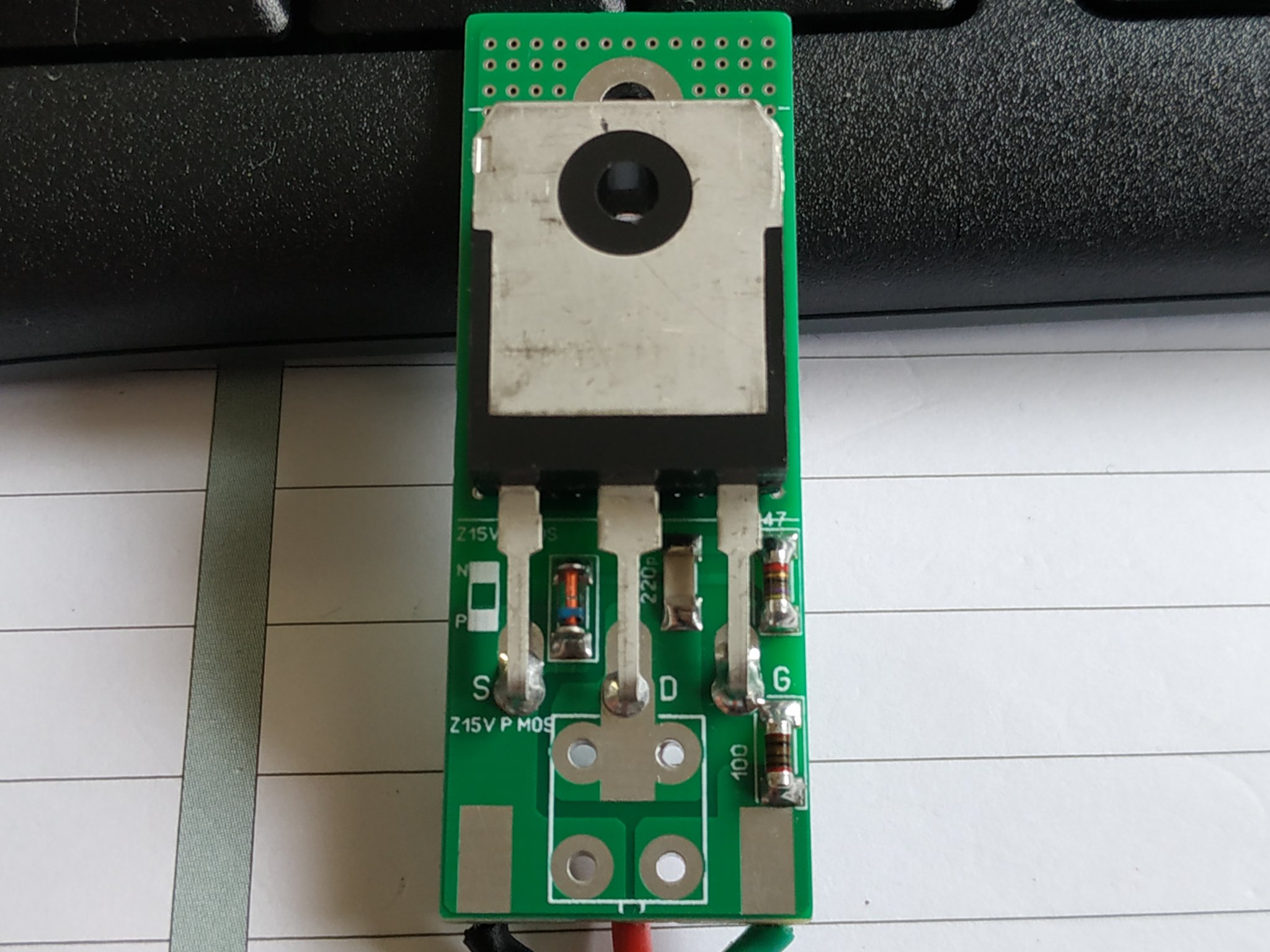

Μy boards arrived.... everything good.
Voltage 21.50DC-21.80DC
On 3.3k 8.30V-8.50V
On 0.22Ω about 353mv ~1.6A
Offset about -2.8 -3.2mv with pot 200Ω and 22Ω νalue...
I don't listening music yet.
On 3.3k 8.30V-8.50V
Ηi James my friend how are you?How are your temps?
My temp at 1.6A from first initial tests with active fan Thermatake PWM by microcontroller activated initial at 40C rise up to 48C down then until the deactivate the fan at 38C cycles again and again. the temp on body FQA about 52-58.

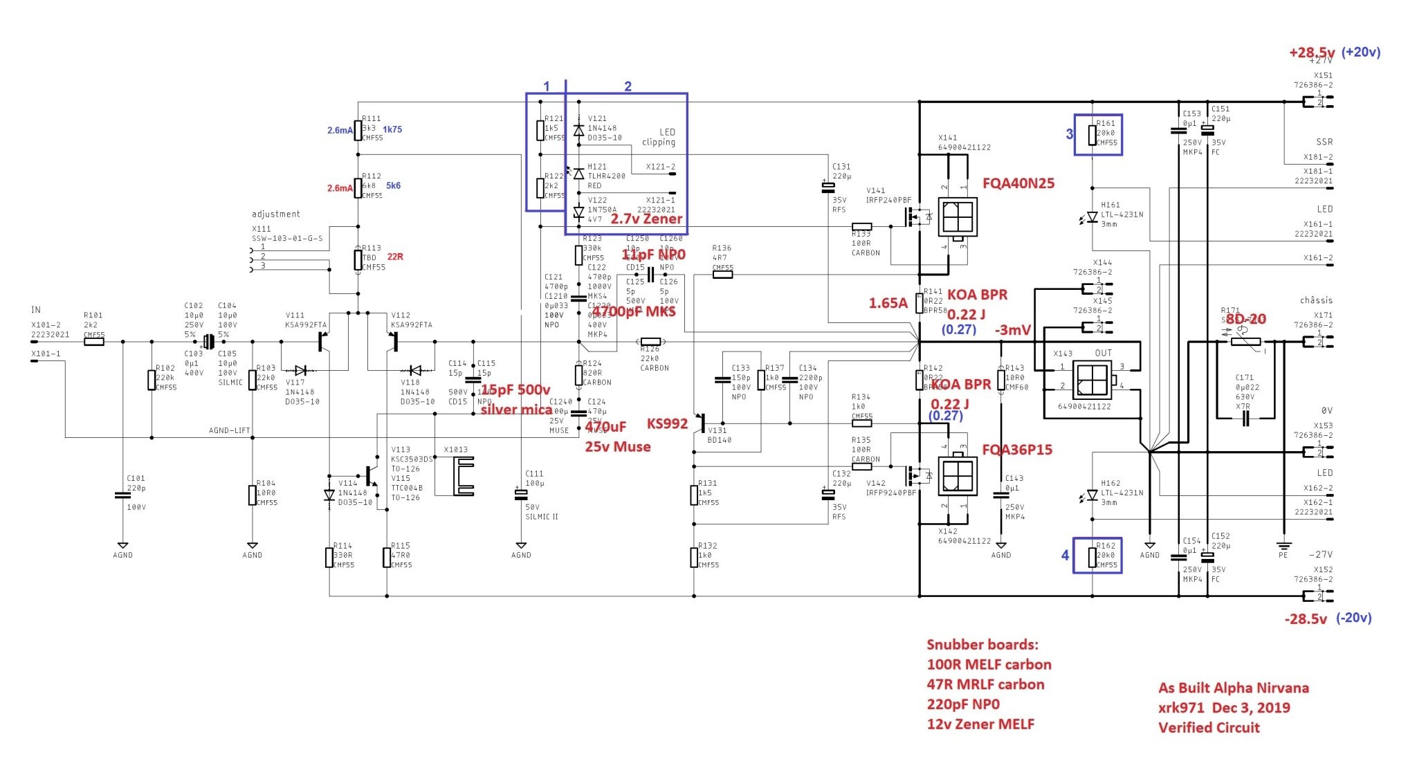

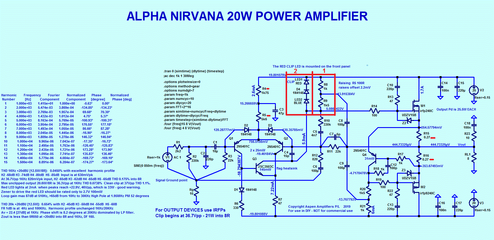

Hi, in the end I am going to mount the 20w//8ohms version (20V rails). I will use it to feed the mid and treble part (92db/w) on a 3 way speaker.
This is the schematic that Hugh designed and offered to this forum...thanks!
You can see some changes from the original version. To make a little memory I copy and paste the explanations given by Hugh himself:
"This amp uses 20V rails, and performance is not as good as the 27V rails and about half the power. But it's essentially the same amplifier with very similar harmonic profile. Interestingly at 20KHz and 12.5W//8R the H2 is at -45dB, which is almost identical to a tube like 6SL7 operating at B+ of 340V and 1.6mA plate current. It clips at just under 21W, and quiescent is 1.32A. Front end is slightly changed; R4 could be a 2k pot to set offset. Quiescent is set by the two 0.27R resistors in the sources of the outputs, which each dissipate an easy 25.5W."
" you can replace the blue led with a 2.7V zener".
There are things that I understand and things that I don't (in blue the 20w version).
I will explain what I think I understand:
R111 is replaced by 1k75 ohms
R112 for 5k6 ohms
R113 could be a 200 ohms adjustable resistor for dc offset adjustment.
R141 for 0.27 ohms
R142 by 0.27 ohms
-My doubts:
Set 1 (in blue)- R121 and R122 (39w) are different values to R8 and R9 (20w).
Set 2- Led 2 blue or zener diode 2,7v reverse biased than the original version?
Can I follow the same order as in the original circuit (39w) reversing only the zener diode?
Sets 3 and 4- shouldn't I change the value of resistors R161 and R162?
Thanks in advance
