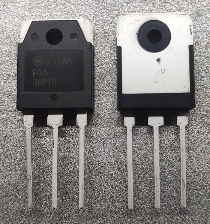

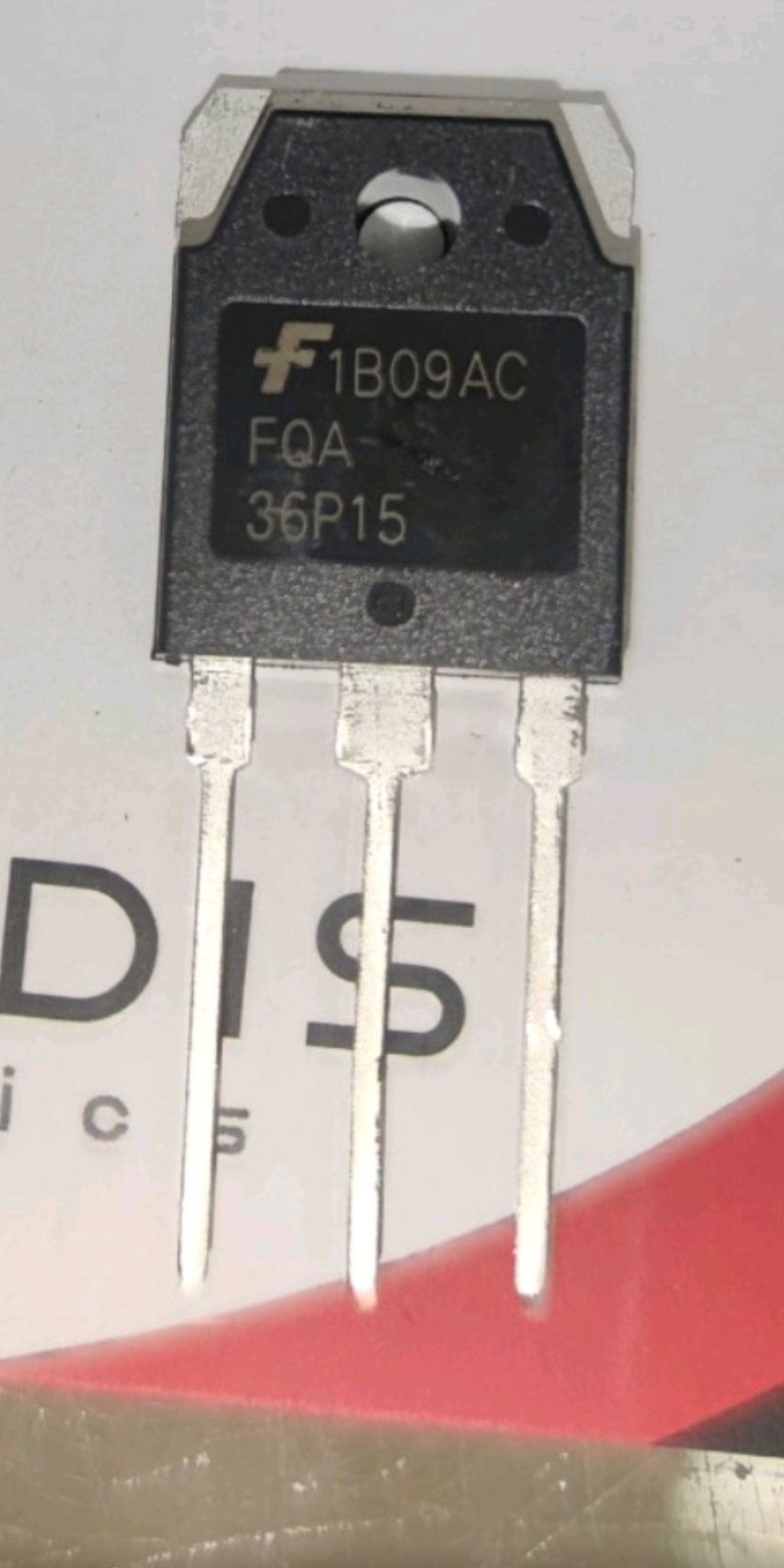

IF we use a double die lateral (the 16A 200V 250W EXW20N20 Exicon device) AND a FQA36P150 (36A 150V 280W Fairchild as the pmos variable CCS, we can raise the second harmonic about 5 dB to about -74dB (at 12.5W into 8R, +20dBU). But the third harmonic will also rise, to about -79dB, a little higher.
The difference in the transconductance here is considerable; gm from 1.4S (lateral) to 19.5S (hexfet) and this range is about the best you can achieve. With any other combination than a nlateral and a pmos hexfet we reduce gm differences, and therefore the creation of asymmetric harmonics (that is, even order harmonics) will be less, so it's the best we can get at present. BTW, reducing the gm differences will reduce the THD overall too.

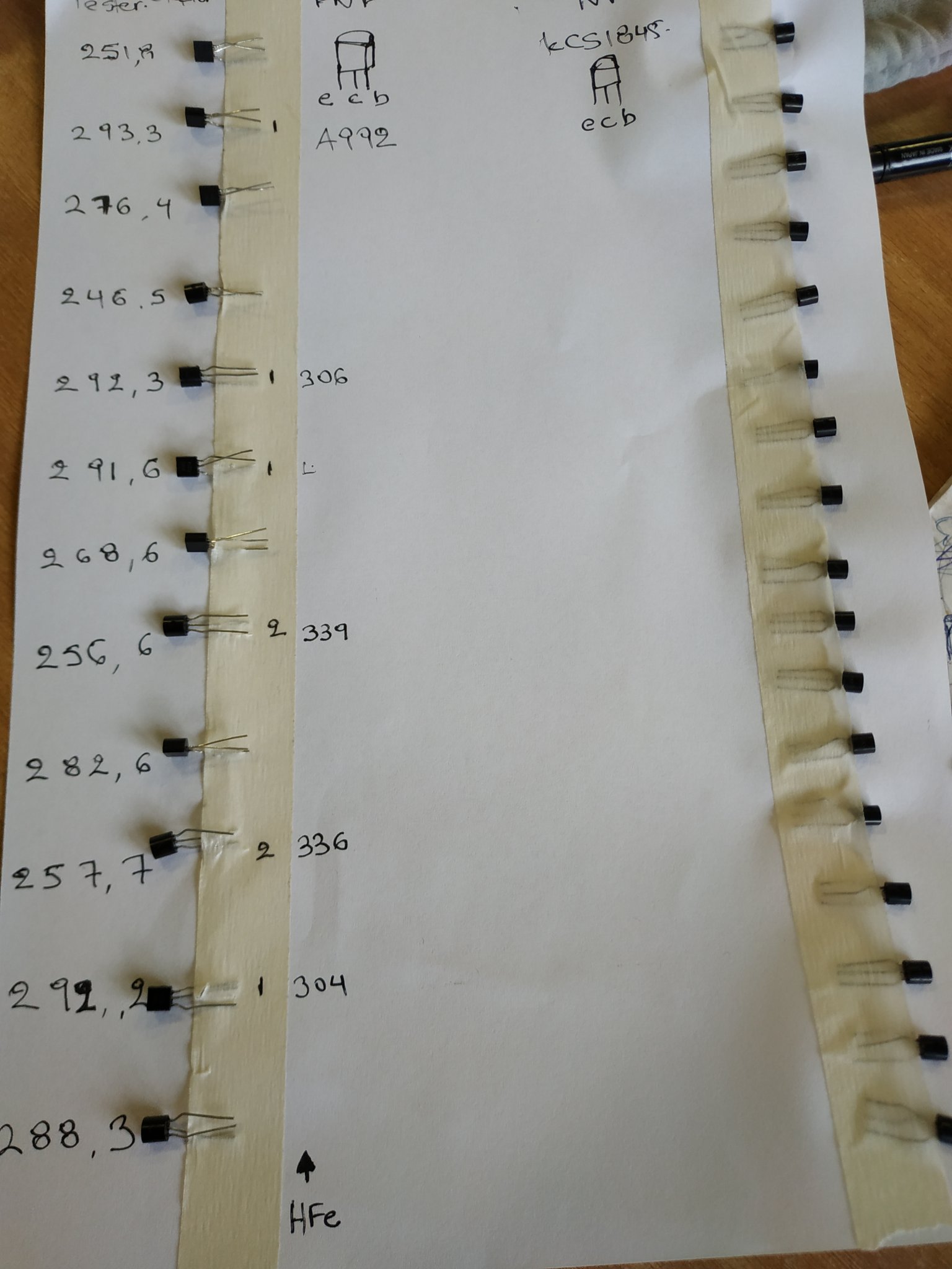

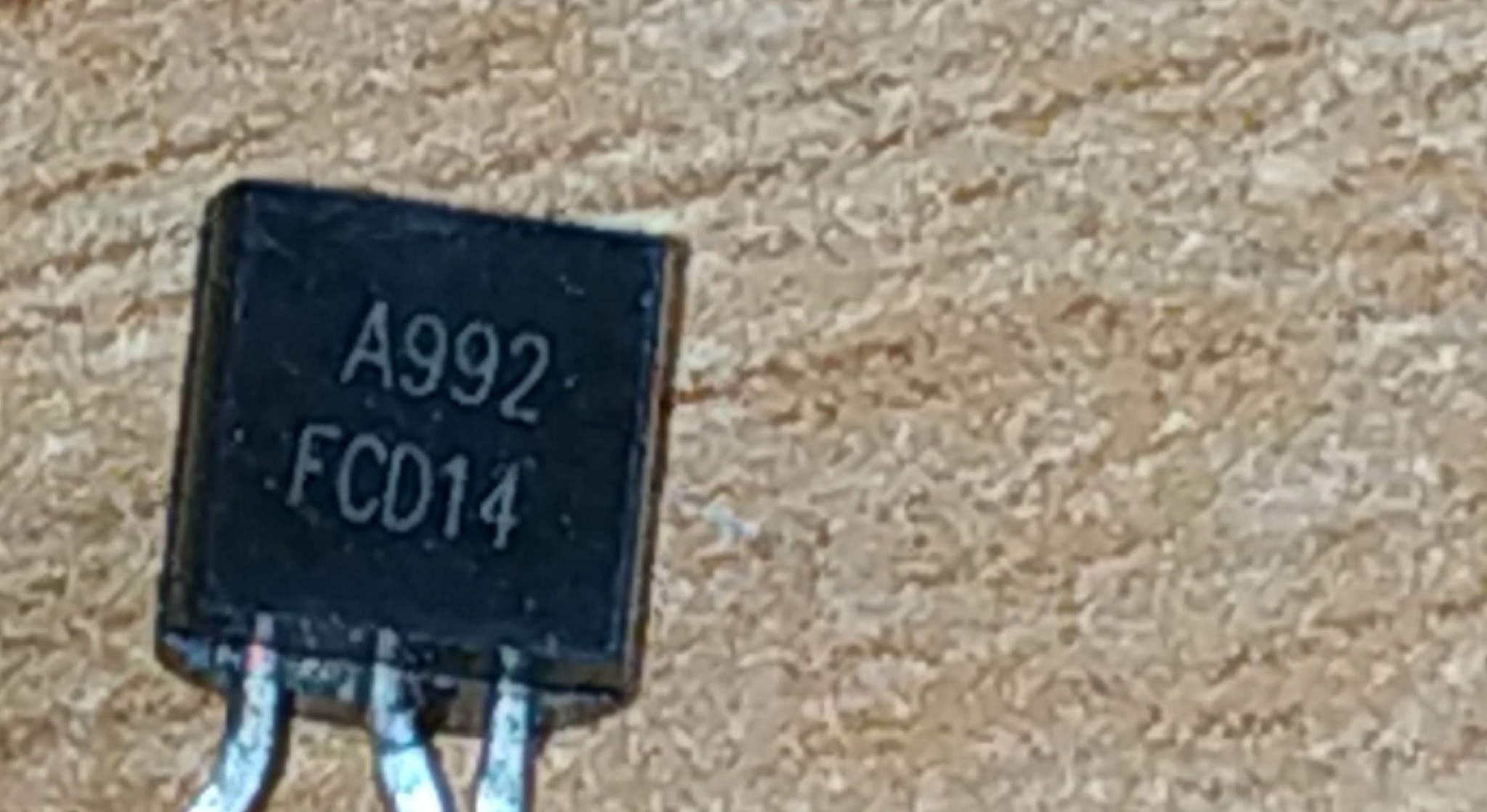

Regarding matching the BJTs - with Hfe numbers in the +/-3 in the last digit should be fine. If you have a perfect match even better. Also look at voltages between base and collector.

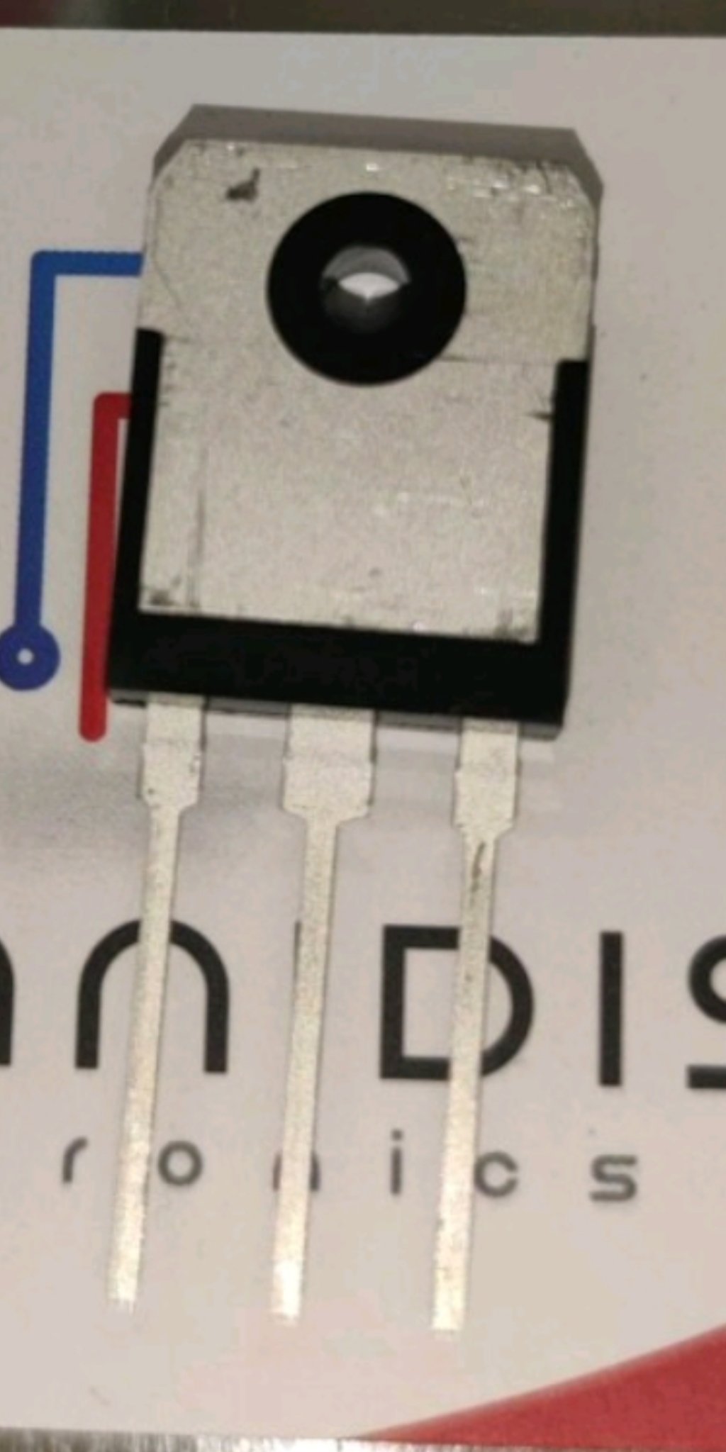

Interesting project...I ordered some PCB's and I will build the 4R version...
Did anyone try in the position of the upper mosfet (n-mos) any of the following?
IRFP140R
IRFP150N
FQL40N50
I didn't go thru the whole topic yet, it's huge...I know they are maybe different than those in discussion here, but these types I'm pretty sure I can get NOS, of certified quality...they were made by Harris and International Rectifier.
If I get some answer I'm not asking just about this amplifier, but the use of these mosfets in class A amps; just to know if it's worth trying them. I haven't yet an option for the P-channel...just waiting to see what I can use from the above - if any - and I will search them after...
Thank you! In this case, at least IRFP140/9140 gets out of the list, the 9140 has a transconductance of 5...I guess also the N-channel 140 will have also smaller transconductance. But FQL40N50 shows in datasheet from On-Semi a typical transconductance of 29 Siemens, given at 20A...but I don't find a matching P-channel model for these. I know there's no complementary devices need here, but still I think they should be in the same league...
EDIT: also IRFP150N has 15S, better but still lower than 29.

Yes Spiros, the IXTQ36P15P is very good for this job.
Rated to 280W it is an excellent pmos for this job.
