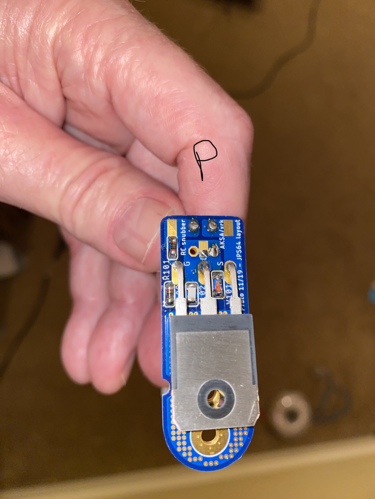

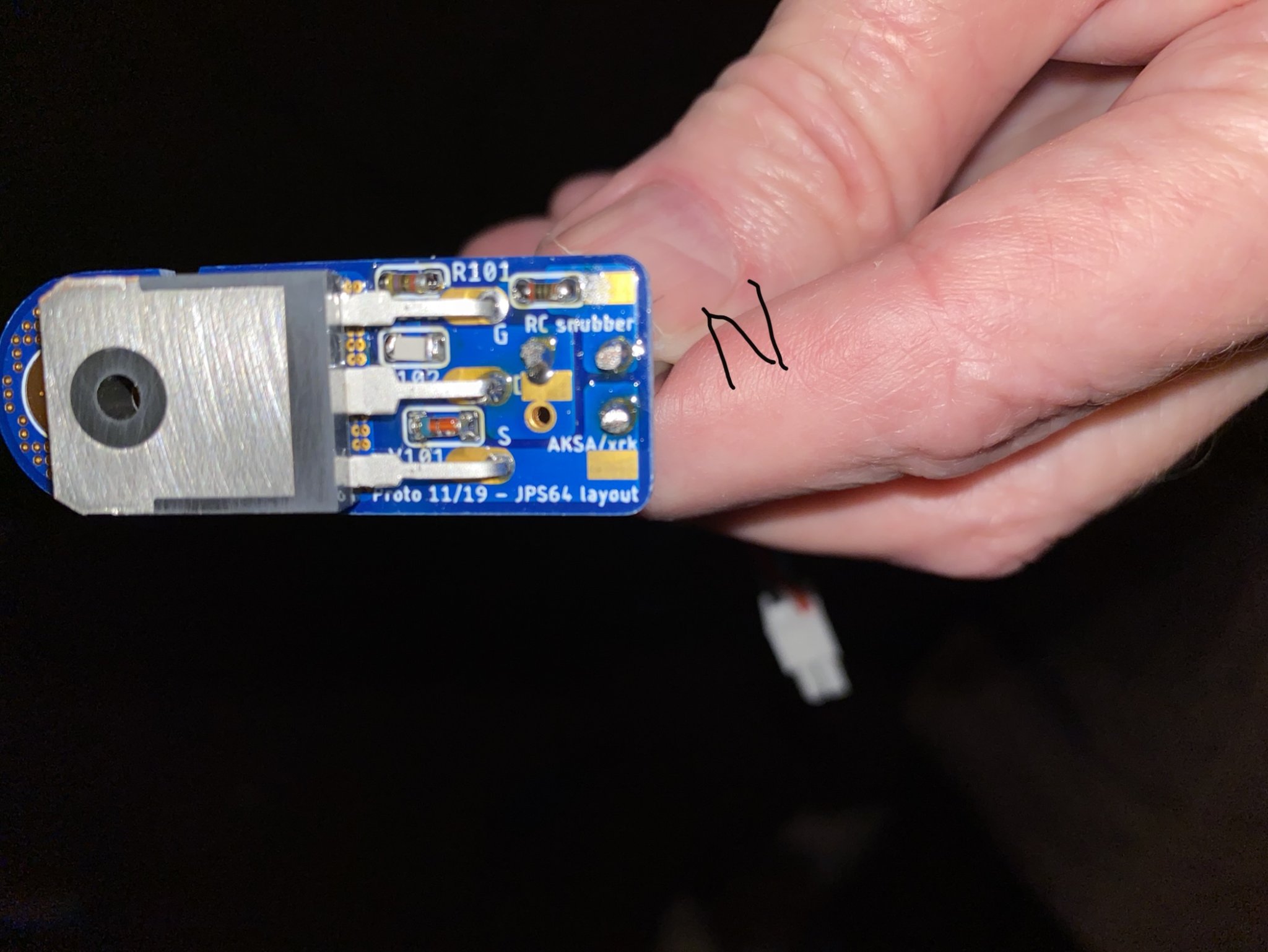

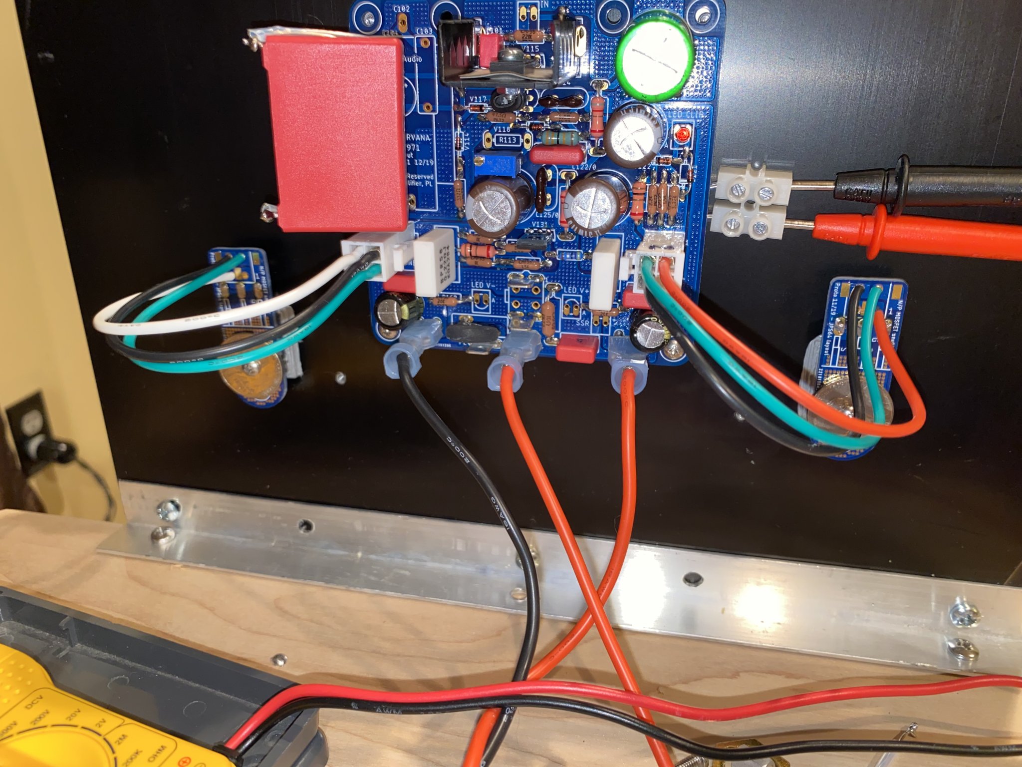

Well I tried firing one Nirvana board up
And the N channel is not working not sure what I could have missed I have the N channel snubber board diode with line toward bolt end and P channel with diode line toward the connector pins side?
Also does the wiring look correct or have I missed something?

When you say it is not working, what do you mean? No current flows through the source resistor?
Please measure the voltages at the 3 pins of the MOSFETs (both N and P) with the amp on. Also measure the voltage across the test points for the source resistors. And measure the output node DC voltage. All with respect to 0v or GND. With numbers like this we can start to debug what’s going on.
Usually when there is no current flow, there is a transistor installed incorrectly or the wrong sex. Look at the small BJT controlling the CCS. V131 needs to be a PNP and the pin outs need to be correct.
Other possible reasons are incorrect resistor value (off by 100x etc) in the circuit.
Check V121, H121, V122 diodes. Those control the gate of the N Chan. If they are flipped or incorrect it won’t work. There should be about a 4.5 to 5v drop between the drain voltage and gate voltage if working well. So 27v at D and about 22v to 23v at the G pin.

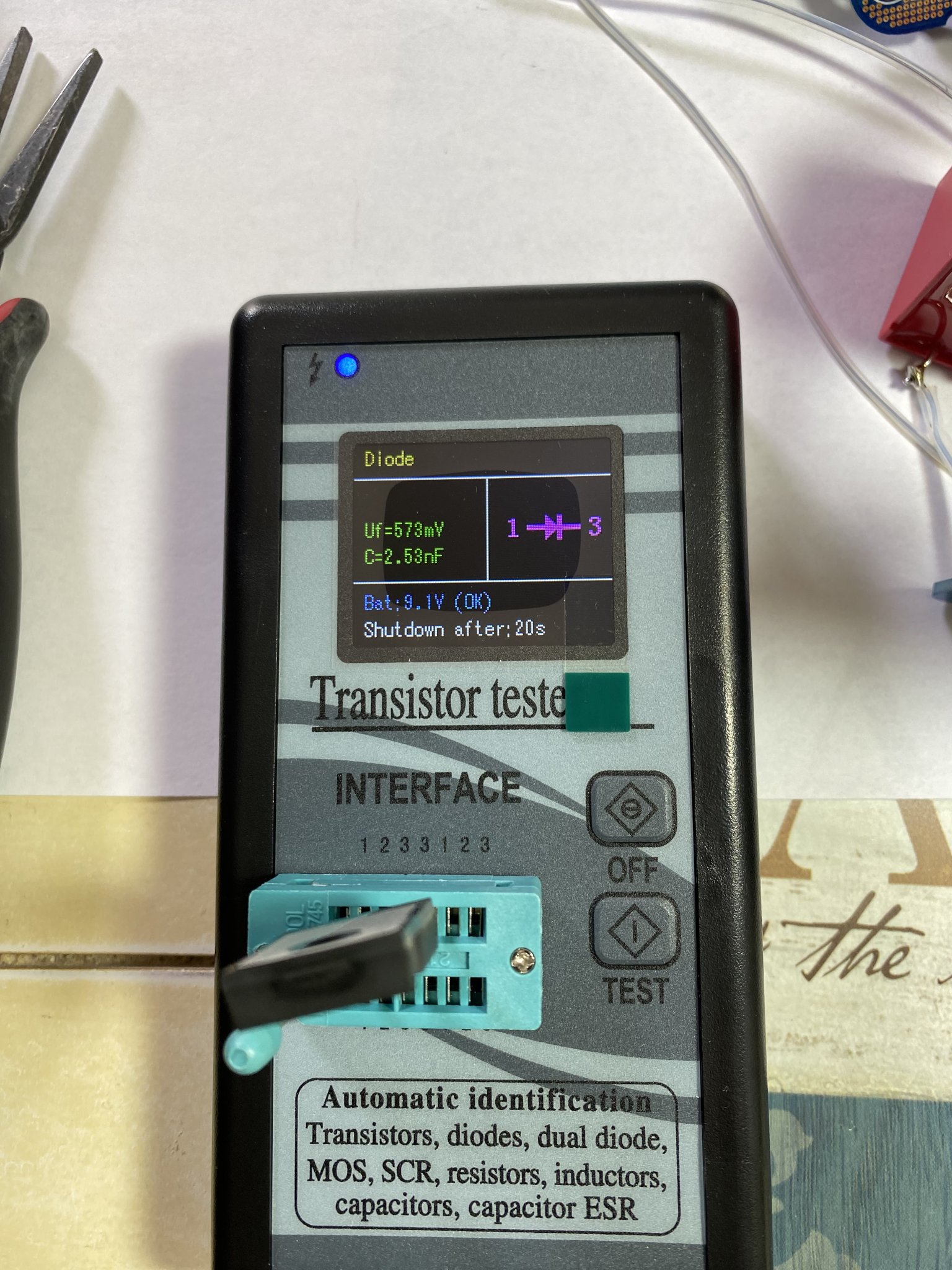

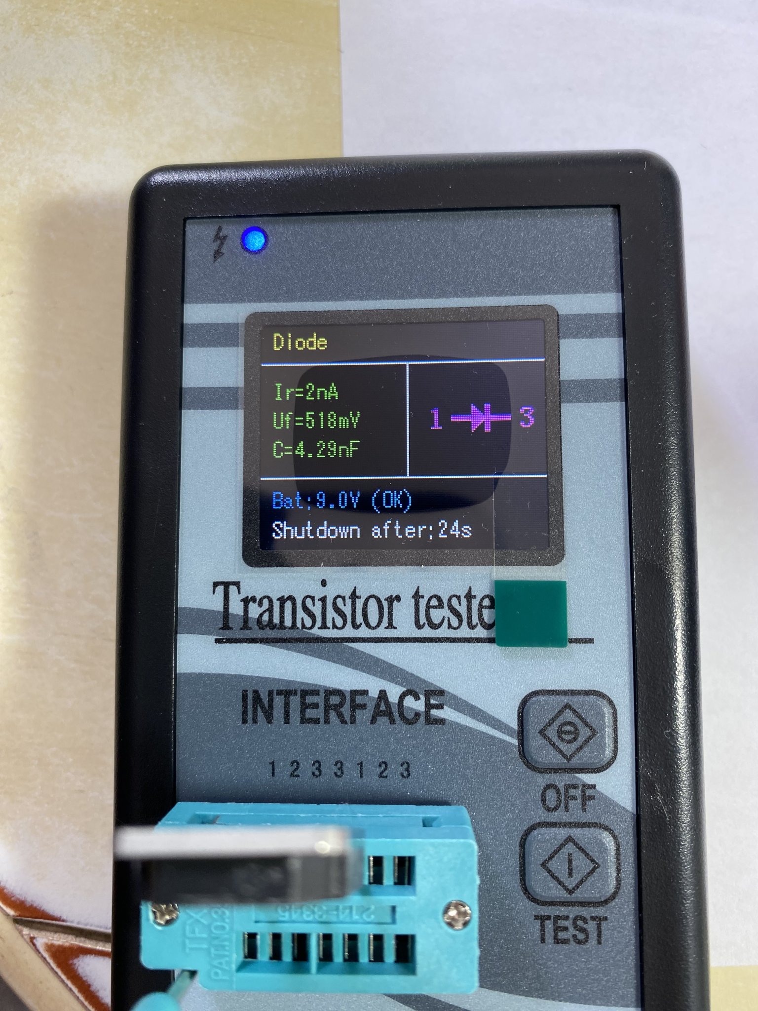

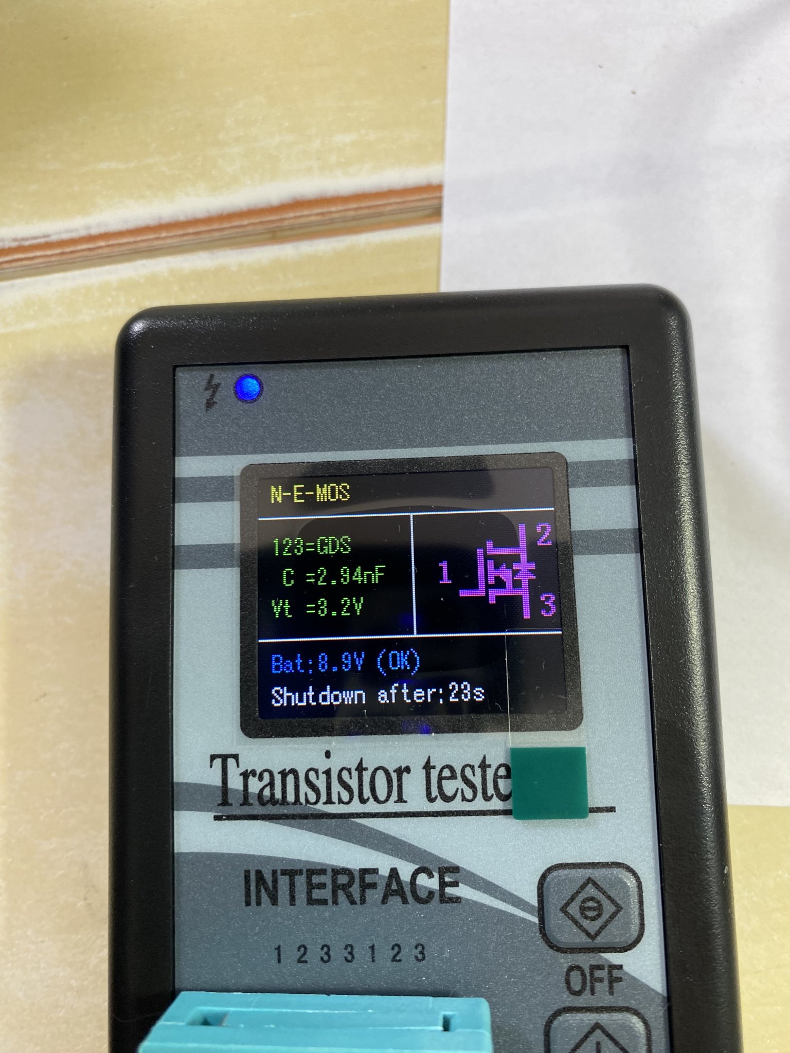

I would suspect the N-channel first. But you barely have 4 volts from your gate to source on your P-channel. Your N-channel Gate and Source voltages are the same which is a short.
Also, make sure that after you remove the MOSFETS that you put them on the transistor checker (and post here to show us the results!) and check any new MOSFETS purchased.
After installing the new ones, make 100% sure that the Gate, Drain and Source do not have any connection to chassis ground. They should also not have continuity with each other or else that indicates a failed transistor. I prefer Aluminum Oxide insulators vs Keratherm on Class A amplifiers. Minimizes the chance that the back of the Mosfet (which is the Drain) accidentally shorts to the chassis.
Best,
Anand.
The pics above show failed transistors. I have a similar tester. Last weekend I was using my tester on Lateral MosFets (2sj162 / 2sk1058) I pulled from a pair of amp boards I am repairing. Five failed out of 8 and with the exception of one of the defective devices they all indicated as the pics above. The odd one out would randomly show a good device or a diode so is not trustworthy.
A normal reading shows the 3 legs of the fuse ;) and type , whether N or P device.
