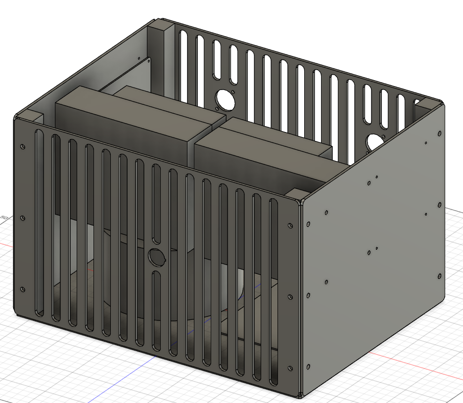

Originally, I was hoping to passively cool this amp for the sake of simplicity, but quickly realized that 100w dissipated is not so easily handled by a small enclosure. That said, I have procured 2x Noctua NH-12 Redux CPU HS/Fan. My enclosure design incorporates mounting support for the LGA 1700 brackets included with any recent CPU HS/Fan combo. I thought about using second hand server heatsinks but thought it would be nice to allow for a more uniform, off-the-shelf solution. These are mounted on the side panels facing inwards and directly pulling in fresh air via the front grill. The exhaust air flows over the amplifier boards for a bit of active cooling there. I have yet to decide how to power the fans.
Prelim enclosure design. Laser/waterjet cut panels with 2020 extrusions for the uprights. Maybe I will CNC these if I find the willpower to fixture thin plate. Superglue comes to mind...

1.) How would you characterize the cooling needs of the mosfets used for the SLB? Is it possible to passively cool these simply with the thermal mass of the aluminum base?

There are a couple of builders who started with active cooling, then regretted it for fan noise reasons. You can cool a 50W mosfet on a 200x150 passive heatsink, but four are needed. This forces you to use monoblock and two transformer design, but then, many prefer this approach.

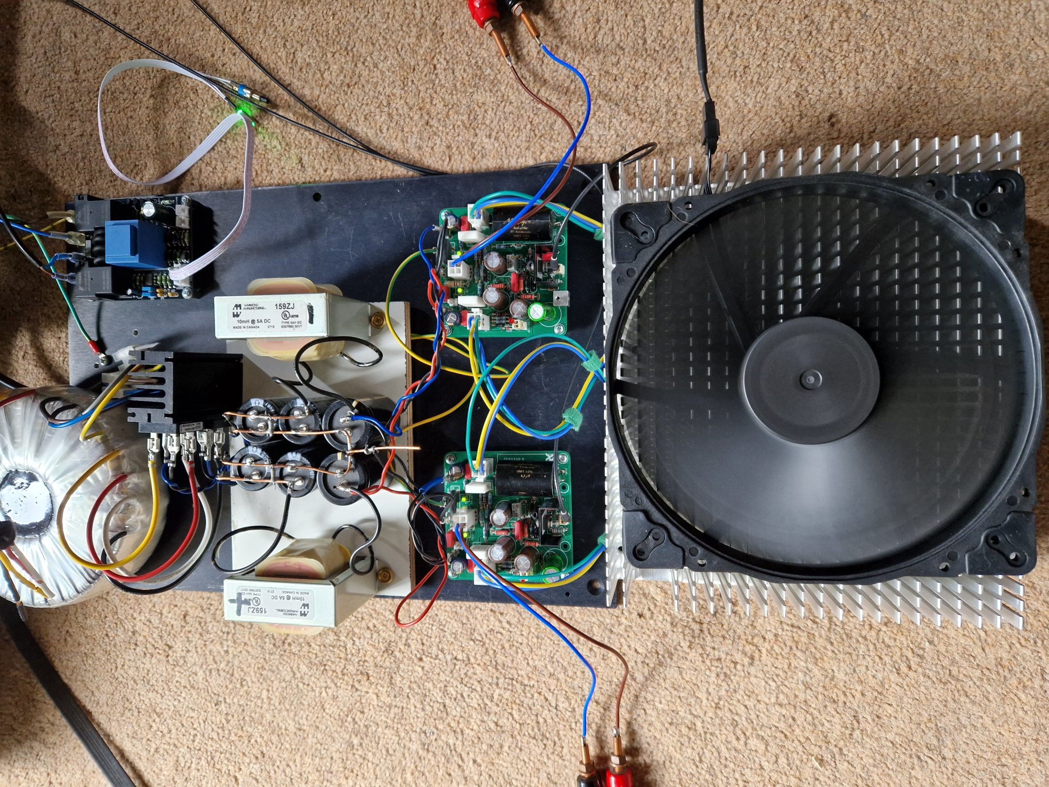

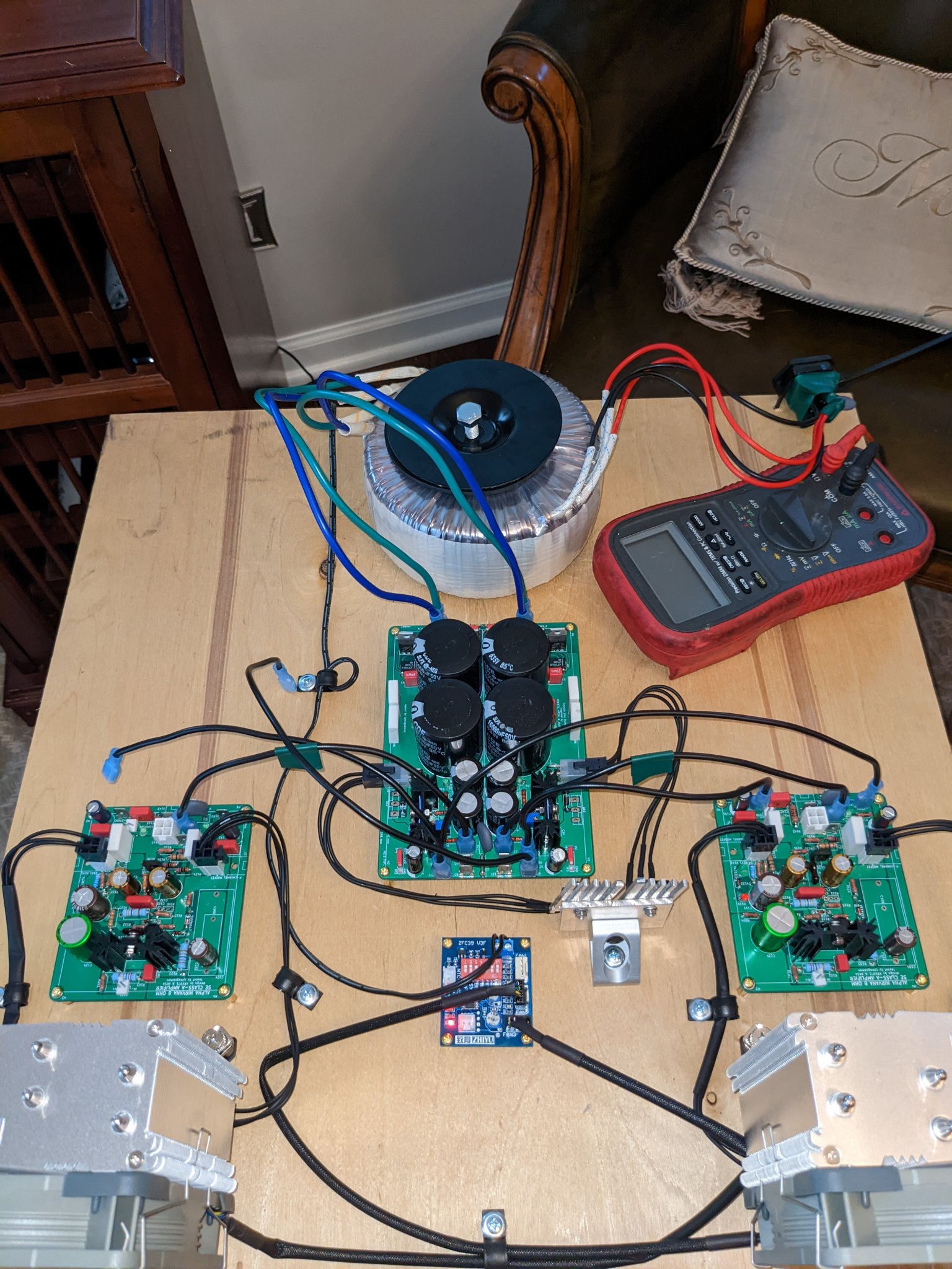

I have completed assembly of the SLB PSU, 2x AN 39, and required accessories. I have some posts made in the SLB thread for troubleshooting I am working through that I will repost below for everyone's knowledge.
SLB/PSU Issues (in order of occurence):
1.) Blew input fuse. Input fuse blew within 10 seconds of first power on. This was caused by not installing the insulators I had on hand for the BJT's on the SLB. Silly mistake easily rectified and verified via multimeter to each pin and to heatsink.
2.) R17 burned up upon applying load for 1-2 minutes. This load was for 2x 120mm fans and as such I had a lot of time to react before the resistor totally burned. R17/R18 can burn up (or R13/15) if the BJTs are not passing current due to miswiring or failure. Replaced R17 with new 10 ohm resistor, fixed.
3.) My project uses a "hiletgo" generic PWM fan controller as mentioned earlier in the thread by others. As a warning, this board passes unregulated input voltage to your fans. Do not supply more than 12V or you will risk destroying your fans as I did. Two new Noctua fans and a 12V AC/DC converter fixed this one.
AN 39 Issues:
1.) Boards powered up without any sparks or smoke, but also no heat from any components. Found that I had placed the MELF diodes on the snubber boards backwards for their respective P/N channel. Working on this fix and will report back.
2.) -Rail LED does not light when both rails are connected. I believe to be a novice mistake caused by moving the "+" label on the footprint during layout.
Some other findings at current state of AN 39 testing:
1.) Heavy DC voltage at the output, some ~5V.
2.) Voltage across source resistors very low. Somewhere between 0.01 - 0.02 ohms I believe. The resistance individually and across checks out so doubtful this is a faulty resistor issue.
3.) Double checked KSC3503 and BD140 pinout vs layout, and verified as placed condition. I believe these to be correct on both boards.

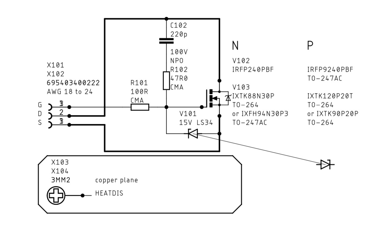

It is important to restate that I duplicated the as built schematics and parts of the layout shown throughout this thread. My boards are not proven to be correct or working at this time. Please do not use this schematic or gerber files for production of your own boards. I wholly recommend purchasing these from XRK on Etsy. That said, I did spend a tremendous amount of time checking and rechecking each component before manufacture. My schematic and layout are attached for those who are able to help me. I am working as well to troubleshoot these issues.
Thank you to all for your advice, guidance, or otherwise.
AN 39 Issues resolutions:
1.) Heavy DC voltage @ output. Fixing of diode orientation at mosfet results in DC offset @ output dropping to .005V.
2.) Voltage across source resistors is now .760Volts with diodes correctly placed on mosfet gates.
3.) KSC3503 and BD140 confirmed to be non problem.
4.) - VDC Rail LED now working after reversing polarity.
I think I may be close to the speaker hookup!!! Just need to pick my source for this testing.

Thank you for your careful analysis. Although a newbie by your admission, you are bringing care and intelligence to your build and I congratulate you for your good results at the finish.
Let me explain the discrepancies which brought us to this. I produced three or four schematics during development, which I did on Cafe napkins and LTSpice. XRK then built the amp and verified it worked. Then he passed the latest schematic to a professional layout guy and he did his magic. Then using both my schematics and JPS's schematics with different designation he published both sets on this forum.
In building anything in electronics, one tiny mistake will bring down the project. When you have two different versions of the original LTSpice schematic and a fresh, new schematic suiting the shiny pcb, there are many possibilities to confuse and obscure. Without attributing any cause to me or to JPS or XRK, one has to read the entire thread and check off all the components against the BOM. I did not produce the BOM, and I should have done that. But the JPS use multibuck software to use the AN, and it builds the BOM and identifies all the designations as the pcb is created. This is where one could be confused, and I regret that of course.

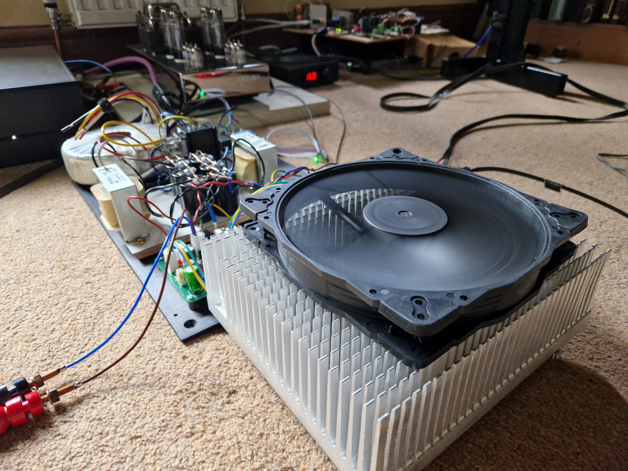

Got my heatsinking sorted. Goodness knows what this Ebay find was originally used for but with a 200mm Noctua fan running at 8.5V there's a ton of very quiet thermal headroom to go to 3A bias. At 1.6A and 20V rails it's only 8deg above ambient. I treated the amp to a custom toroid and got some used chokes for CLC just to see. Sounds sooo much better than the Meanwell switchers I used for test. I would just leave it and enjoy, but got to try CapMx next...
